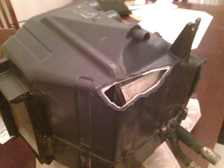

Got some progress done last night. Got my gauges installed on top of the dash and modified my AC box to fit with my floor modifications. Didn't have to trim too much and filled the gap in with two layers of adhesive foam. Got the blower motor and AC box reinstalled after that.
