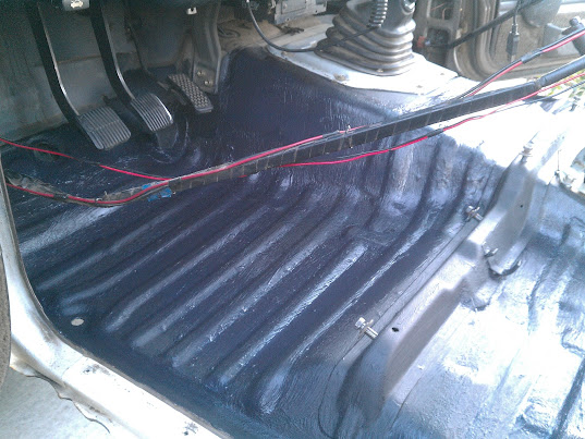

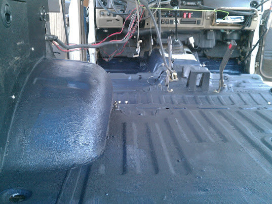

My Spectrum liner, Cruiser Crap and carpet kit showed up at some point last week and I just got a chance today to get some work done. Took out my interior ( again ) and pounded out the last of the factory insulation crap.
Cleaned with Xylene then brake cleaner:
I used ~1.25 gallons to put three coats on the entire floor pan. I was planning on doing 4 but I think 3 will be more than enough. Thank you Doc for the advice!
Much better:
This stuff has to cure for 36 hours, then I'll lay out my Cruiser Crap and install the carpet!!
