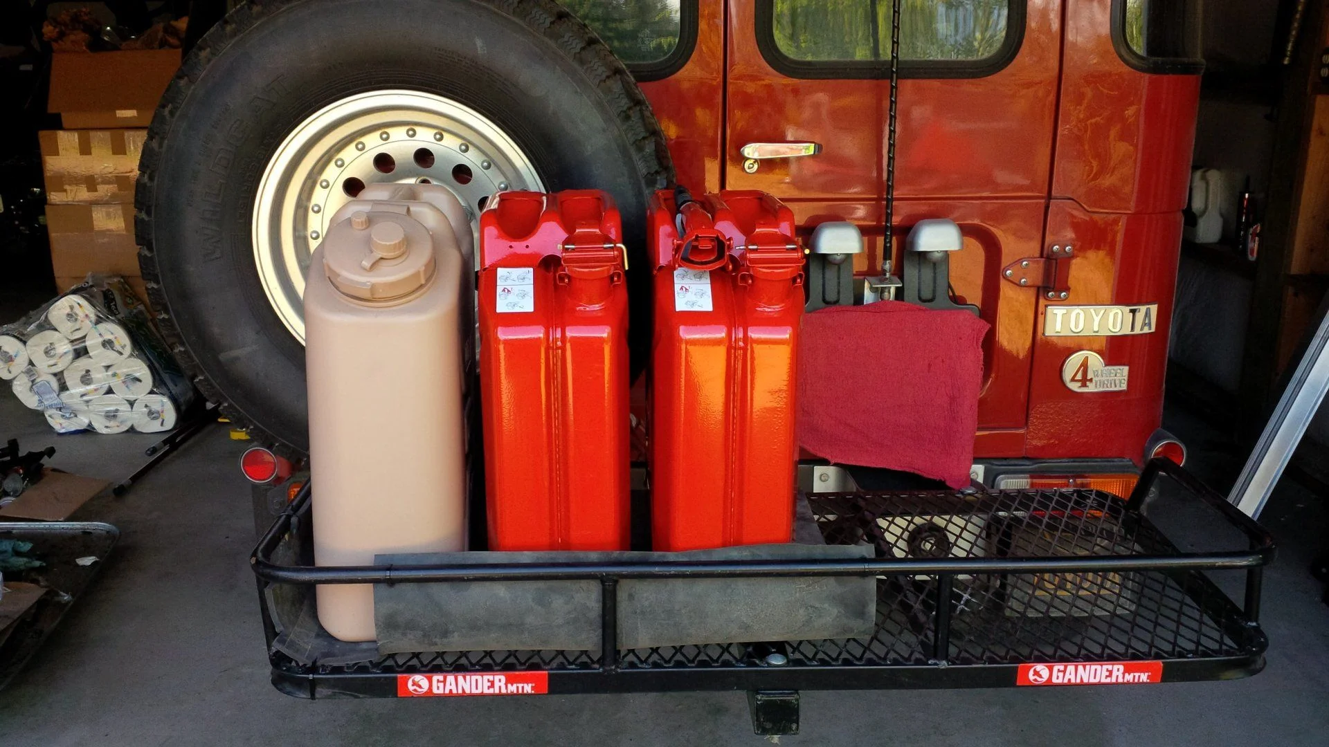

Picked up couple of NATO Jerry cans and one Mil spec water can, will be hitting the trails tomorrow with the:princess:.
Cans are sitting on 1/4 inch isolation rubber to prevent road jarring damage.
full
Approximately how heavy are those NATO jerry cans?
The Toyota OEM one weighs over 14 lbs and that's without gas!
They are 12 Lbs each.
