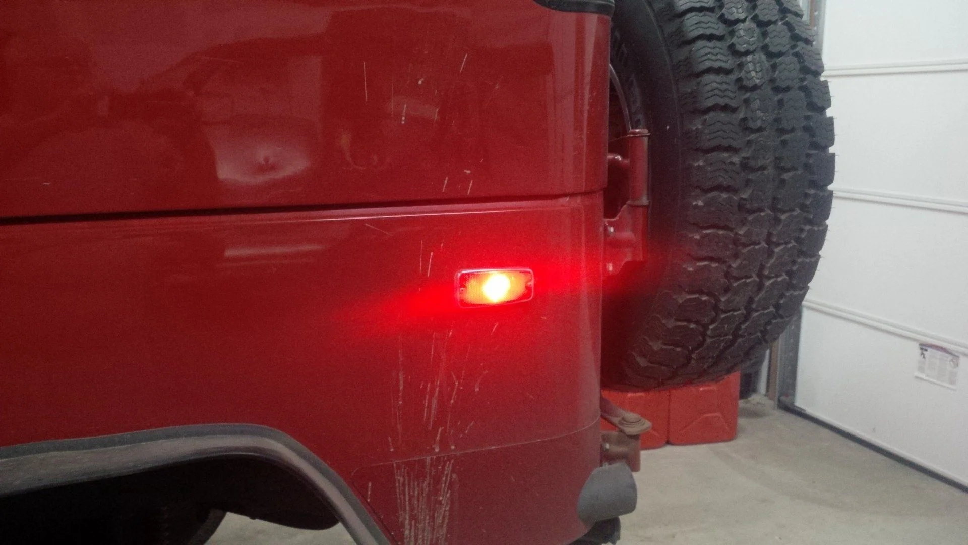

Rear Side Markers
full

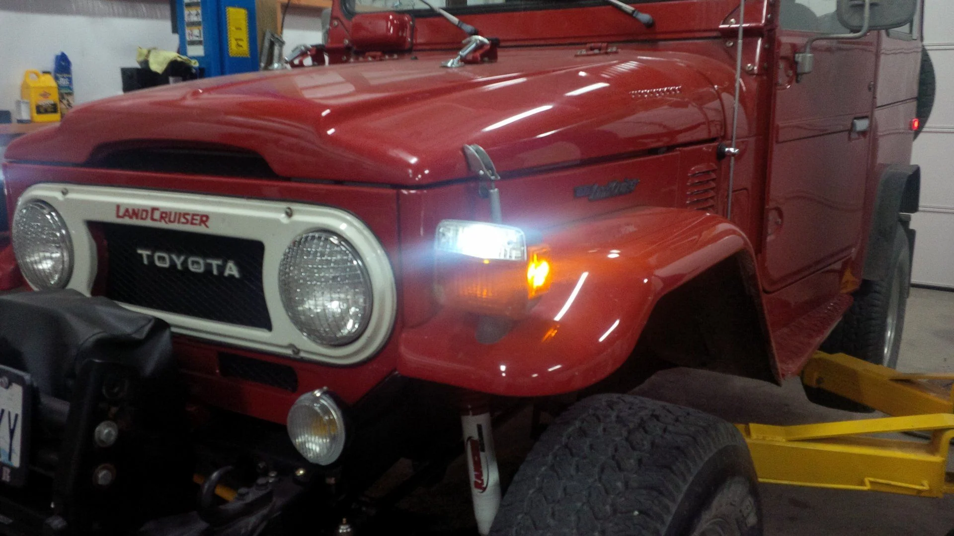

Front turn signals, side markers and running lights LED, with the exception of the head and fog lights (future project)

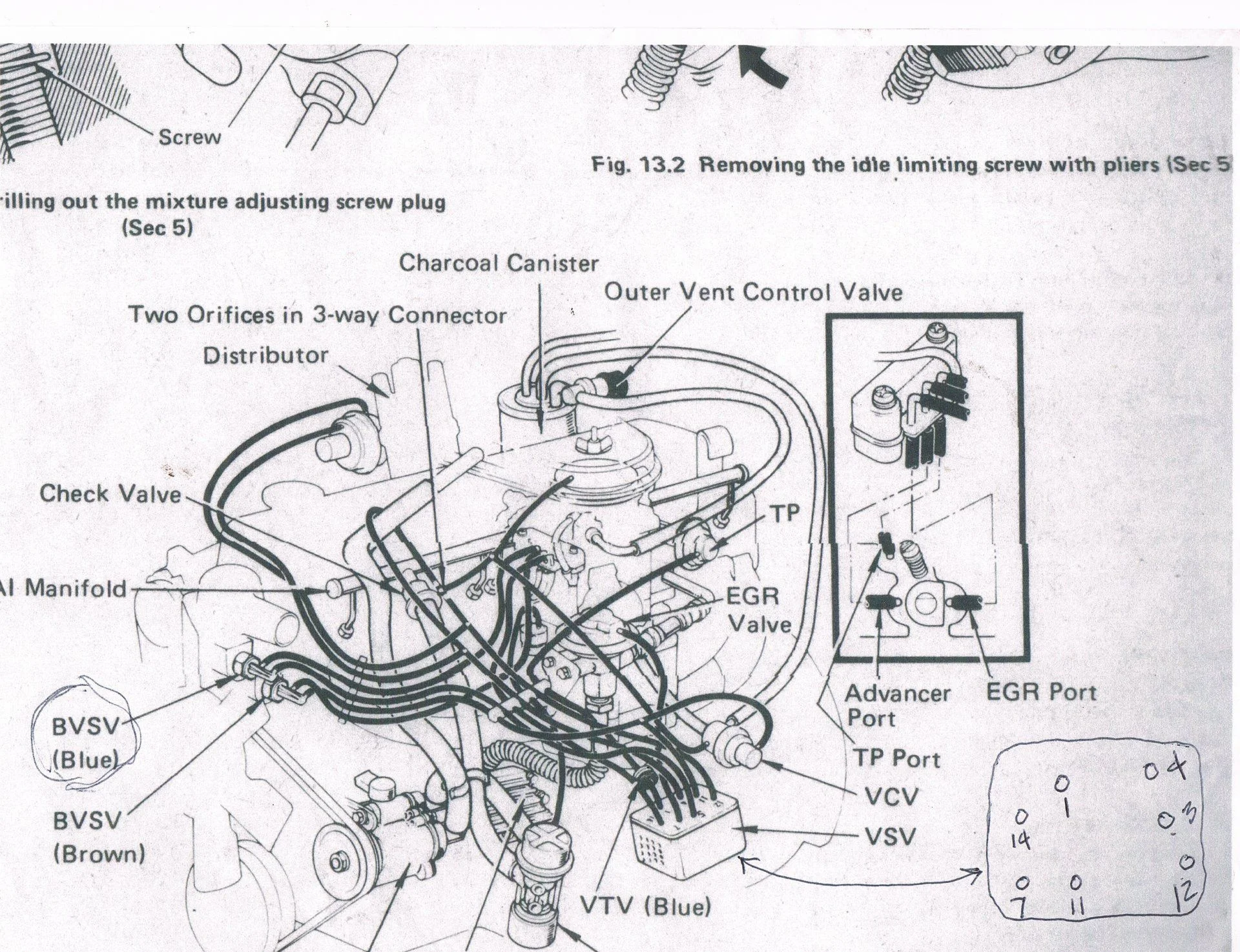

1978 2F Engine Emissions Diagram
For reference:

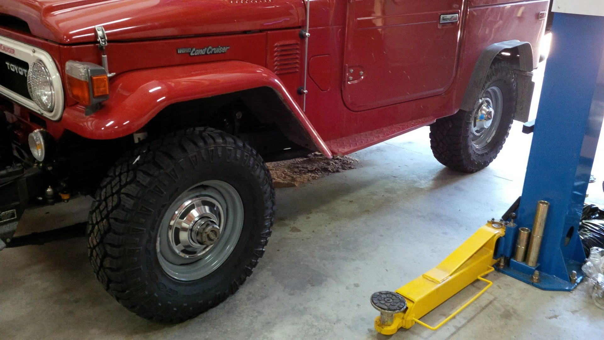

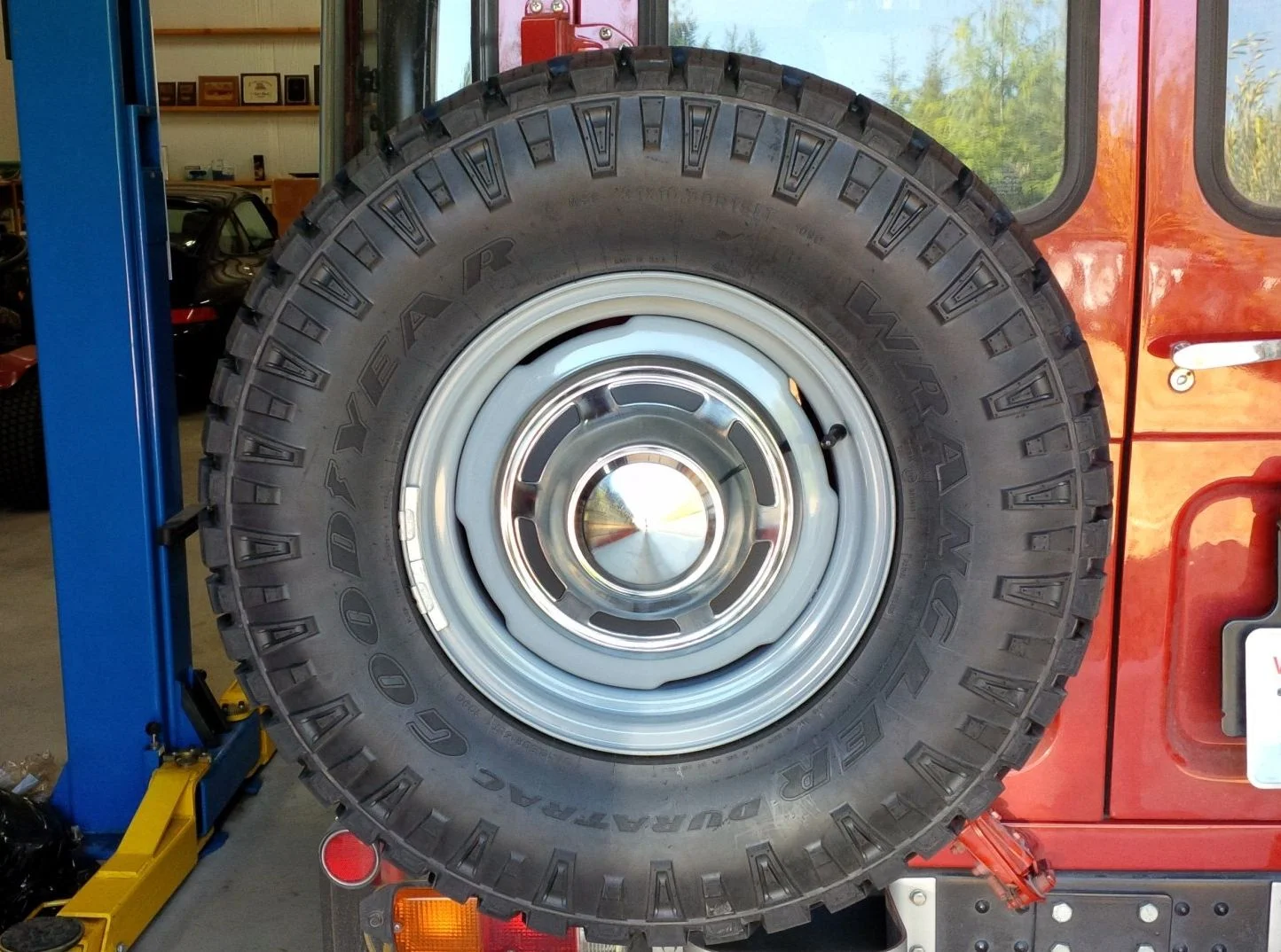

Installed my new steelies, tires and hubcaps what a difference it makes.
Tires - Good Year Duratracs 31x10.5x15, steelies OEM Toyota, hubcaps OEM Toyota.
I'll be removing the rear flairs as I no longer need them, that was a PO add-on, however, the mud flaps stay since they are my install.

I'm in the middle of breathing life into the carb cooling fan system on my de-smogged 78 fj40 that runs a header (plenty of good threads on that subject) ... one of your early pics re your re-sealing project with your intake/exhaust manifolds on your engine lift, points to me perhaps needing to move the manifold temp sensor/sender re the carb cooling fan closer to the header so it can get a temp reading signal ... just proves plenty of pics can help in a number of ways ...

your OEM steelies, hubcaps, and tires look great ... that's the way a 40 looks best in my humble opinion ...
