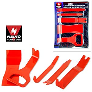

GAA thanks for the tip, will do. What tool did you use to pry the hub caps off without scratching the paint?

I use two of these tools in the photo below. The far left and far right piece. I put the 90 degree bends back to back, with the fat blade towards the rim and the smaller blade under the lip of the hubcap. You sort of have to wedge them in, once in place, I twist the smaller blade till the hubcap pops off. (note - I put a hand towel over the hubcap to keep it from flying out of the rim once it pops out of the springs) Remember, my rims are 9" wide, that means my hubcaps are are 4" deeper from the outside of the rim. If you have stock steelies, I would think all you need is the OEM hubcap tool.
I keep these tools inside my Toyota bag in my rig, just in case needed.
Thanks GAA, will do.
