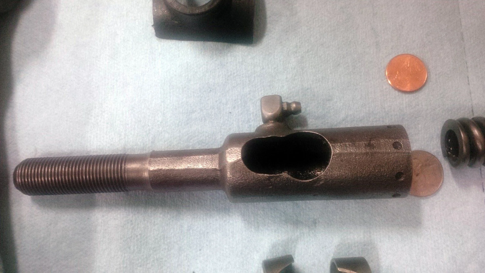

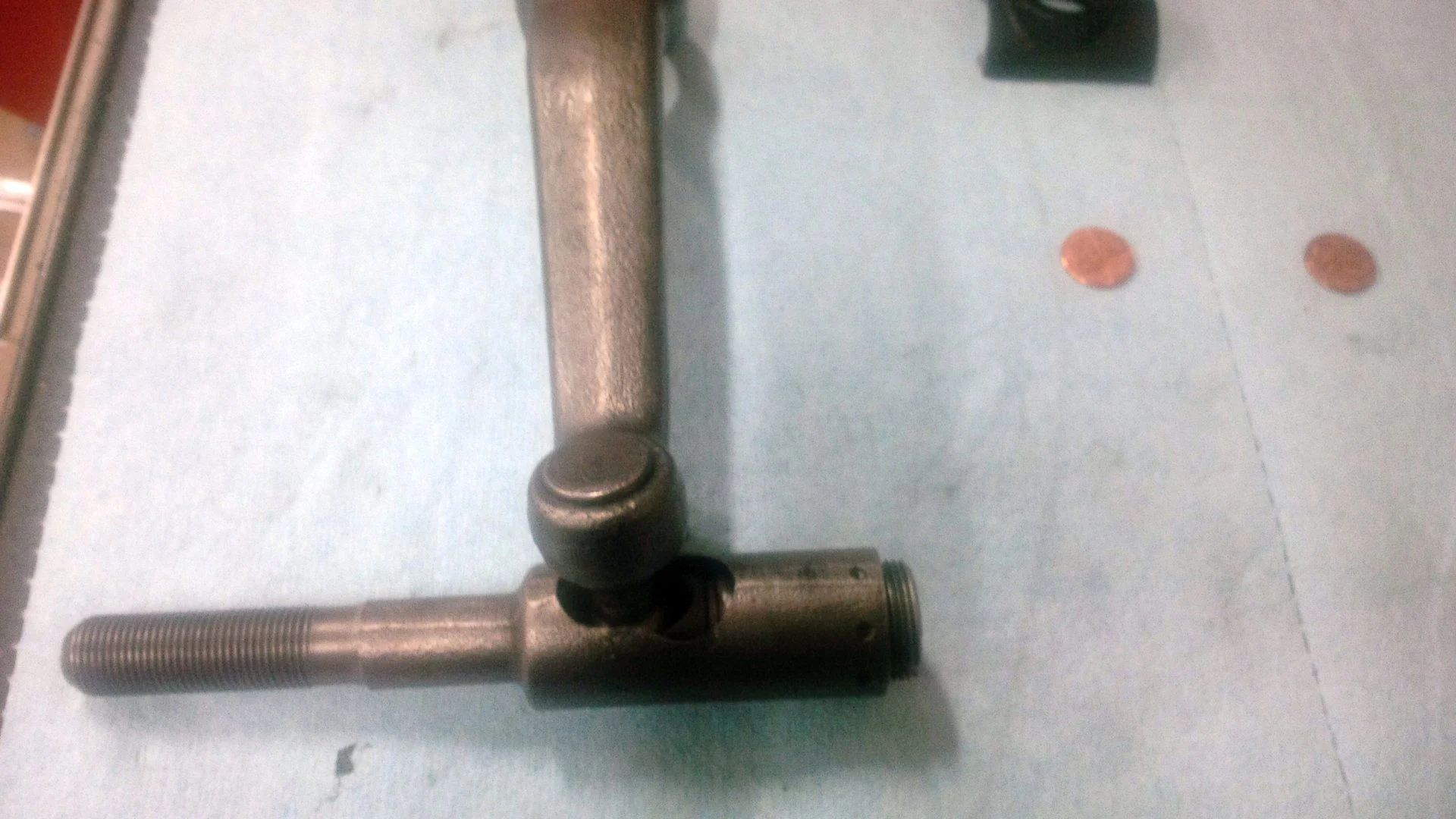

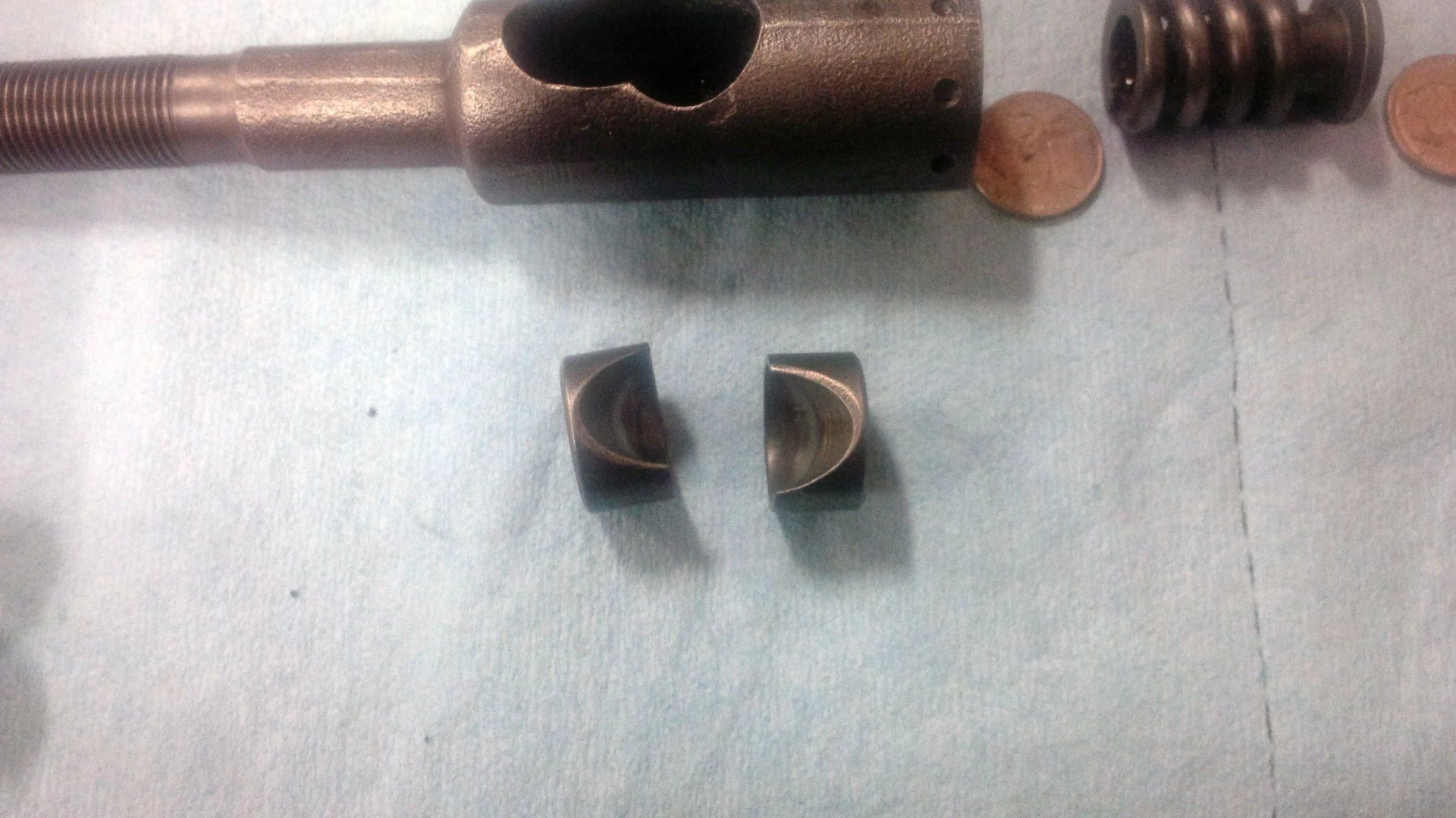

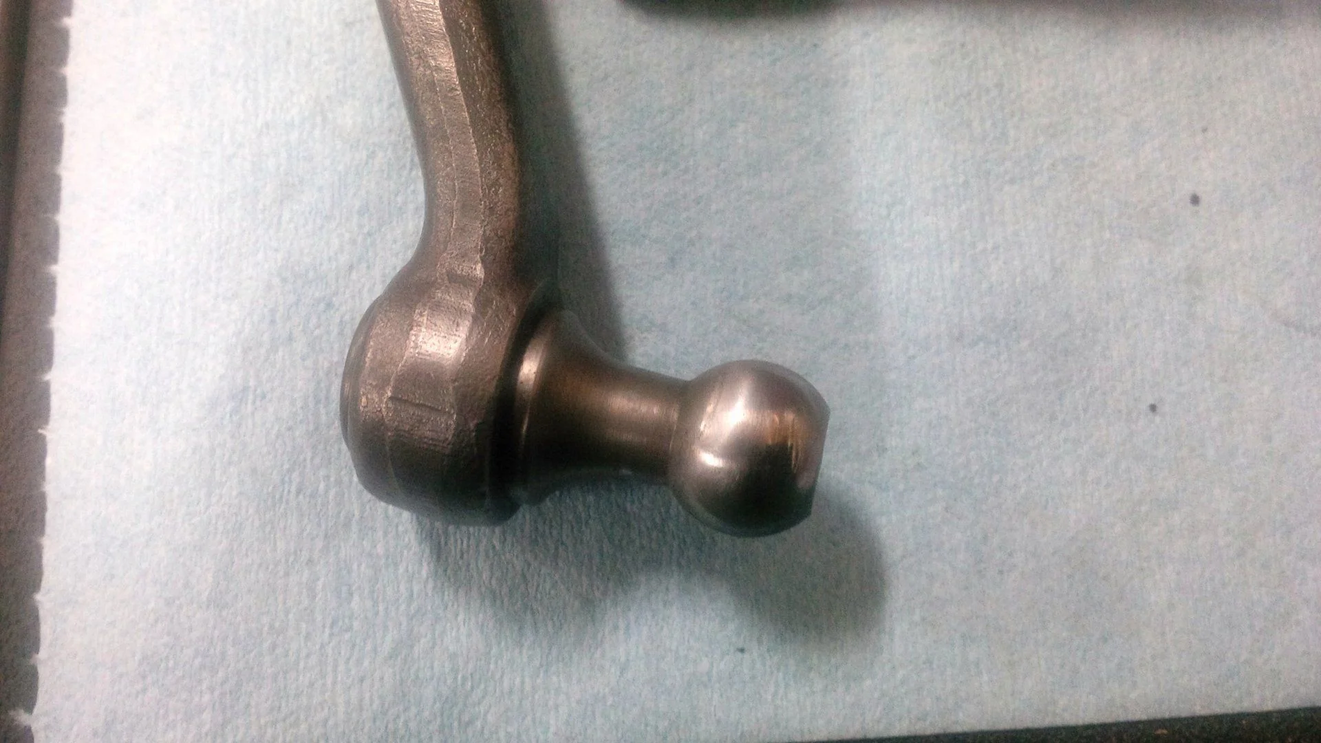

I did the penny rebuilt on the relay rod/Pittman arm ball housing, the pennies really didn't work that well so I upgraded to nickels and worked great. Here are a few pics.
