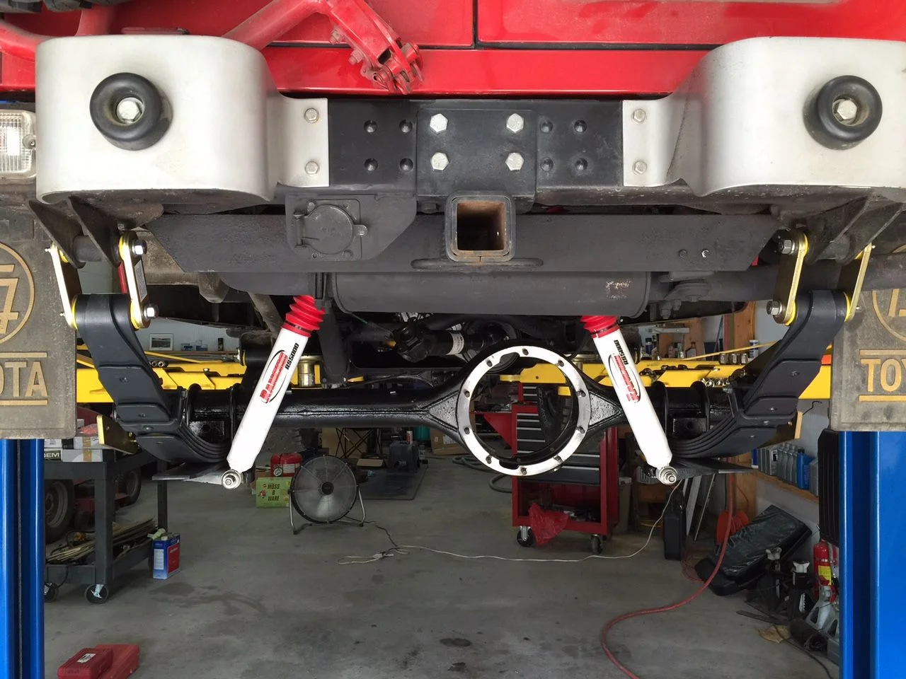

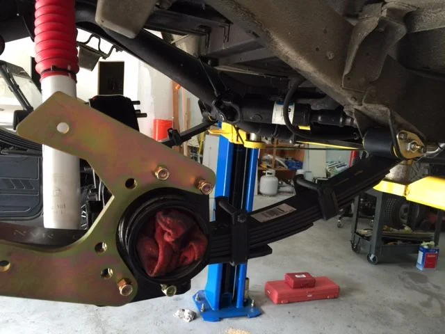

Rear springs installed and trying out the disc brake brackets for optimum braking location, final location still pending

I also installed new rear bearings and seals (not shown) will upload new pics tomorrow

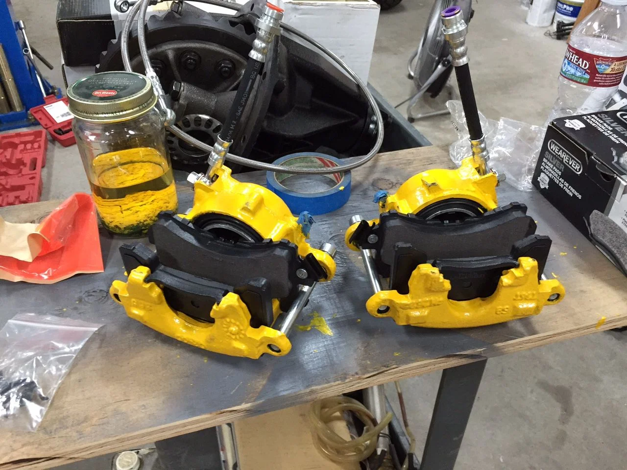

All I was able to do today was to assemble the calipers.

Nice Mike, the calipers look sweet!!! I need to clean mine up too. I guess I will look around for mud flaps.....I thought those looked pretty burly.

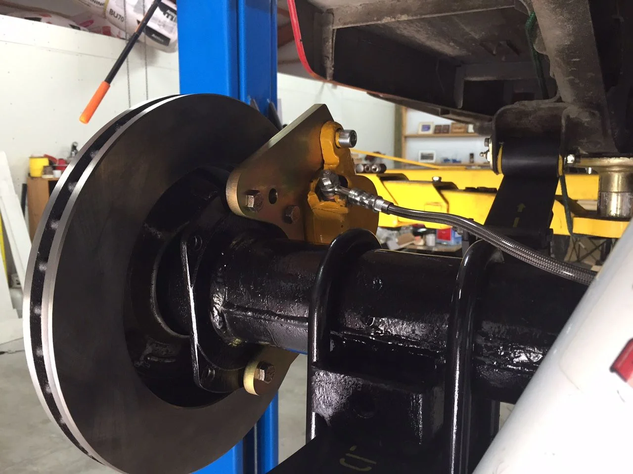

Rear disc brakes installation progress pics:
full
Rotors and calipers installed
full
Using stainless steel flex brake lines

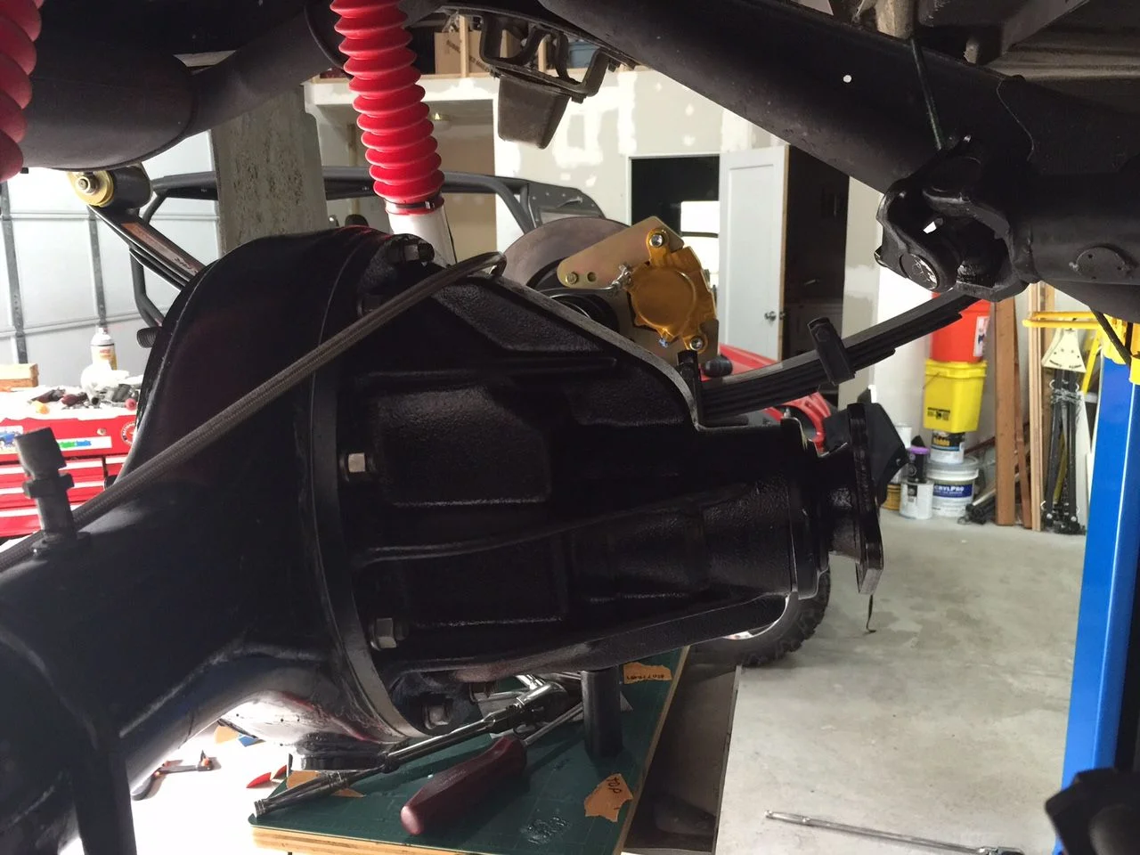

3rd member filled with oil and no leaks
