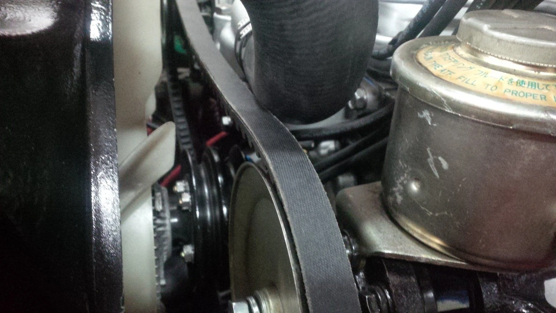

Today I had some spare time to work on the PS system, I finished installing the PS pulley, also installed the belt and quickly discovered that the belt is in contact with the upper rad hose, so at this point I'm stuck. Does anyone know of a solution for this problem?
I'm using an FJ60 pump and mounting bracket.

The belt is loose as a goose, if I tighten more it digs in the rad hose
full
Is that a factory hose? I just put a new OEM one on mine tonight to deal with a similar issue. It has a tighter bend to avoid that problem than yours looks to have.
Or maybe the FJ60 upper thermostat housing is a slightly different shape to point the hose in a different direction?
The "issue" is the thermostat housing. I'll do some digging tomorrow to see if I have a housing that'll work. Obviously the later 2F 4-bolt thermostat housing would work, but you don't have an oil cooler on the engine which will limit your options some.

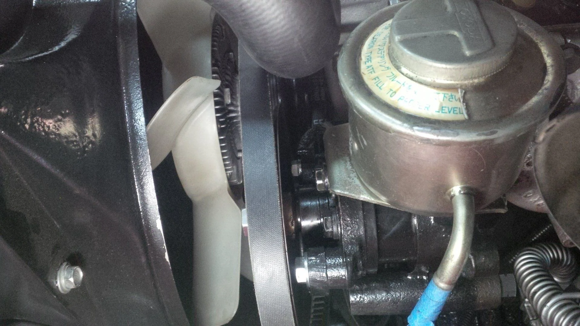

I've been looking at your first pic of the power steering pump. First, it does look like a thermostat housing that points upwards more would solve the problem.
Maybe it's an optical illusion caused by the angle of the pic, but the first pic in post 169 makes it look like the power steering pulley is not aligned with the other pulley on the opposite side of the motor. It might be tight quarters there to do this, but place a straight edge across the crank pulley and make sure both pulleys are on the same plane. If the crank pulley is a multiple groove pulley, which I think it is, this will be harder to do, but it is doable with an extra hand and a tape measure.
At the same time you can make sure the opposite side pulley is properly aligned.
It looks like you have limited space there and may need to temporarily remove some items, but if the pulleys are not closely aligned you will experience odd belt wear, and possible future problems.
Don
You can plug the oil cooler nipple off. This is in a 78 FJ40 with a 2F and PS with no oil cooler.

So by using this Tstat housing solves the belt issue? I'm also concerned about the misaligned pulleys as this condition will wear belts prematurely, does the Saginaw PS pump align better than the FJ60 pump?
Thanks!
Please do Georg, my Saginaw pump is not aligned so I would like to compare to an oem setup
Every FJ40/45/60 with PS utilizes that exact belt and pulley setup. They're all slightly offset. I can post pics of an FJ60 engine later today it that would help.
