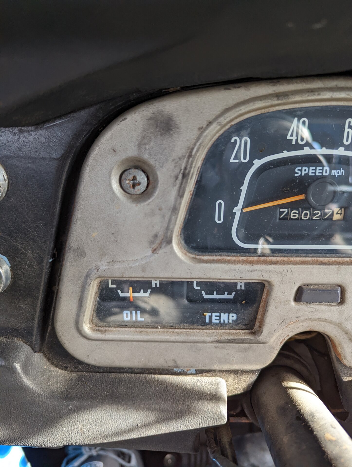

So my recently rebuilt 2f (from an 87` 60) has this low oil pressure reading. It never goes higher than the middle even under higher rpms. It usually stays right above the second tick. and also I think my guage cluster is reading temperature incorrectly because when I shut off it falls to H and the guage doesn't move past this marker. It's like it's backwards.
The picture is at 2500 rpm on the freeway <speedo temporarily disconnected>
Any ideas? Thank you

It doesn't really change or increase with rpms. I will check specifically tmrw. It's usually higher during warmup, then falls right where the picture is.

Seems to be in a normal spot on the gauge. First thought is are the gauge and the sensor matched? Running a late 80's engine in an early 70's truck may be part of the problem but not sure. If I were concerned I would get an aftermarket gauge and get some readings. Think it should be in the 45-50 psi range. Then you know it is good.

It's been awhile but I'm pretty sure I used the original sensor? I don't want to misspeak but I remember the temp guage having this issue since I've switched to the 2f and I think I had to use the original temp sensor because the one for the 60 is different? Not positive but I will check

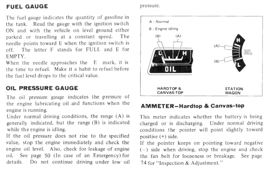

Gauges on the 40 are indicators only, I look for changes from the normal positions that I have seen on my truck. As reference, here is the information from the 73 owner's manual on the gauge ranges. An 76 owners manual may give you the same reference information.
