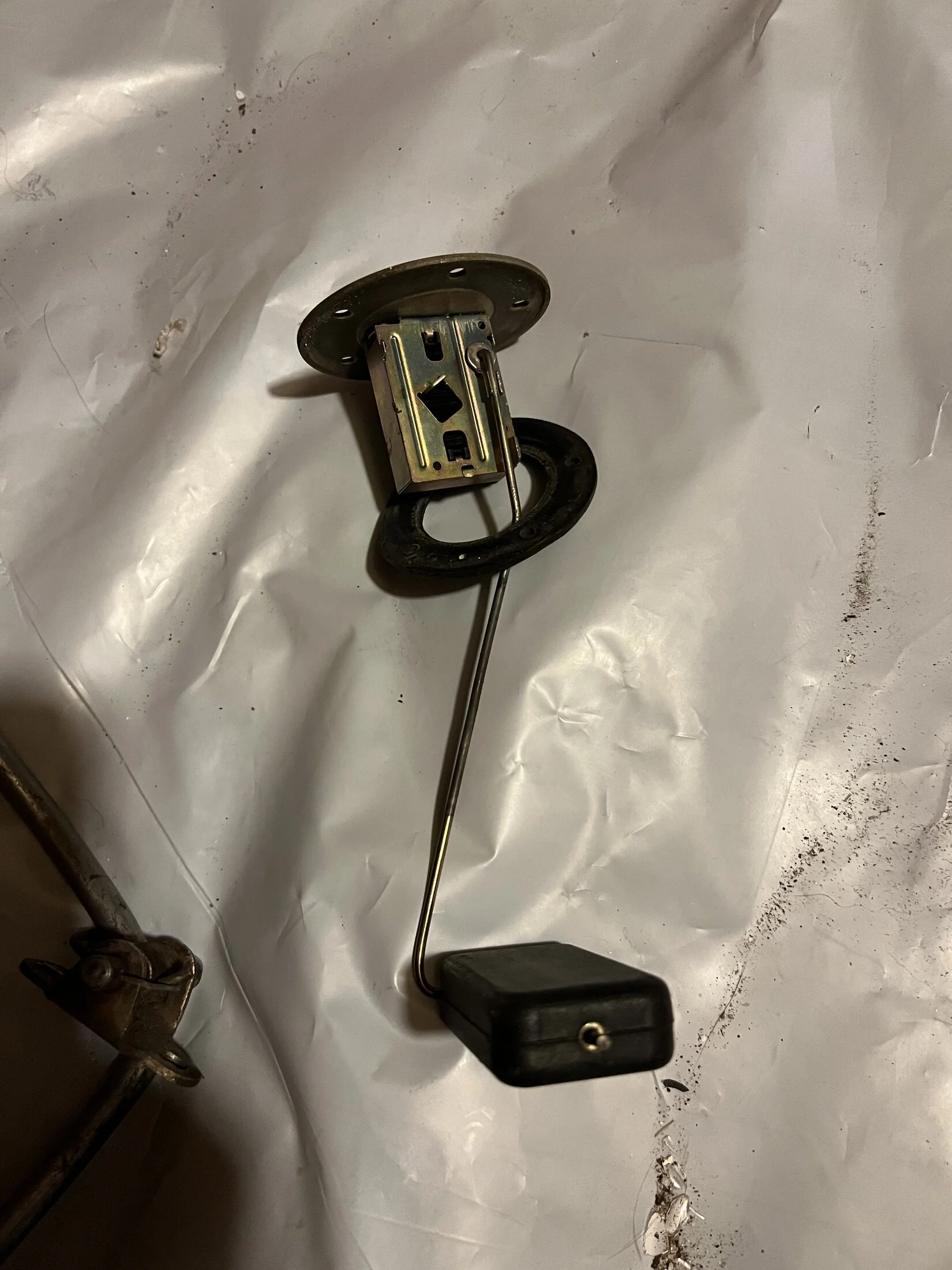

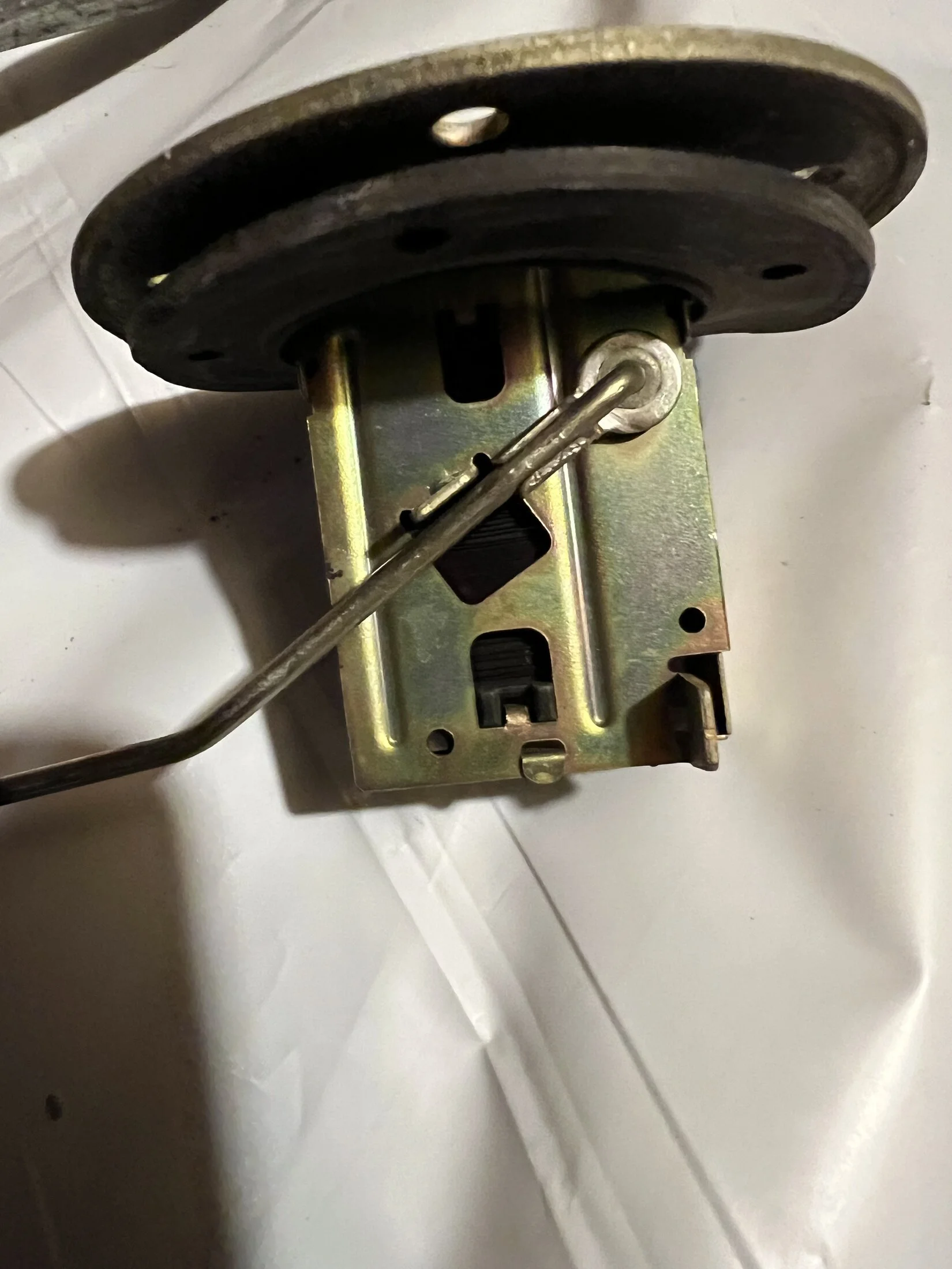

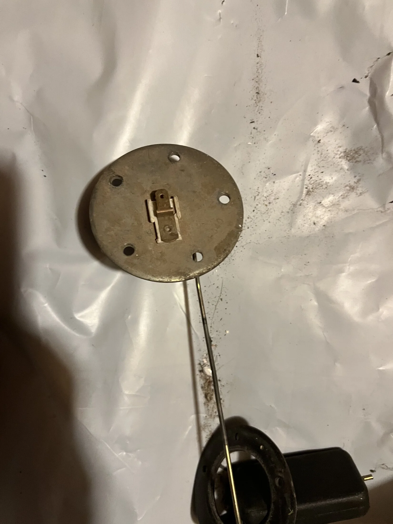

You bet though, I should clarify that I was mistaken. What I have is the sending unit and not the gauge
Here are a few pictures. DM me your address and I can send this over to you.
