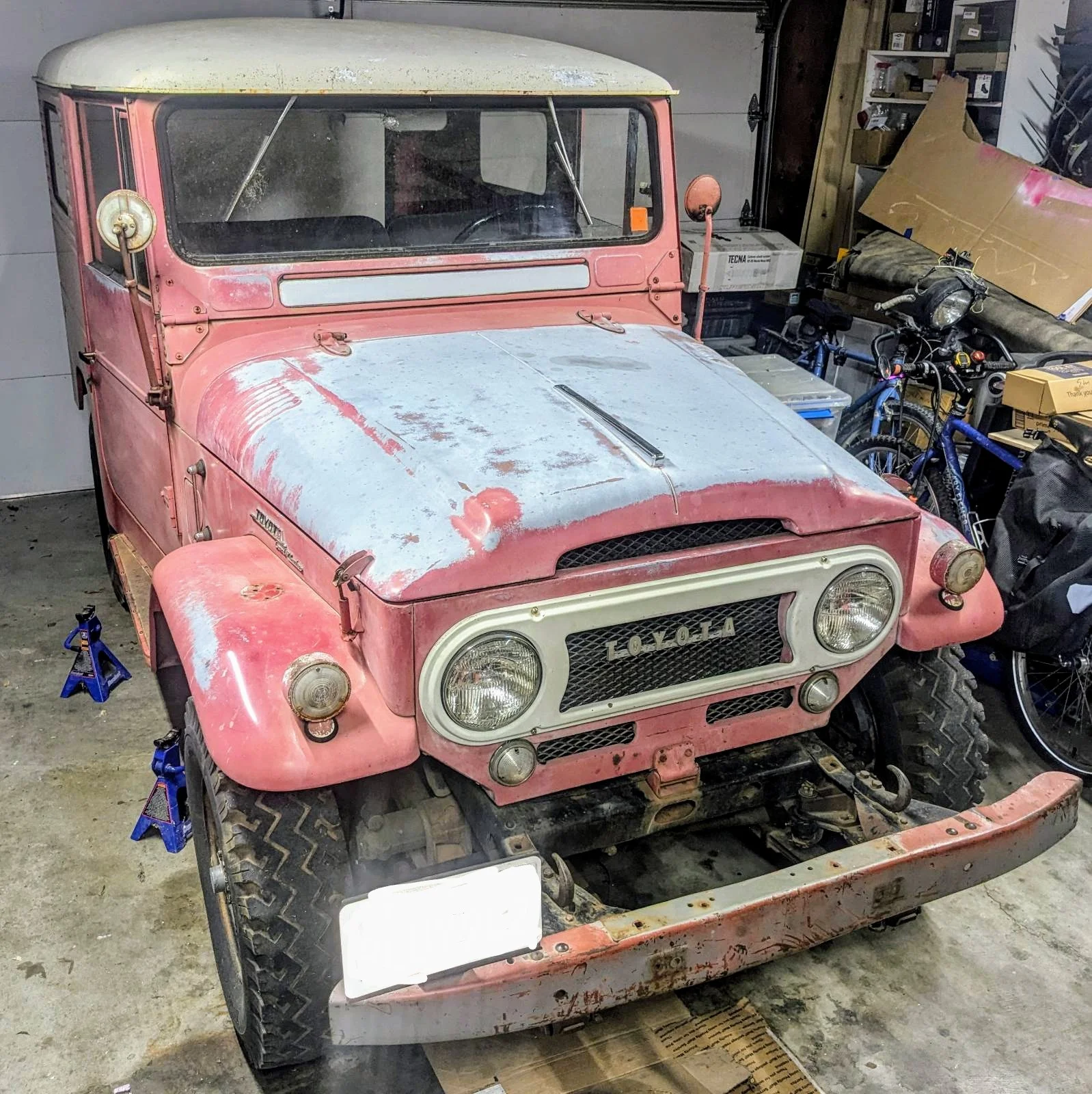

9 Months into the build for the 69 FJ40 project, I'm still in the "welding sheet metal" phase. It's also morphed into much more of a crawler than I first anticipated, just based on the parts I've managed to scrounge up. Someday it will be pretty rad.
So when I came across something much more complete, I thought 'hey, I could fix the brakes and just drive this one!'. But maybe it's not quite as easy as I first thought it'd be. This rig is largely original, in all the good and bad ways. But it's not all Toyota-original.

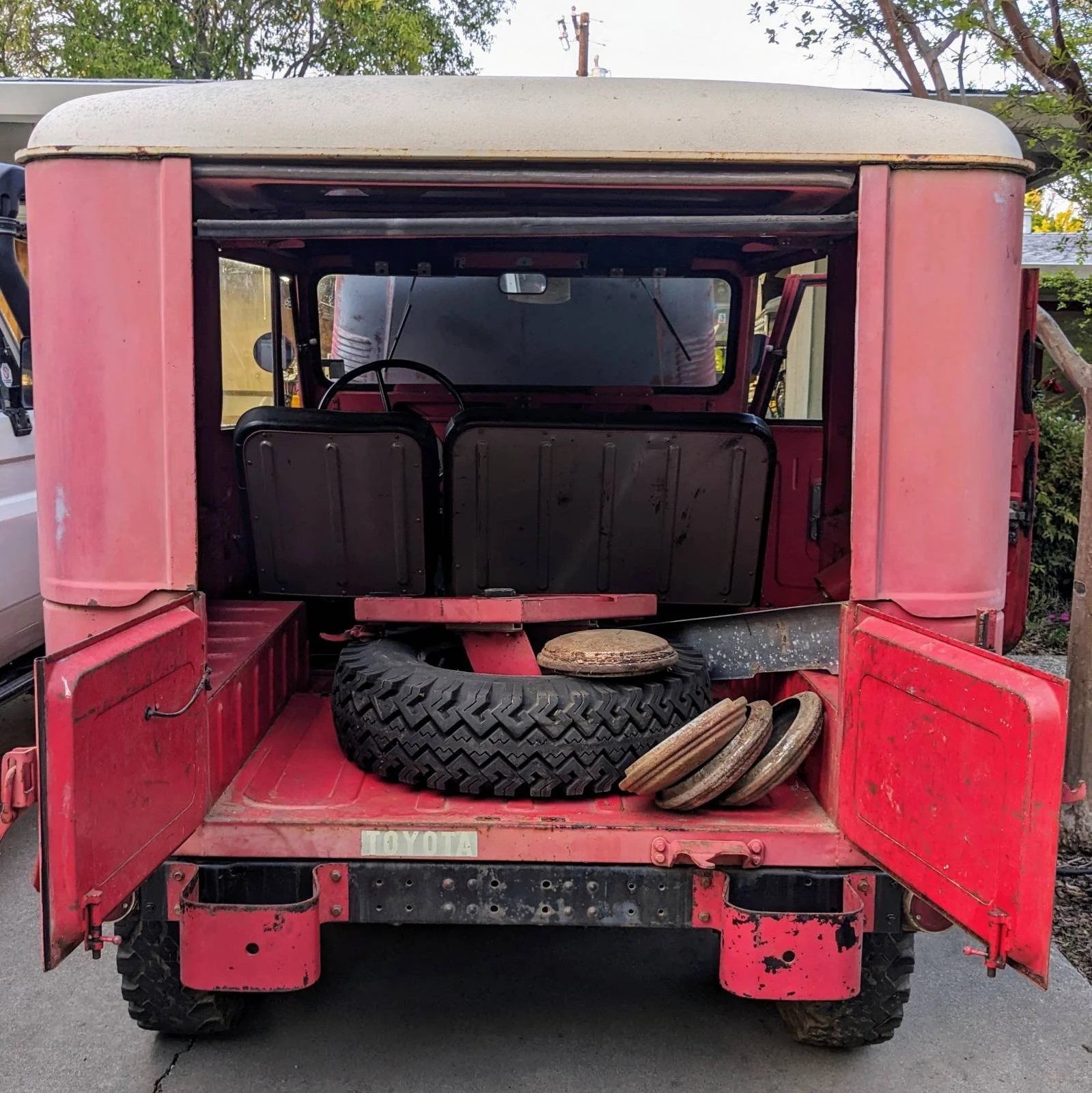

The bifold door is awesome, but the spare tire carrier is busted and the tires are all ancient.

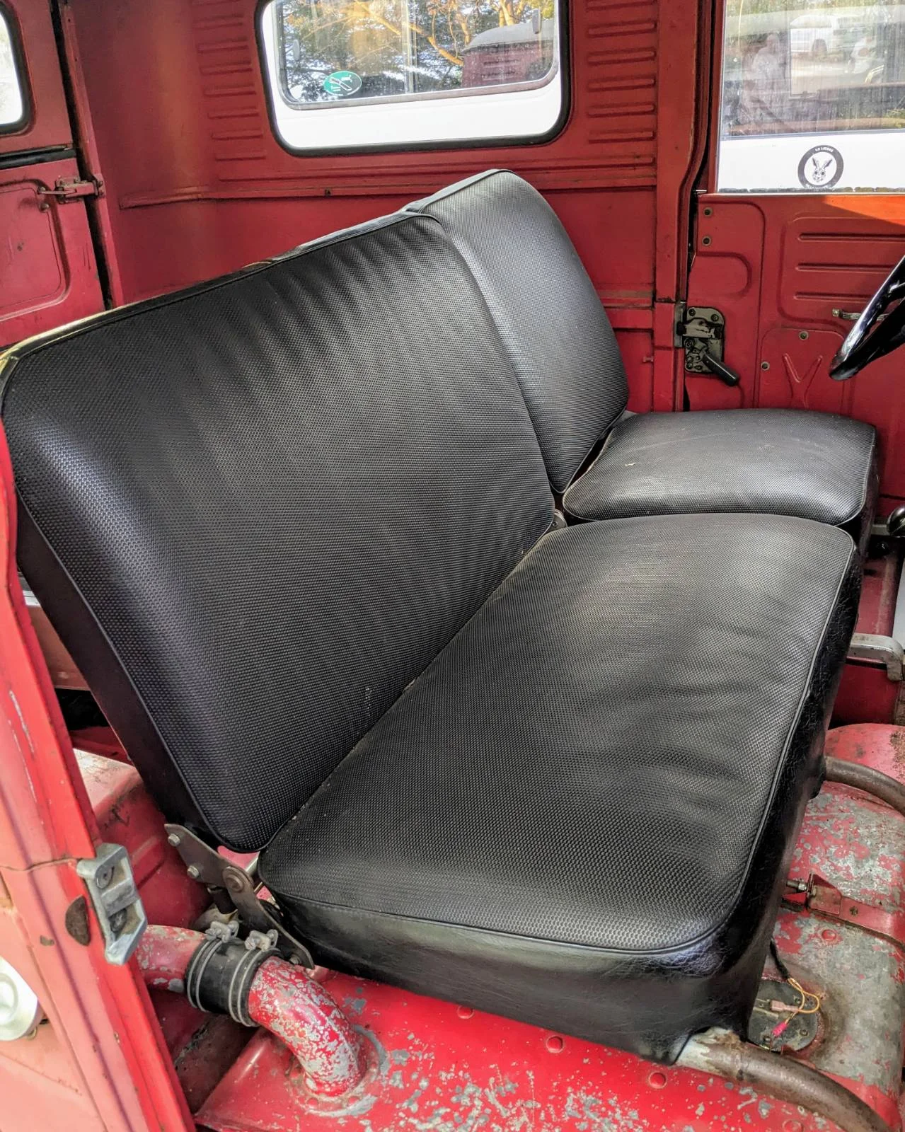

Nice seats, shoddy terminals at the fuel sender.

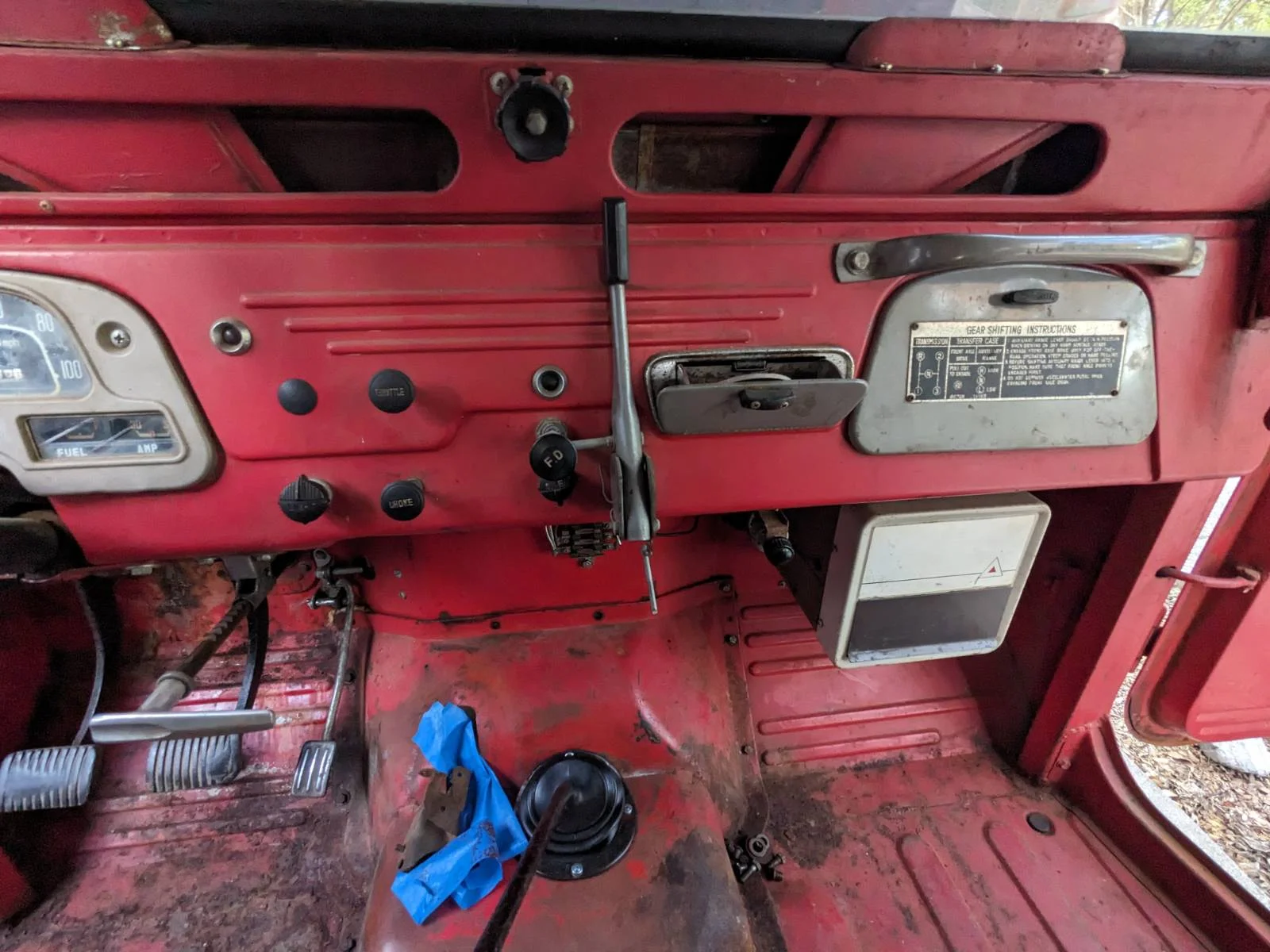

Dealer-installed heat? And someone moved the shifter to the floor.

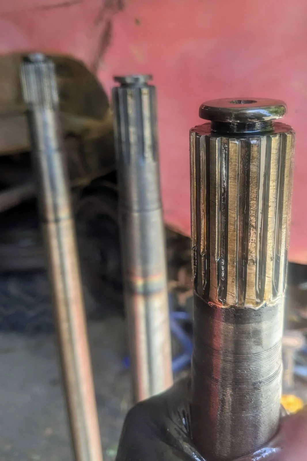

But when I got to the rear left corner, the lug nuts wouldn't spin off. Instead, the wheel studs were just spinning in the axle flange. Rather than employ care and critical thinking, I decided to cut/break the studs off and swap in a donor axle shaft. Along the way I realized this one corner had reverse-threaded studs. Odd. But I'd already broken several off so I was committed to the axle swap.
And then I found this.
16 spline axle? What the hell?

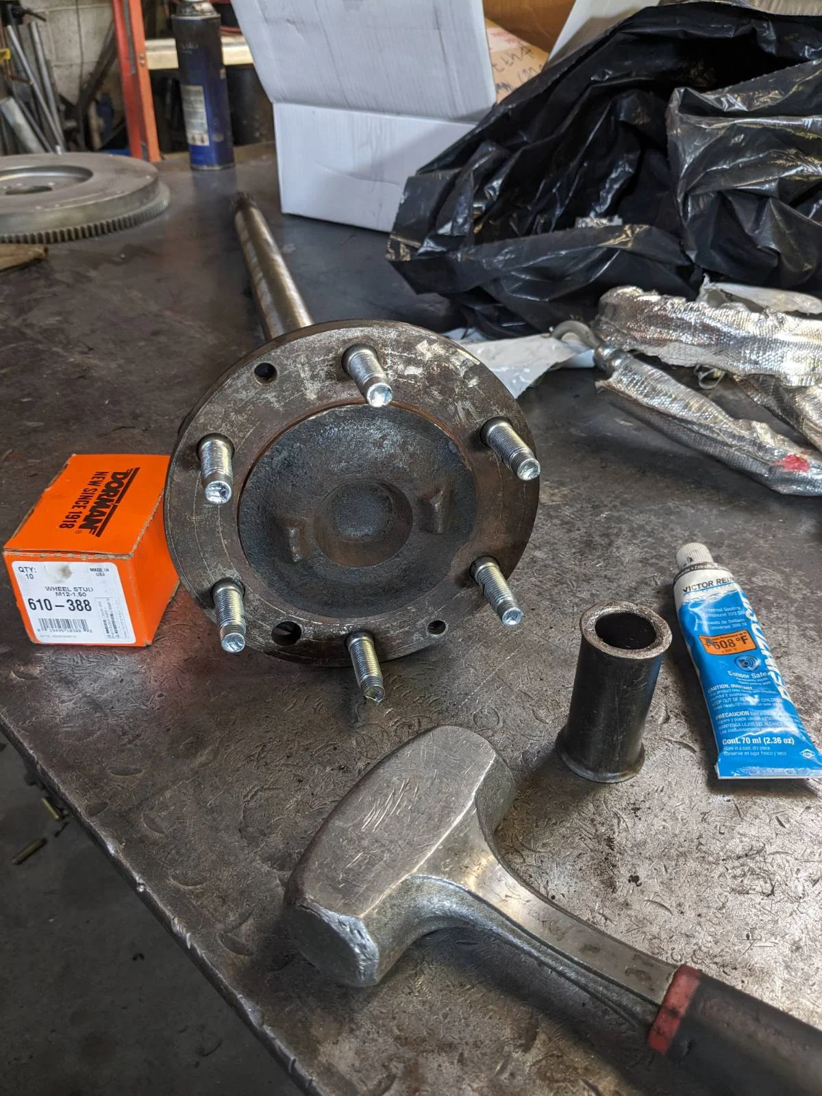

This put me in a bit of a bind. I had donor 10-spline and a 30-spline axles to swap in, but that obviously wasn't going to work. I thought I could keep the project moving by just replacing the studs. But this weird 16-spline axle takes larger-diameter-than-toyota studs.
All I wanted to do is sort out the leaking brakes, but now I have an axle mystery and no wheel studs.
I measured the diameter at the knurl of a toyota stud, and the knurled hole in the axle flange, and found the mystery axle needed studs with a knurl ~1mm larger. I then turned to the Dorman wheel stud catalog and found that the studs for a '93 '97 Mercury Cougar have the same m12x1.5 thread pitch as Toyota, and a knurl ~1mm larger. I ordered a set and hammered them in, so at least now I've undone the damage I did, while converting the studs to normal right-hand threads.
Mercury Cougar studs have the right thread pitch and diameter, but they are a bit long. Annoying but ok.
But all this raises the question, what the heck did I buy? A largely unmolested 1965 40, but with a 327 SBC, 3 on the floor, and a 16-spline axle? Could this have all been installed by the dealer when the 40 was new? If so, maybe that would change my plans. It's kind of a cool time capsule in that case.

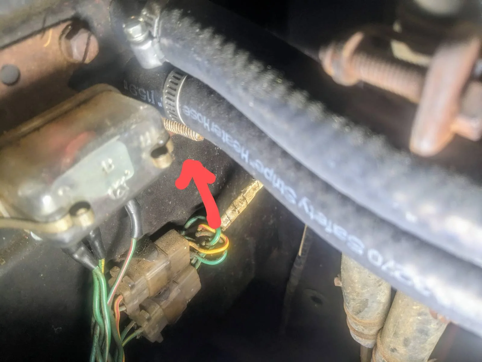

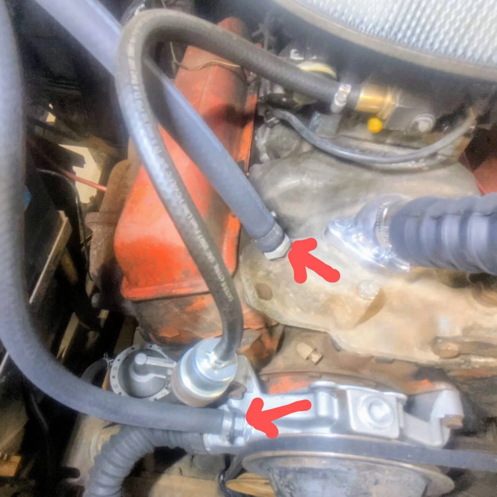

I see you have the Hupps or whatever heater. Can you please take a pic of the engine bay where that mounts? Trying to see if the holes would line up with what I have no so I wouldn’t have to drill holes.

I see one stud directly under the heater hoses on the firewall. I edited the pics above to show that.
The heater is securely mounted and doesn't rotate so i am guessing there is another stud or bolt on the interior side of the firewall. Not sure why nothing else is visible from the engine bay.
