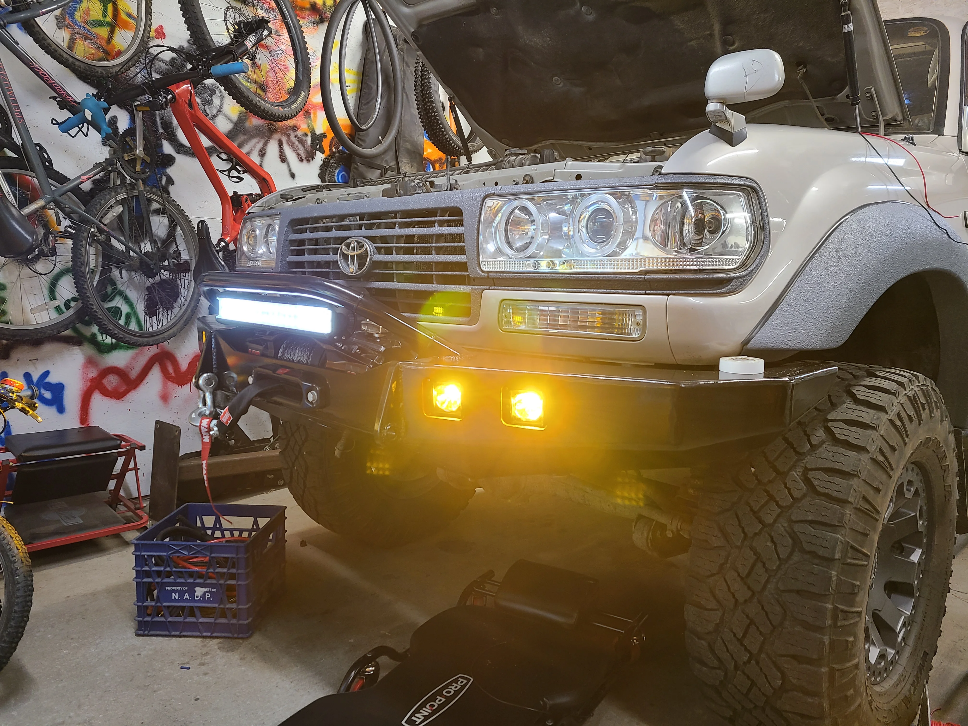

Thanks. I haven't done much with it the last few weeks, but I did get things hooked up. Winch and lights are mostly working. I've got the amber fogs lit up, but they also have white diodes. I've ordered a second switch so I can turn them on independently, but for now, this works.
full
Man, you’re giving me 80 envy. Seriously nice work on the bumper. Bet you could sell those as kits.
Thanks. The idea of selling it has been brought up before. Maybe after some other tweaks to the design I'll consider it. Anyone know if selling some pieces of cut metal as a diy kit carries any liability issues for the seller?
I don't see how anything could come back on you if all you're providing is a kit. That being said I'm some asshat out there has tried to rest blame on a kit builder at some point. The quality of the welds is on the end user and not you. Maybe there would be some "improper design" loophole but to me that's a stretch.
It is a nice-looking bumper. Good job!

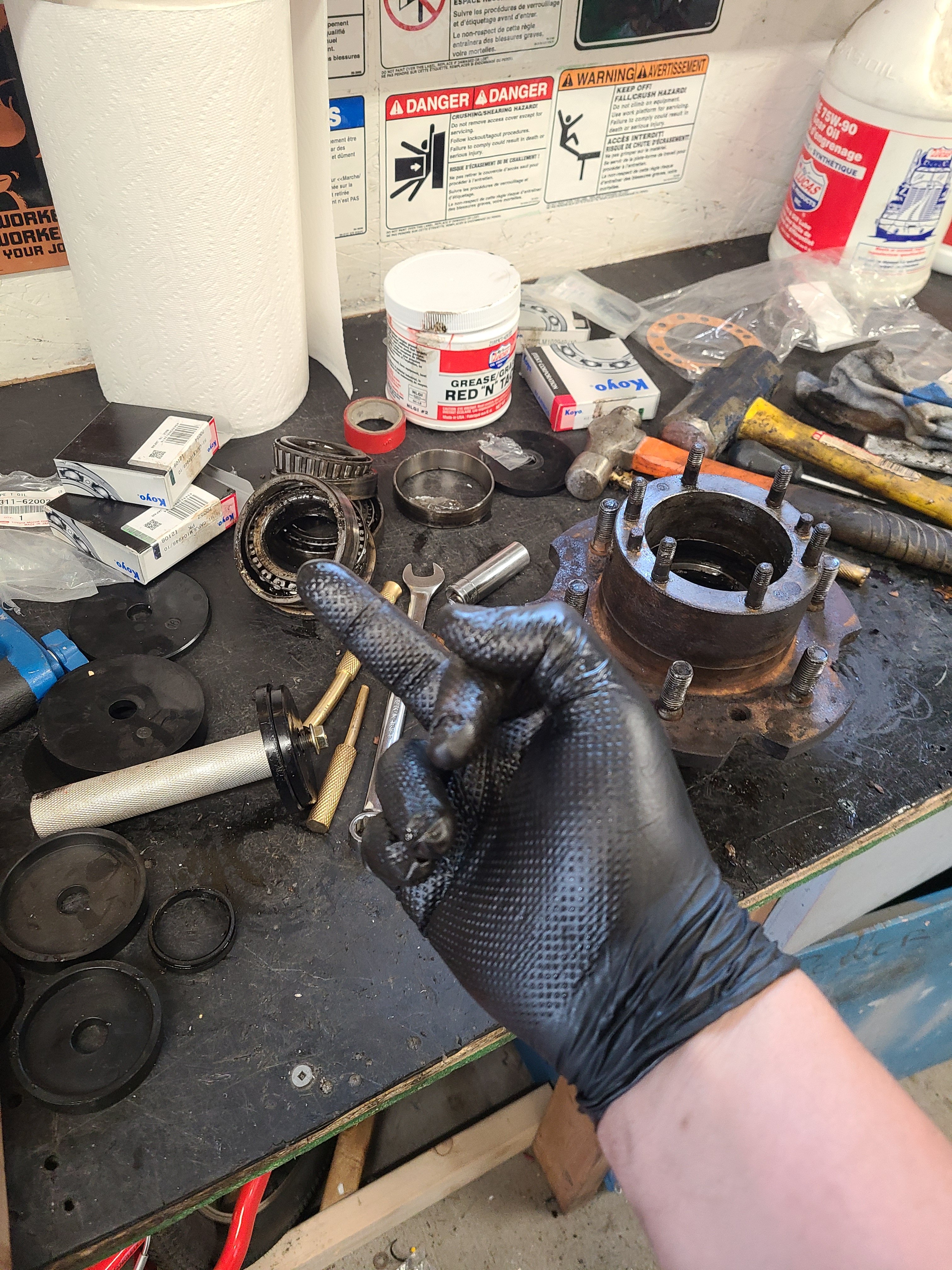

Finally did a job I kinda put off ever since buying the truck - rear hubs. I started noticing a bit of growl/whine from somewhere so thought it would be a good time to finally do this. Took a while, didn't fix the noise and the bearings honestly still looked fine. But, at least there's new diff oil, new grease, new seals in there
Worst part of the job was wrapping up the second side, admiring how nicely the second big seal went in, then seeing the bearing sitting on the bench. Can't get it out without wrecking it obviously, so bring on the 1 1/2hr drive to go both ways across town during rush hour to get a new one.
