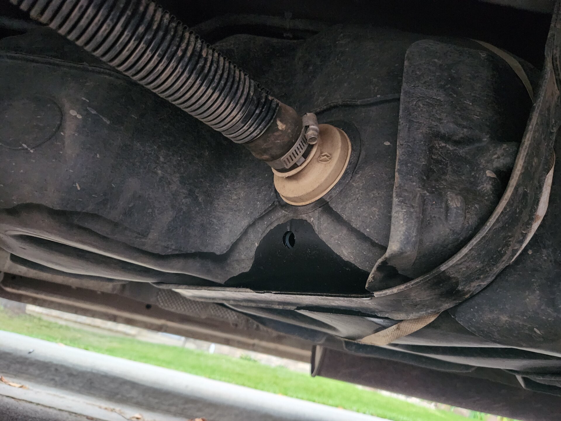

Not related to the truck, but another fine day for unexpectedly spending money. Went out to the van to go to work and found that some dirtbag cocksucker drilled a hole in my tank to steal gas. Got a brass plug with some ptfe sealant into it and that's holding for now, but not a long term fix. What a ****ing joke.

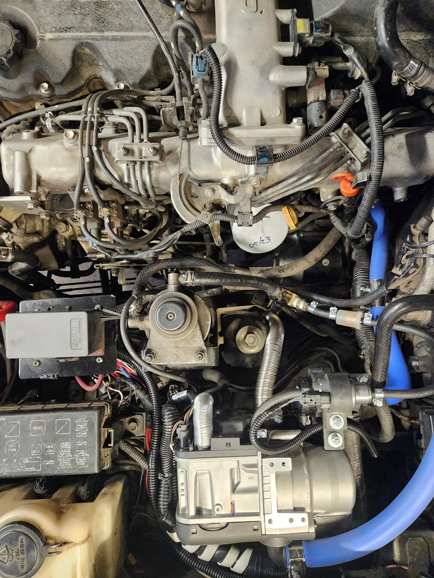

Took out my relay box holder thing.
Cut up the relay plate and made new mounts for it where the old 24v switchover relay was living.
Built a plate with mounting brackets for the heater.
All mounting plates this far (including the battery boxes) have been using factory threaded holes, by the way.
Picked up some 3/4" and 5/8" silicone heater hose, with 2x reducer fittings and one 3/4" 90 elbow.

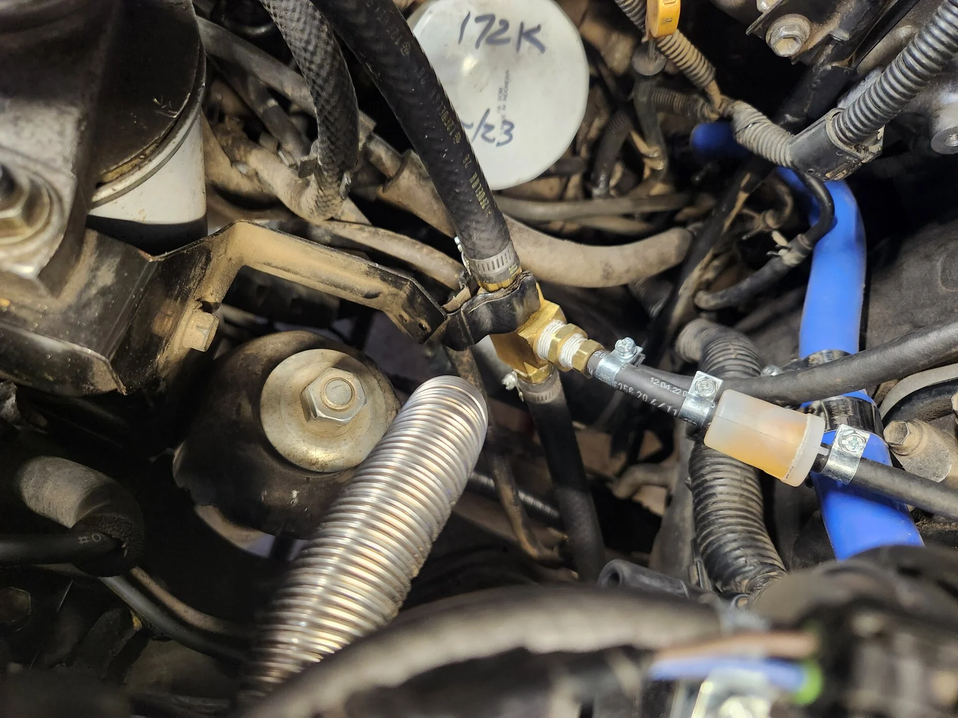

Used a brass T fitting with 1/2" barbed ends and a 3/16" reducer for the heater fuel tap off.
Built a little standoff to mount the fuel pump right to the heater bracket.

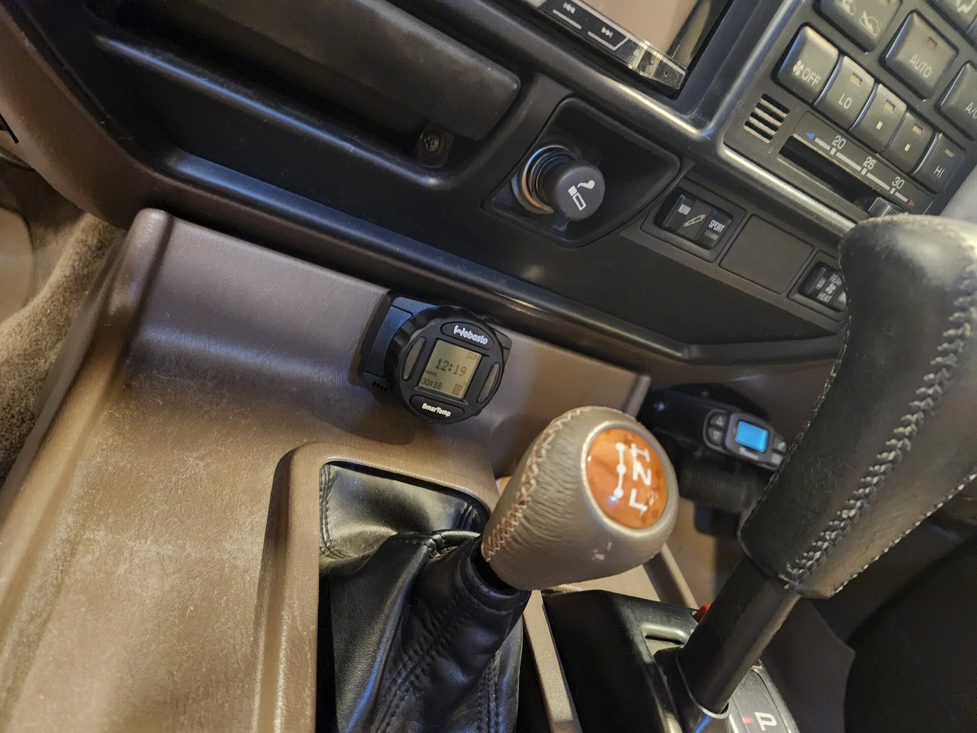

Mounted the controller behind the shifter with some 3m tape for now. I didn't want to commit to screws, this might just stay like this.

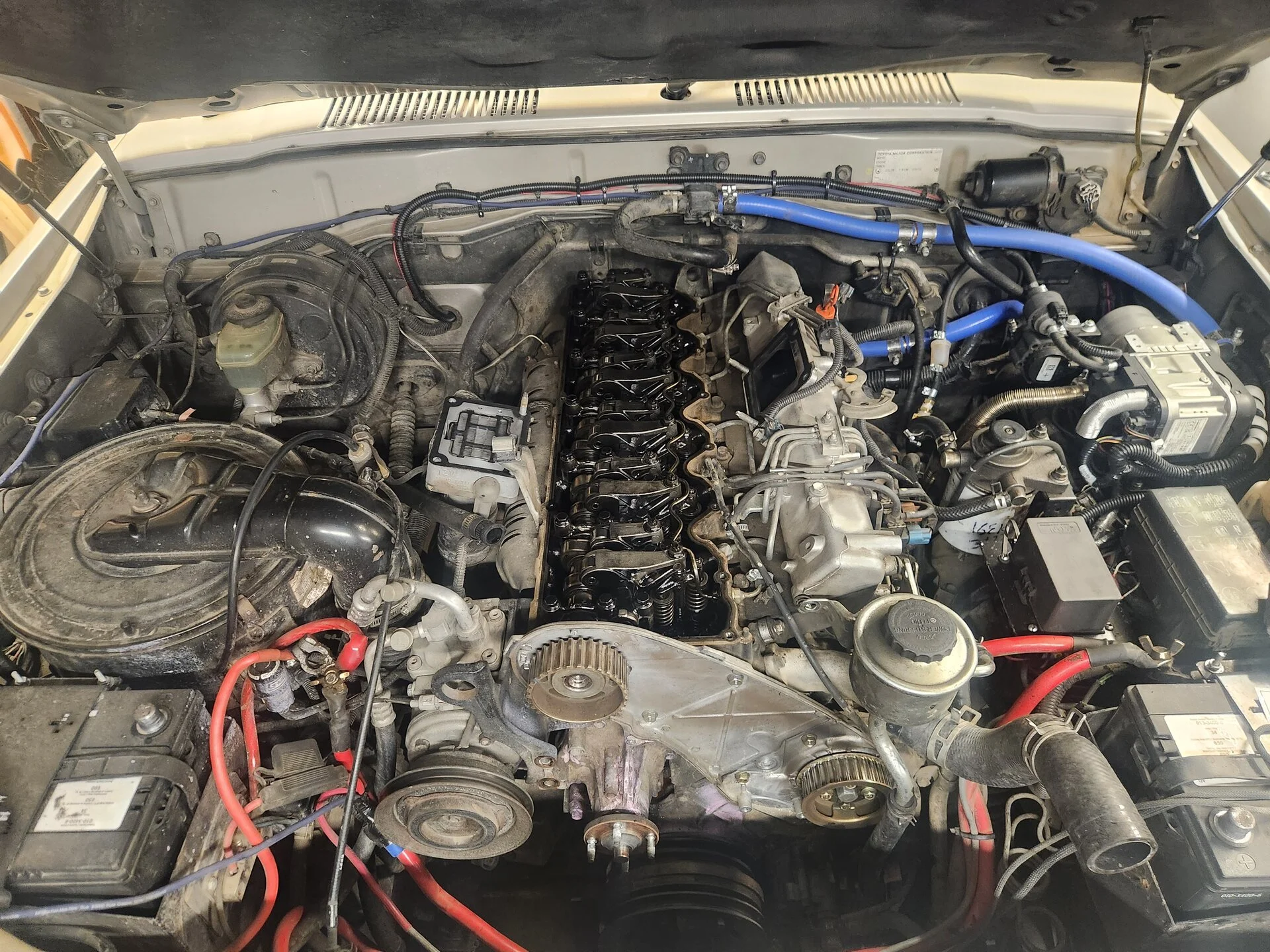

Measured up my valve clearances while the cover was off, and found they've all tightened up a bit. Some of my intake were at like 0.08mm (spec is 0.2mm), exhausts around 0.43mm (0.5mm). Either that just happens, or maybe I did something wrong when I did it 6 years ago. Went through the process again and buttoned it up. Seems to run nice, maybe a bit smoother? Will have to pay attention to it.

I didn't take many photos of this project, but here's one that shows stuff. And my valve measurements.

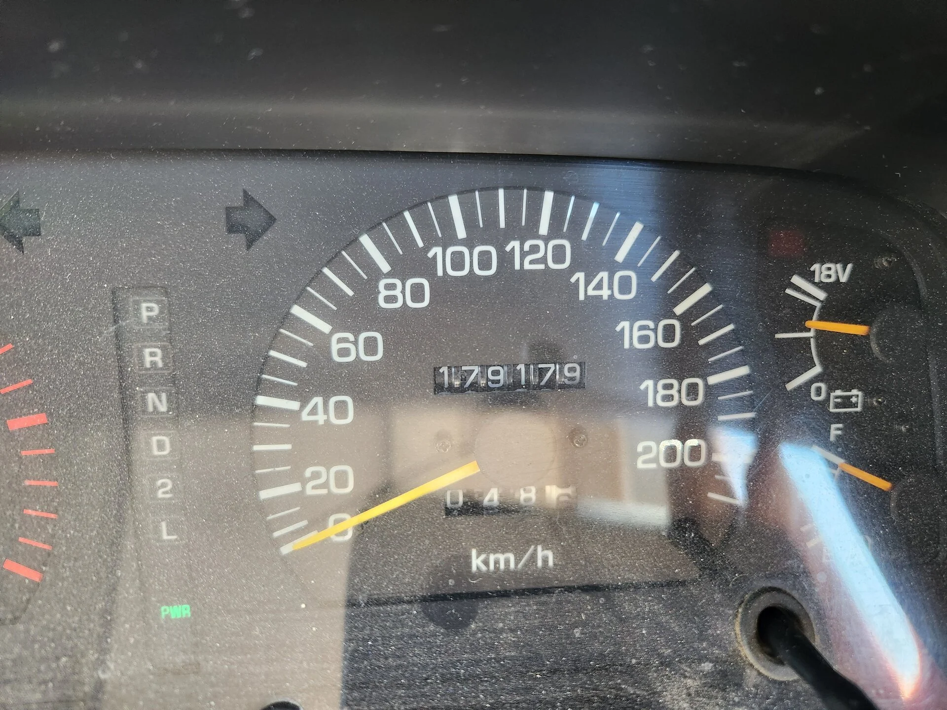

And I hit 179179 today. Wasn't trying to catch it or anything, just looked down and there it was.
