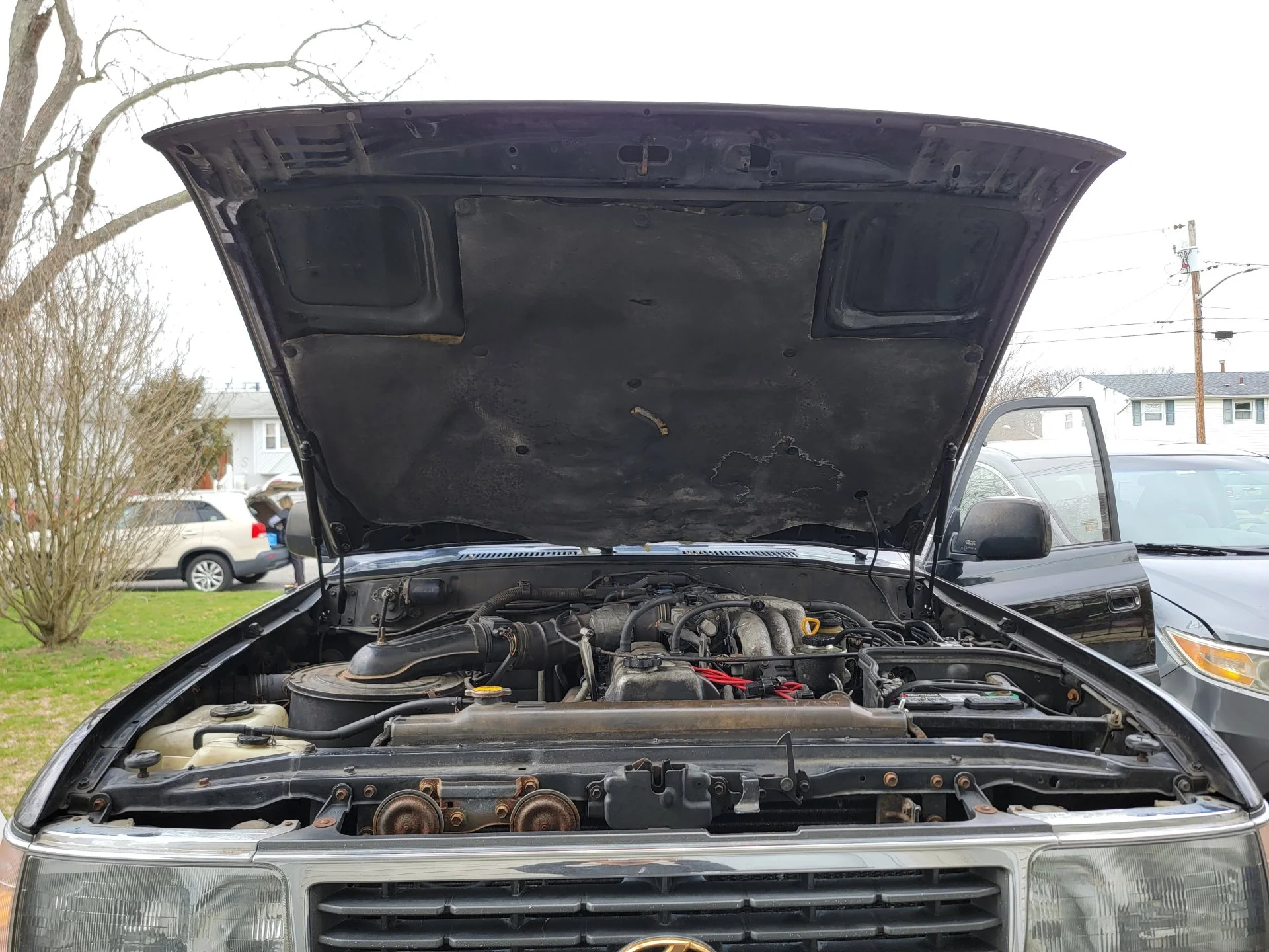

Maybe it's good to start with some of the symptoms I'm having now? I'll list them out below and then scout the many threads on here for similar issues that others have already posted and share it here for reference.
Issues
  • noticeable loss of power (resolved with EGR)
  • squeaky noise when shifting between PRND gears
  • transfer case shift lever vibrates slightly during idle and gets more intense as I accelerate; main shifter vibrates to but more subtle
  • sometimes when letting off the gas pedal, the car would slightly veer to either side; not consistently
  • I can smell fuel vapors around the hood or underneath after exiting the vehicle
  • observed fuel leaking from the tank if I fill up > 90%
  • P0401 CEL (fixed 4/12/22)
  • bubbly rust on several parts of the body
  • quick vibration around the front passenger side of the body for a second when accelerating from a complete stop (bad engine/body mounts)
  • heat shields on both catalytic converters came off
  • wind noise coming either from front door or windshield when driving > 40mph
  • loose sun visors on both sides
  • large dent at the center of the front bumper
  • vibration on passenger side, noticeable on side view mirror. it goes away when I turn the steering wheel to the right or left

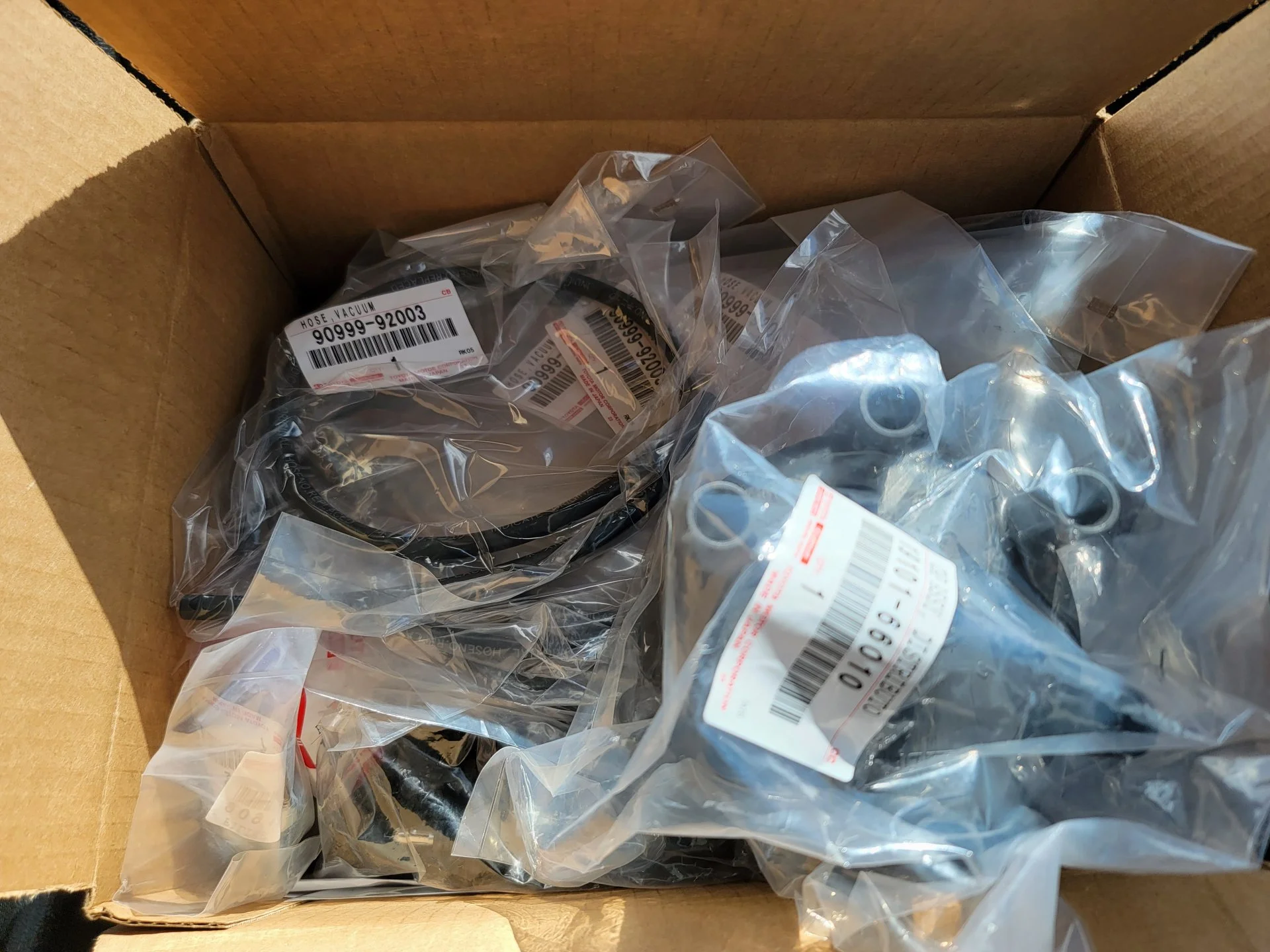

I've purchased a few parts last week and they're probably going to take a while to arrive.

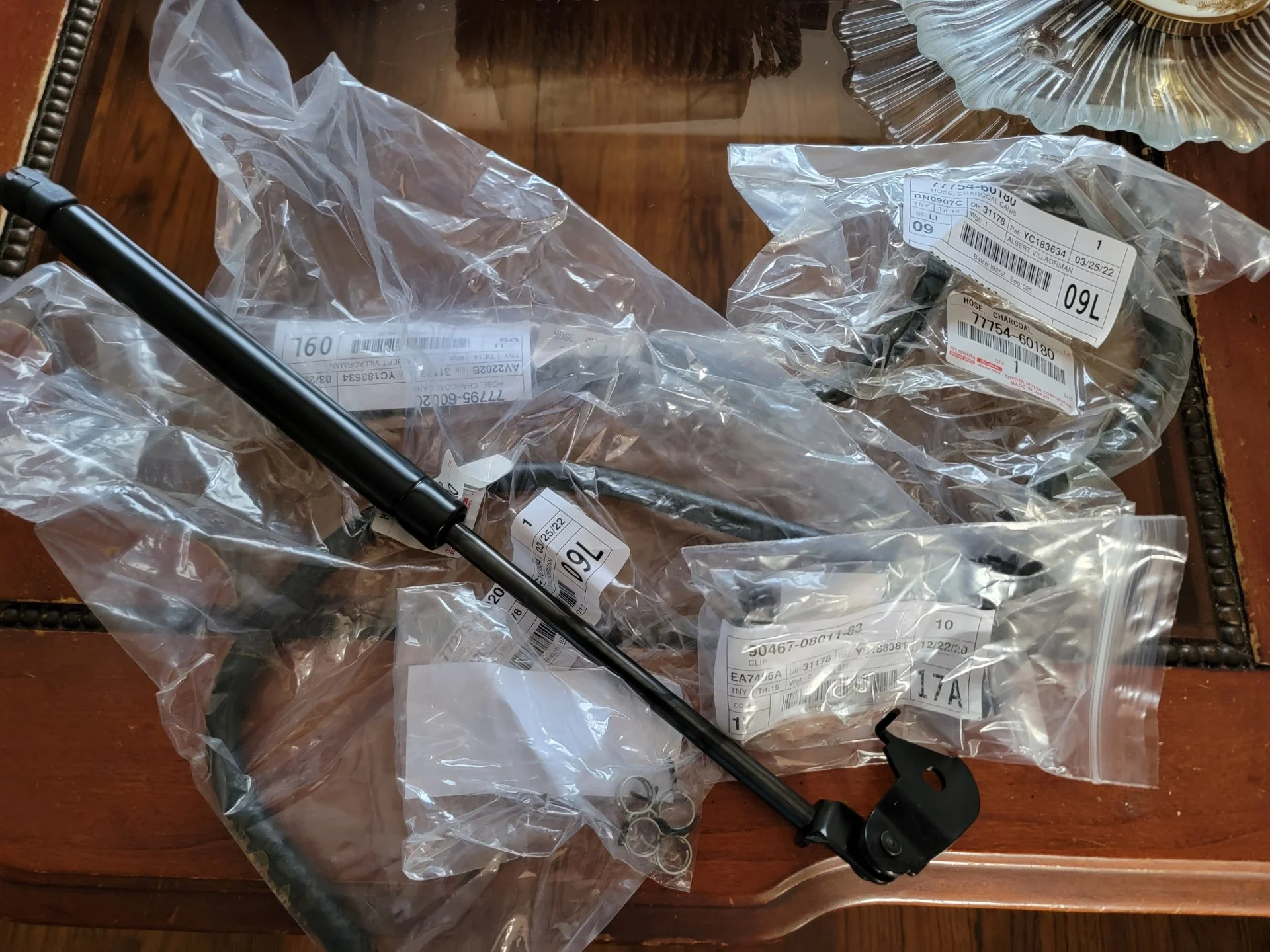

I'm going to be inspecting the charcoal canister today to see if it's clogged. Then replace the old hoses with OEM parts when I put it back. The hood fell on my head earlier this week so I went ahead and got replacement struts for it. I also have a rubber strip dangling on the front of the hood, so a new set of clips should fix that.
the hood opens up by itself now. I have a bit more confidence that it won't fall and hit me on the head. One bolt was stripped when I took it out so I had to wait until Tuesday to pick a replacement at the closest Lexus dealership. I picked up a new intake filter so I'll replace it once I replace the valve cover gasket and other parts that I'll be removing to get to it.
Next up will be to remove the charcoal canister and inspect it for any clogs and then replace the vacuum lines that go out from it. I'm thinking of just removing the bolts that connect the bracket to the body because the last time I tried to remove the canister itself, the fuse box is in the way and I can't pull it out entirely. Does that sound like the better way to go?

I just got a notification from wits end that he shipped the order today. I have the pcv valve kit, valve cover replacement, vacuum hoses on the way.

I just received my order from @NLXTACY the mailman dropped it off at the next door neighbors house. I only found out it was my package when he marked my package as delivered when he handed me just my letters and no package.

So I didn't get a chance to do anything to the car this past weekend except for installing the new gas filter and connecting a vacuum hose to the corresponding port.
This afternoon I decided to take a look at the egr modulator and the egr valve and it looks like the line going out from the egr valve to the vsv is going directly to the upper intake chamber. Does that look right or is it really supposed to go into that port and the other side of that metal tube goes to the vsv underneath?
