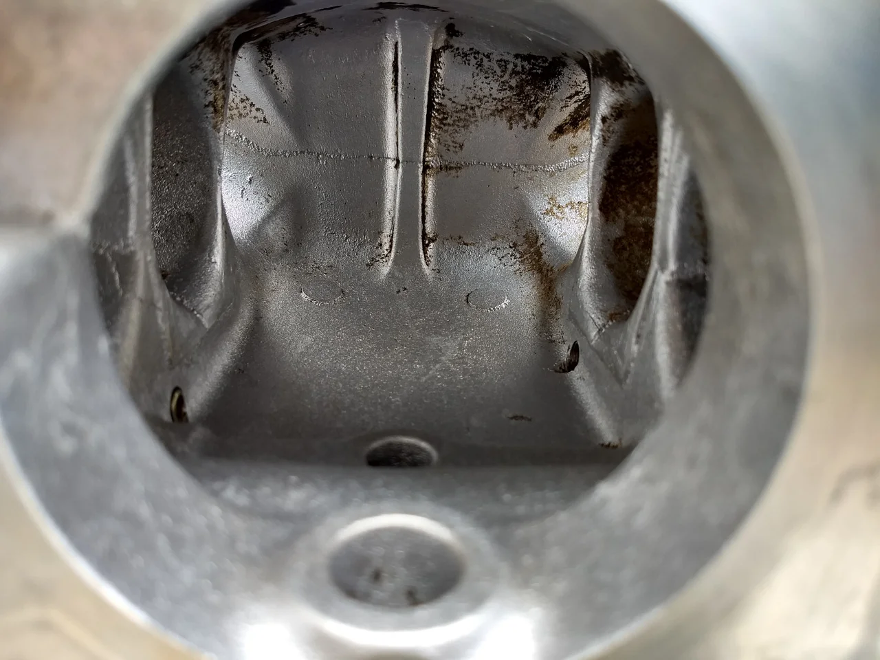

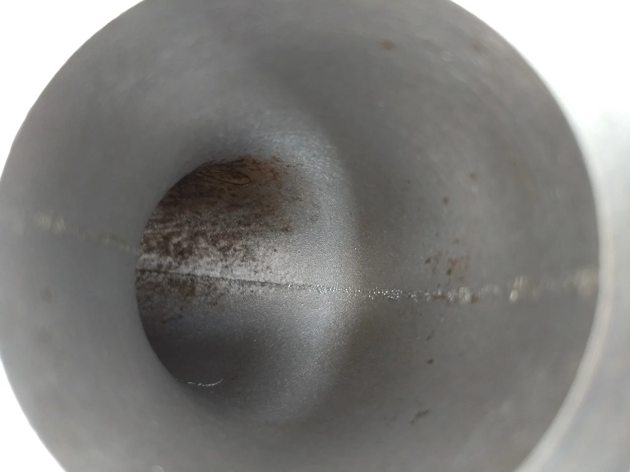

I did the Simple Green soak, too. Put a plastic tub in the bathtub, dumped in a gallon of Simple Green, and added enough hot water to submerge the intake manifold.
It probably soaked for around four hours in total. Every hour or so, I'd check on it and scrub it with a nylon brush. If you want to get really thorough, you might buy one of those bottle brushes to get way down in there. Guitar strings can help clear out those small passages.
I don't have a 'before' photo of the upper intake, but this should give you an idea of how bad it was:
After:
Anyway, I think the risk of Simple Green to the intake is overstated. I wouldn't spray it on a raw, polished, aluminum wheel and leave it, but I wouldn't be worried about using it to remove carbon.

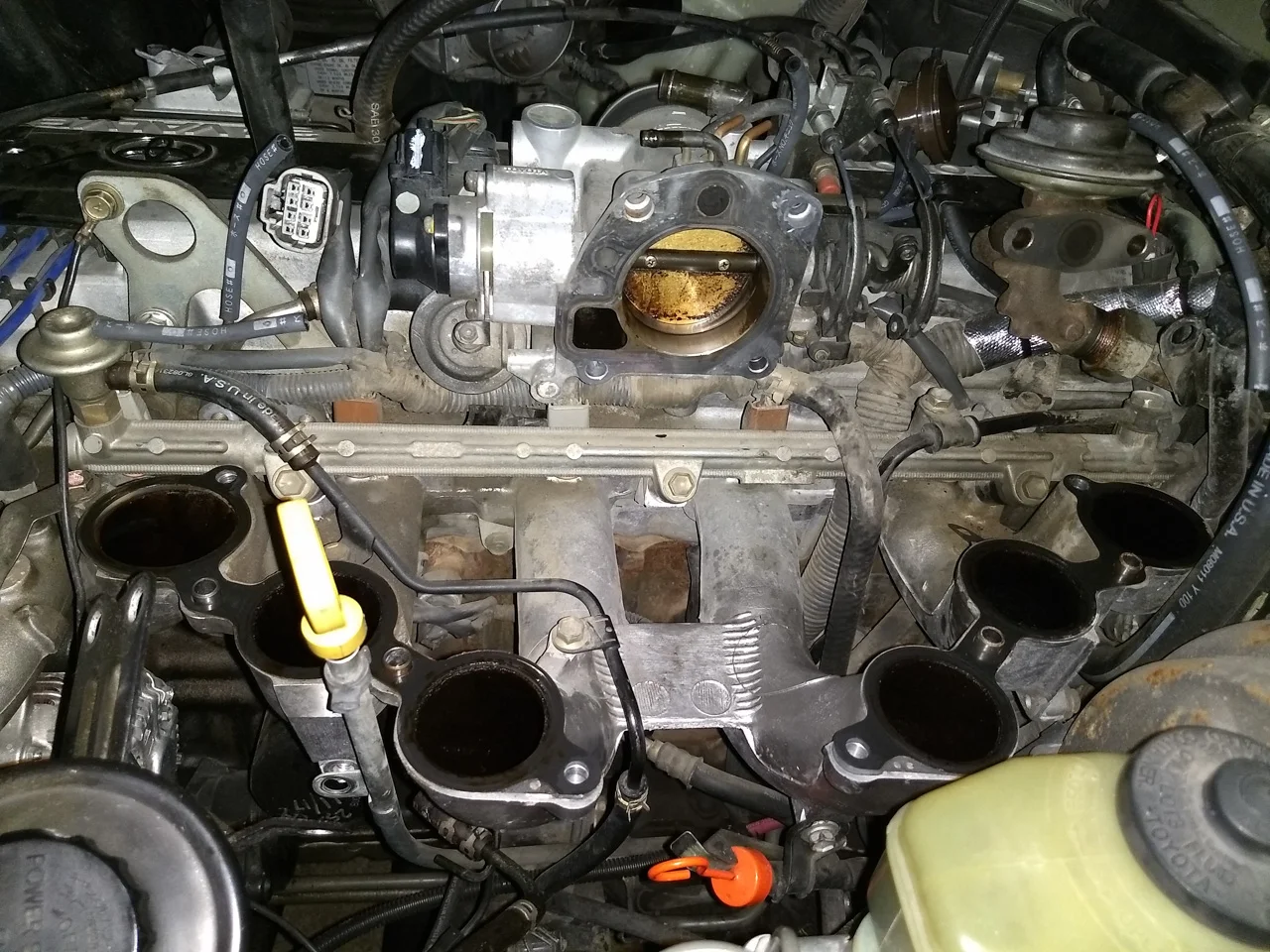

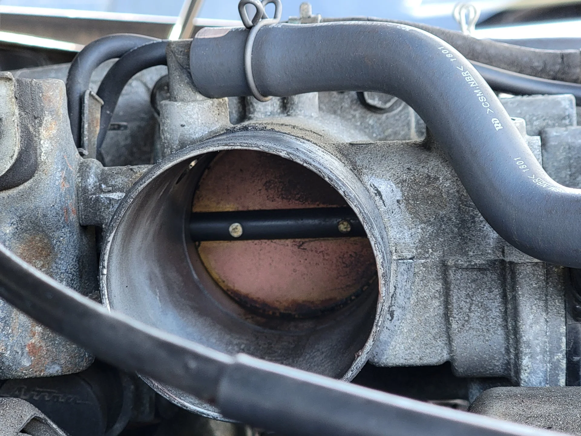

Throttle body cleaner will not be enough for the upper intake manifold. Even soaking it in simple green wasn’t enough for me, had to pressure wash it afterwards to get the 25 years of carbon buildup off.
as for the throttle body… simple green spray, throttle body cleaner and a brush were enough for mine, yours could be worse though.
ok I will post pictures on a different weekend

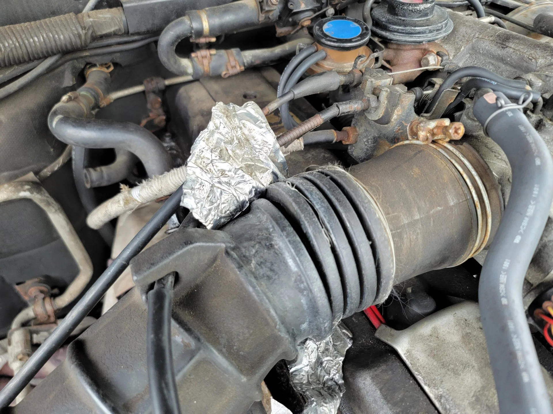

so I'm still holding off on the big job involving replacing the valve cover gasket but today I tried to just replace the air intake filter and found that the intake tube portion connecting to the throttle bodh has split apart and has just been kept together by duct tape by the previous mechanic.
I went ahead and changed the filter and cleaned the throttle body with the throttle body and intake cleaner. I noticed that some of the liquid spilled down to the valve cover so I went ahead and placed a Terry cloth underneath the lip to catch any more liquid spilling over. I took note of that because could this affect the spark plugs? it has dried off quickly like brake cleaner so idk if it would have any effect.
I ordered a replacement intake tube with clamps from lexus so that should arrive soon, but I wanted to reuse the current one for the time being. I taped it back up with aluminum foil tape because I didn't have any duct tape on me atm. When I replaced the tube, I noticed that inside the tape, I kinda have a feeling that it fell off. I just wrapped more tape around it.
After closing up everything, I tried starting the car but it would just crank and not idle. Is the bad intake tube the culprit? the throttle body cleaner overspray that spilled onto the valve cover and dried up quickly culprit? I also noticed that the locking mechanism for the MAF sensor plug is gone so I just tried to push that in as much as I could. Could it actually not have been plugged in all the way?
That intake tube is rough. Unless you disconnected vacuum lines, electrical connectors, or something else I bet the intake tube is the likely culprit. Doesn’t look like you have a great seal there.
Your throttle cable looks pretty well ****ed too. That could be an issue now and definitely in the future.
Your throttle cable looks pretty well f***ed too. That could be an issue now and definitely in the future.
yeah I have new tube and clamps coming in hopefully this week. as soon as I took off the air filter cover, the tube started falling off... it's stiff now too. is the throttle that long cable that goes from the passenger all the way around to the driver side?
Are you disconnecting the intake tube from the air filter cover before trying to lift the air filter cover? Well, I suppose you sort of disconnect it as you lift the cover. The point being that you shouldn't try to bend the intake hose back in order to reach the air filter, like you can do on some vehicles.
I first loosened the clamp close to the throttle body. The clamp to the air filter was missing already. As I was loosening the nut, the tube started to fall off the duct tape wrap. I kept the tube mounted to the filter cover.
When replacing it after cleaning the throttle body and swapping the filter with a new one, I first taped the two split tubes together while keeping it connected to the filter cover. then I first aligned the retaped tube to the throttle body then as I tried to squeeze the tube as I fit the bolt through the opening in the filter cover, I noticed that the crack probably split open underneath the new aluminum tape.
I didnt bother to retape it because I could just install the new one I ordered at a different day.
I tried to start the car but it would just crank and not turnover. I guessed that tube is not sealed properly even though it's covered in tape.
So I got a little impatient and replaced the aluminum tape with duct tape and verified that the gap between the tube was the culprit. It turned over and can idle now. The air intake tube still hasn't arrived at the dealer yet as expected. I sure hope it arrives by Saturday because it's going to the shop for its first undercoating service with woolwax/fluid film. I just don't have the time to do it myself.
