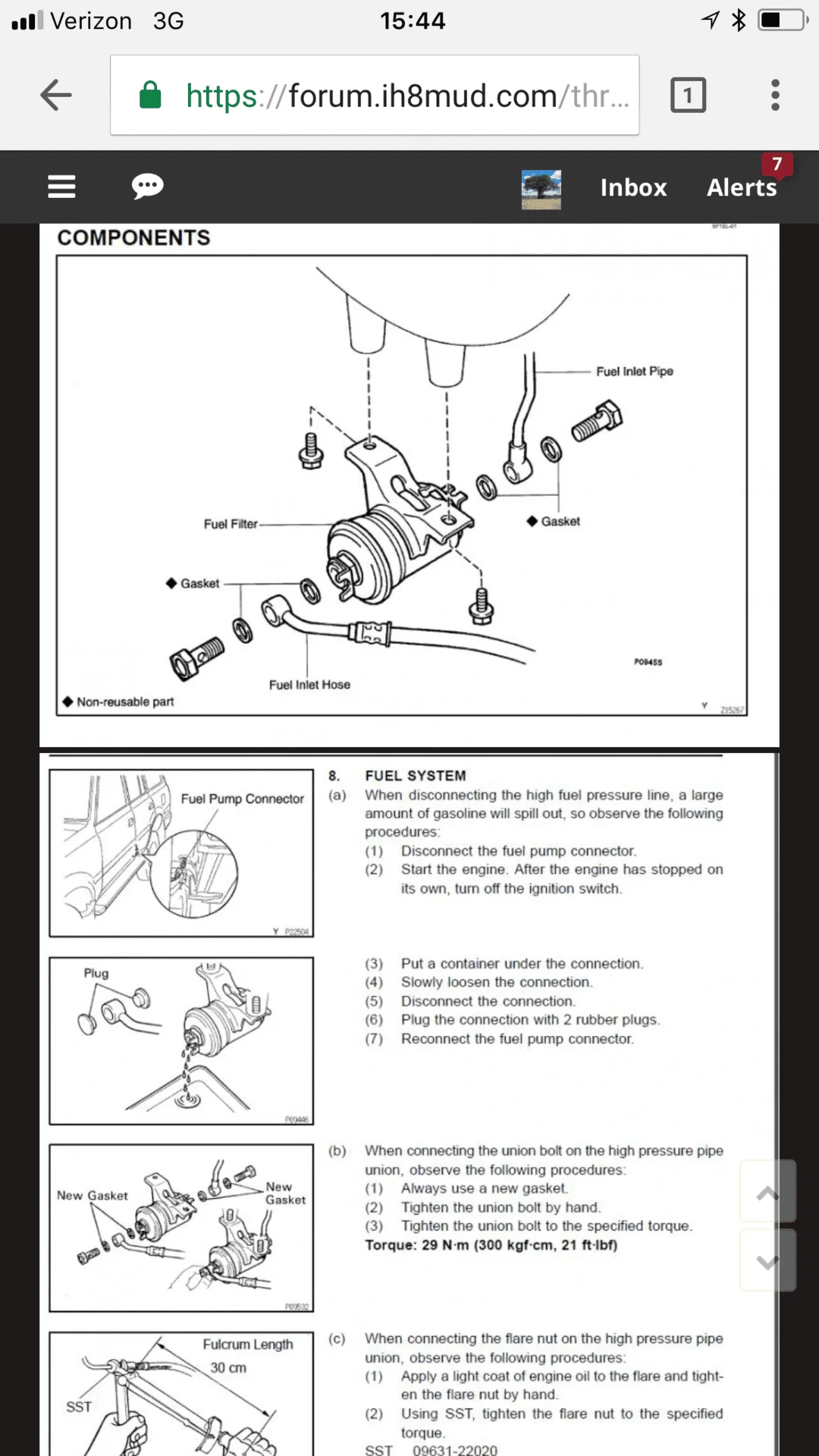

So, I’d just like to verify that this is in fact the fuel filter...
This is part of one of the threads I’m looking at...
So, two things...
(1) is that photo indeed the fuel filter that says “China” on it (might not be able to see China in the photo, but it’s printed under the arrow)?
(2) any tips for a newbie doing this for the first time (I’ve of course read the FSM procedure, so I’m looking for helpful tips beyond that).

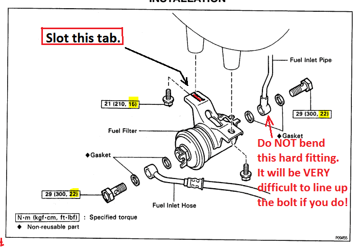

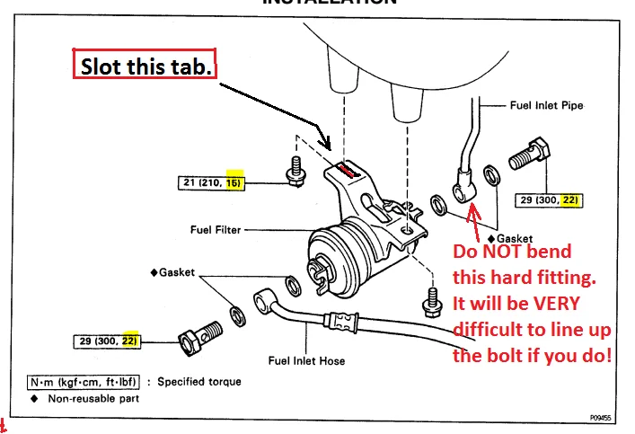

And be careful not to break your #2 knock sensor. Seriously, remove the knock sensor because you will break it. It’s right there and ready to be broken.
It’s not a horrible job. And definitely easier with notching the one side tab (it’ll be obvious why).
Oh, and don’t smoke! Or run a LP heater when doing it. You will spill gas...
It might seem obvious...but do NOT loosen the mounting bolts on the filter until you have first loosened the Union Bolts though the banjo fittings.
Also, guard against bending the ridged fuel line at the rear of the fuel filter. It will make lining up the union bolt difficult if you do.
Lastly, IF you don't have long, skinny, double jointed arms....get some extra crush washers, because you will be dropping some (as I did) and it seems they ALWAYS go to the nether-regions of the engine/transmission and NEVER hit the floor where you might find them.
