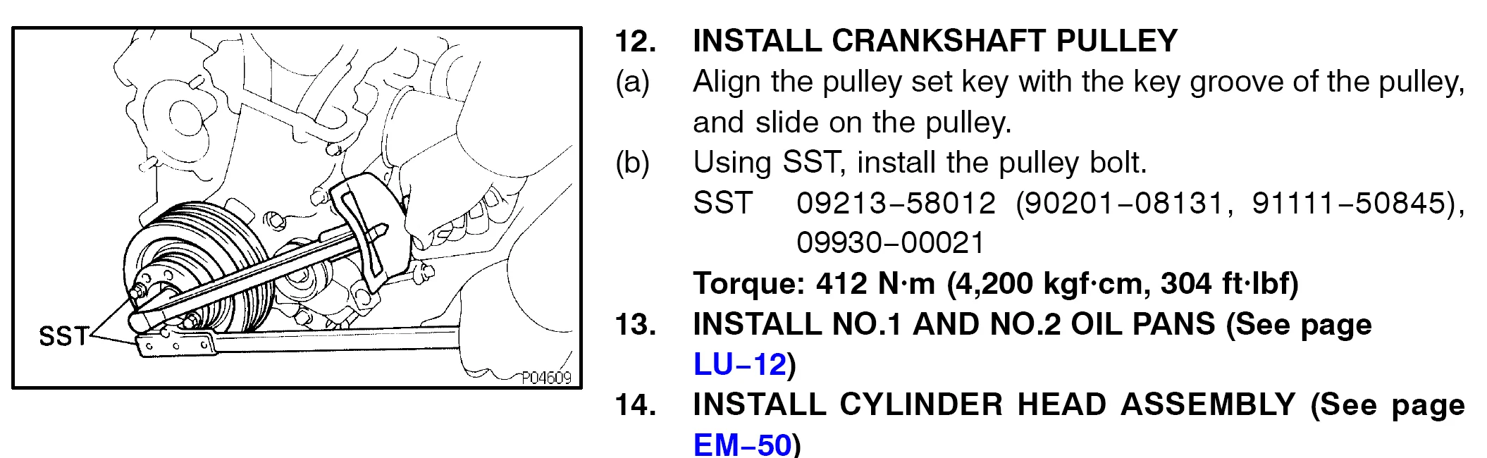

I was searching for why the crank bolt needs such high torque, which I knew but didn't know why (because the oil pump gear is not keyed), I came across another thread about not enough torque was applied to tighten the crankshaft pulley after fixing a leak, causing the oil pump to fail.
The dude in the picture is only using one arm! 💪
I'm always amused at that page. And the one before it taking the bolt off.

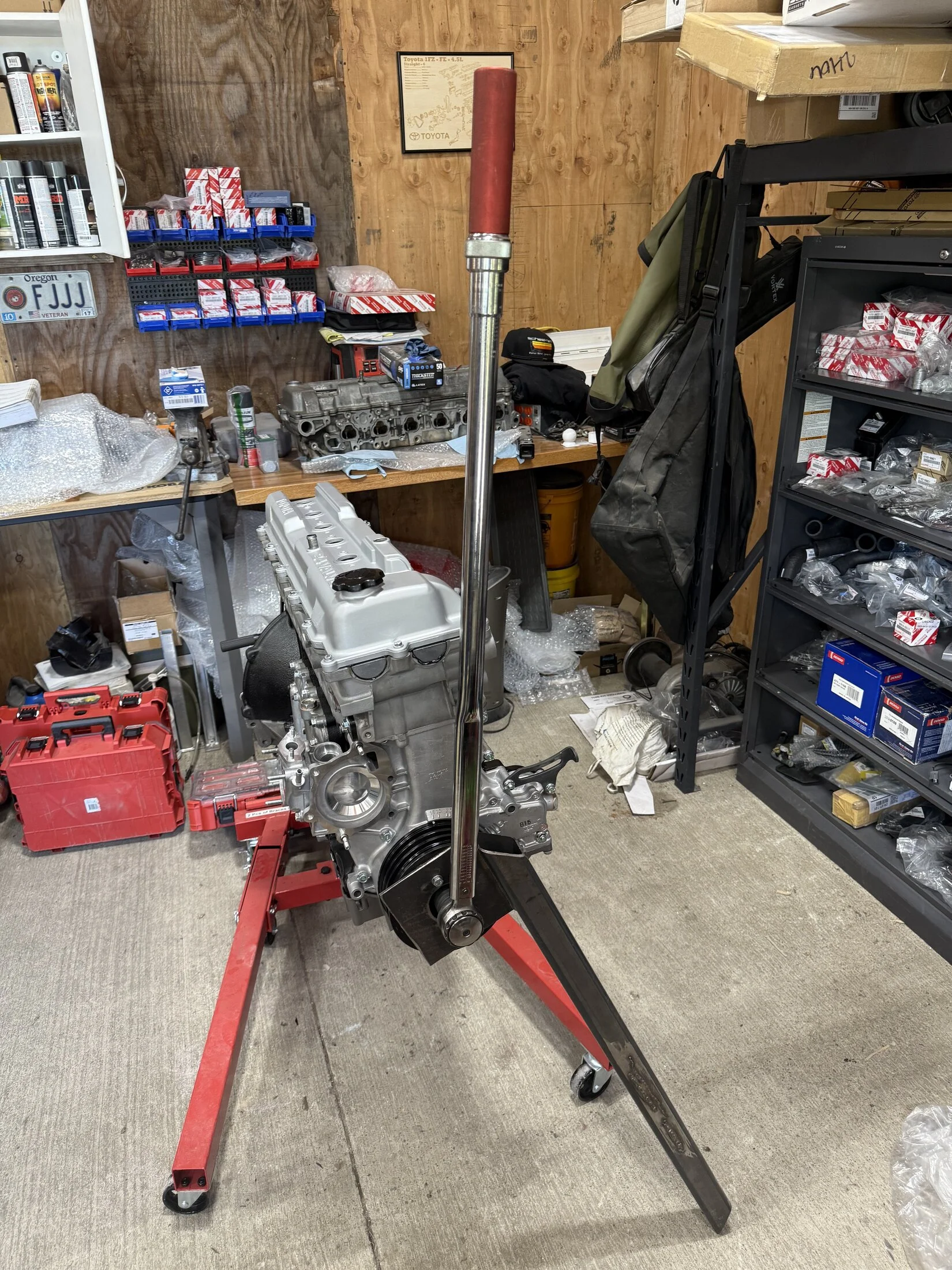

I can't imagine what 304 ft lbs of effort feels like.
I should have asked the guy who did my crank seal, a former mechanic for the local Toyota dealer who now works out of his own garage, how he accomplished this.
All I can recall is that he made a point of telling me "It's not coming loose".

I ended up using a 300+lb torque wrench and a 6ft pipe to tighten that darn nut... My FIL who was in Army aviation watched and provided commentary... He said, "that thing is the 80's Jesus nut"... lol.
