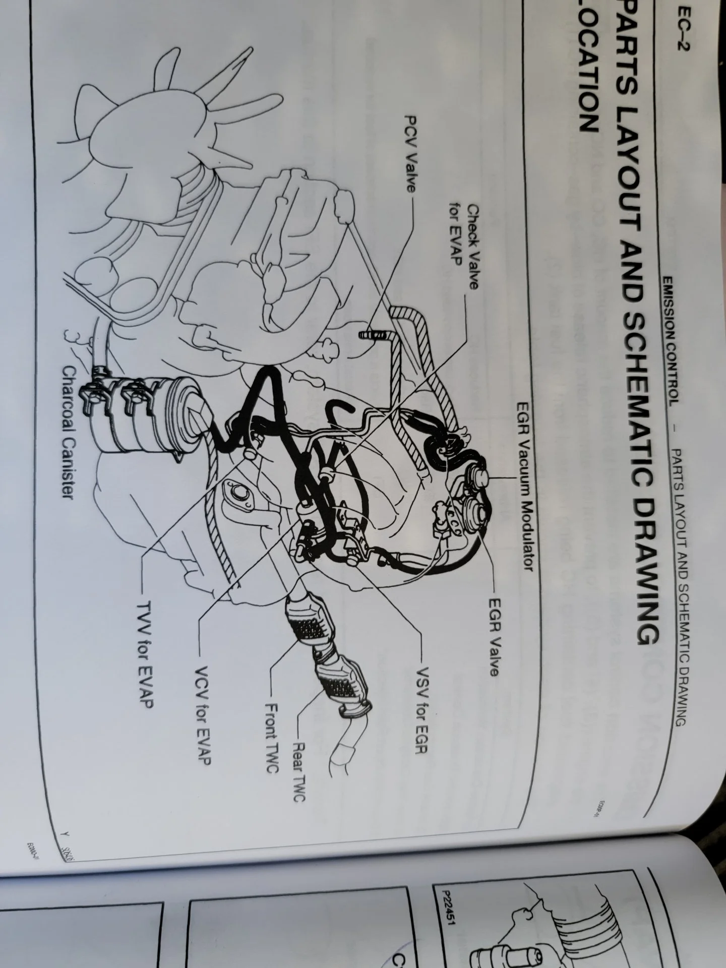

here is the chart from fsm
so I looked more inside and found that the other vsv it's connected to is the one for egr right? maybe they connected it to a new vsv because that one that's still connected to the upper intake chamber is dead!?

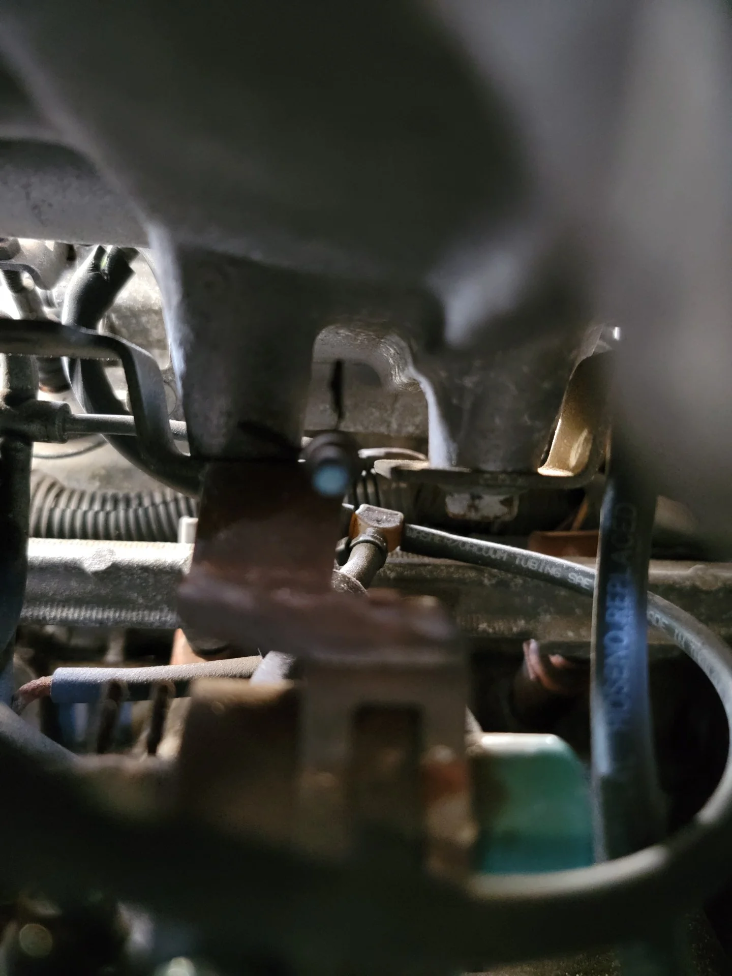

ok so I reconnected the vacuum line from that metal pipe to the new VSV. I followed the other tube from the vsv to a T connector and the one leading to the intake had a crack. I tried to cut the tip but it's too loose to get back in the port. What size is that because the hose is a bit thicker than the one that came in the vacuum kit.

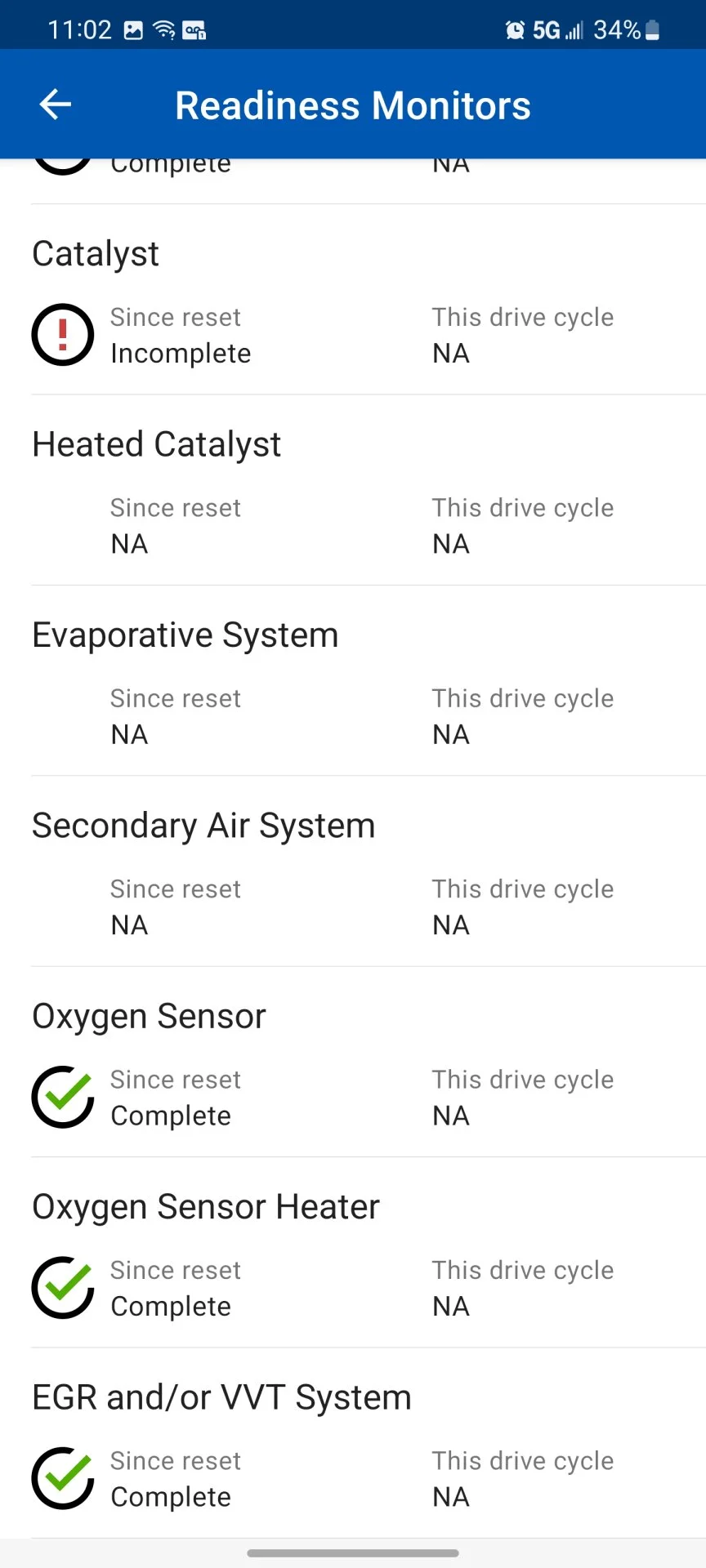

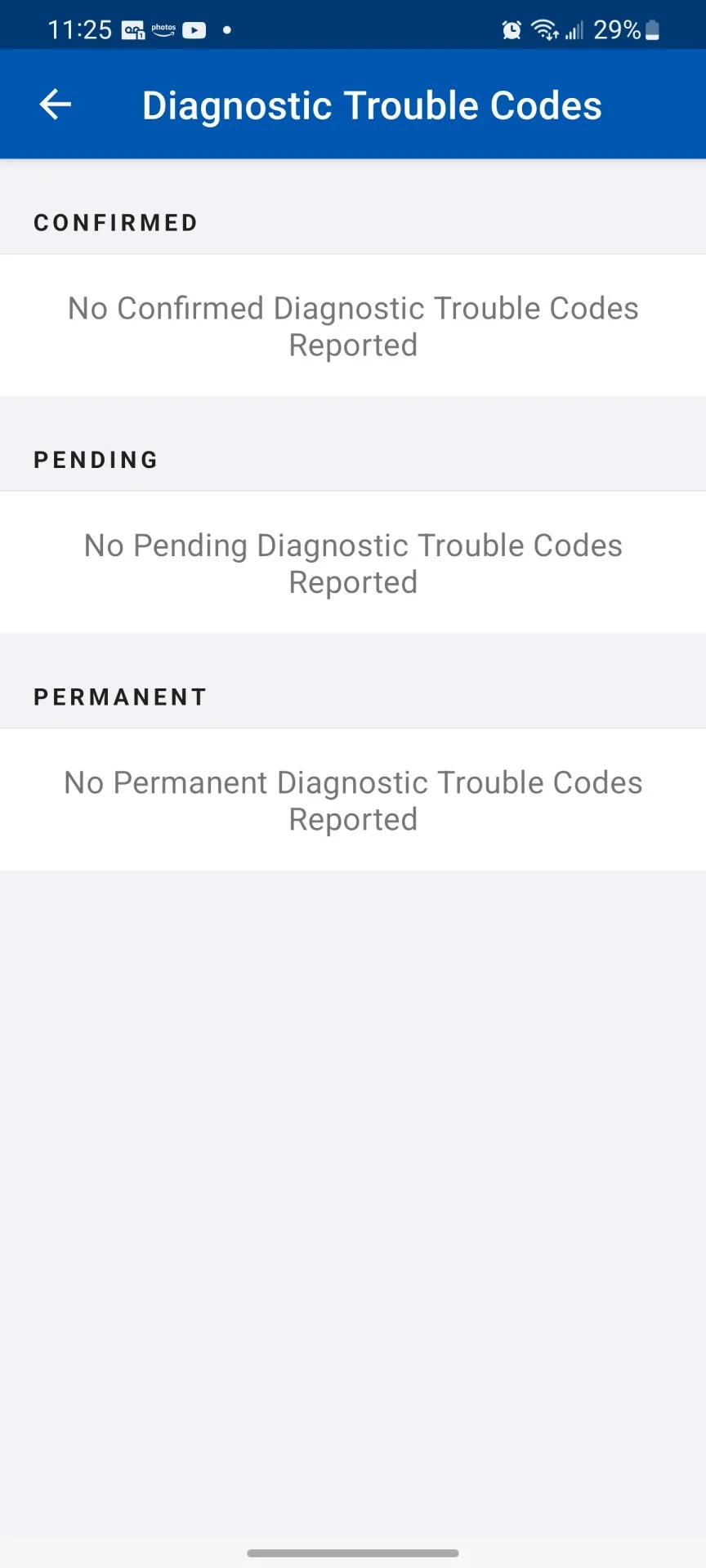

All right so after connecting the vacuum from egr valve to the VSV, confirming that the other line from VSV connects to a T connector, and replaced the cracked hose connecting from T connector back to the Intake, I don't see CEL so far after 3 trips.
It is still a bit janky because I couldnt reach into the T all the way in without removing the throttle body (which I will still do when i replace the valve cover gasket next weekend?). So what I did was cut off the tip of the cracked hose so there's no leak, and join that with a new vacuum hose from autozone (5.5mm) and it fits to the intake fine.

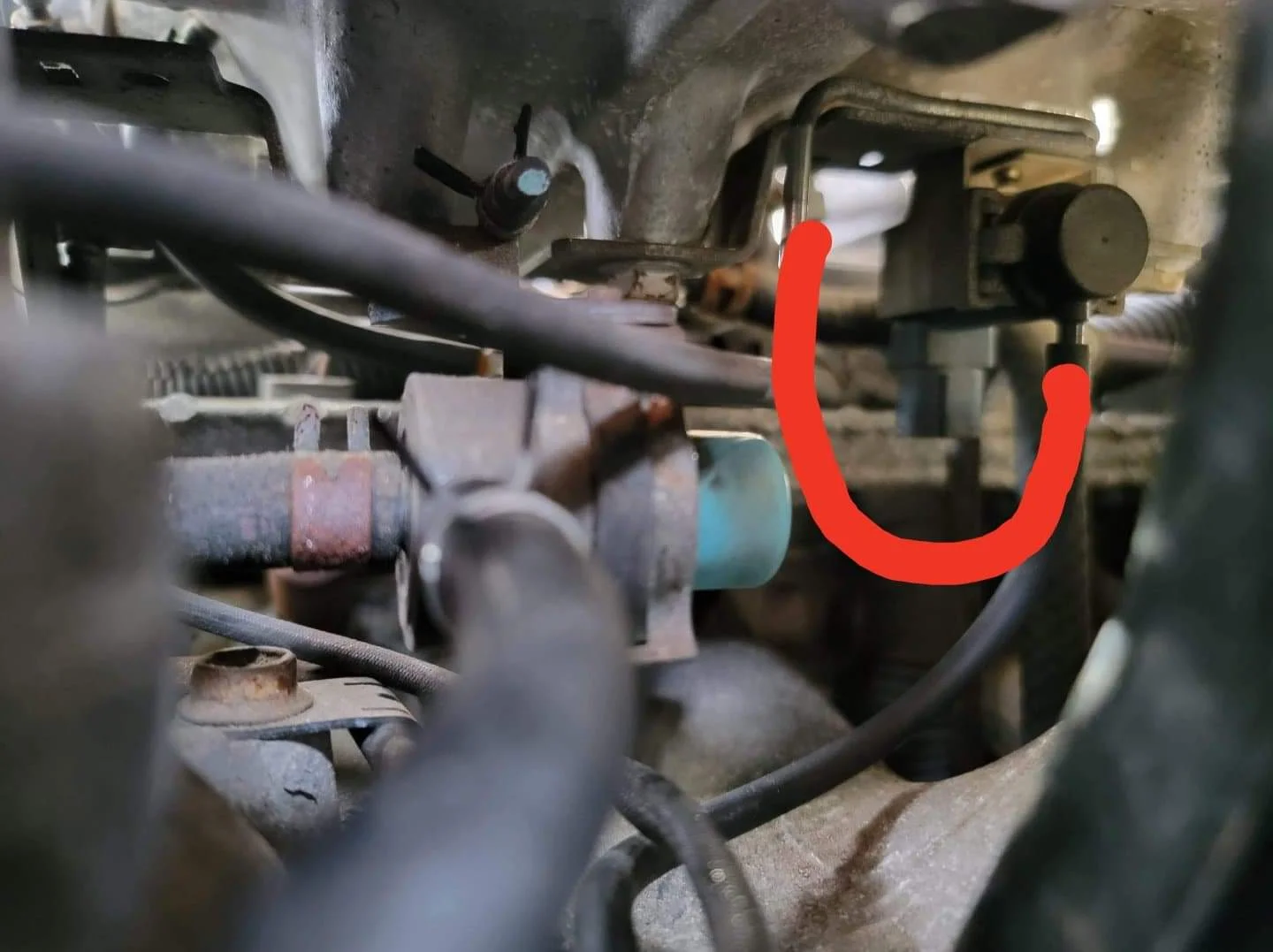

I was really curious after work as to what could have been causing the EGR issue since the modulator is working fine and the egr valve is newly replaced and VSV that the mechanic took out dangling is working. I took a peek inside the manifold and found that this new VSV was connected to the old VSV that failed. Then I noticed that there was still a tube connecting from there to the new one which didn't make sense.
So after reviewing where the lines went from egr valve to vsv, I figured I might as well do a quick reroute underneath and see if that would resolve the issue. Now that it's resolved, I at least know what the problem was and hopefully I have time this coming weekend to remove the upper intake, clean it, then remove the dead VSV still mounted to it.
I'm still thinking whether I should mount the new VSV to the intake or move it to a more convenient location like near the modulator and egr valve sort of like how the camry does it?

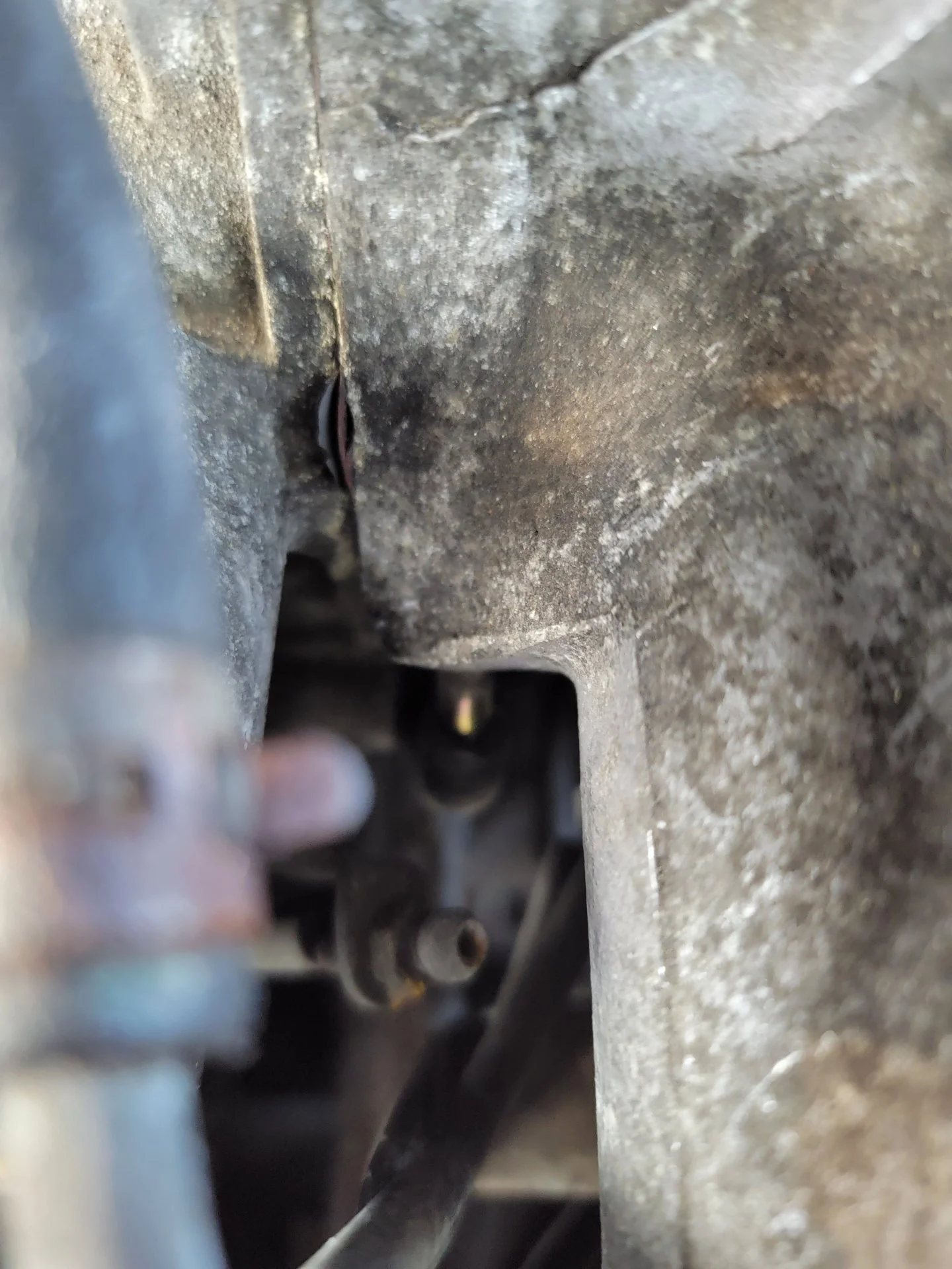

I'm about to go to the supermarket for grocery shopping and just wanted to look underneath and took a video of what the muffler sounds like right now. I noticed that there is a stain on the rear end of the muffler where it connects to the tail pipe? I also noticed stain on the rear differential where it connects to the drive shaft.
welp, I found the leak on the muffler and was about to clean off the rust before I put the tiger patch tape and it felt like of I put just a bit more pressure, I would end up with a bigger hole in the muffler.
I checked the lexus parts near me and it looks like they have it available for 425$
The wetness appears to be from the rear pinion seal. Check the breather on the rear axle to see if it's functioning. Push/pull on the driveshaft (side to side) near the rear diff to check for axial play (should be none). IME, you may be able to just replace the rear pinion seal if nothing else is causing the leak.
