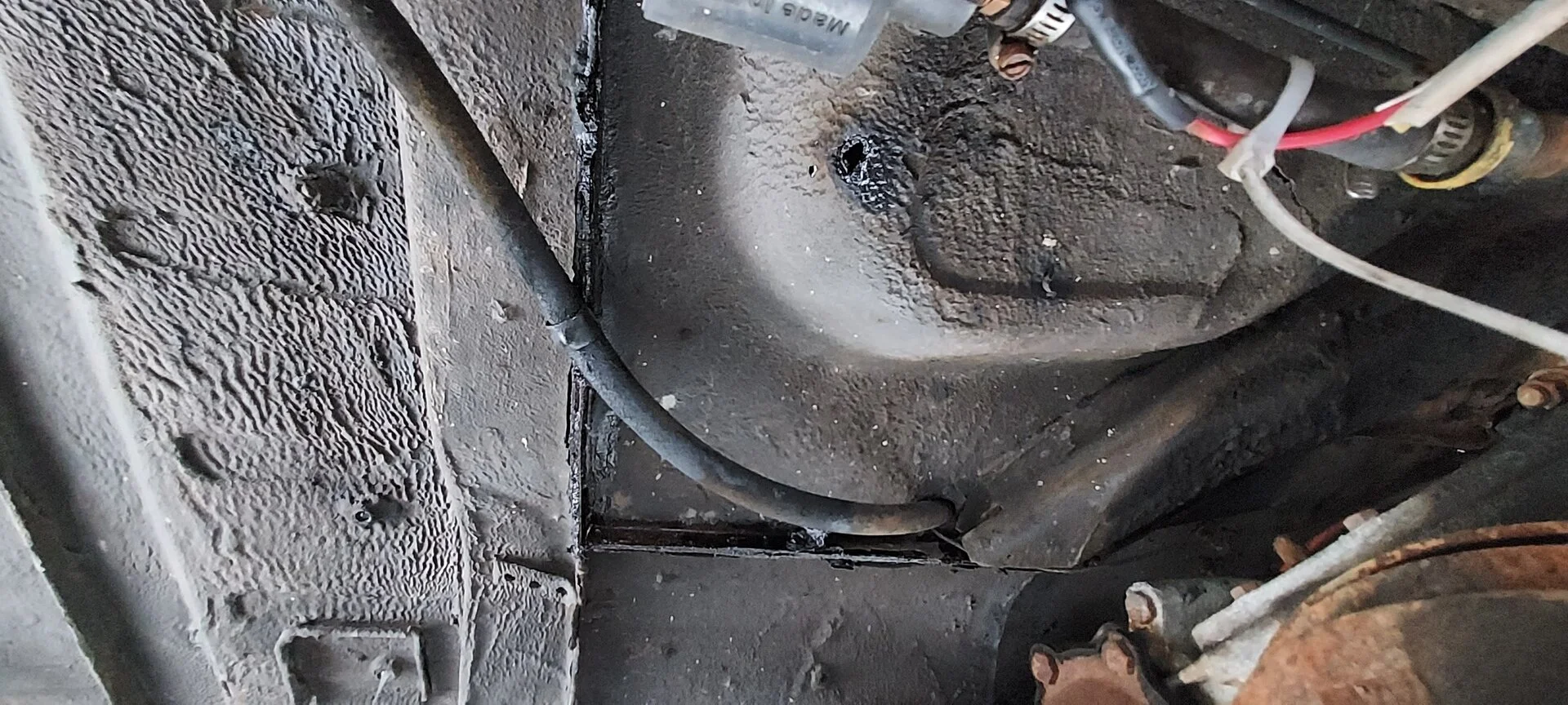

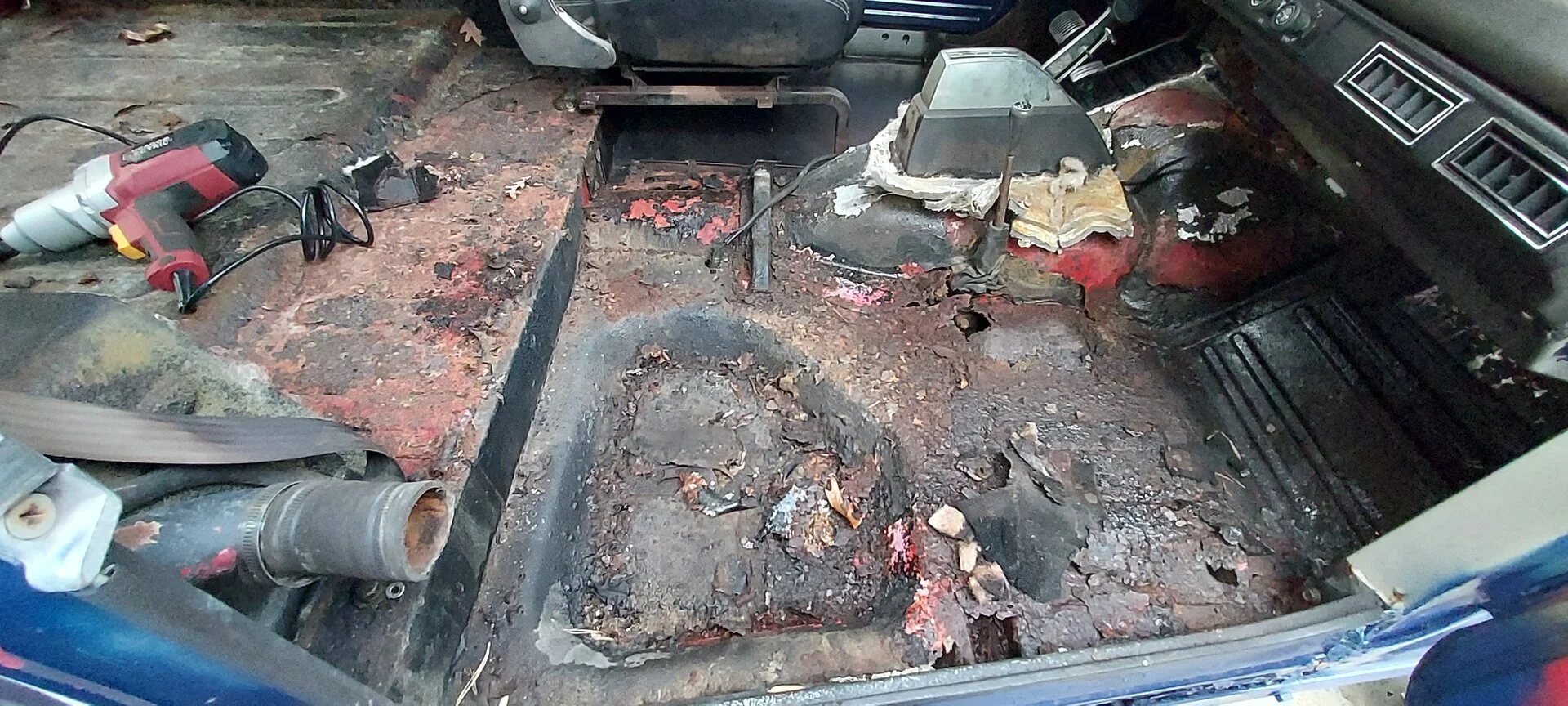

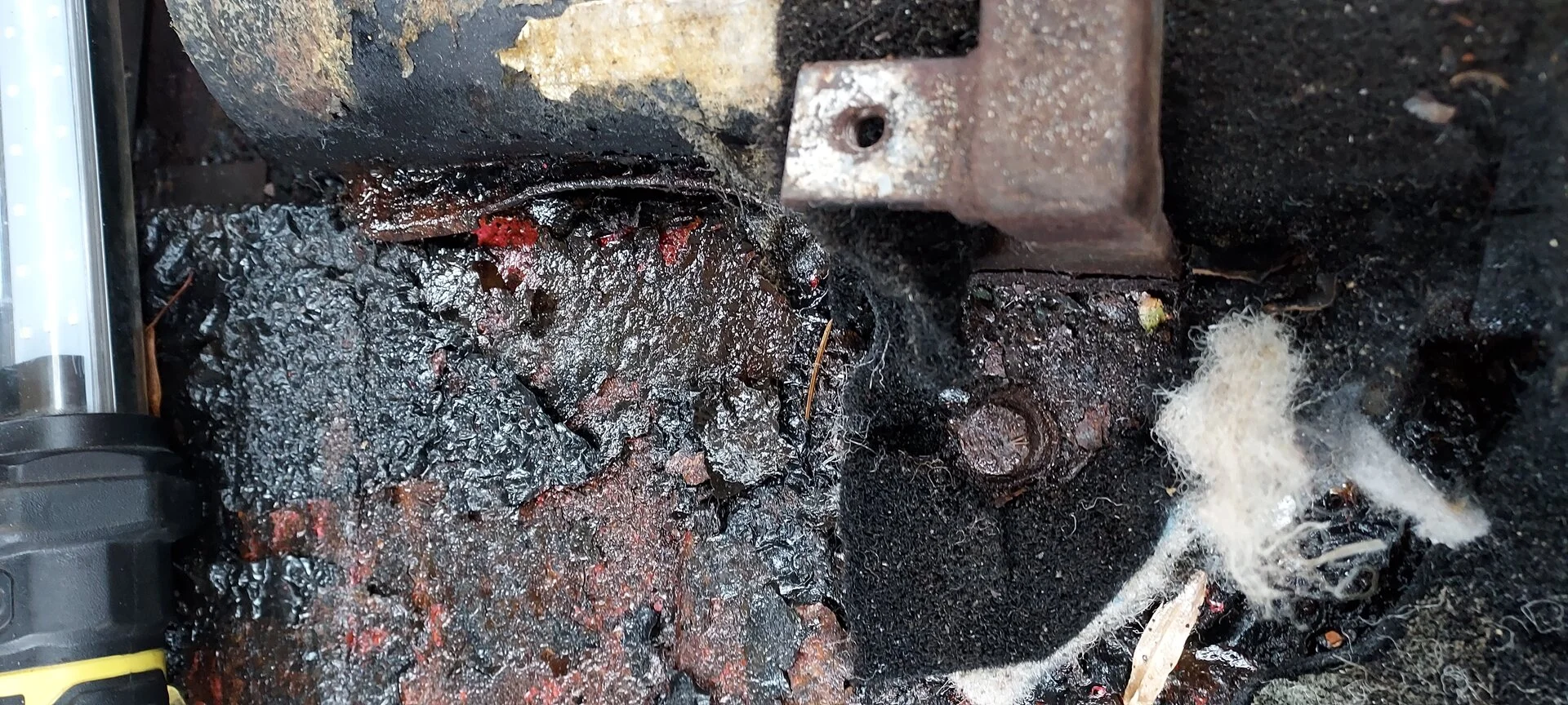

I have owned this rig for about a year. This weekend was the first time I filled the gas tank completely. I walked out this morning to a rather large puddle and an awful smell of gas. I opened the door and was basically knocked over by the smell. One of the PO covered the entire rig with two layers of insulation and then carpet. I have been cutting this s*** out for months. The carpet, insulation and body panels at the rear of the gas tank on the drivers side was soaked with gas. It seeped through the seams in the body. I am still cutting the carpet out around the tank.

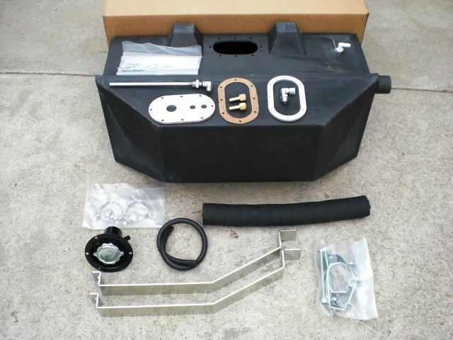

Possibly time to consider one of my 22 gal. nylon rear fuel cells, no welds, no rust, lab tested stronger than steel tanks. Sad news, after selling literally 1,000's of these tanks from 1970-2023 I have 2 left, then I will finally discontinue them. My Roto Molding company wants me to order too many, wants to take months to build a batch for me, and they now sell too slow- - -way too much money tied up for too long. I'd have to have a serious surge of interest shown to continue this product.
So how much to buy and ship to Boise Idaho? 72FJ40
