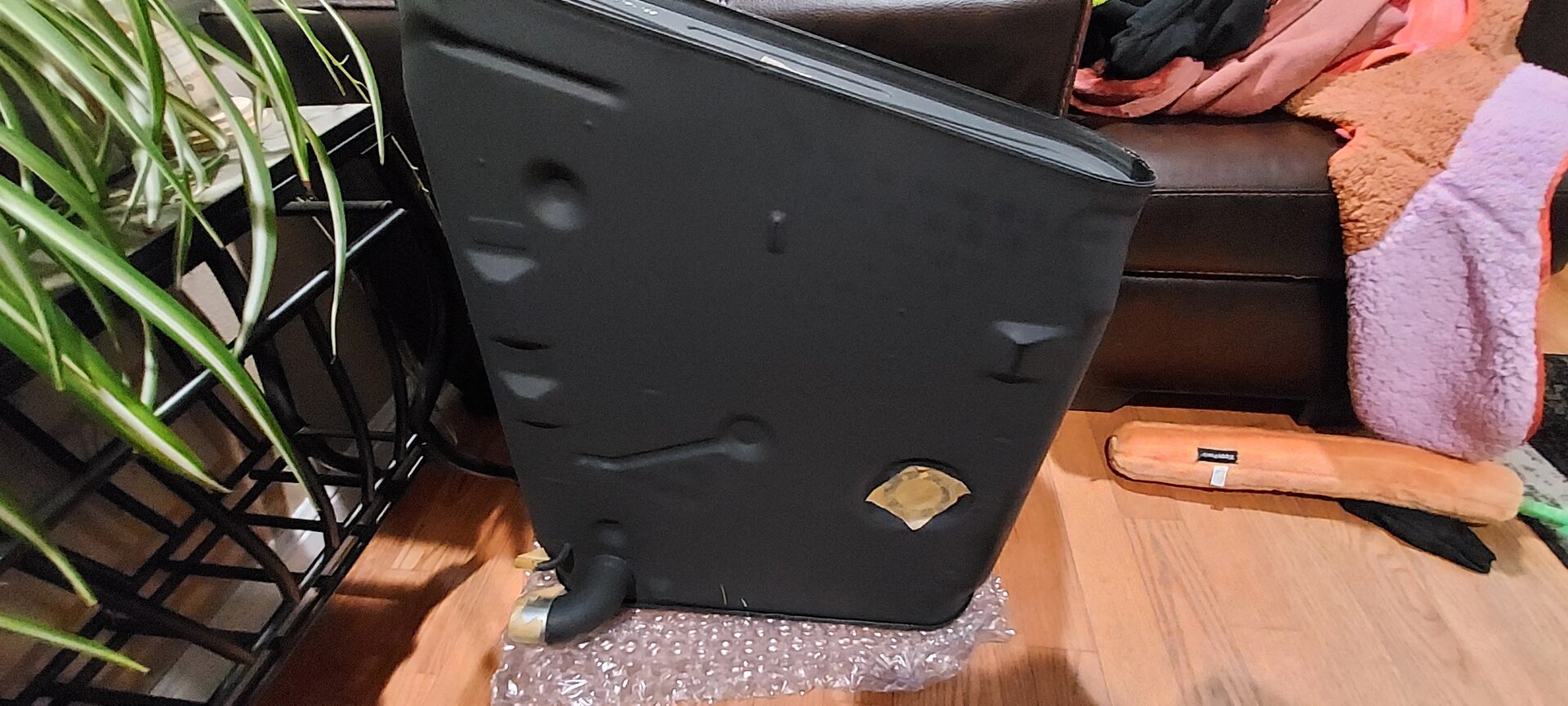

So according to Toyota parts department, this is one of 3 OEM Toyota gas tanks in the country. Installation process starts tomorrow.
Other than blowing some air into it to get any dust out, anything else that I should do before installation?
TOYOTA uses that brown water proof tape like wrap on ALL openings , the smaller tubes and VENT ports will have rubber caps or more tape...
the inside of any toyota oem tank is always SPOTLESS , like pur virgin-metallurgy inside , i would NOT introduce ANYTING except fresh clean good hi-test / hi-octane gasoline , also i personally would first pour in a FULL qt. of SeaFoam , the red and white metal can , it will coat and lube the walls of that sparky new 73100- you have there , and more important flush any resident-residue-evil out of the lines after the new sparky tank .....

I painted mine. 2 coats of rustoleum with a brush.
