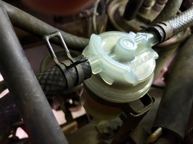

get a metal coat hanger
ream it out using kid gloves
have bucket ready to catch gas as when u bust thru the tank sealer u dumped inside you better have a PLAN A in effect !
have
NEW hose and NEW clamp's standing by arms reacha away
eazy peezy ..,.
just make sure u think this out all step by steps first !
then install a TWIN / HIS and HERS OEM Fuel Filter SYSTEM in-effect right away !!!
do NOT start the engine
u need to PRE-TRAP All crap in OEM transparent fuel filtert #1 , and ZERO in #2 down the line
you understand this DOUBLE fuel filters trapping set up ?
carry a spare TRAP - pre filter at all times
use these same 2 below ,
have extras in glove box because u can swap out anytime in only few minuys at the local what ever parking lot when it gets starts glogegd
THIS IS THE WAY ,,,:santa::):santa:

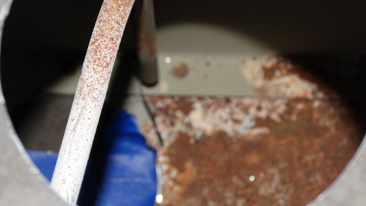

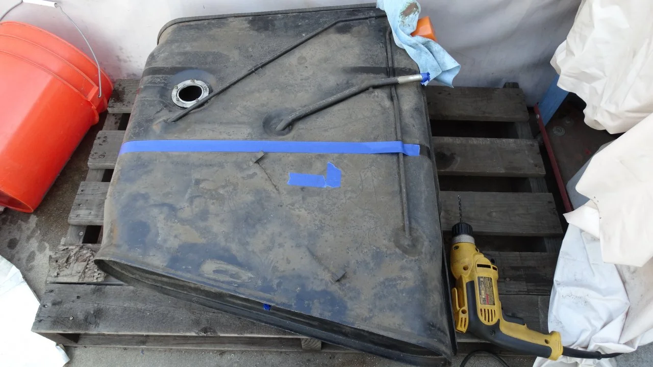

If you look at this picture:
The fuel supply line takes a 90 degree turn and is about an inch short of the long piece of tape. I don't know if 16" is long enough to make it to the bottom of the tank.
It might be that the coat hanger simply bound up before getting to the end of the line.
