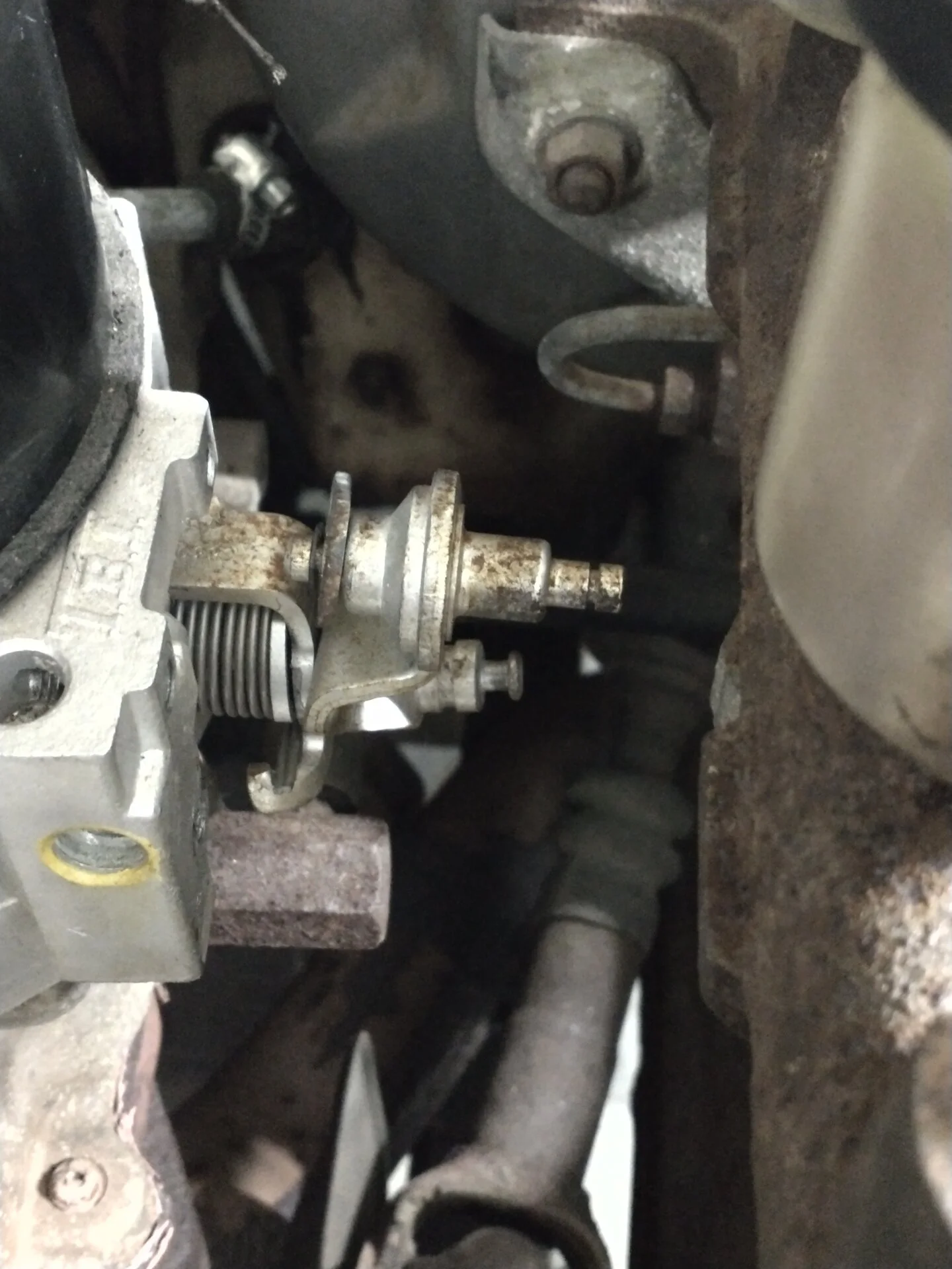

I've had some throttle cable issues over the last few weeks, mainly due to my install errors a few years ago. I'm taking care of it now, but I'm looking for options to connect the throttle cable to the tbi throttle body arm studs (there are 3 of various diameters) Is there a generic 'kit' to help with this?
Thanks
Figured out the throttle cable.
