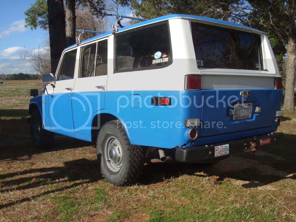

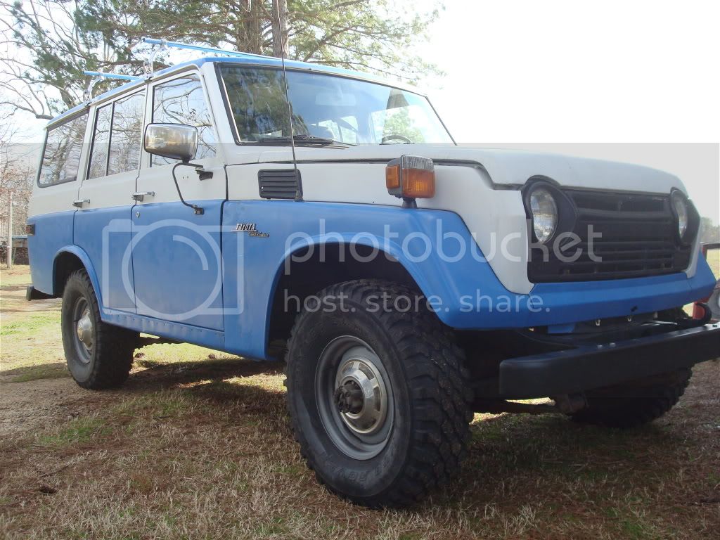

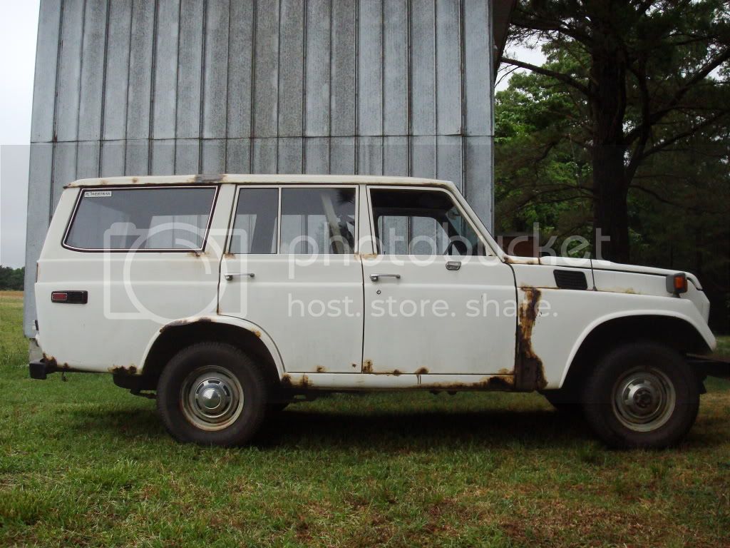

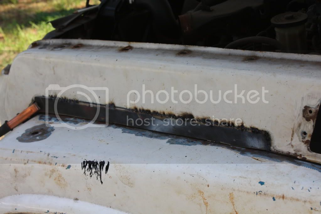

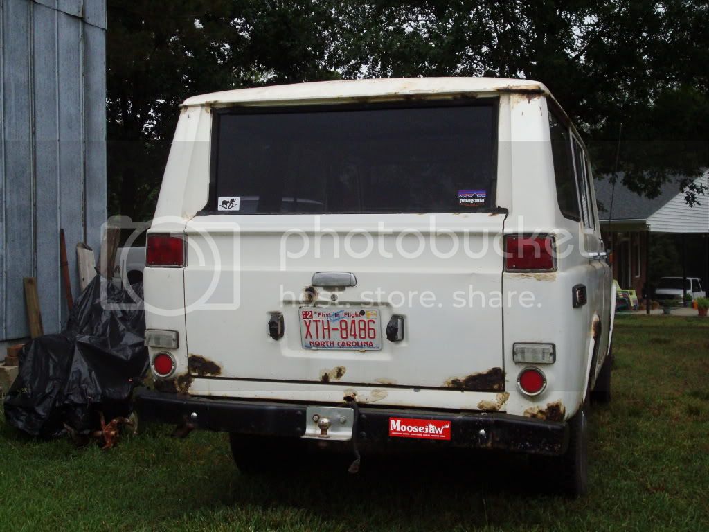

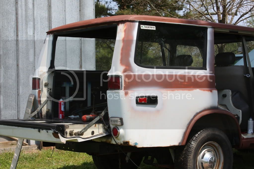

got my 55 about a year ago and it was full of rust. pretty solid roof and completely solid floor though, and it ran great, so I was happy. It has been parked about an hour from me, so time has been very tough to come by to work on it, so i didn't take care of everything, and still have a ways to go, but i've been driving it for a few days. It looks great from 20 feet away, and I'm gonna be ok with that. there is some bondo work and some holes that still need to be patched, but I'll get to it. 1977 model, was originally Smurf Blue and White.

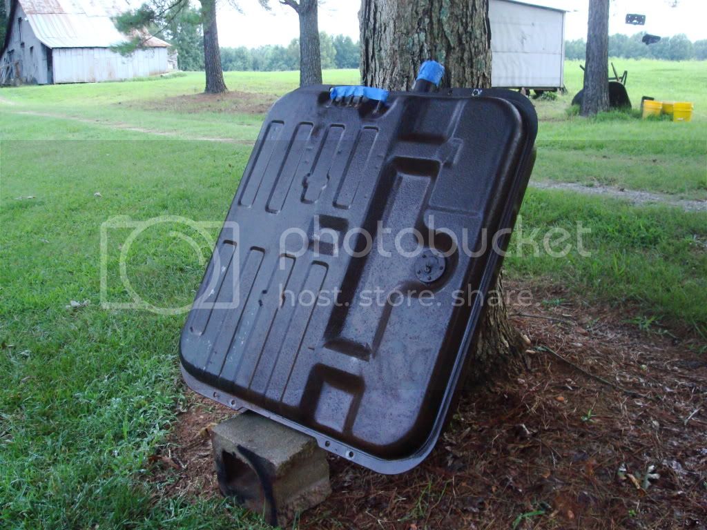

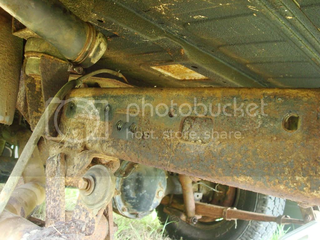

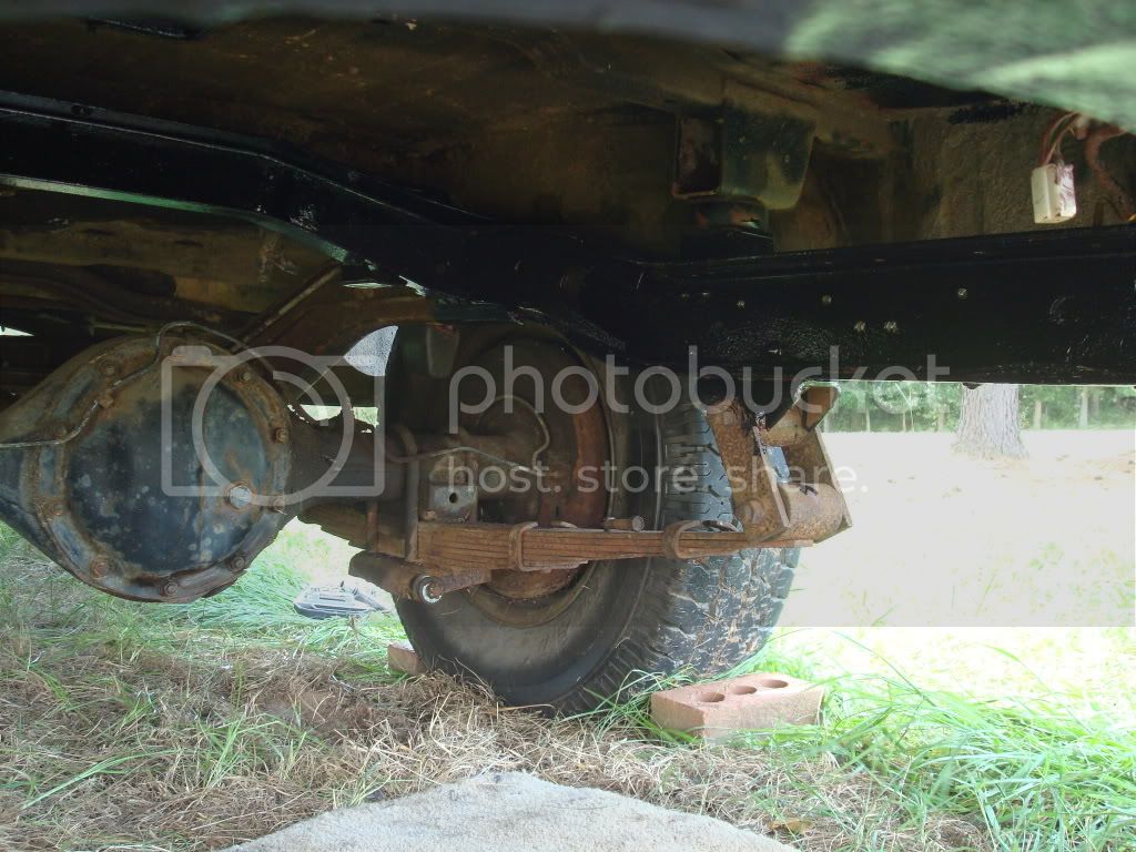

Here are some pics, nothing too detailed and I left some parts out seeing that I was working by myself and didn't always have a camera. i'll try to keep them in order, starting from last April.

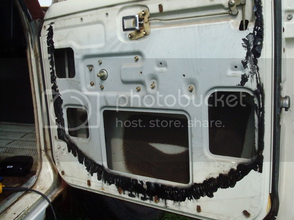

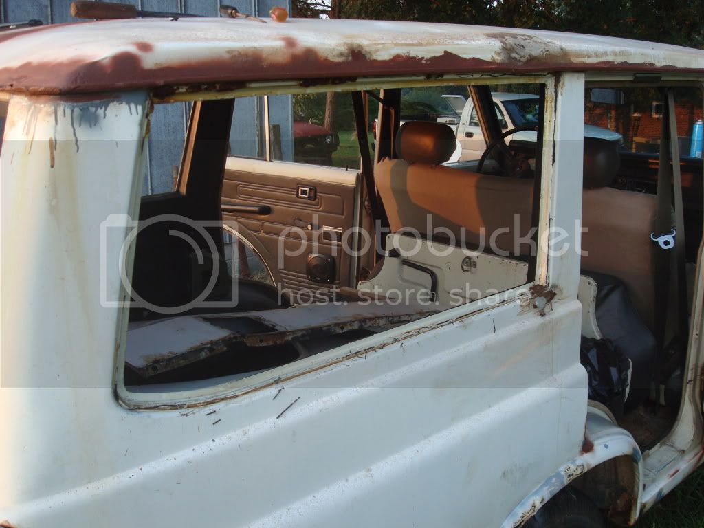

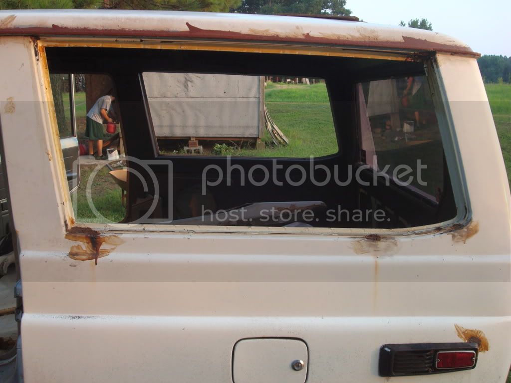

I have all the door panels...cleaning out the 10 years of gunk in the bottom of the door

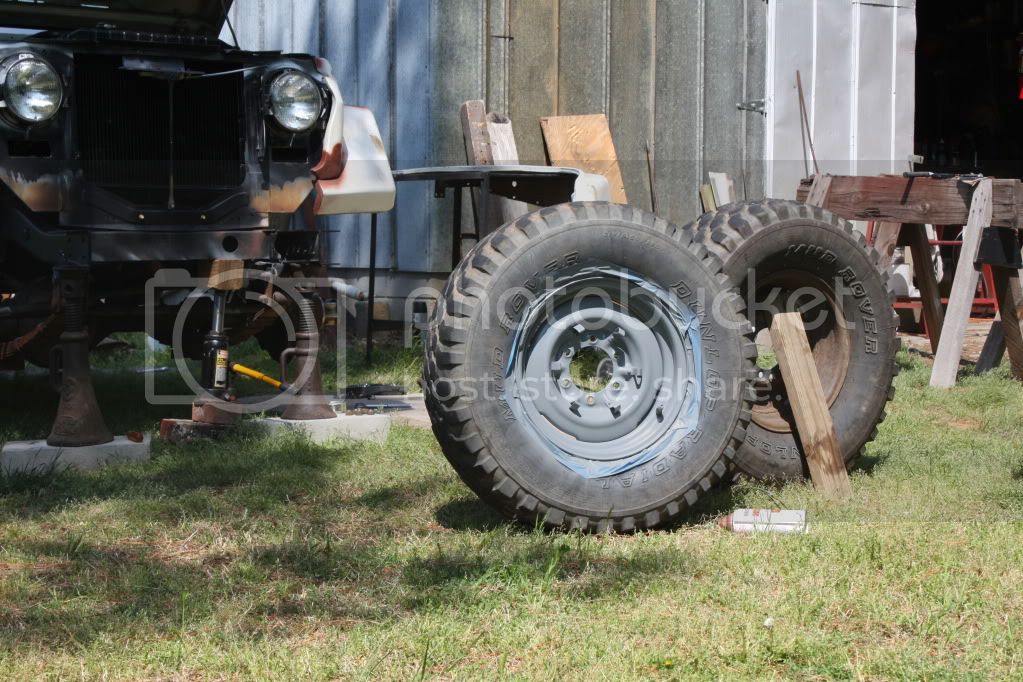

Sanded and painted the whole frame..it is solid
Rear window didn't work...faulty safety switch, just took it out

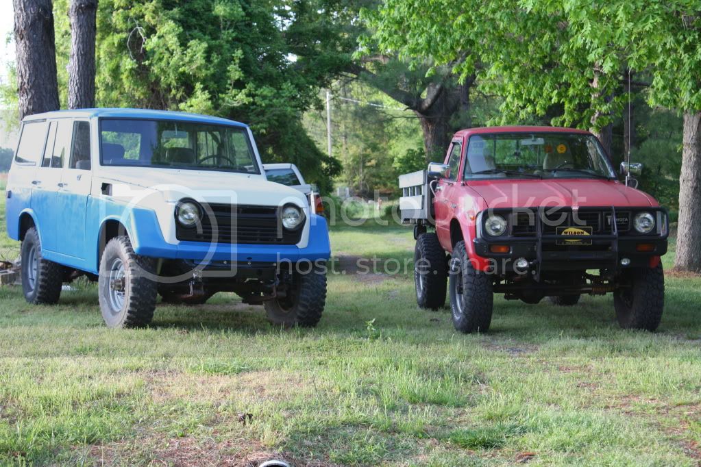

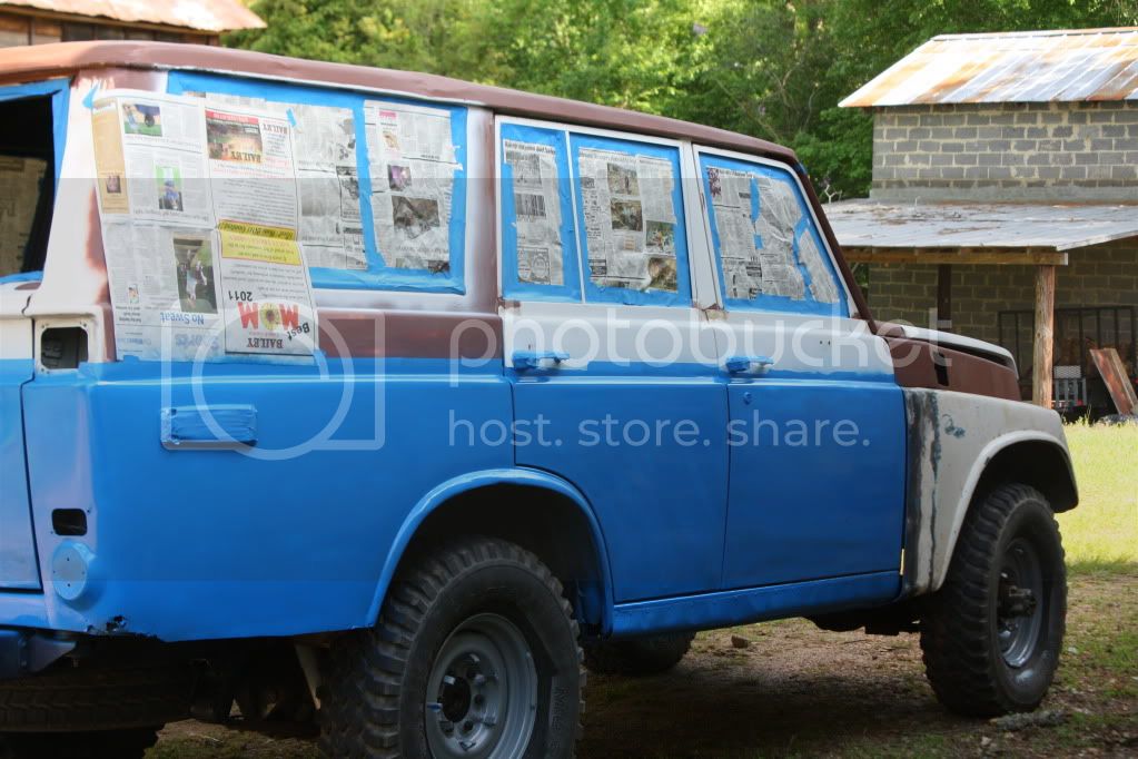

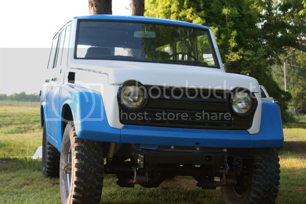

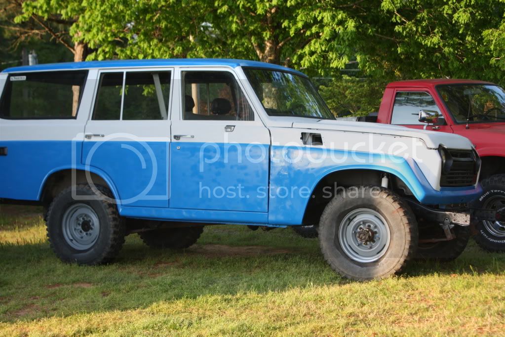

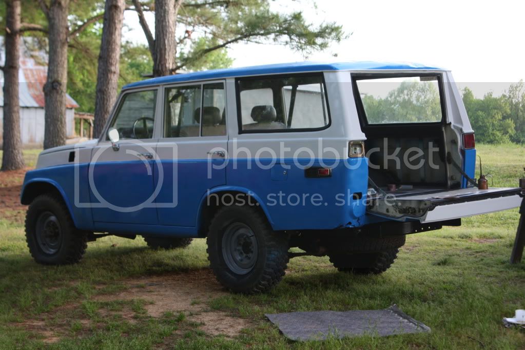

I have all the trim and lights back on it, and have drivin in a hundred miles or so, needs a tune up, but that's about it. The paint is Rustoleum spray cans, Sail Blue and White.
Lookin Gooood!!!!
Hey great progess - shes startin to look like a beauty!!!
Nice work
:cheers:
Looking Good - you do too much more you won't want to drive her and get her dirty :)
