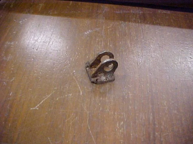

been awhile since posting up here... i have made a few oem soft door window handles :)
OEM is the white one

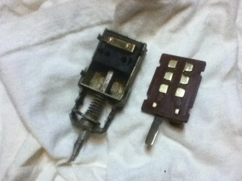

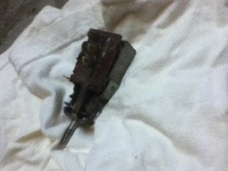

had a issue with the cruiser yesterday...
shoveled out my driveway (with snowblower) then went to my inlaws to do them same there and had my wipers stop working along the way.... bummer ... snowstorm + no wipers = not all that fun :rolleyes:
tryed to get them working before leaving their house... as i pulled the switch out it wasnt feeling right... kinda crunchy as i pull it out and push it back in.... still no workie
along the way home after the inlaws i kept the switch on low speed (incert prayers here) and it came on about 1/2 way home right when i was about to pull over and wipe off the windshield :clap:
4 little tabs to get the cover off... Turns out it was the metal slide tab floped over and laying sideways inside
the springs were so caked with 'stuff' there was no spring to them to hold the slide against the contacts
clean it all up... lub up all the necessary areas replace the cover and reinstall
all in all under 15 min

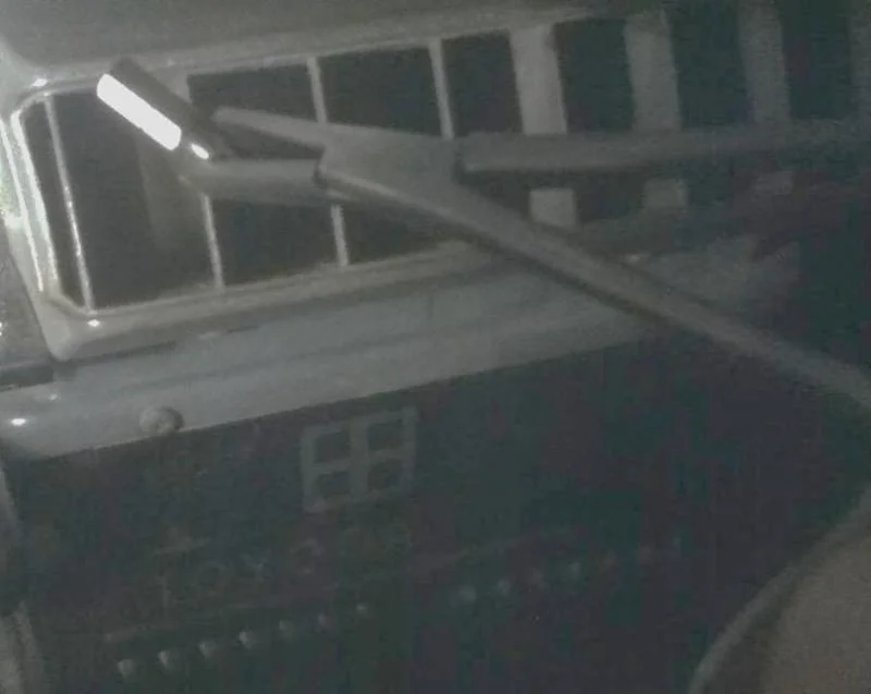

went to put it back tightening the set screw on the knob... the phillips bit came off the driver and landed in the heater :rolleyes:
spent 20 minutes trying to find something to get inside... finally got it ... i dislike time wasters thike that :meh:

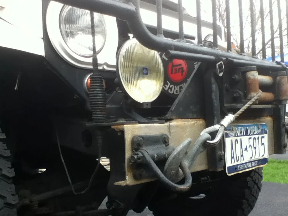

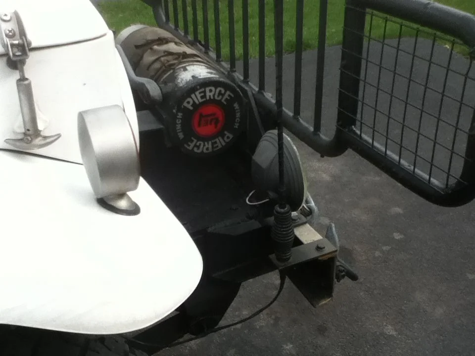

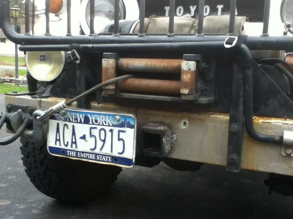

I am not a very big sticker person.... however ... got these GREAT stickers... and I am totally torn on where to put them.... also feel like I'm putting 'lipstick on a pig' will probably make a few inches look good at least :D
pic 2 spot one
Location 1 speaks to me.
On the winch...
X2.........
well .... i finally did it LOL... winch it is...

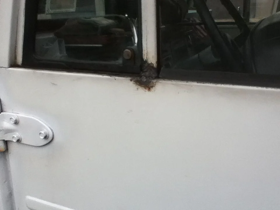

My welding jobs ... I went to the school of PO-U it seems... I need to do more welding I guess :)
Doors had cracks in 4 places... The usual places for a DD I guess that has many miles

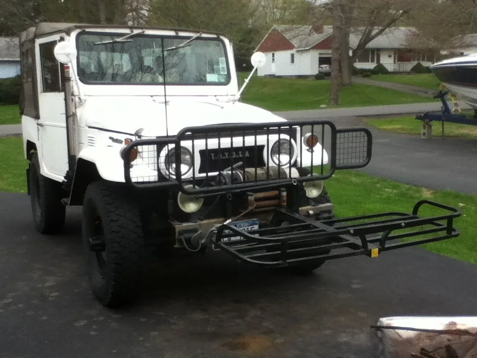

And made more storage .... Welded a receiver tube on front bumper... Tada more storage lol
Made bracket/bar for license plate ... Had to move from center
