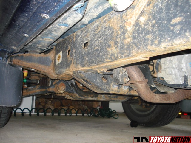

This is surface rust:
Much more than that and it starts to become corrosion. Everyone has their own opinions on what level of rust is acceptable and thats fine. In my own opinion and from what I've seen I completely disagree with you if you think that the OP's level of rust is acceptable as a good platform.
The OP's frame is heading toward a level of corrosion that begins to degrade the strength of the chassis (think about getting into an accident with a weekend frame, not good). Also its a level of rust that makes usually easy tasks difficult, frustrating and burdensome. Bolts will not come off without breaking the studs, and replacing studs not only is a pain in the ass but it is also time consuming.
As I stated earlier, if you want to run it around and bash on it its not a bad rig. If you want a 80 that you can build out for off roading and love for a long time I'd look elsewhere.
