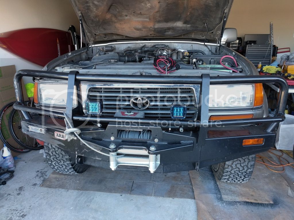

12/7 Updated with pictures:
Home for the first time (purchased and promptly crashed on 11/3) from the shop w/ new axle -- no body work done (yet).
Rigid D2s going on while waiting on new brakes.
Also, anything else I should buy?
Random things I already plan on adding are some slee sliders and fabbing some underbelly protection that ties into those.
