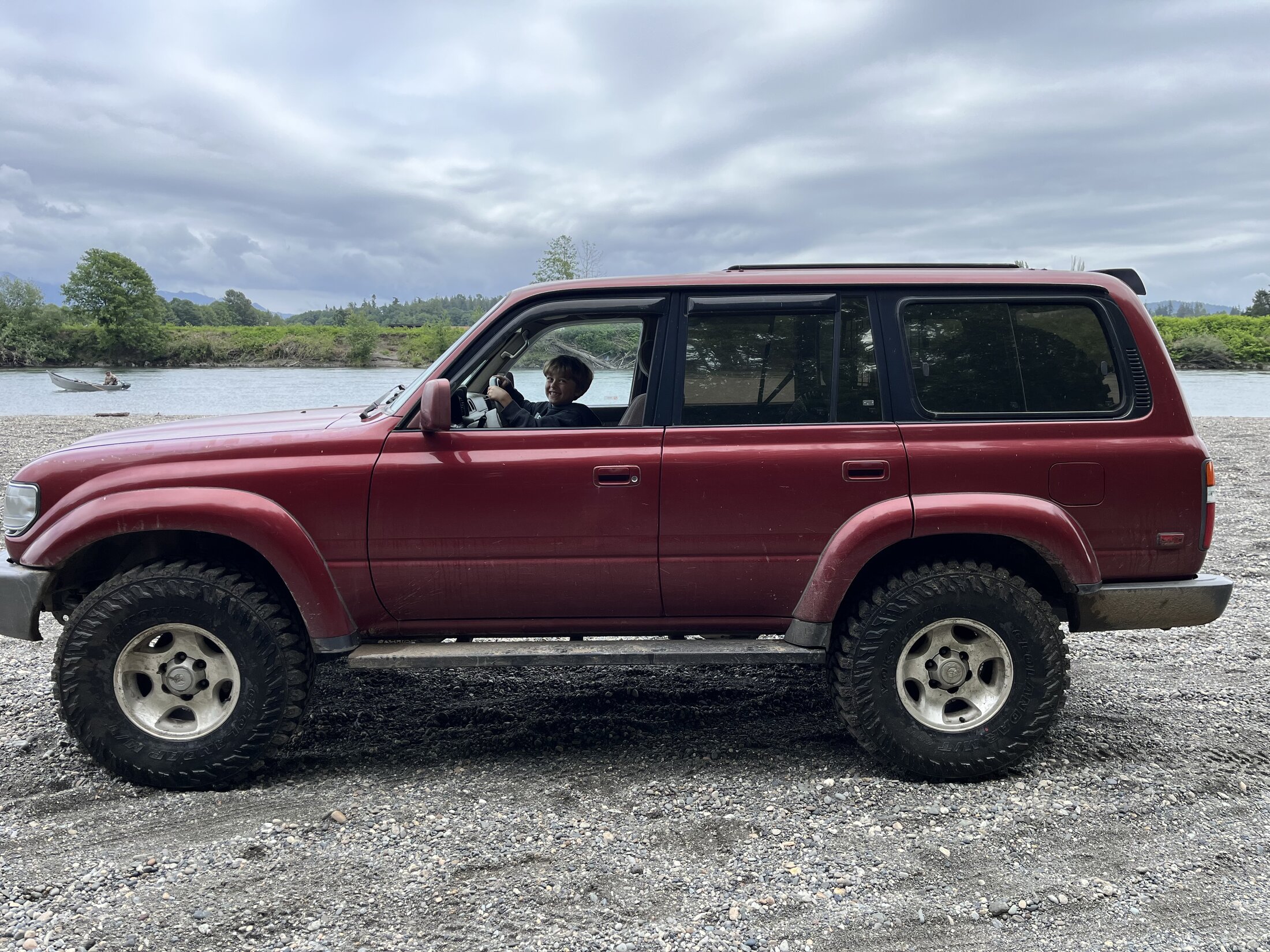

I am partial to the OEM look. 12k hidden winch upfront and 20 gallon extra gas tank in the back. BIOR sliders with OEM look. Sure, not as durable if you smash into something or get smashed into.
I see a new Land Cruiser driver in the making 😎
Yeah that's clean, great setup! Bellfab interior tire carrier?
