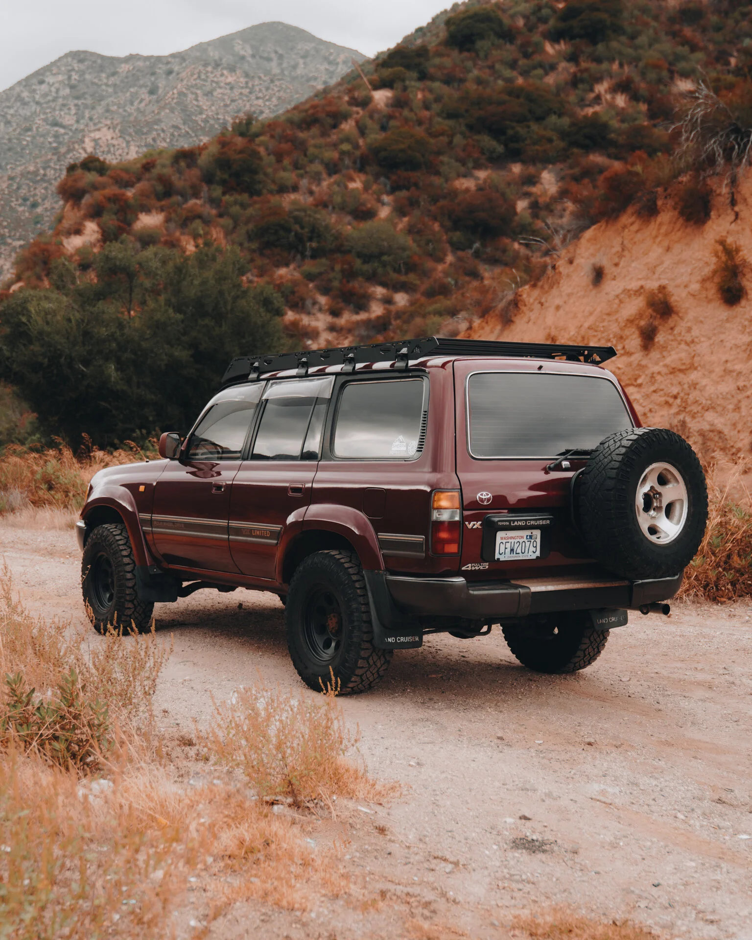

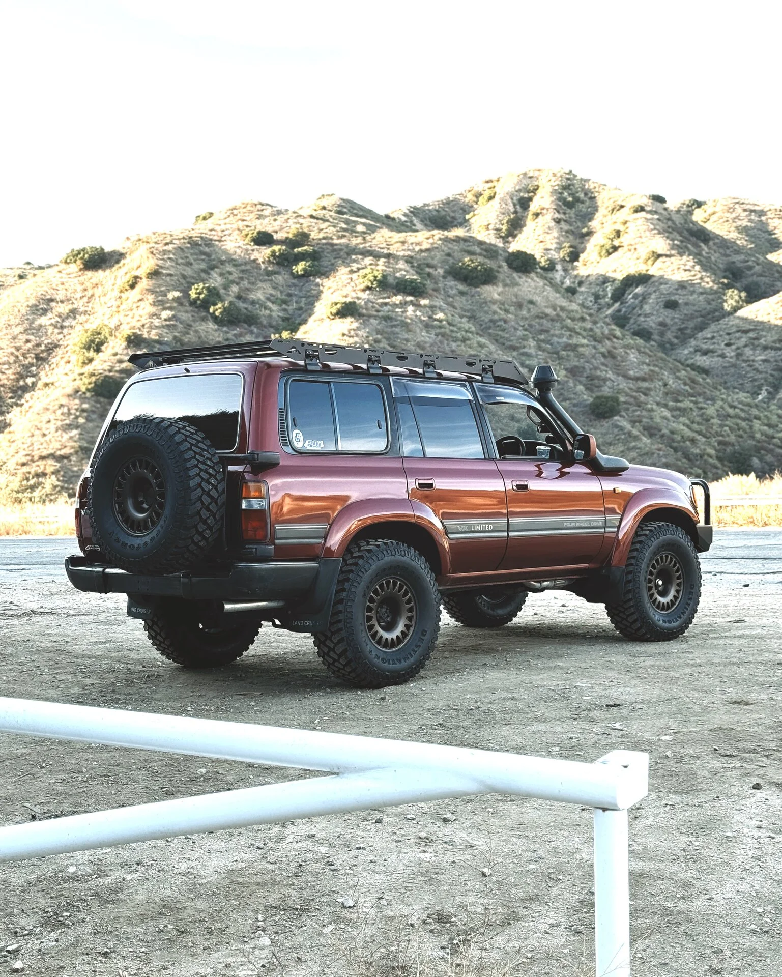

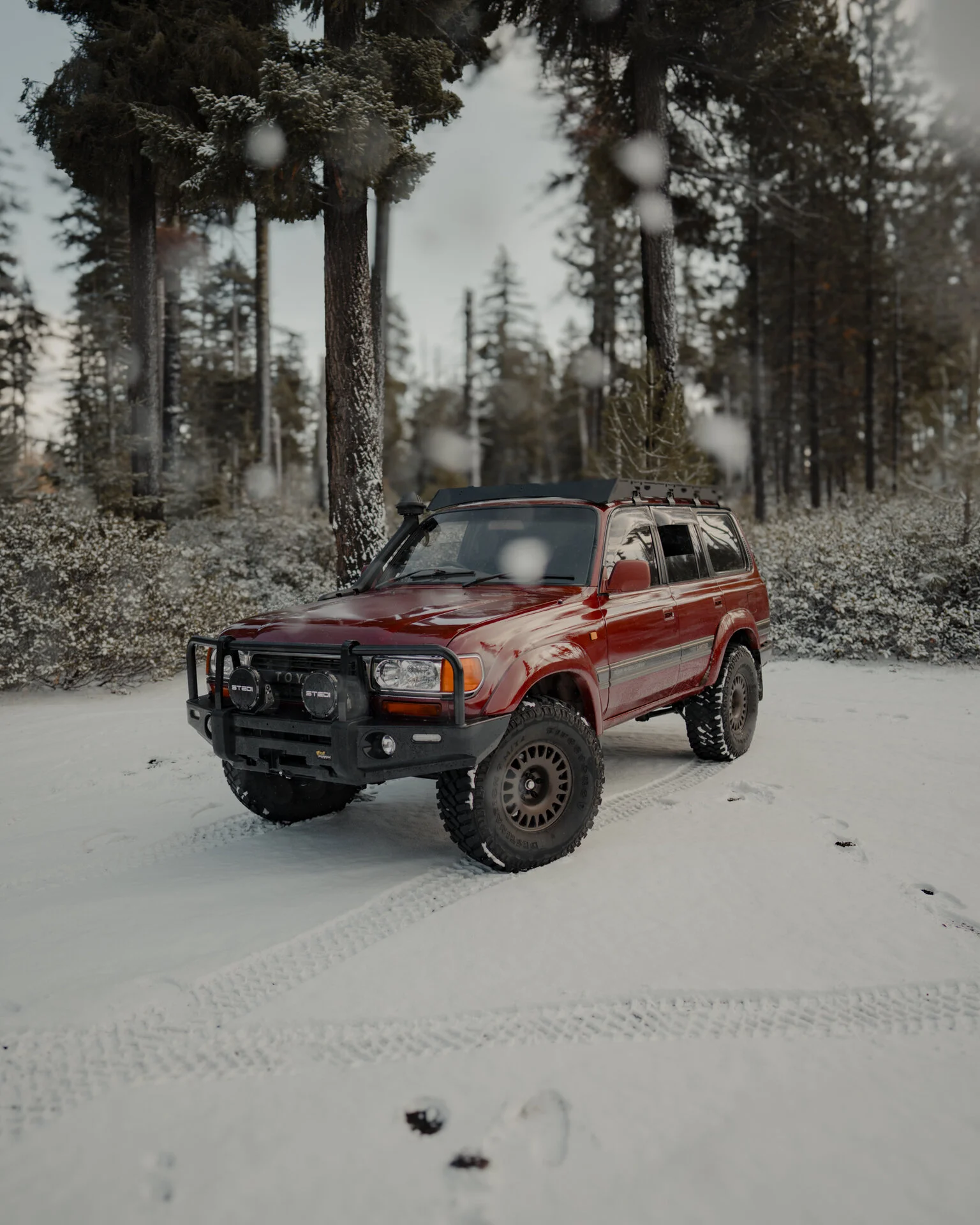

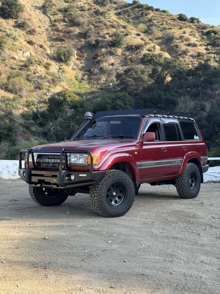

I'm really hyped on this one; I picked up a 1990 HDJ81—triple locked, 1HDT diesel motor.
The first drive home was 8 hrs, and did it with no issues. It's pretty wild that a 33-year-old truck runs like a dream!

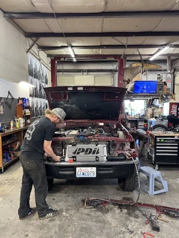

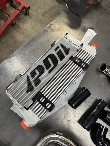

The first thing I had done was a PDI intercooler and trans cooler.

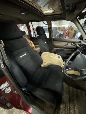

Also added some Corbuea GTS-II seats (with heat)

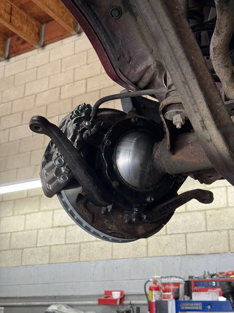

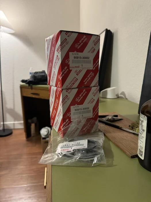

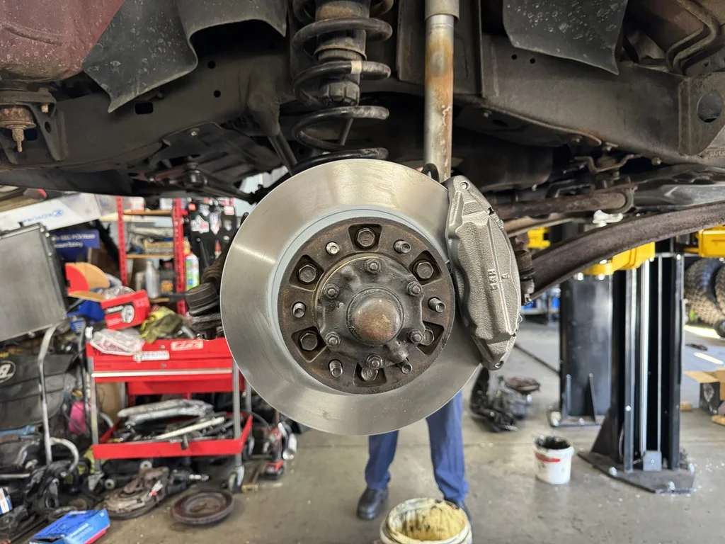

Most of the stuff on my short list is maintenance. So, I'm currently getting my front knuckles rebuilt. But while they're apart I'll be upgrading to the later 80 series rotor and calipers for some added braking power.

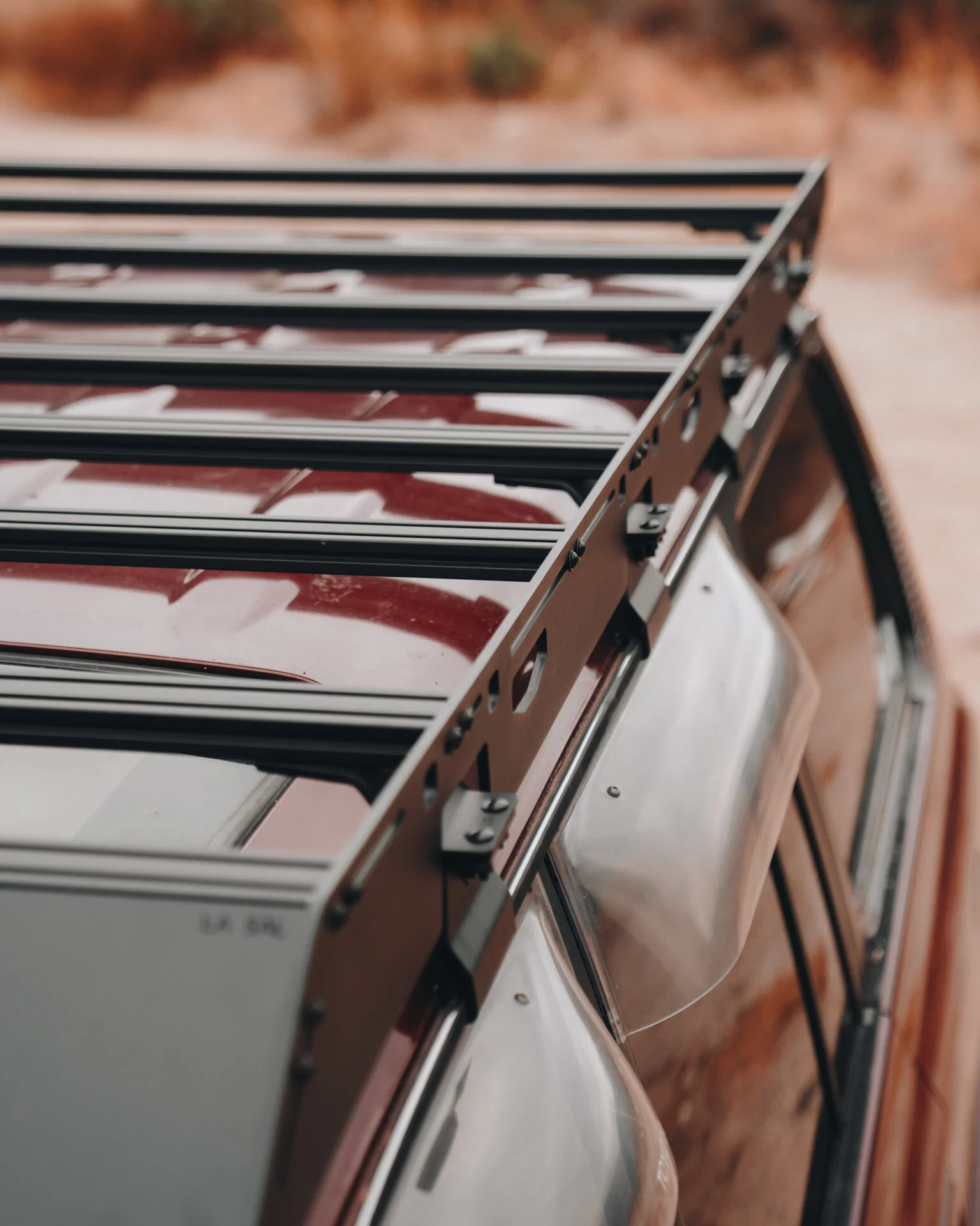

How tall is the Sherpa rack off the roof at its highest point? Im curious because I want one but still want it to fit in my garage. Maybe a measurement from rain gutter to top of the side plate??
