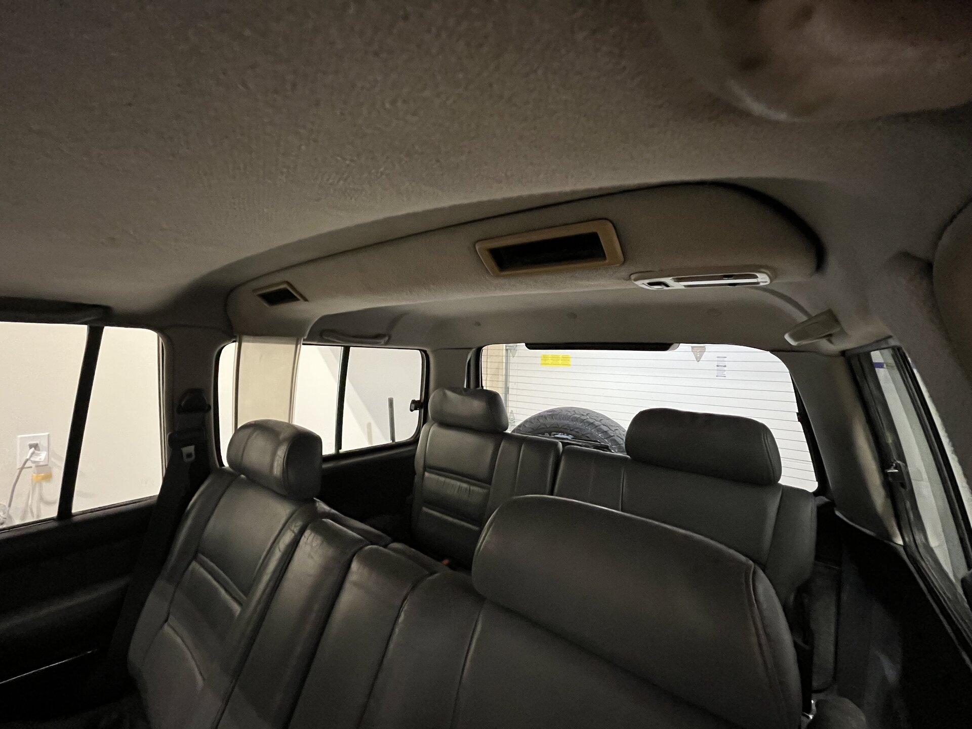

Nice looking rig! Can't imagine there are too many of these out there in LHD. I see you've got that rear AC setup too, haven't seen that very often. Looks very clean. How's it like to drive?
Is there no heater valve on the firewall?
No heater valve - they likely had a leak on the front heater core and bypassed it or the valve plastic failed and they bypassed it. I will do a pressure test on the core from engine bay to determine if it's leaking or not. Good eye!
Drives like an old Crown Vic - needs springs and shocks. Motor pulls hard and sounds great. With enough pedal you can get some turbo spool sound. Overall it drives as expected for an 80 that needs some basic maintenance.

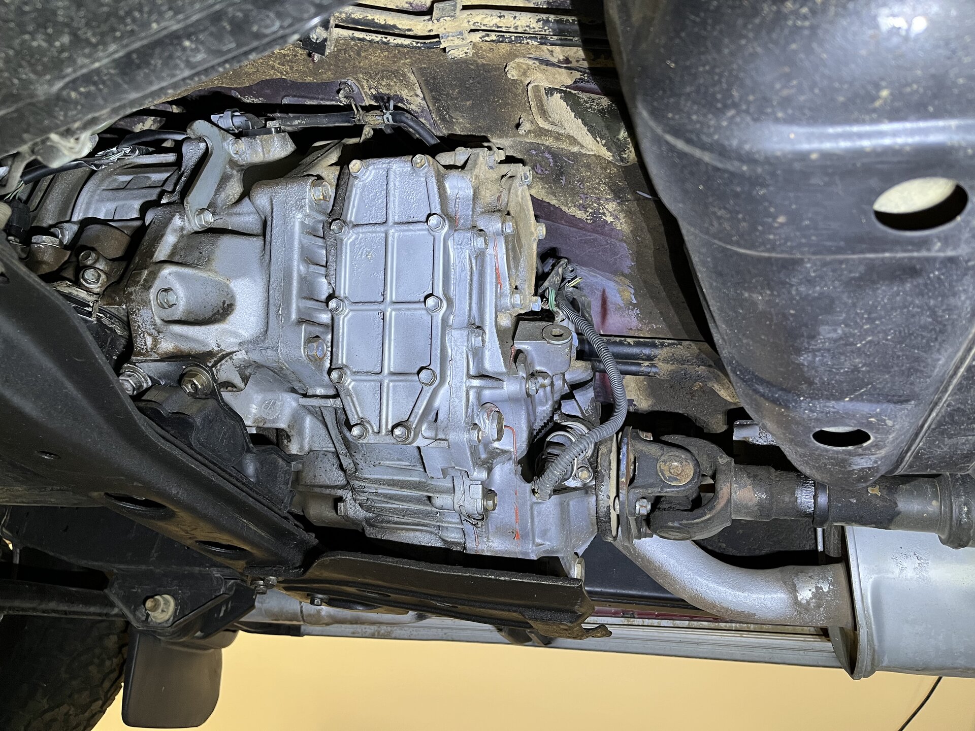

The HF1A transfer case has the removable blank for a PTO which must have been an option along with the 12v winch. My other HF1A does not have a removable plate for the PTO. Would be nice to replace the 12v with a PTO for cool factor.

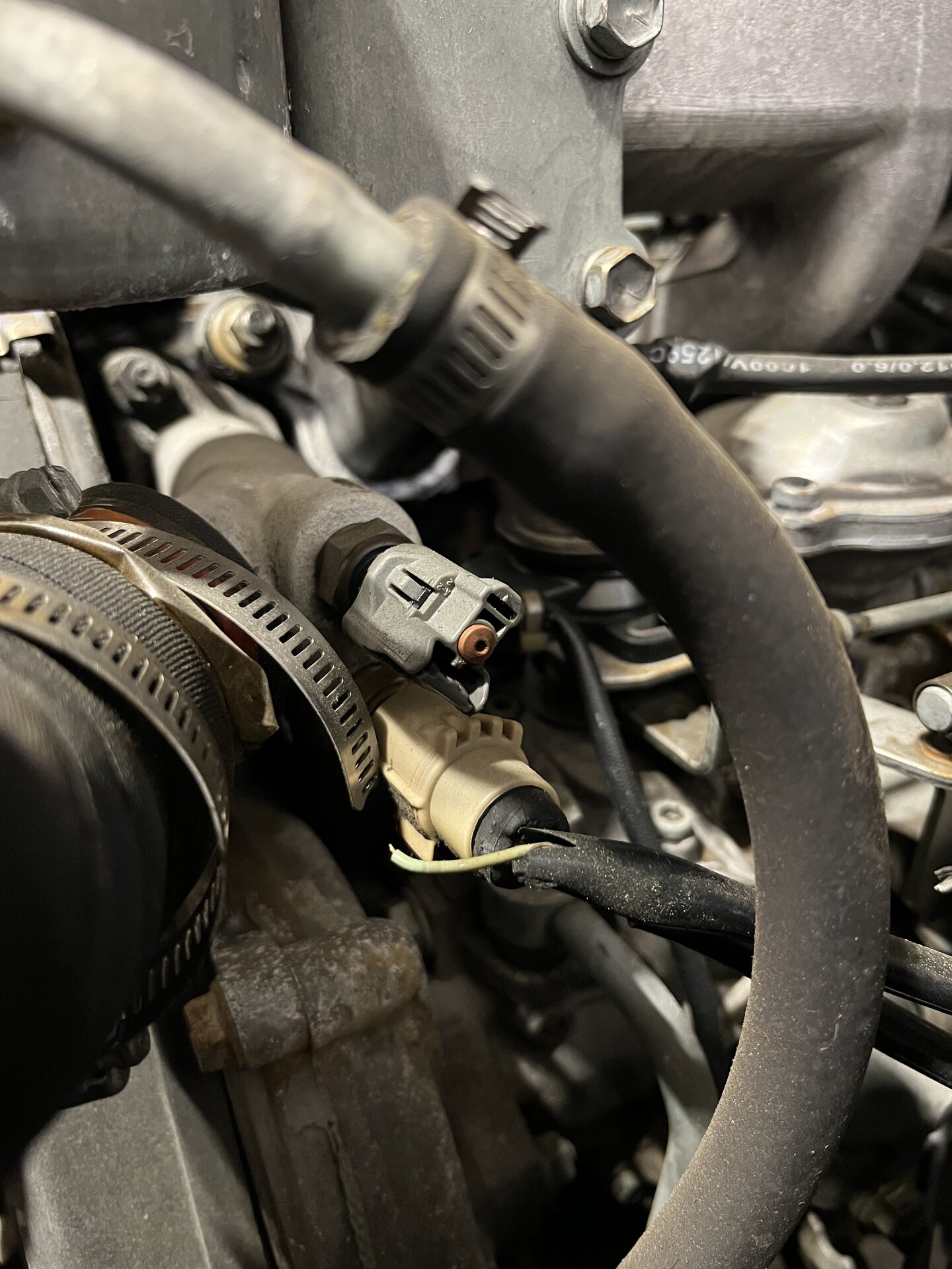

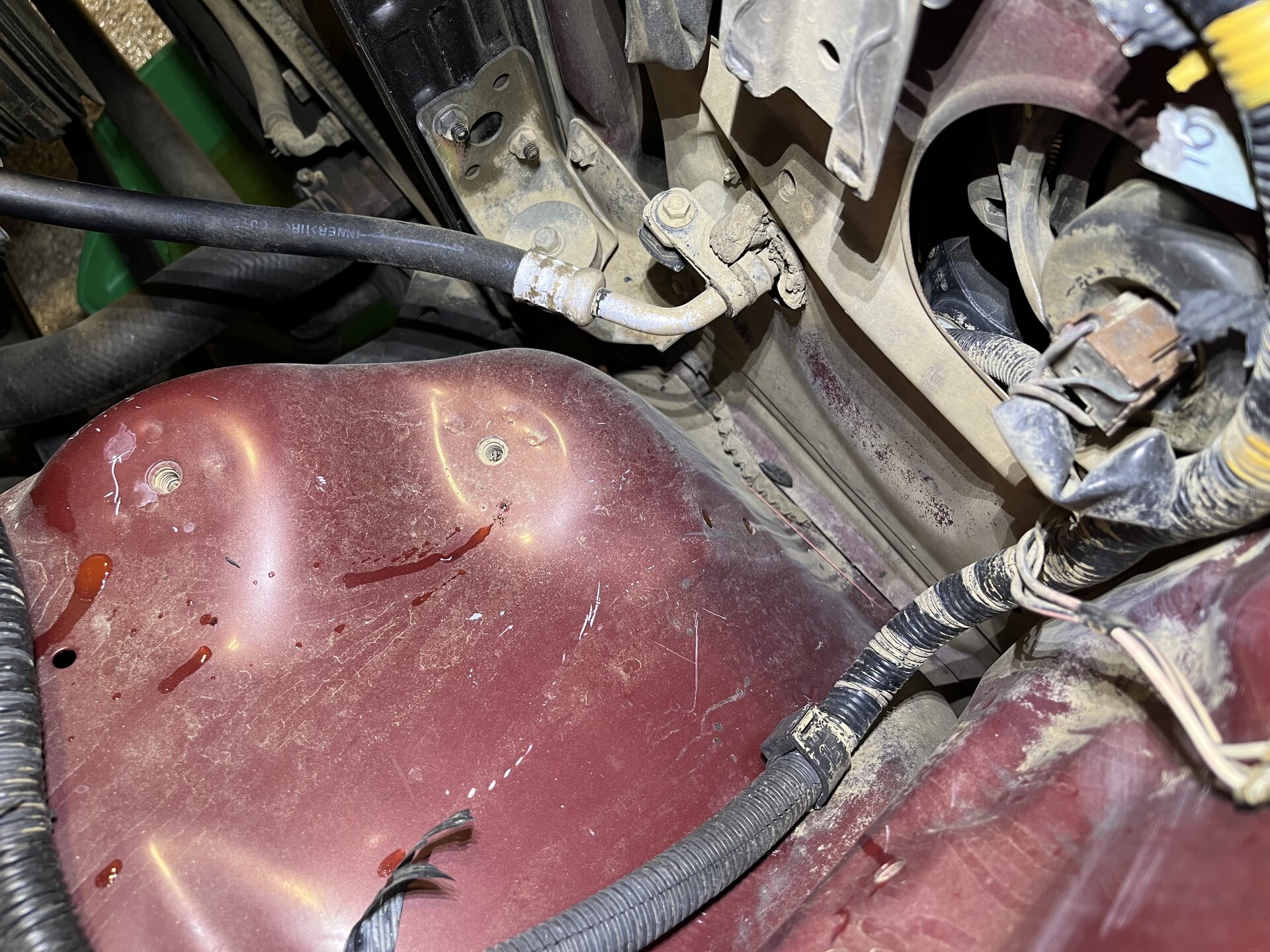

Started to work on getting access to the thermostat and cooling system components to identify the cause of coolant loss. Within 30 minutes I was able to identify the issue - thermostat pipe to radiator had cracked and allowed coolant to just pour out. Hopefully this was a recent problem and not a long term issue. In addition, I found a severed coolant temp sensor wire and an old belt busted tucked under the coolant reservoir. A repair wire will resolve this.

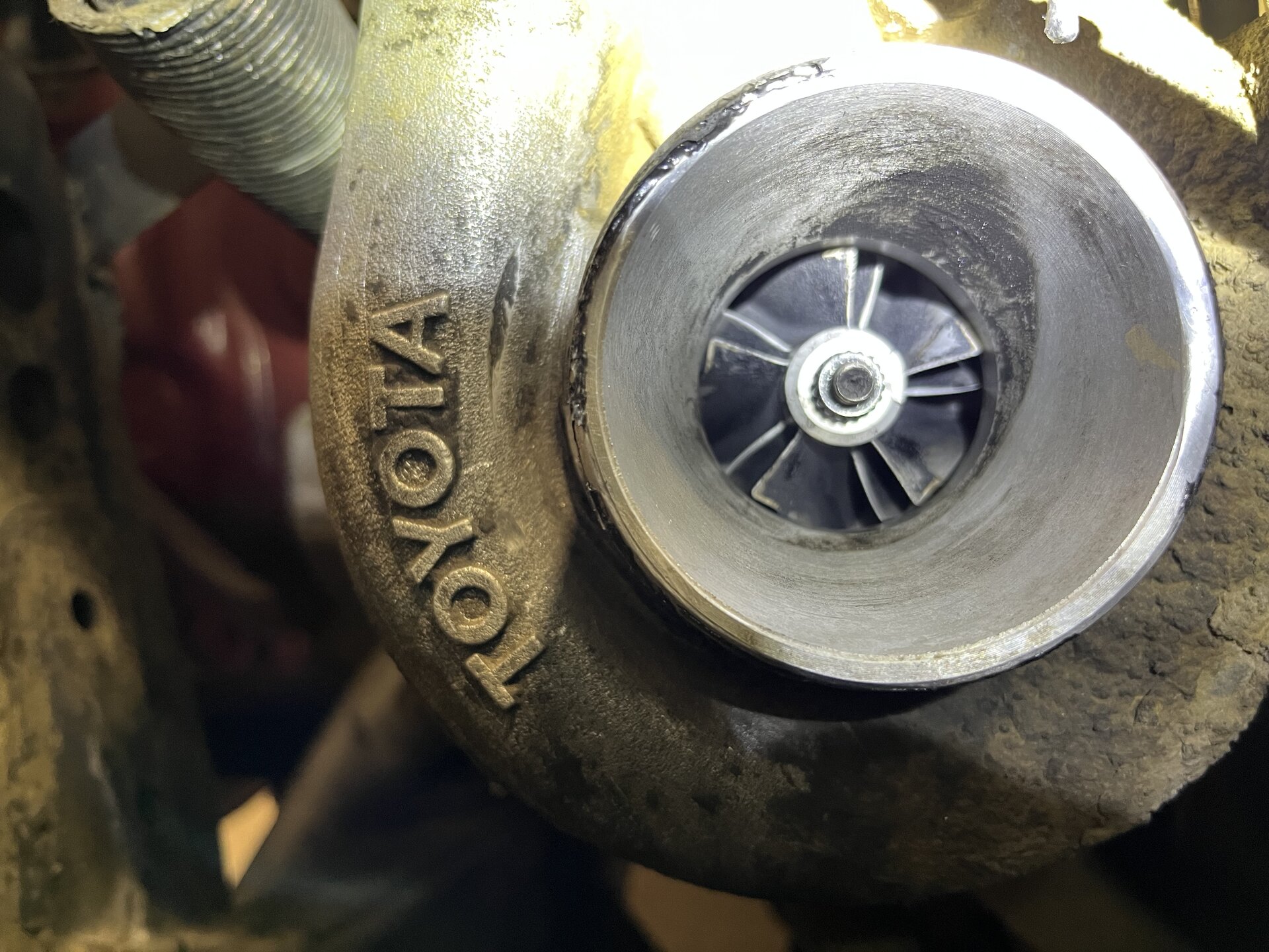

Turbo does not have any axial play and from a quick look shows no history of eating anything. Will look closer again.

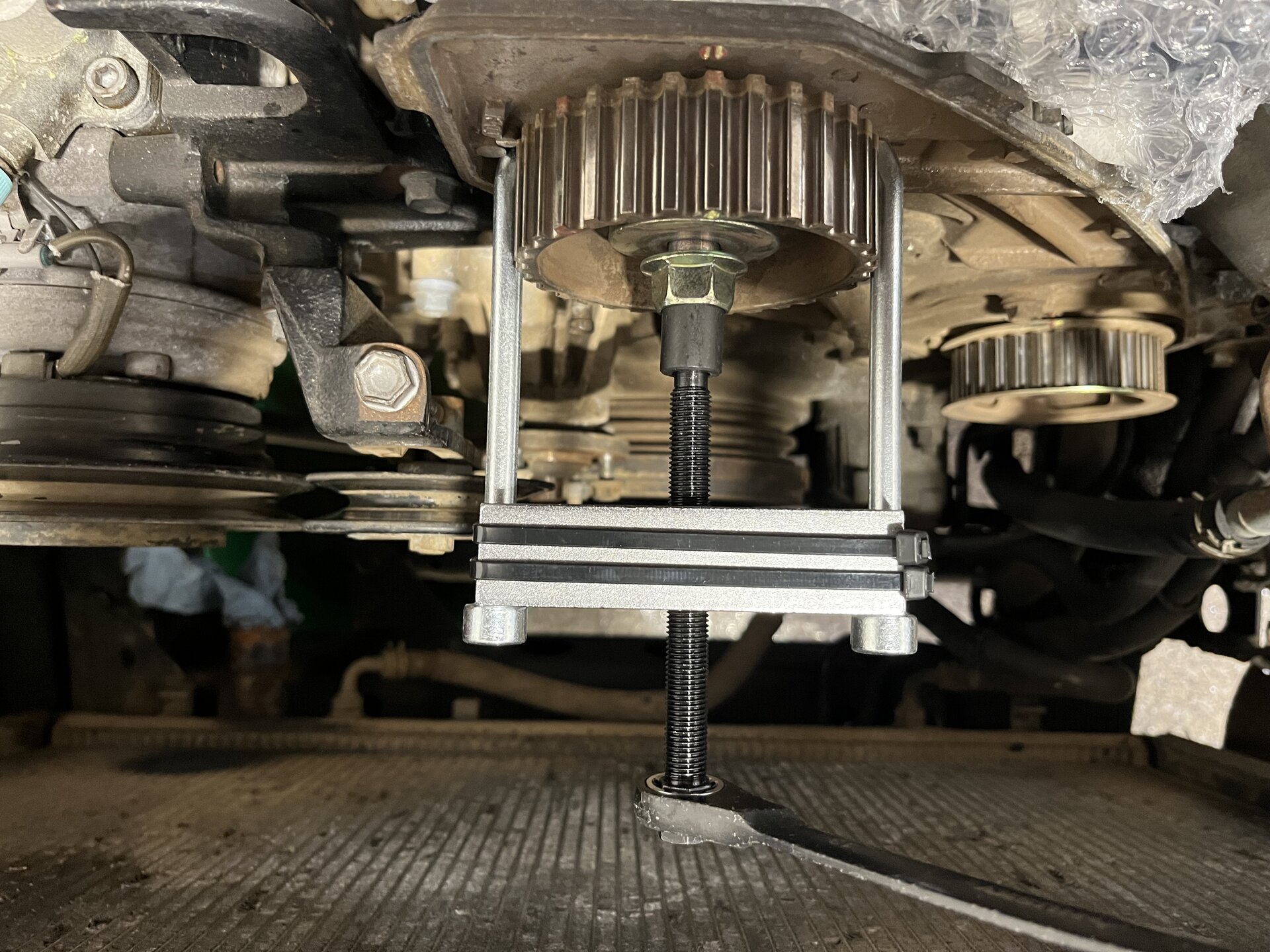

Made some progress today but need to get a 2 leg puller to get the cam gear off. My 3 leg pullers just don't fit. The removed timing belt looked very good. Engine must have been maintained per intervals.
I tried a steering wheel puller to get the cam gear off and it worked just fine.

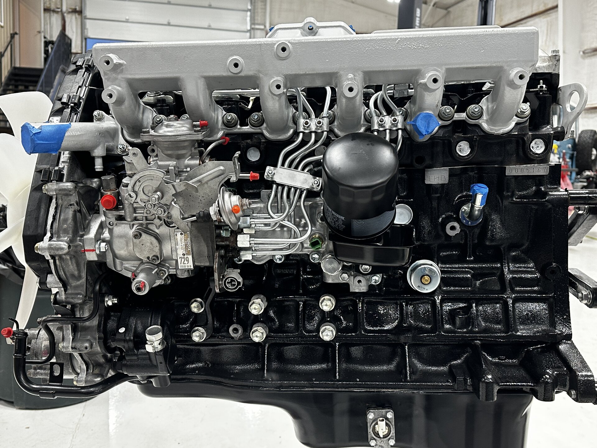

Started on the coolant hose replacement and ran into some things that need to be address. One is the bypass pipe which is pressed into the block. Still available. Anyone have tips for removing it with engine still in vehicle?
Also the heater supply pipe to both front and rear cores needs to be replaced. Does not look like its available anymore.
Removed the #1 cylinder BEB. Not bad. #3 markings. Will order a full set.
coolant bypass pipe that is pressed into the block. Should be replaced.
The water inlet at the back of the block is a bitch to get to with the block in the engine bay.
You can try tapping it out with a pointed punch, but it’s tough.
Putting a new one in is also not easy with the engine in the truck.
As much as I want to avoid doing it, I just can’t. I’ll give your suggestions a try and do my best.
