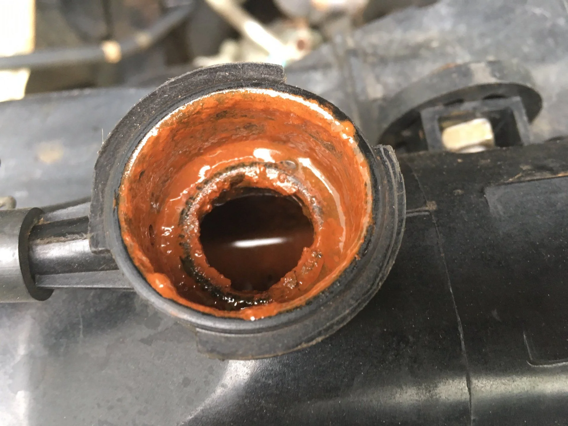

Head gasket failed a day after the long trip. #6 cylinder.
- Loss of coolant from radiator.
- Expansion tank not functioning. I put the expansion tank "straw" into a bottle of water and saw bubbles indicating exhaust gas.
- I scoped the cylinders and #6 was really clean and the next morning had a pool of water. A clean cylinder indicates steam cleaning.

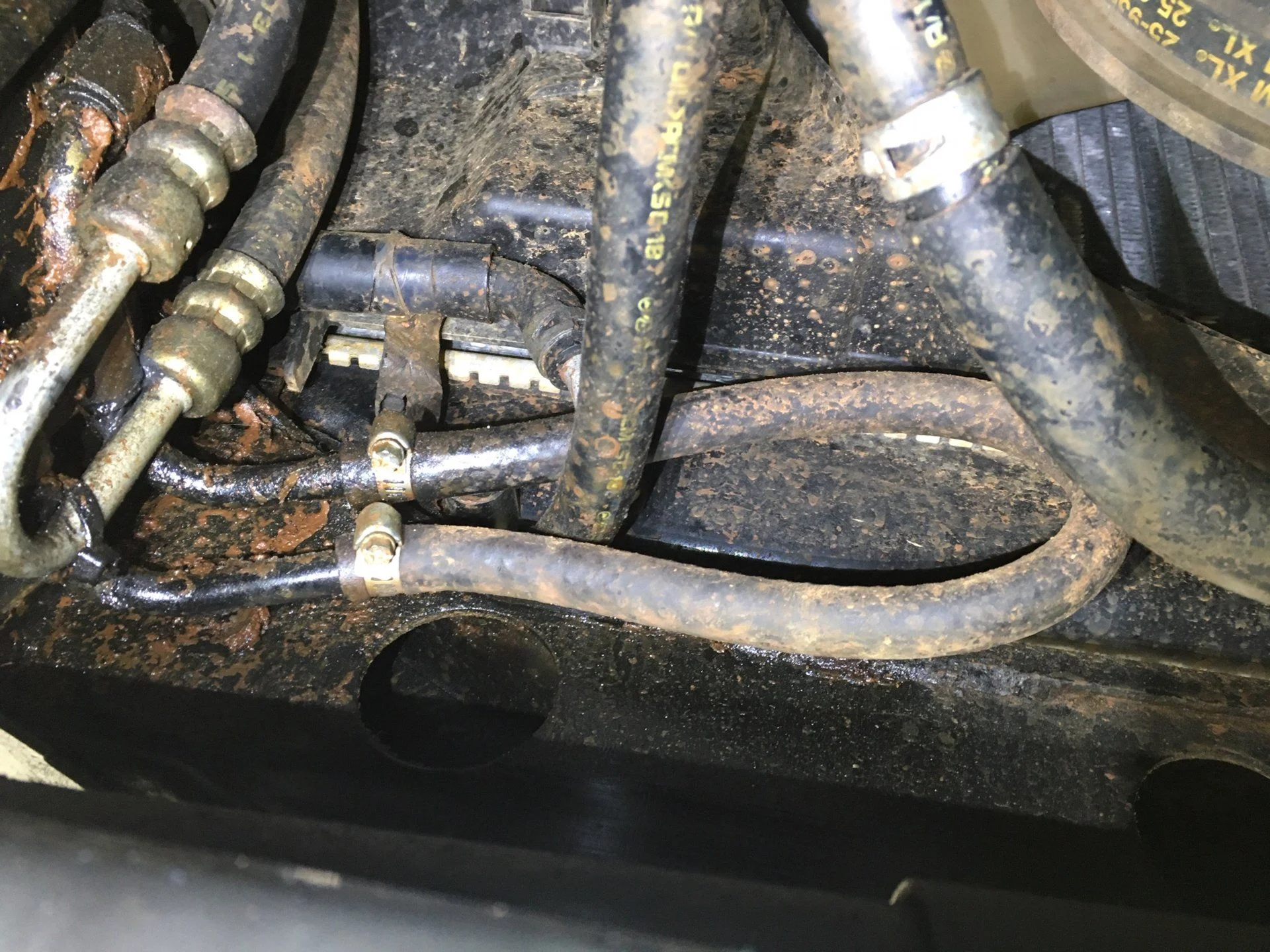

No power steering cooler. Bypassed with a hose. Fluid was found to be not ATF.

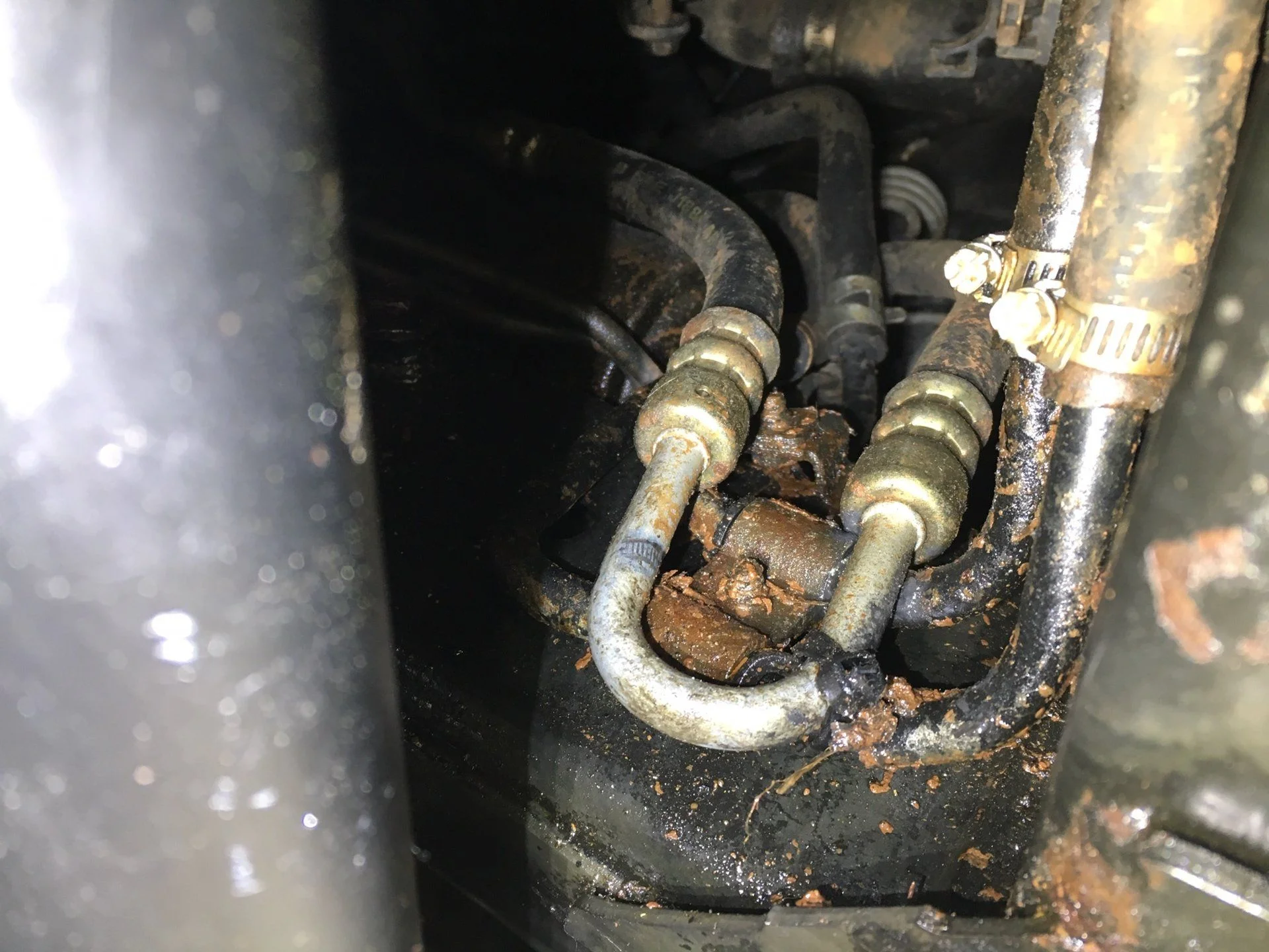

Steering gear box leaking.

Steering cooler bypass hose. Not sure why this was done.
Radiator. Exhaust gas + coolant + water.
Leaking steering gearbox. Photo does not show all the oil. It's like a river of oil from it.

Anyone have OEM power steering coolers they are no longer using? Else, I will go after market.
I would go aftermarket on that, the OEM "paperclip" is kind of silly.

Anyone have knowledge of why the oil cooler would have been bypassed?
engine oil cooler or trans oil cooler? engine oil cooler is mounted to the block under the exhaust manifolds so the only sort of bypass would be to loop the coolant lines together, could have been leaking coolant into the oil maybe.
as for the ps cooler I would just cut out he paperclip and go with a generic trans cooler, I got one from napa for 30 or so when mine started leaking

@bigredmachine - That would be great if you could provide some information about the machine shop. It's the power steering cooler. Paperclip cooler was removed at some point and a rubber hose installed as a jumper. Not sure why. Trans cooler will be my choice.

The PS paperclip likely sprung a leak and was bypassed because it's pricey to replace. At least that is my recollection when one of my did that. The trans cooler is integrated into the bottom of the radiator.

Also, based on the pic of your radiator cap, it seems the PO may have used BARS stop leak to cure the head gasket. Enjoy that .... it's everywhere and never seems to go away. The PO of my wheeling rig did the same thing and I've drained the system probably a dozen times, ran it with a hose on one end and draining out of the other for hours and put in a new radiator and most all of the other cooling system parts and it is still everywhere.
