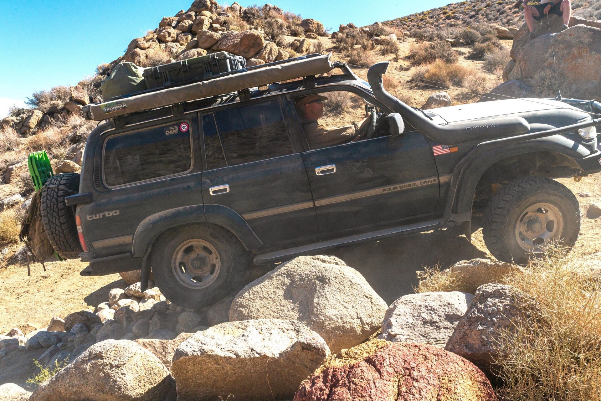

GregView attachment 3715276
What tires and rims are those?
Do you guys think it would be worth to the marks part time swap at the same time as the knuckle rebuild? Going to be in there already
JDM Steel wheels. I repainted them with Krylon Dark Metal Metallic paint
Toyota 42601-60362
Cooper ST/Maxx 255/85-16. These are my favorite tires-have had BFG, Toyo, Goodyear and Nitto. These have lasted longer, are quieter and better all around for noise, dirt, rocks, wet and snow, IMO. I'm currently over 30,000 miles on this set with lots of tread to go.
