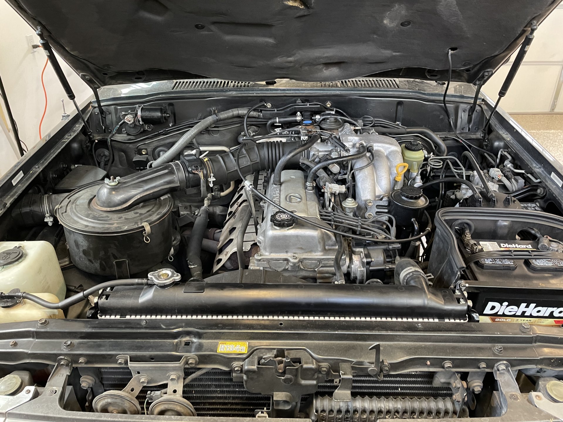

I recently sold an 80 that I built and had an itch to do another. The last one was 3x locked, 150k miles, oem sub tank, Magnuson supercharger, OEM quad lights, and all maintenance completed with many upgrades from brand names like Wits' End, LandTank, OME, Delta, ARB, and many others.

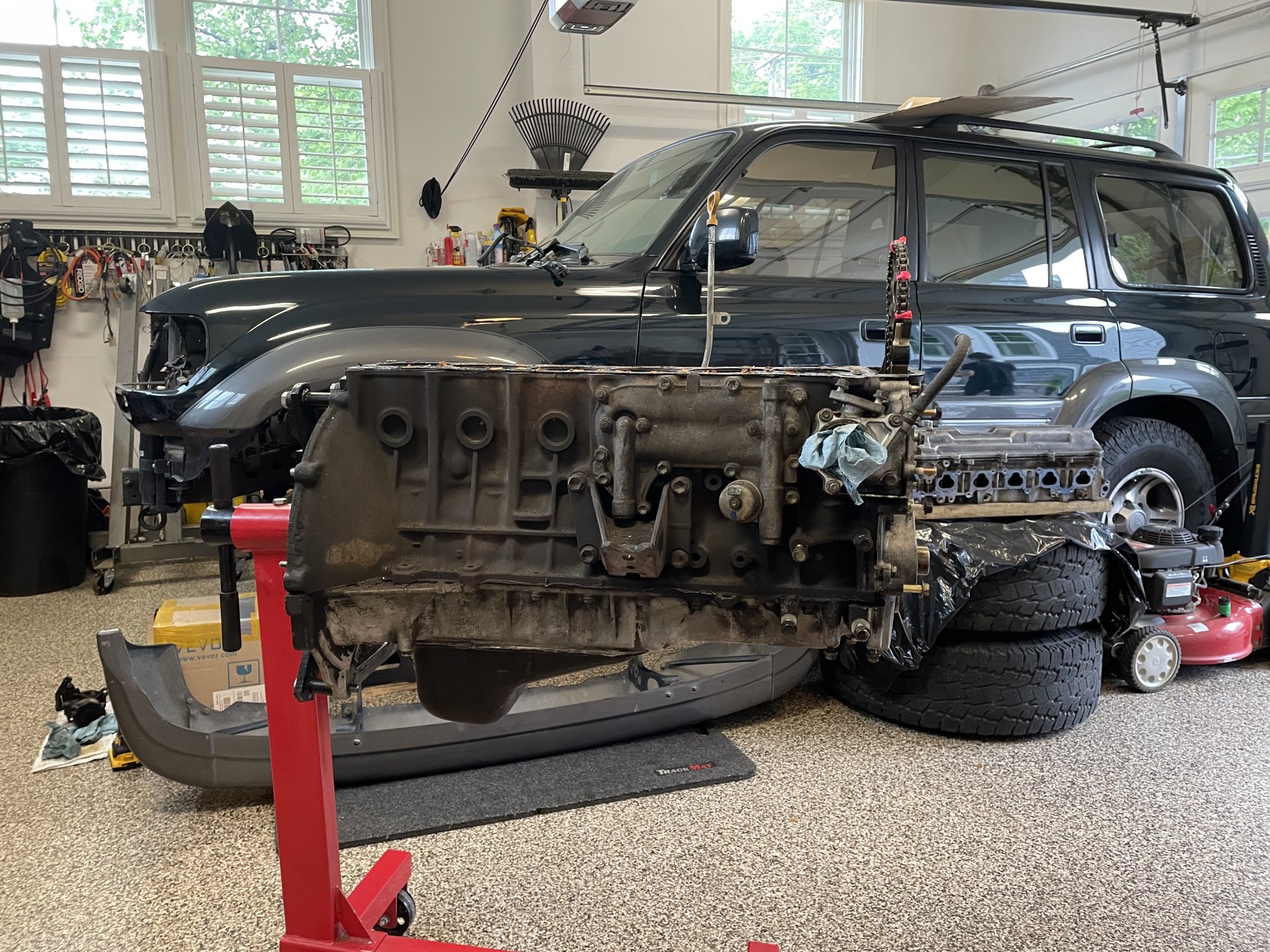

The new build starts with a higher mileage 80; 304,000 miles. It's a Texas car its entire life and serviced by the dealer every 3k with documentation. Even the catalytic converts were replaced by the dealer a few years back. The original owner had the dealer regularly service all components as most of us do on this forum. The head has never been off and shows no signs of head gasket failure. The body and frame are as rust free as they come and the paint sparkles like new.

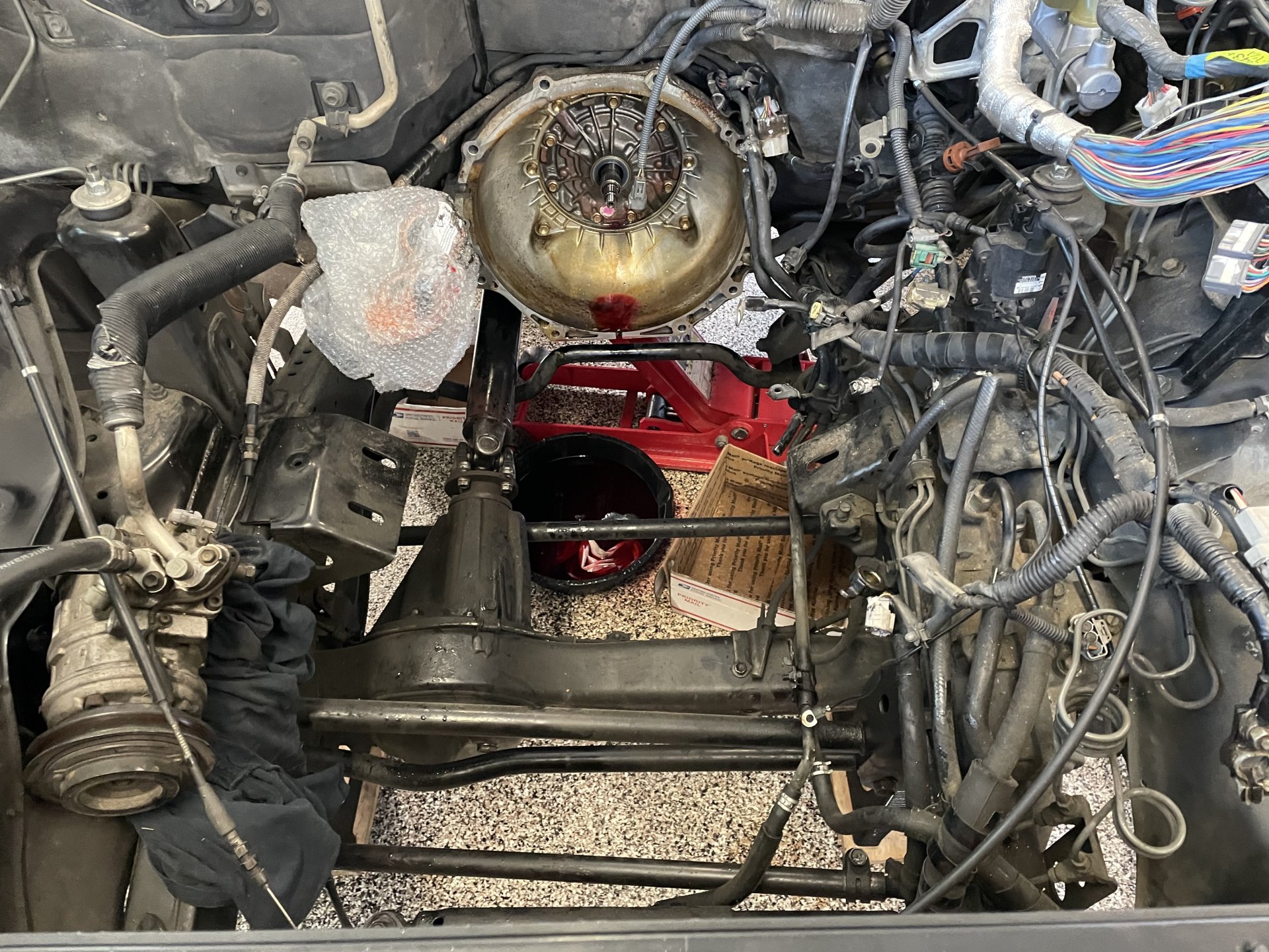

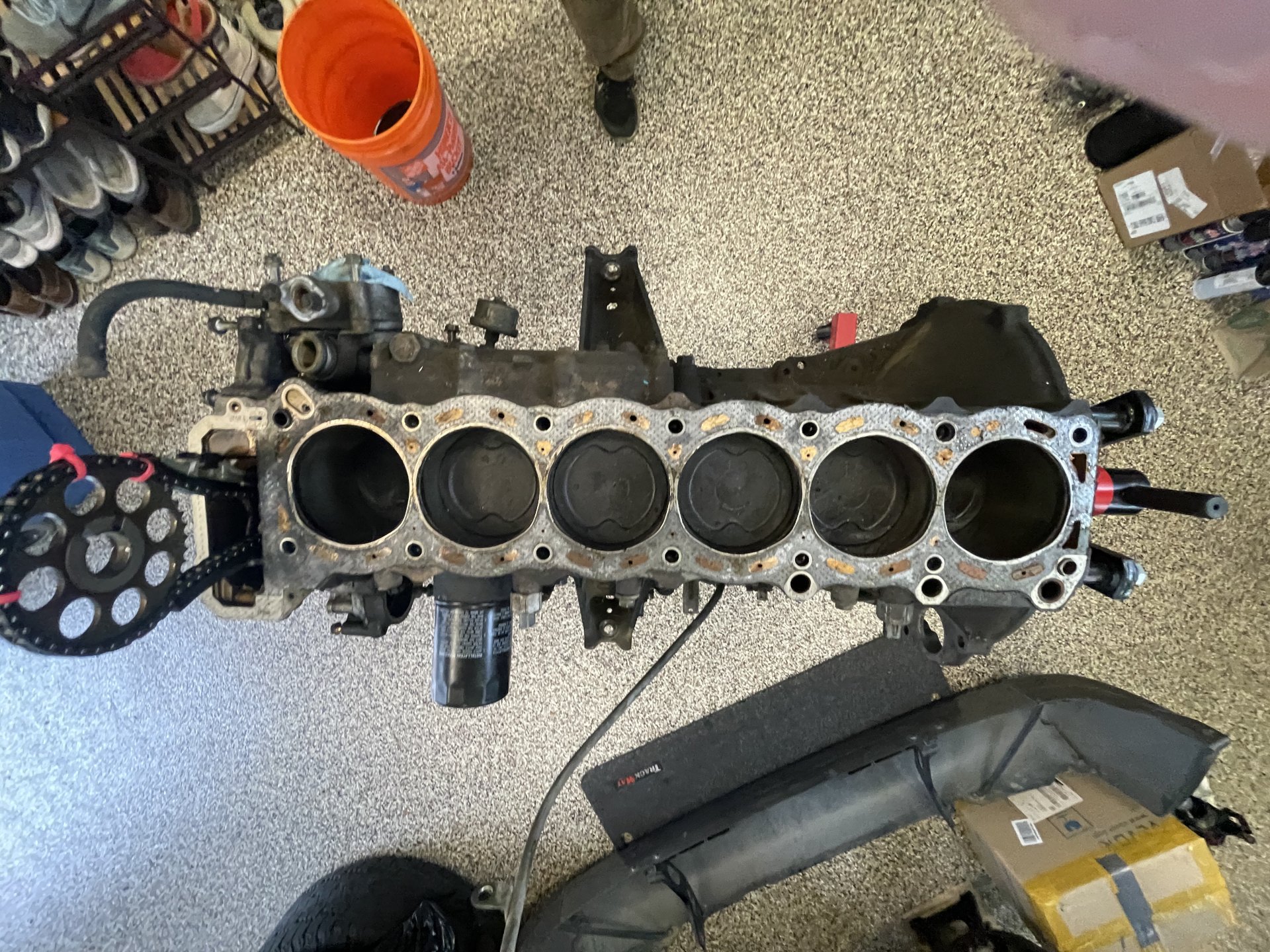

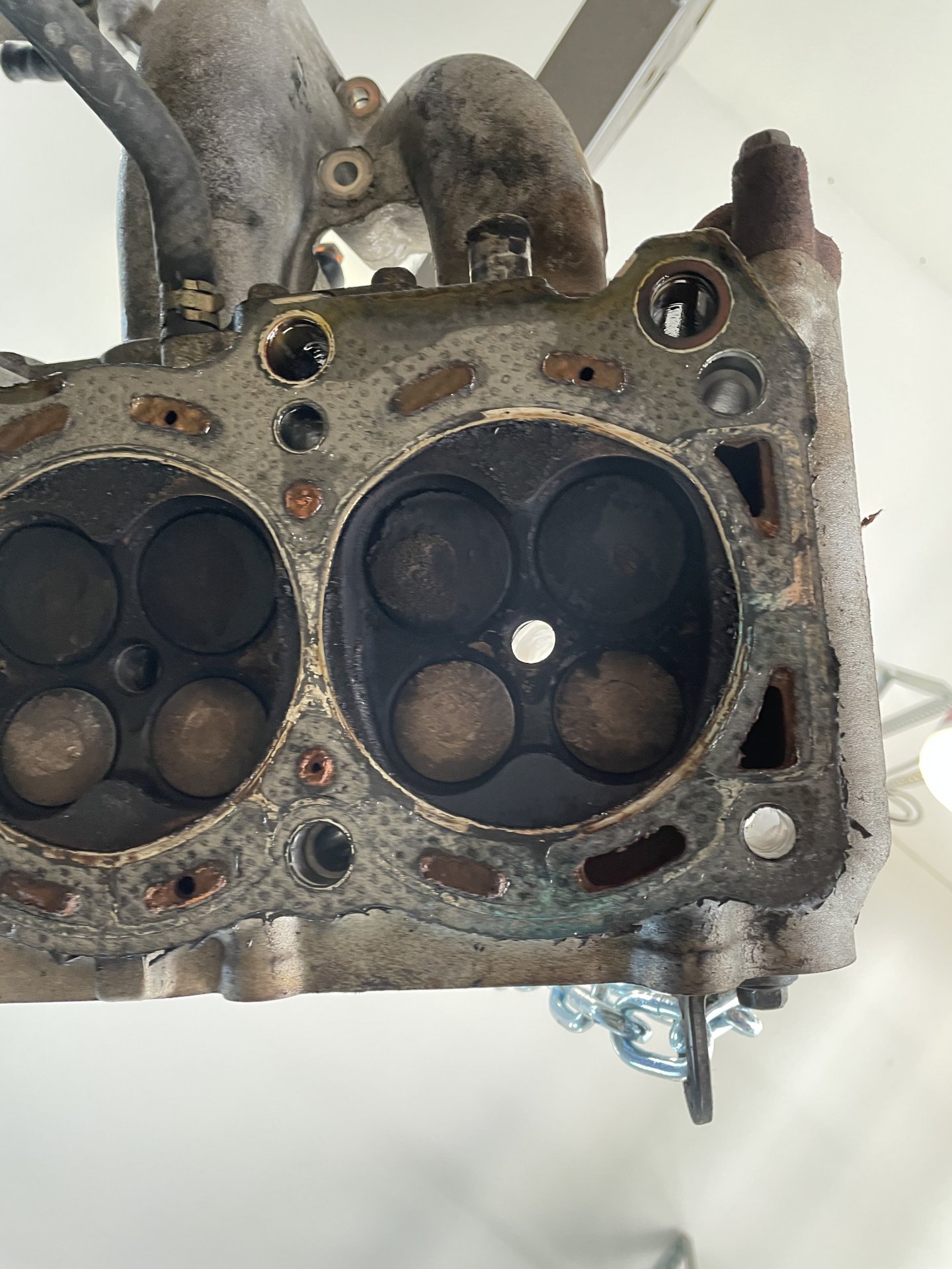

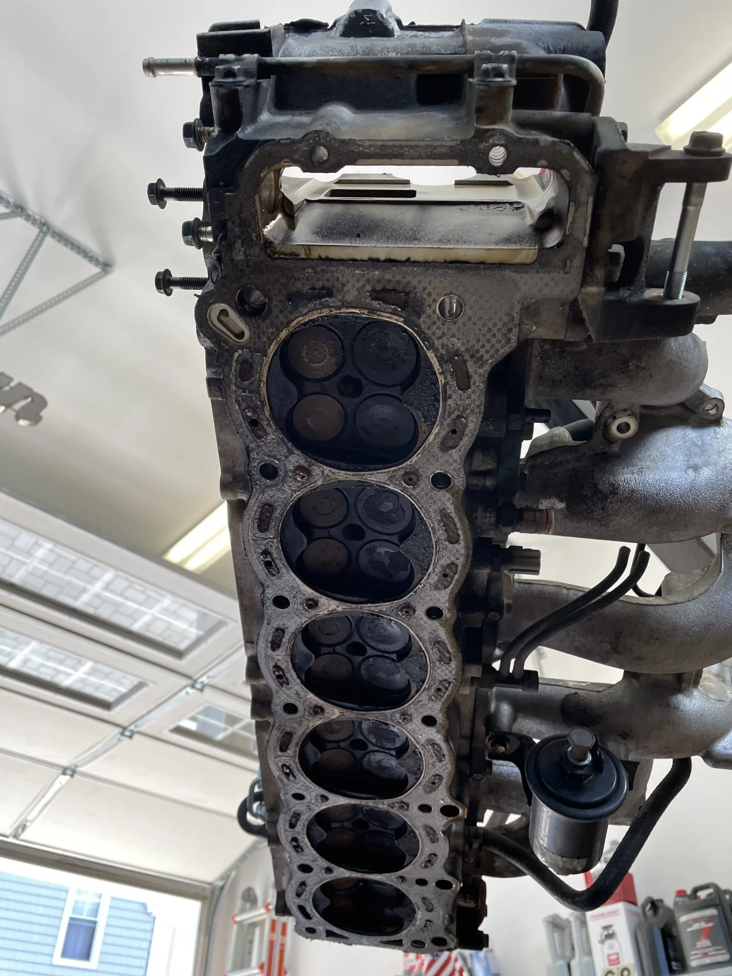

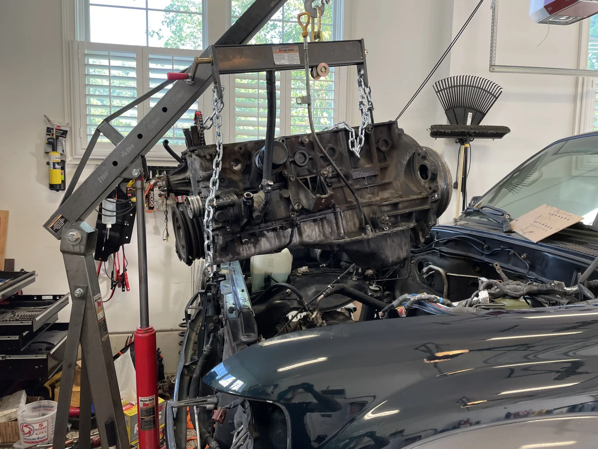

My initial plan was to remove the head to address the valves and update the head gasket as well as replace all the parts that are included with the overhaul kit. Once I had the head off I could either put it back together and let it run or remove the block to check on tolerances. The engine came out.
After some thought and consideration of how involved the engine rebuild is, lack of specific measuring tools, not so local machine shops, and not a ton of free time - I decided to buy an OEM short block from Toyota and save the original block for when time allows a proper rebuild or sell it to another member who has time. Toyota informed me that only 3 short blocks are available nationwide. I have heard the same thing over the years from other members doing builds so I don't know if those numbers are true or how it actually works. The engine is supposed to be here in a week.

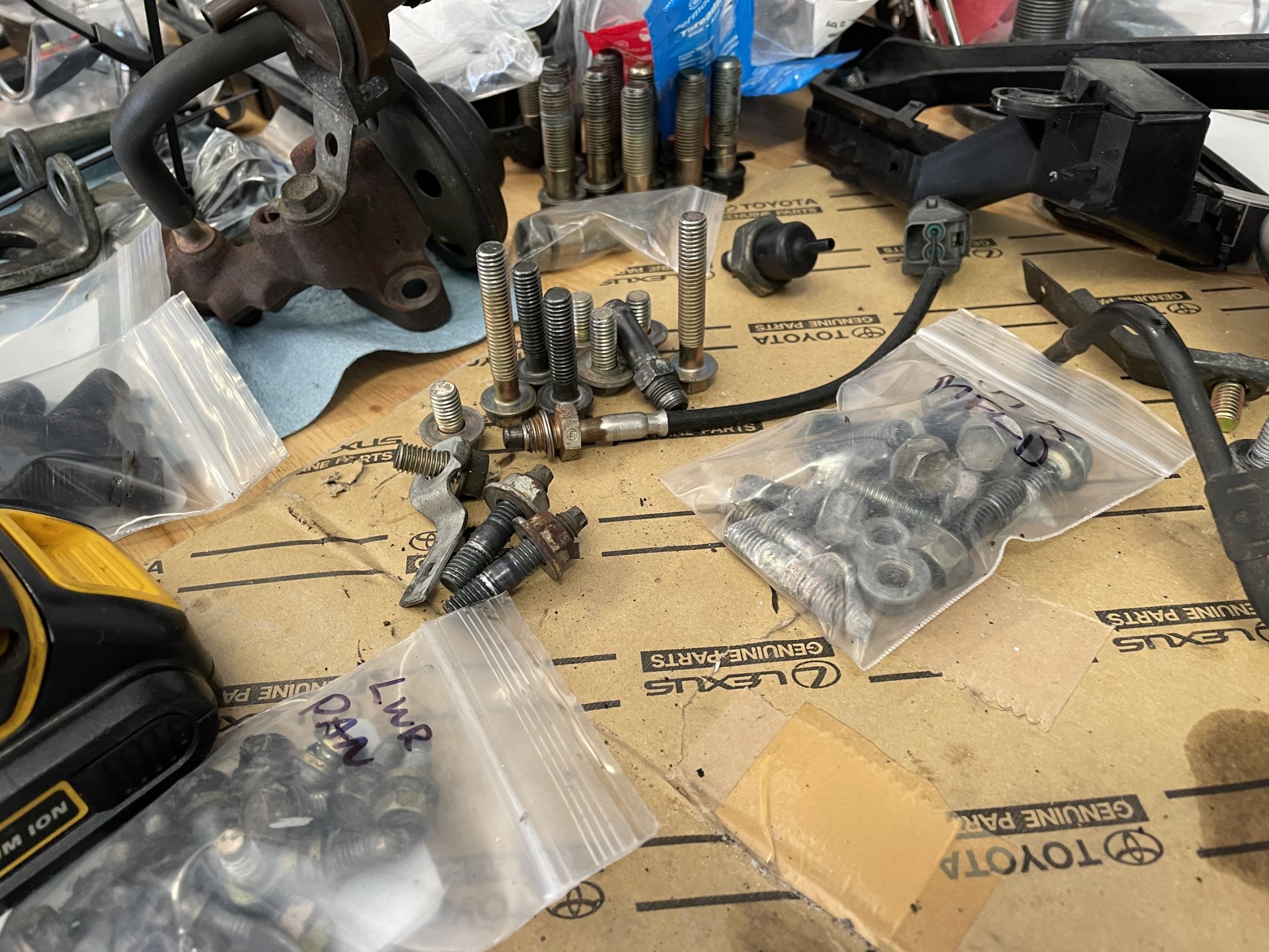

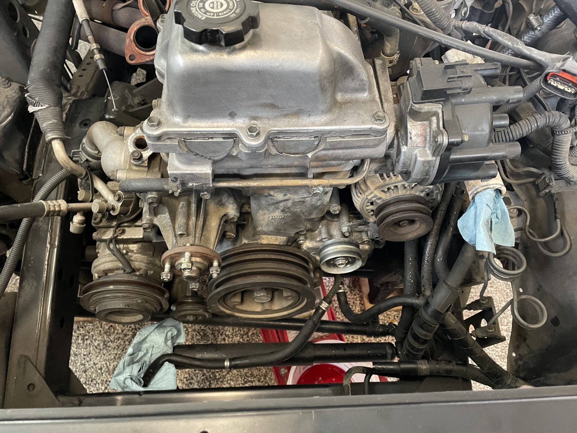

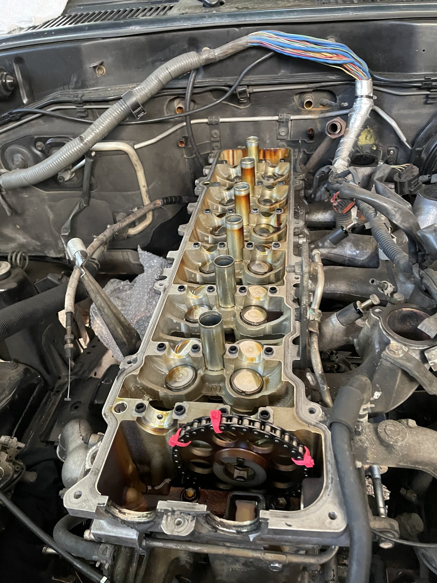

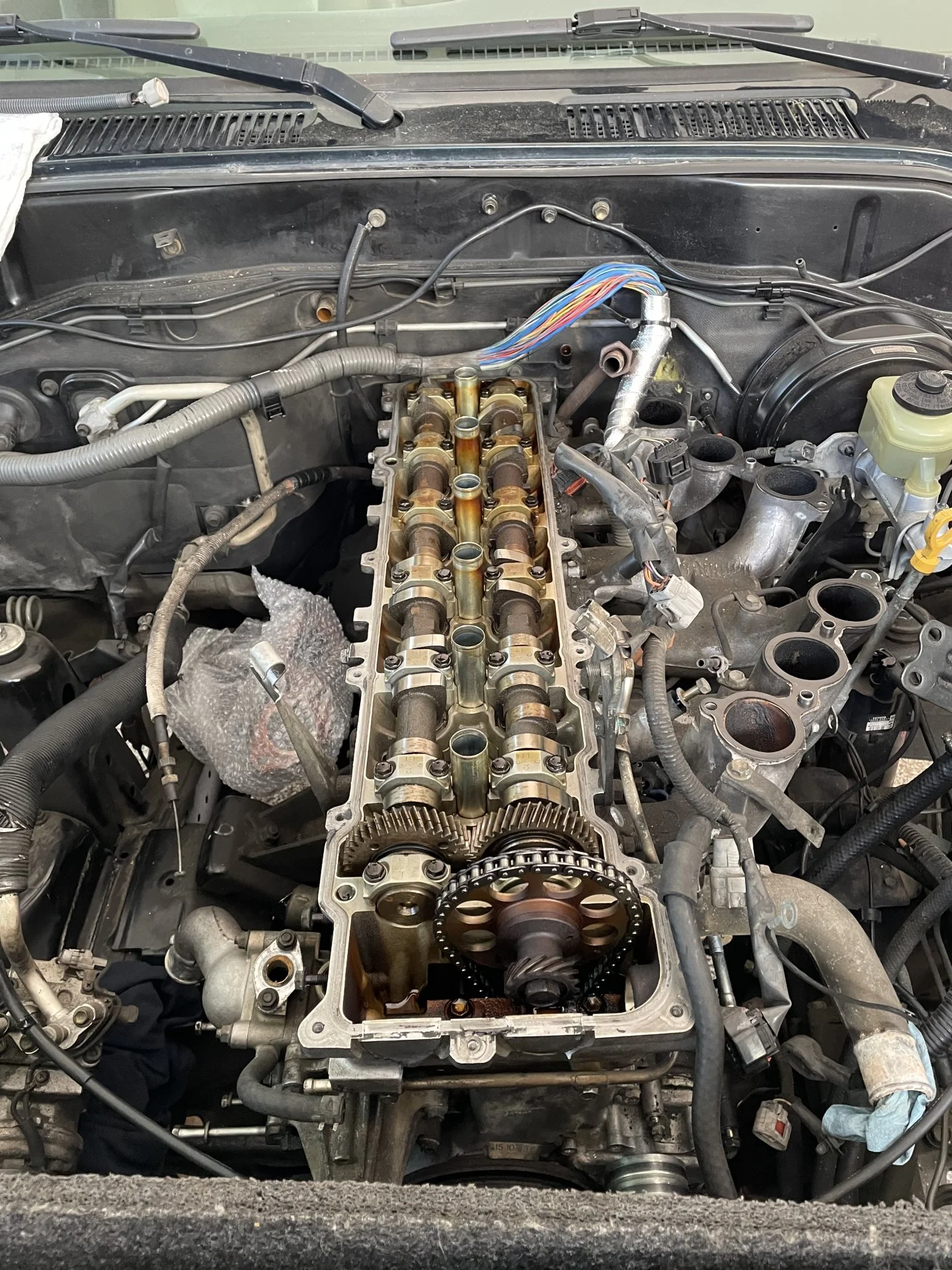

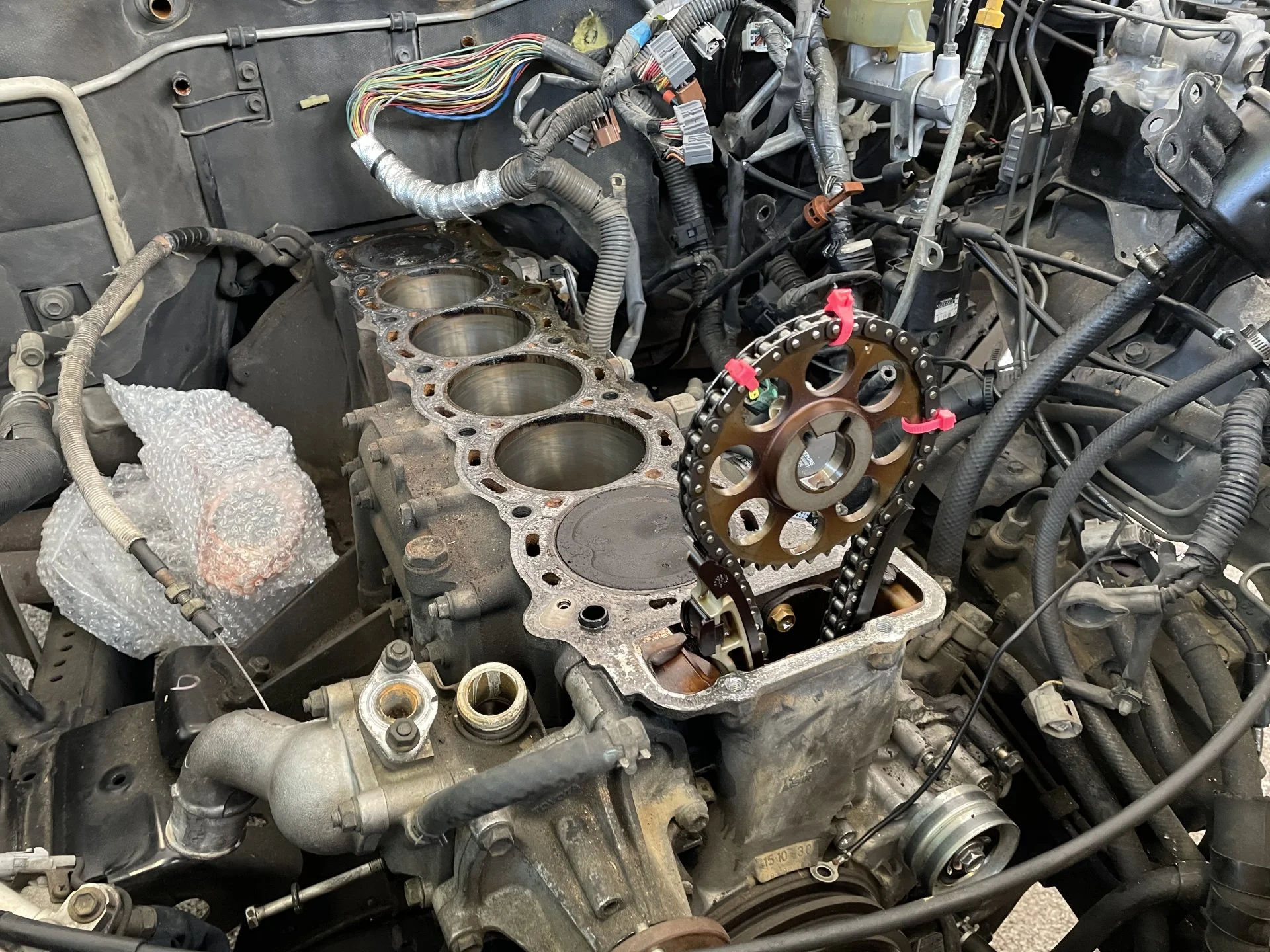

I removed just the engine. No trans. I do all work alone so in order to separate the engine from trans I removed the head first. I can then reach the top two bolts from the top without any issues. I will get a very long extension when installing the full assembly. It was really easy to get to from the top once the head was off.

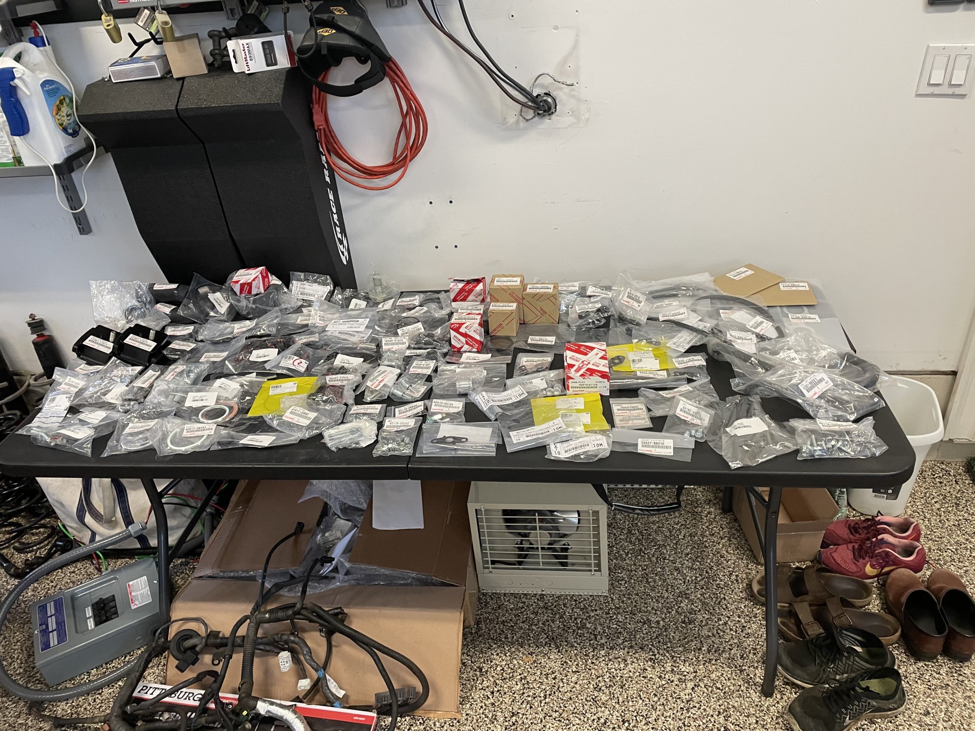

- Machine and rebuild the head with new guides and seals.
- Replace all wear parts such as chain guides, seals, o-rings, and hardware. More parts will be listed as they are bolted on.

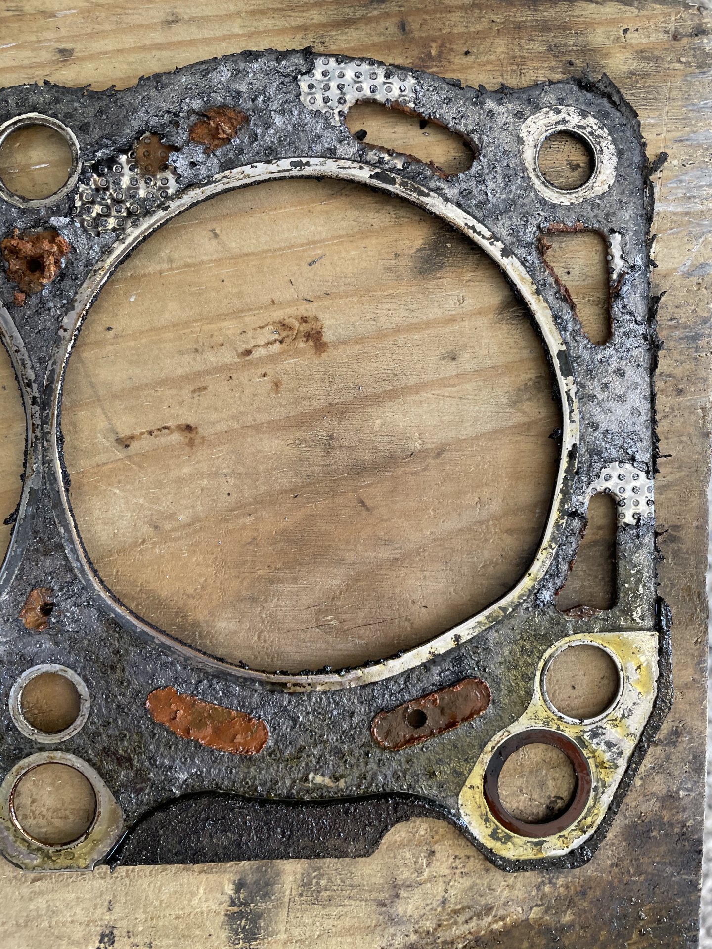

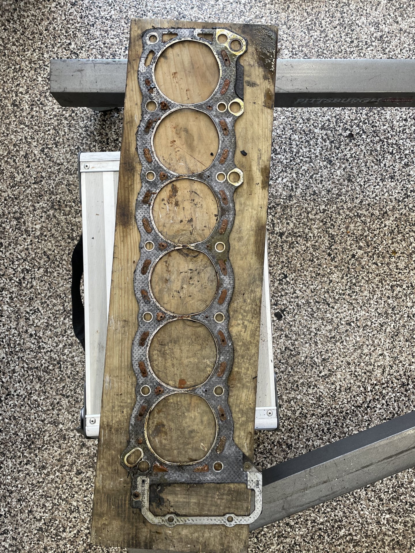

- Install Cometic MLS gasket (part # C-4530-053). Waiting on delivery but taking longer than normal. Anyone have one sitting around?
- Install ARP studs (part # 209-4702, Opel V6) Waiting on delivery but taking longer than normal. Anyone have one sitting around?

- Replace vacuum lines and vacuum switching valves.

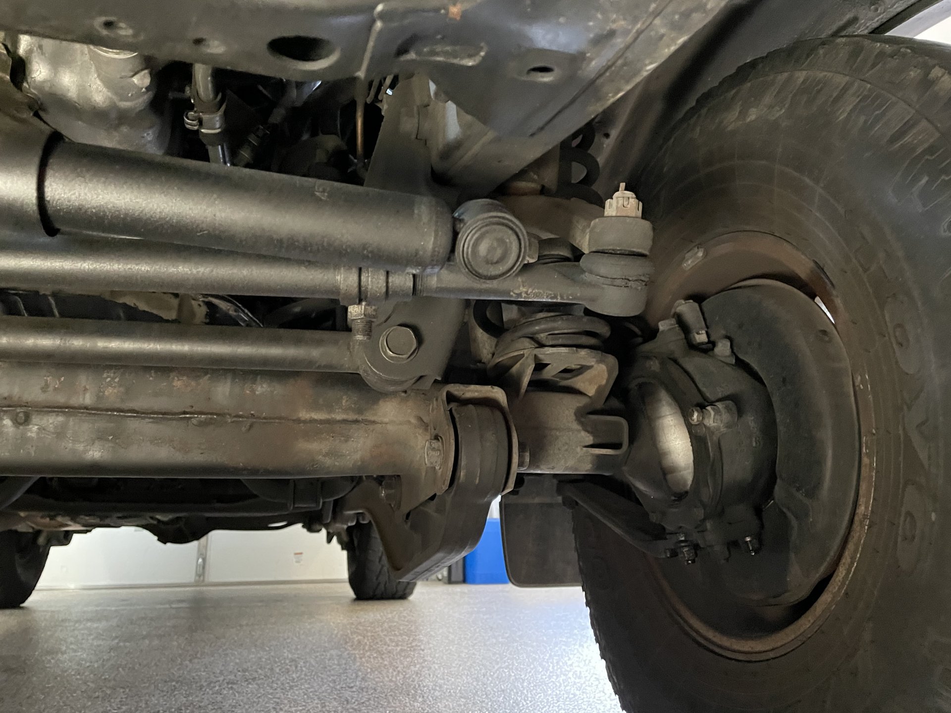

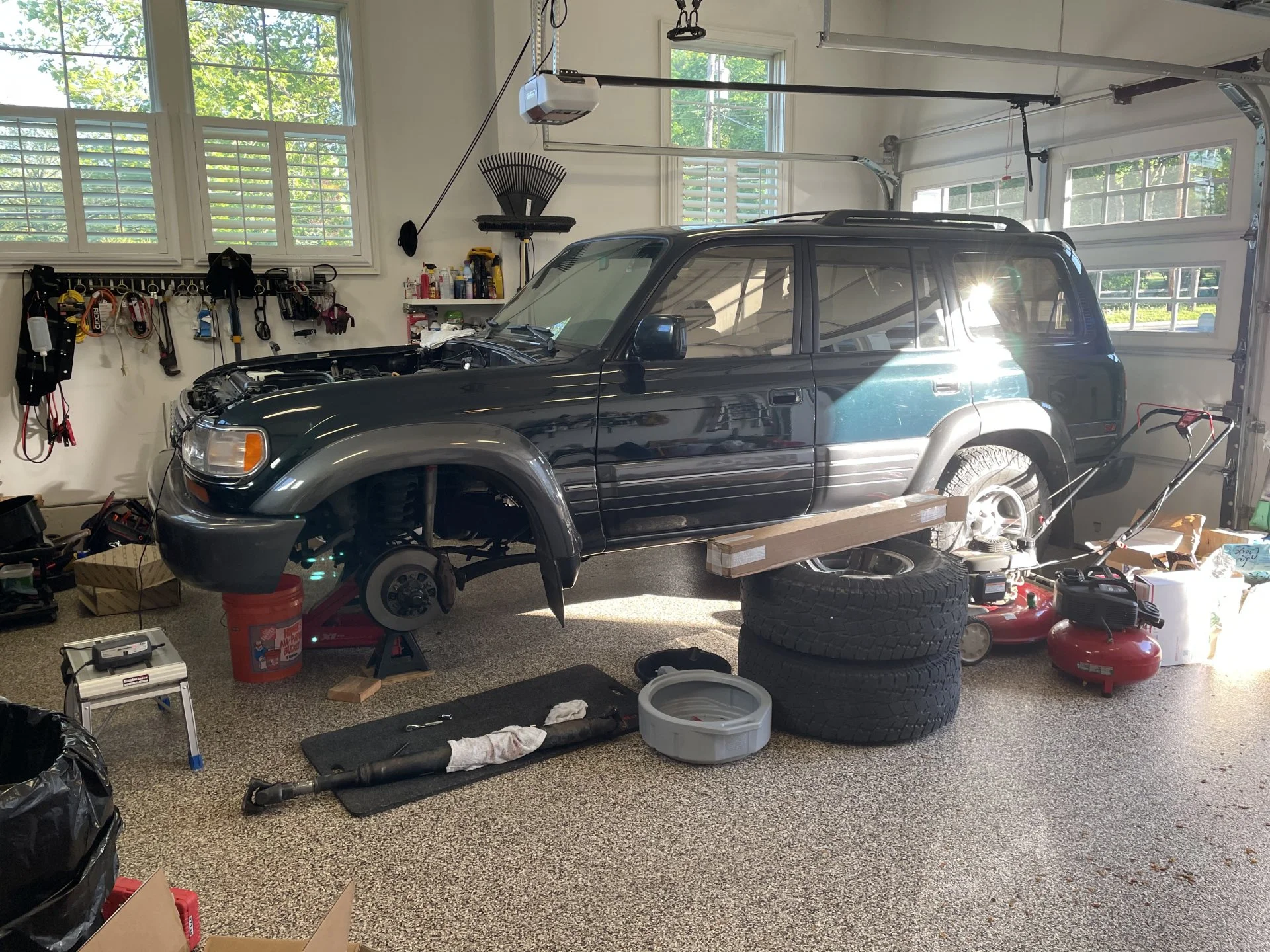

- Rebuild front axle. Completed 5/15/2021

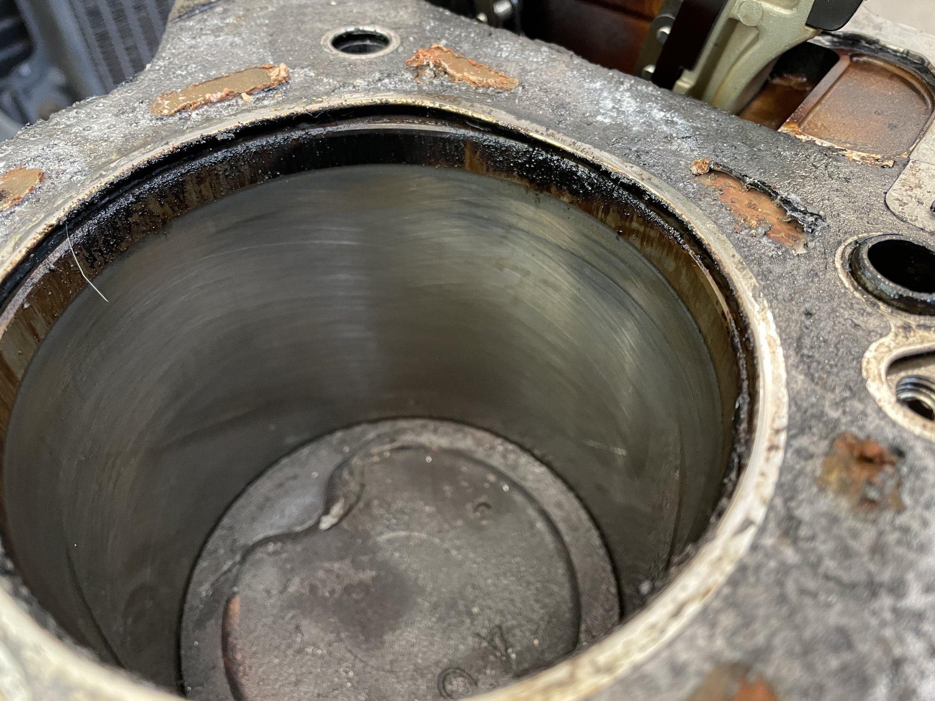

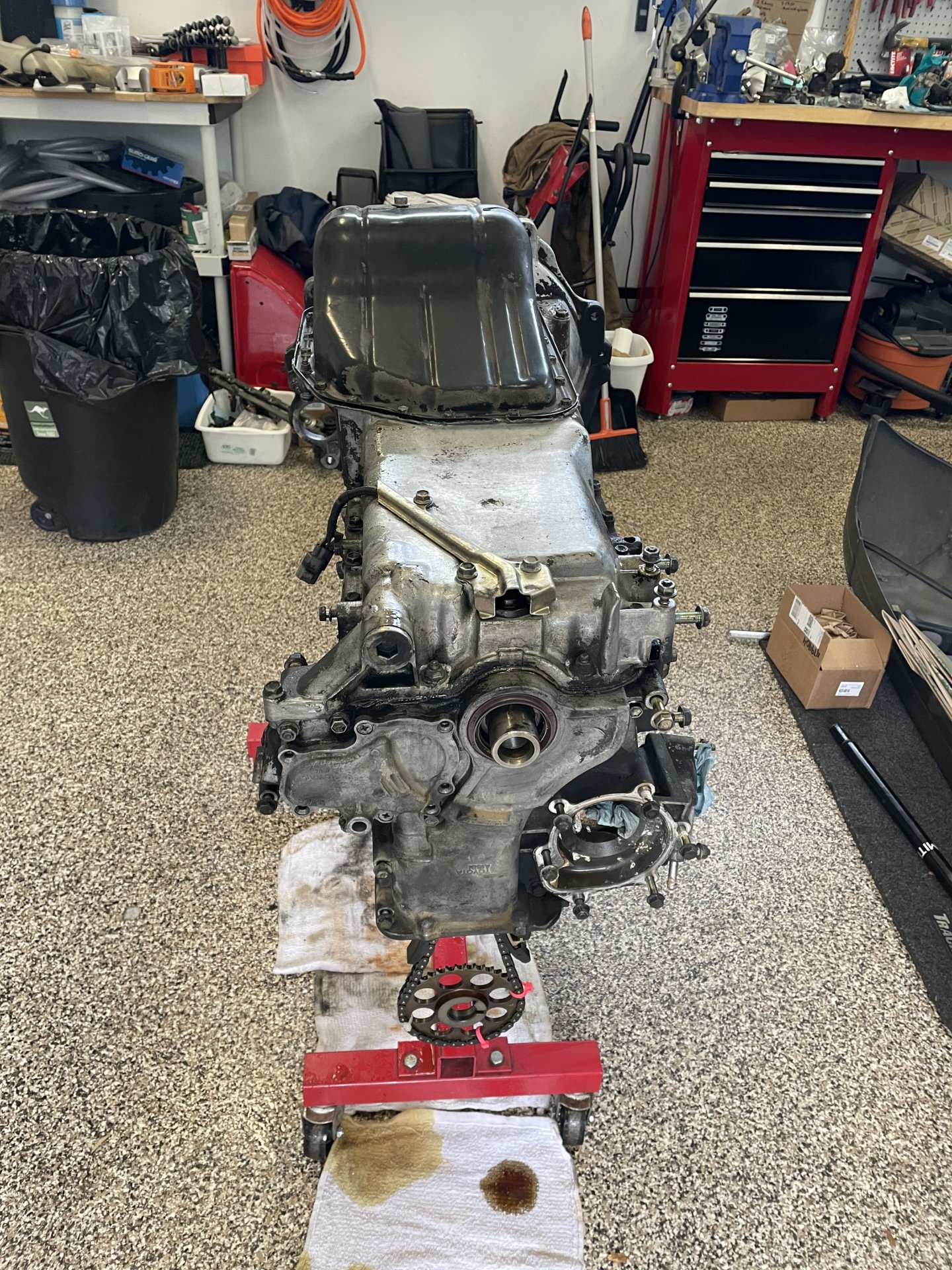

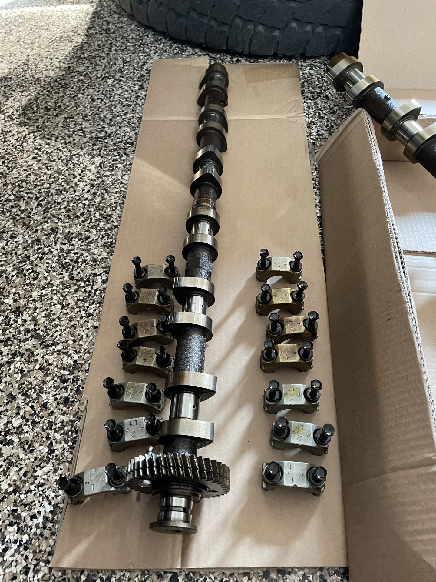

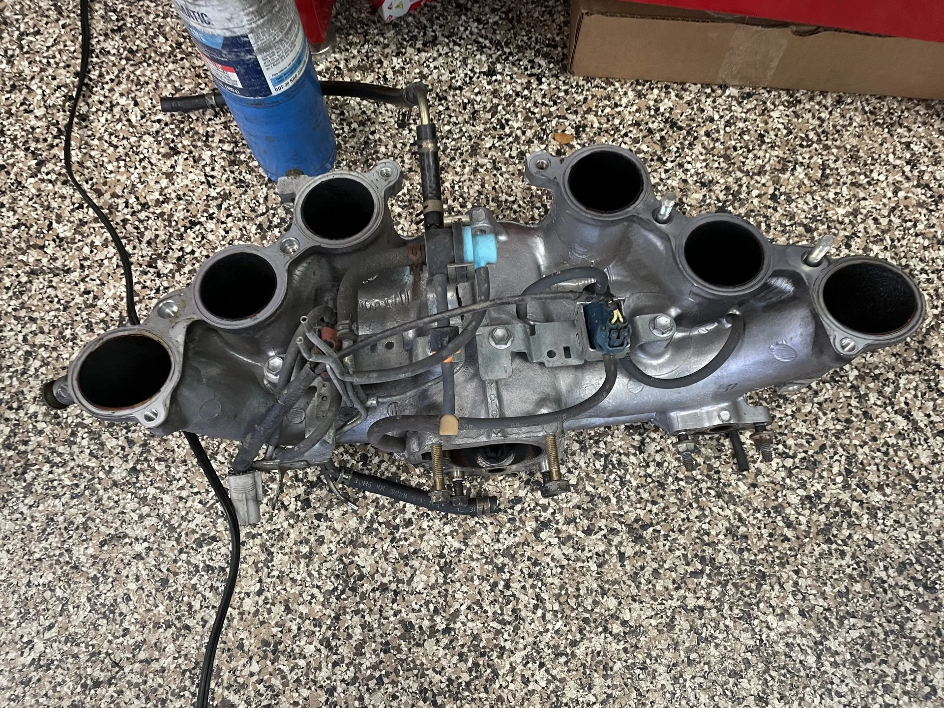

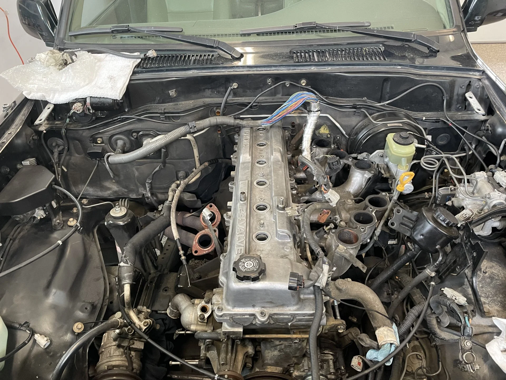

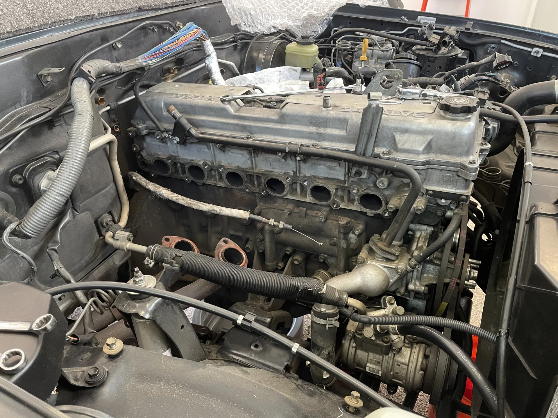

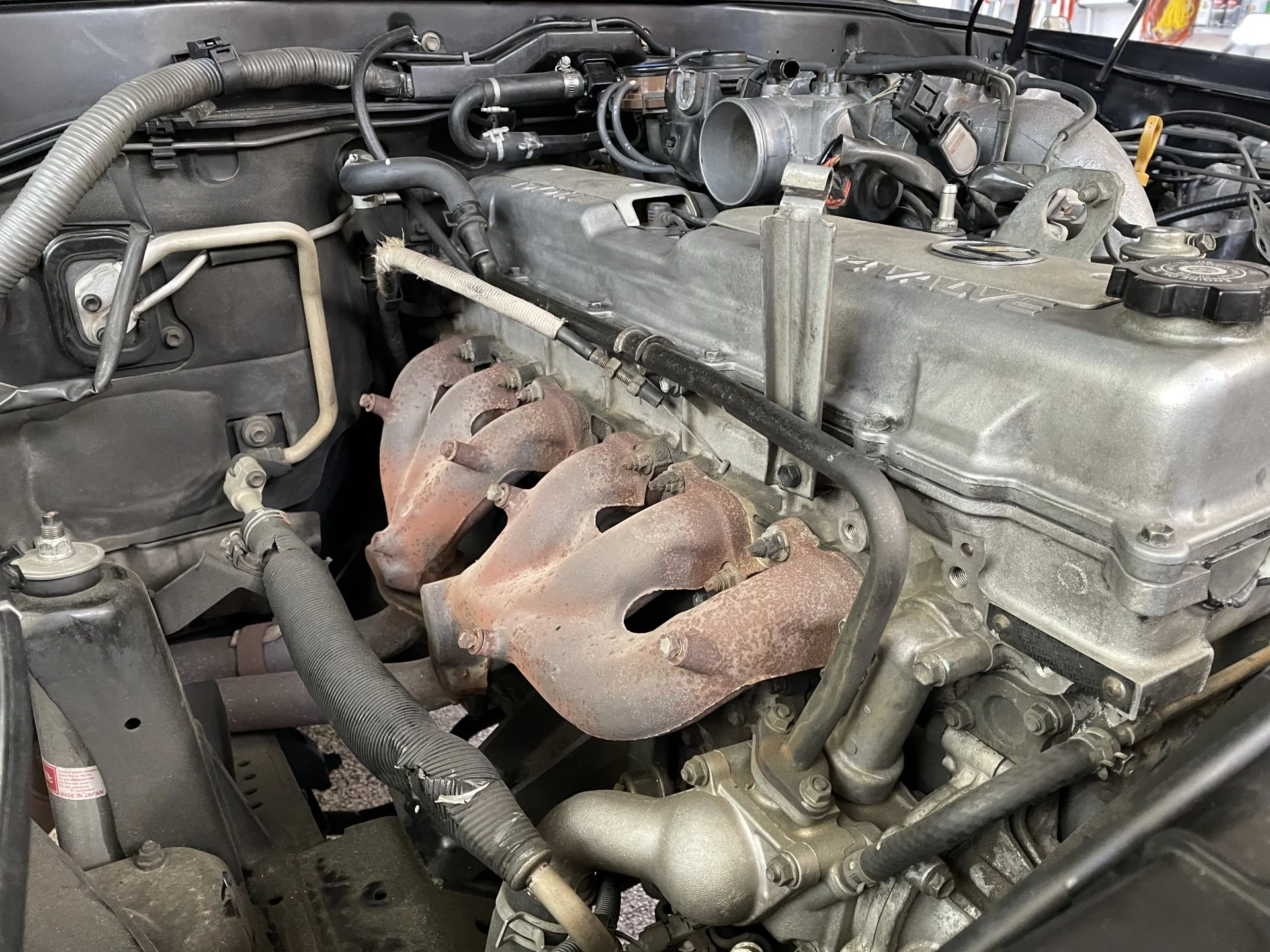

Here are some photos of the truck and progress photos. Engine is in really good condition. Shows little to no wear by visual inspection. Anyone interested in a clean short block for a project?

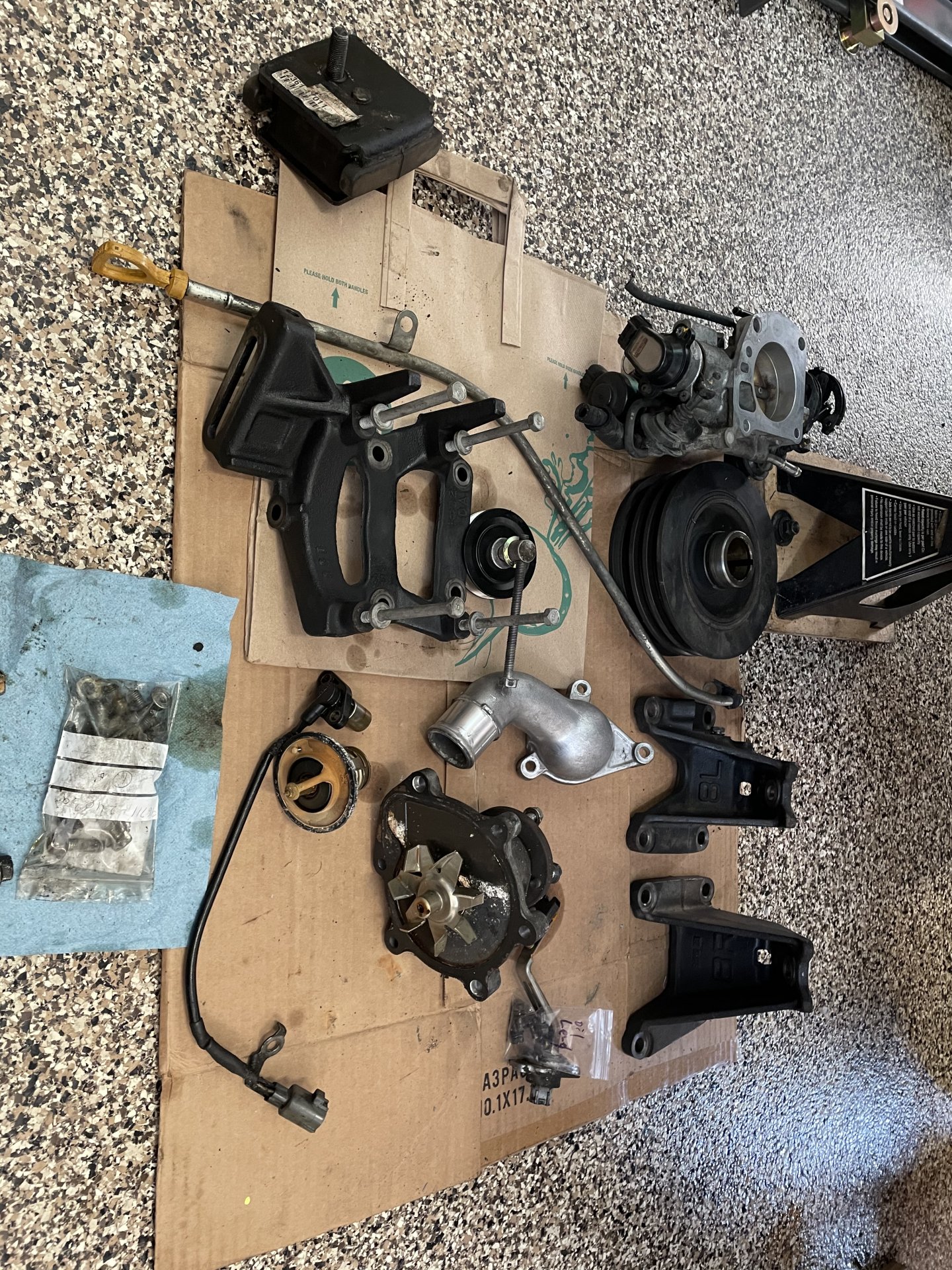

Some more:

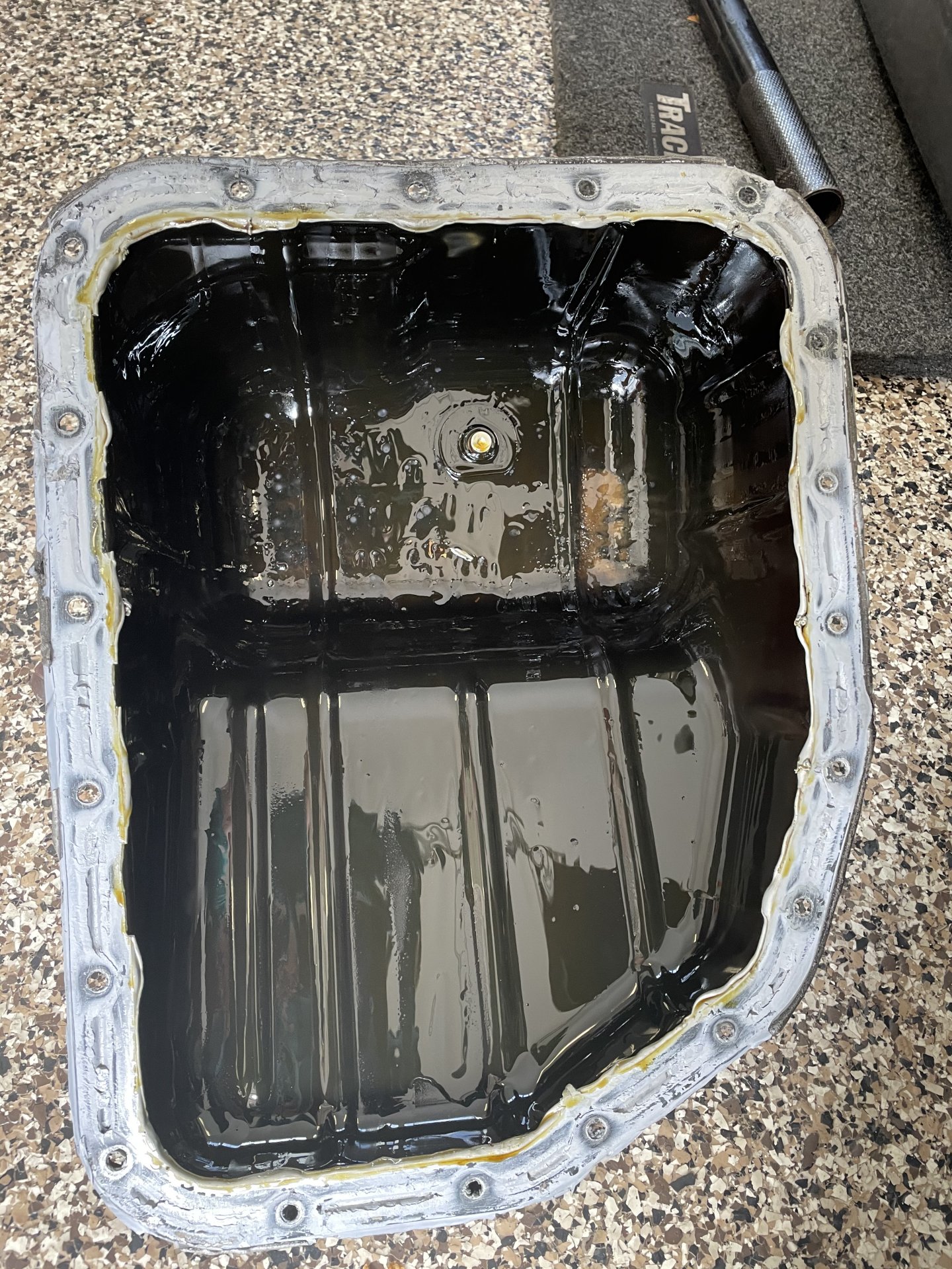

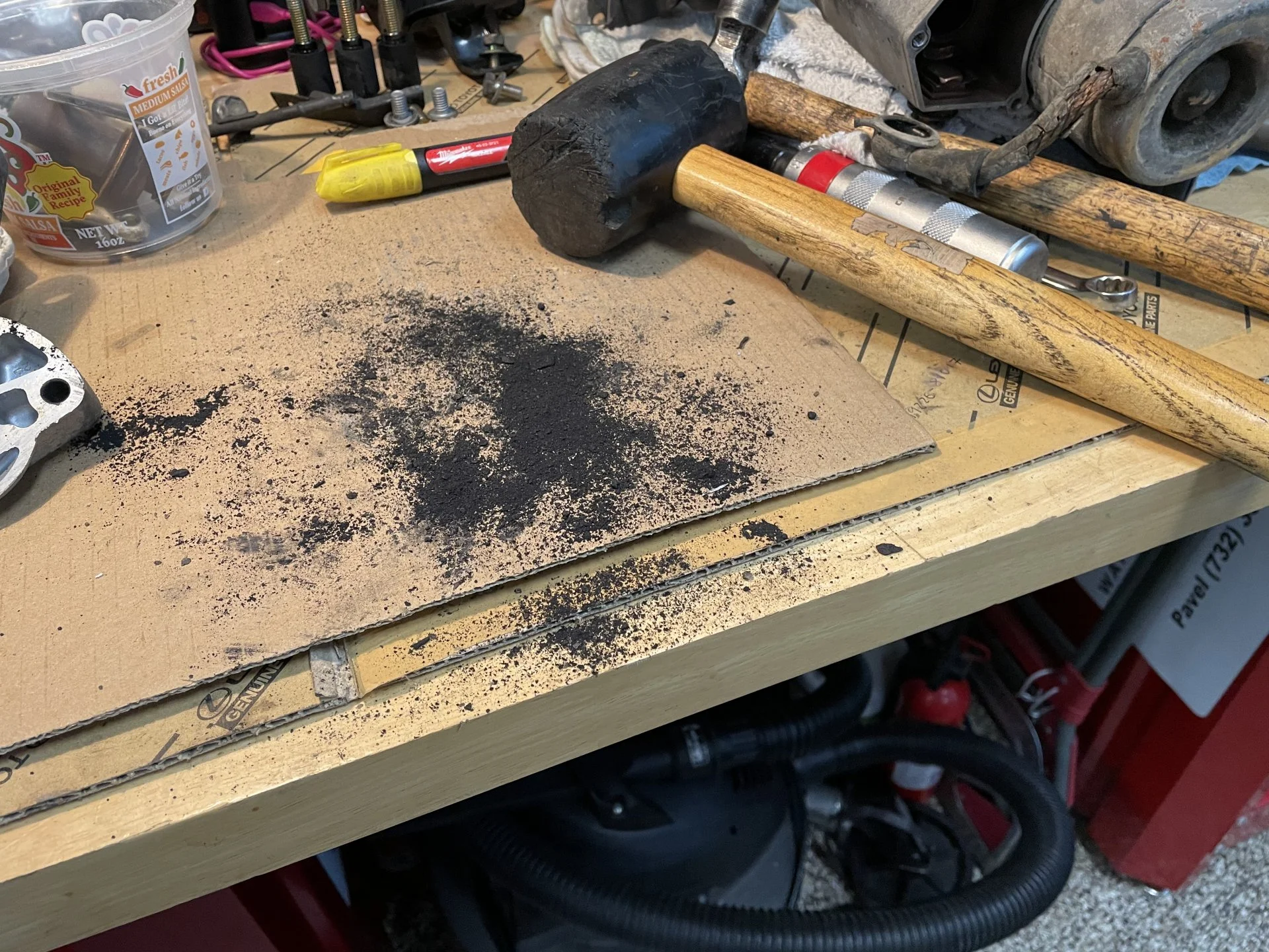

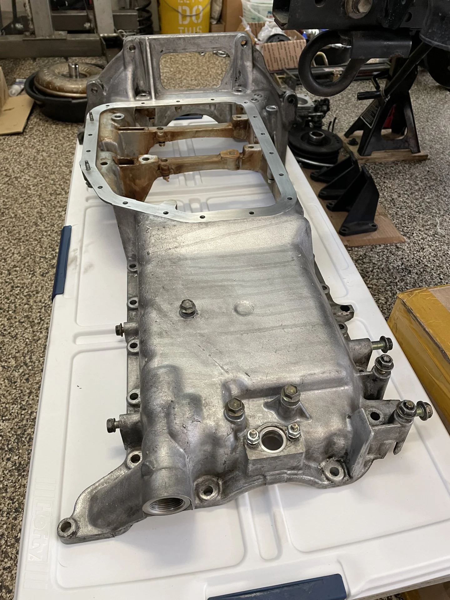

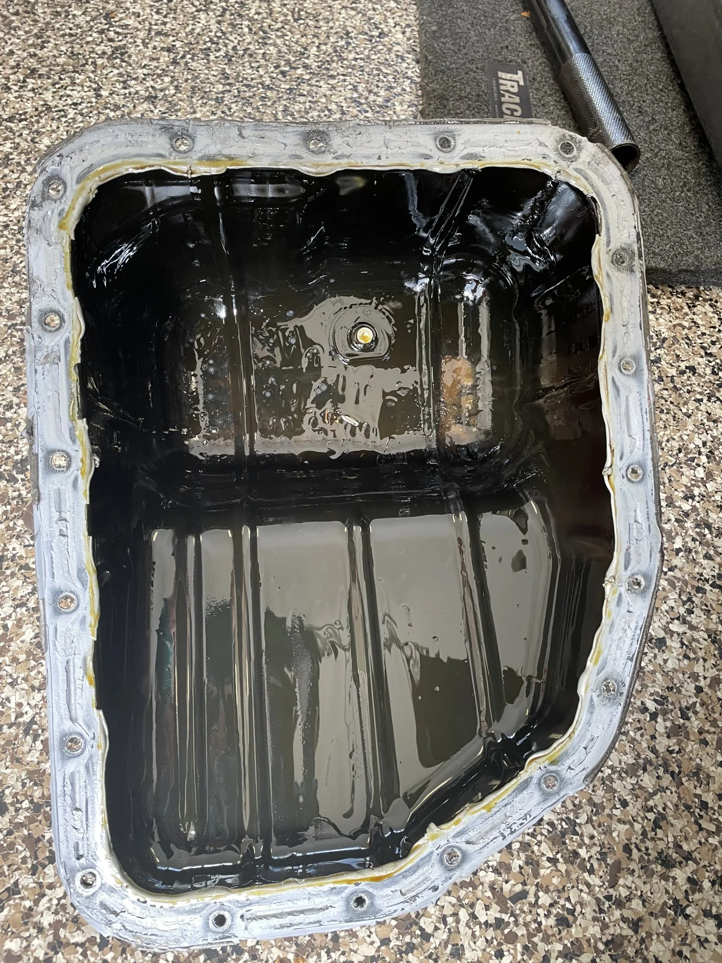

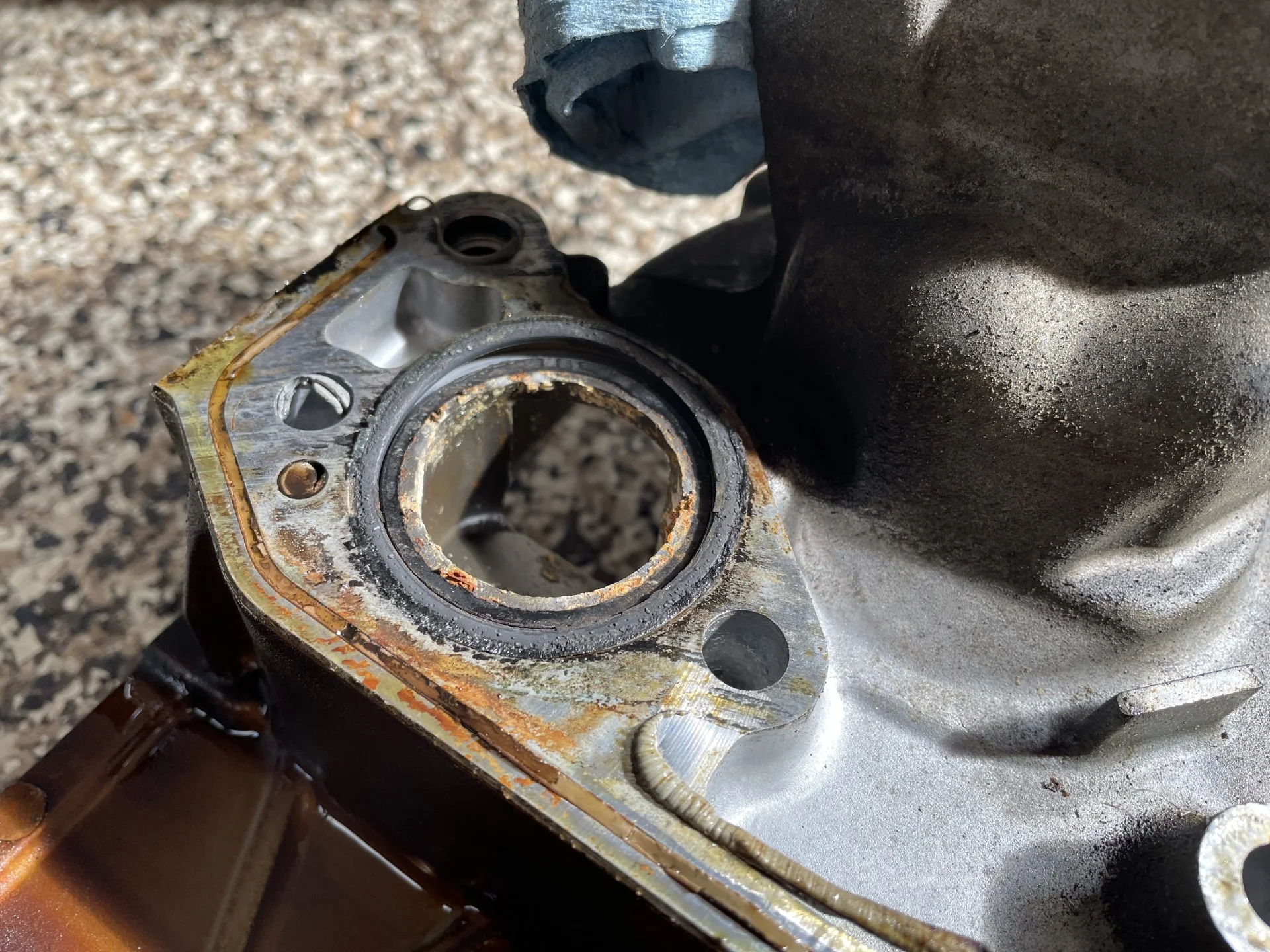

Leftover form in place gasket material from last oil pan reseal.
Not much to show for.

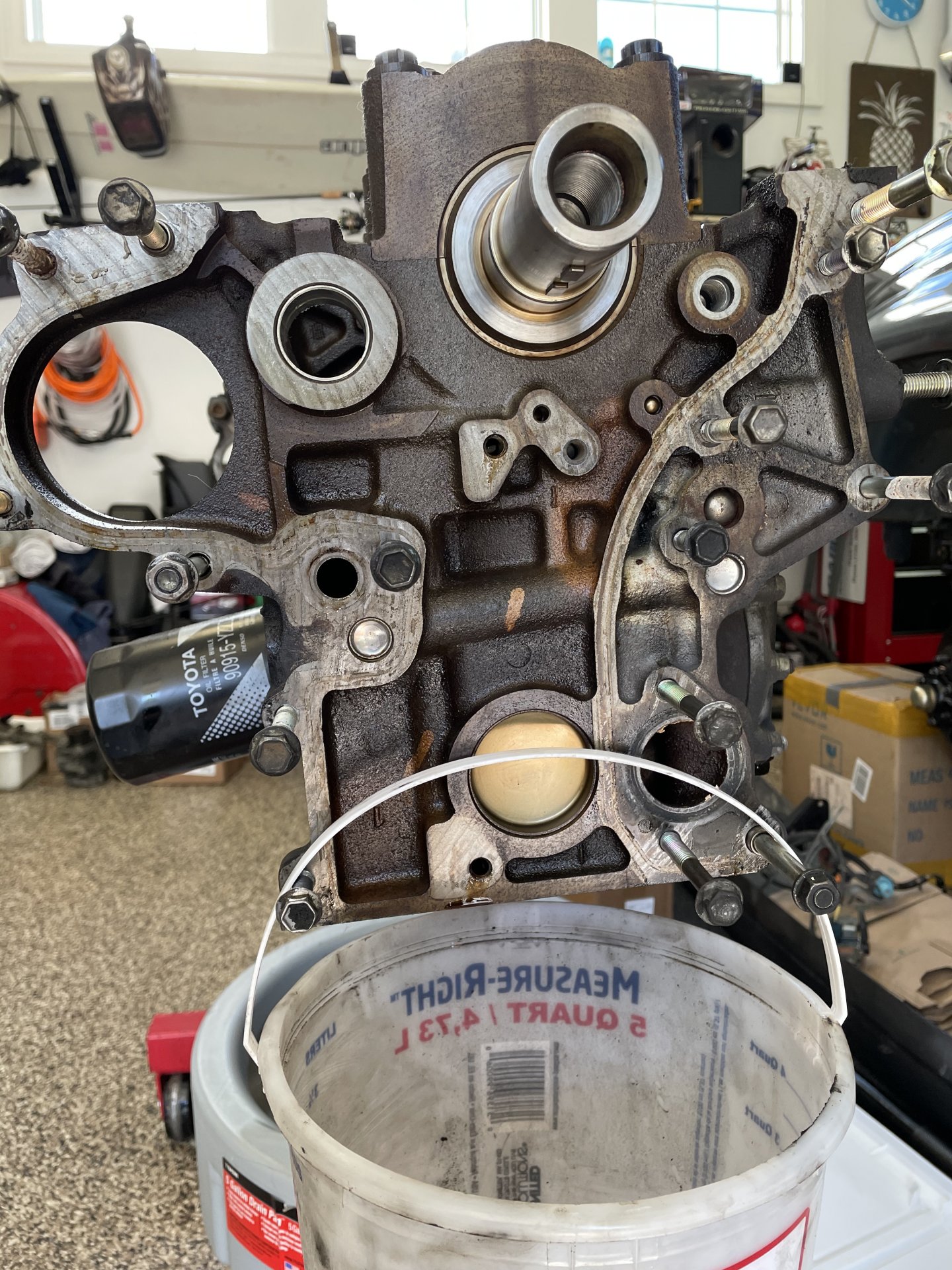

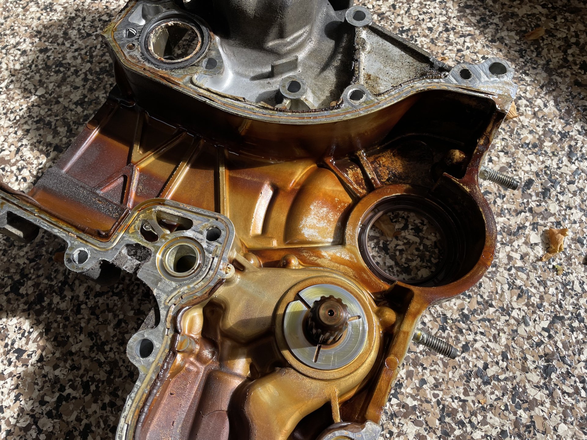

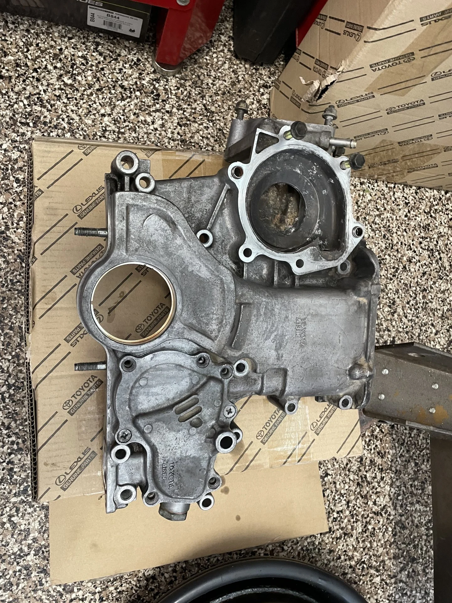

front engine cover. Will be replaced with new for cosmetic purposes. Nothing wrong with this one if anyone needs one.

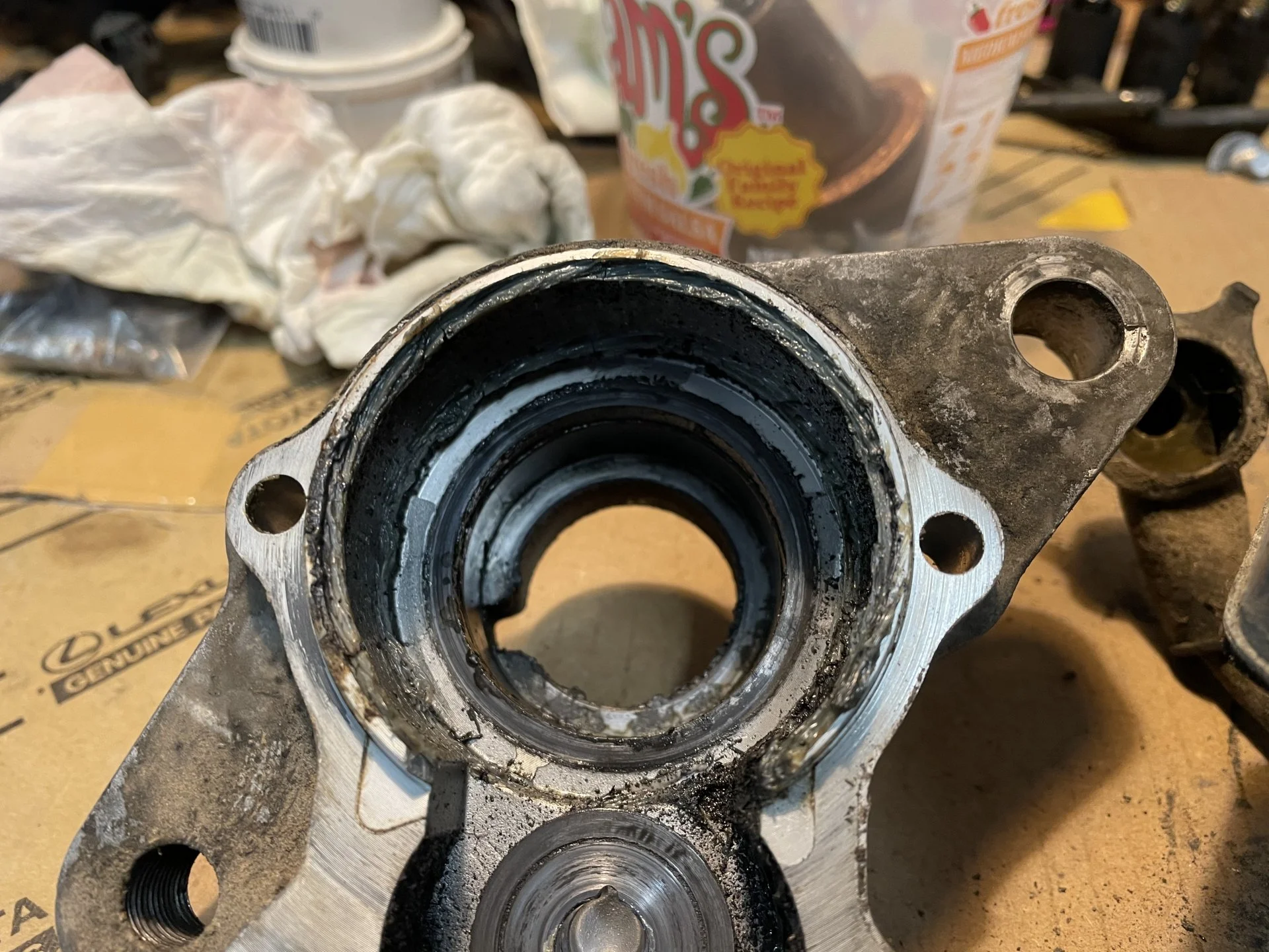

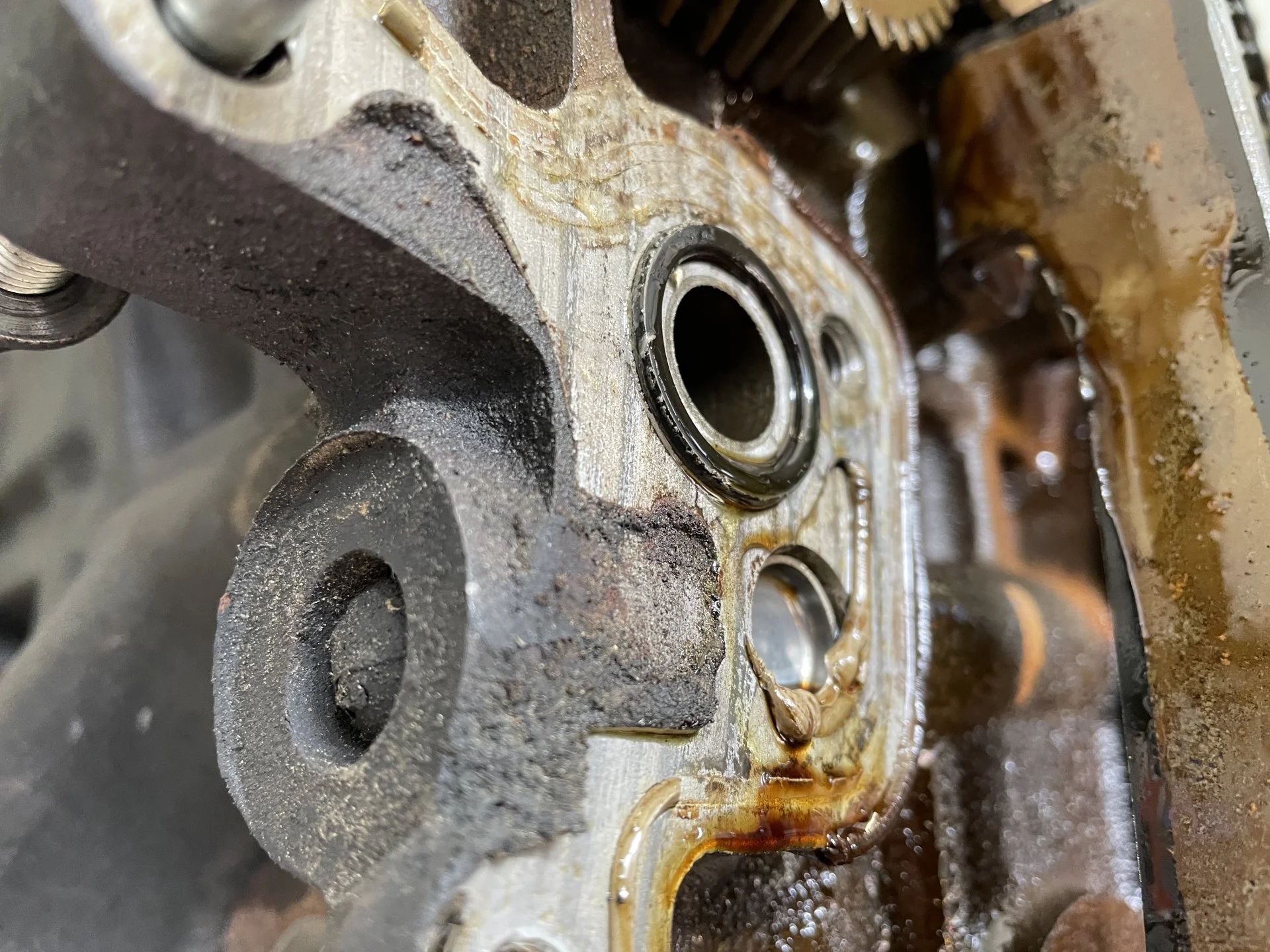

Another o-ring on the front engine cover that fails and causes some oil to seep out by the water pump.

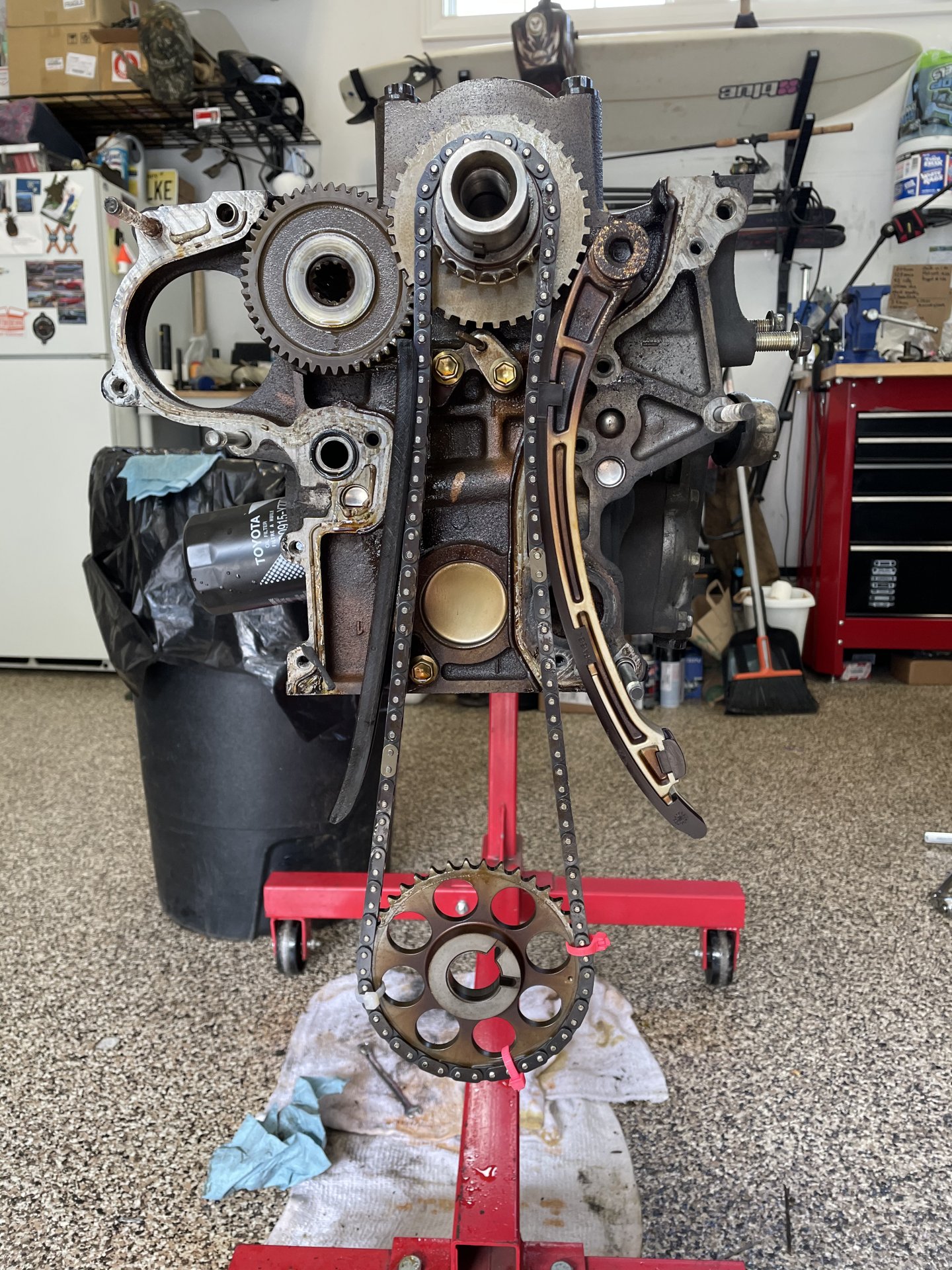

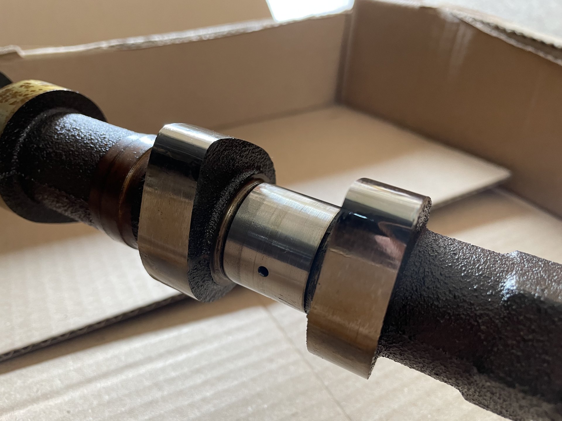

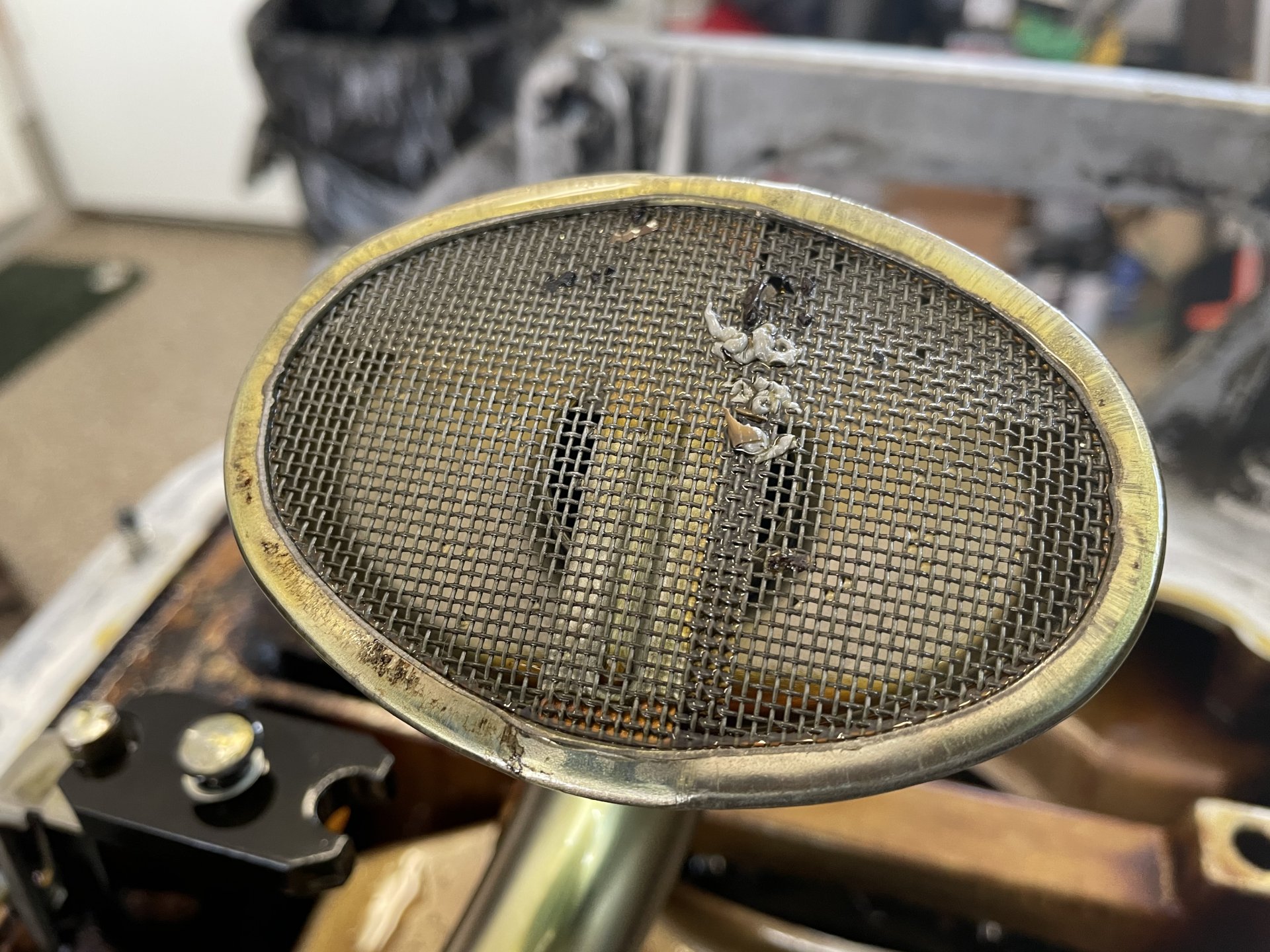

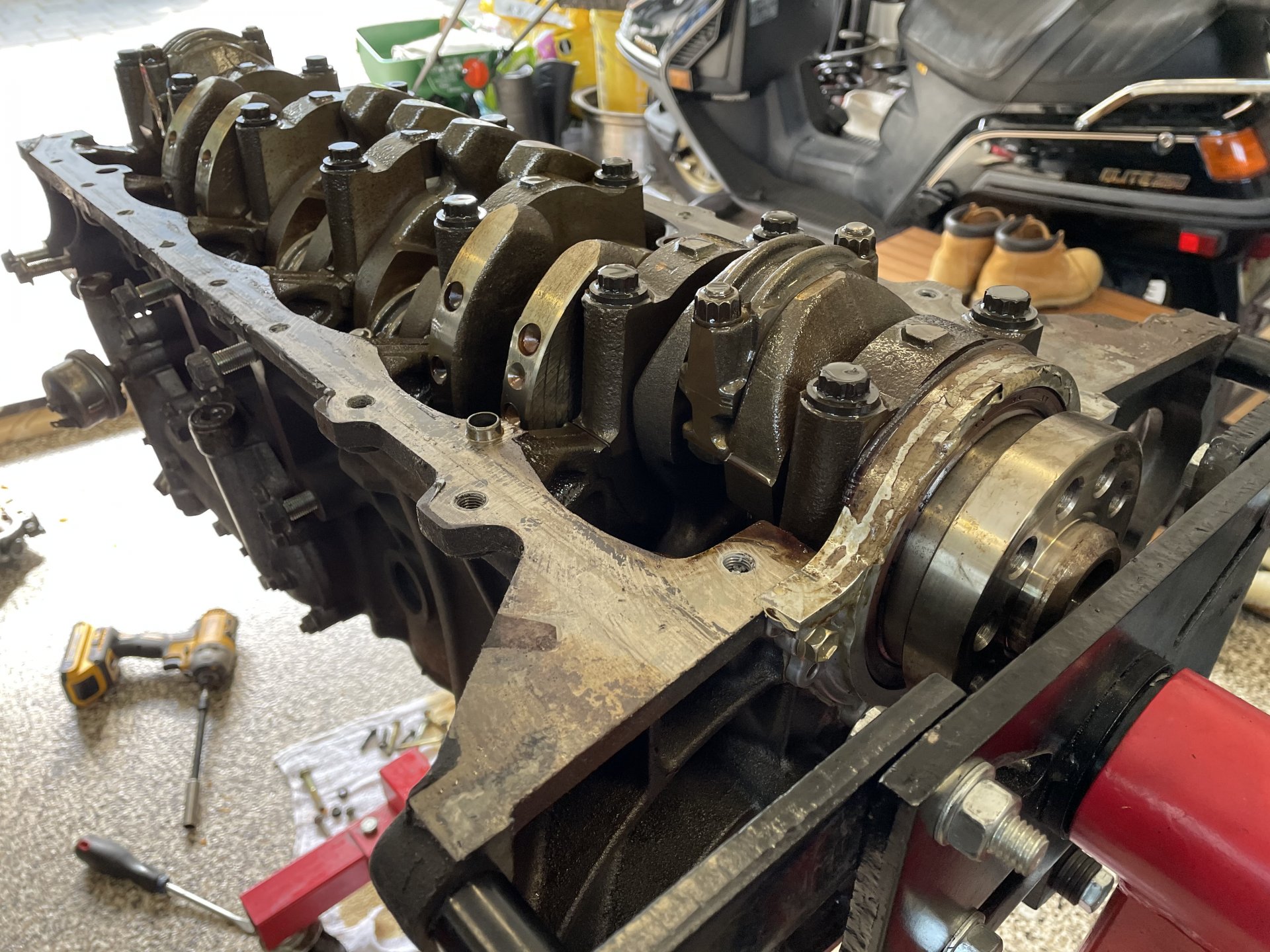

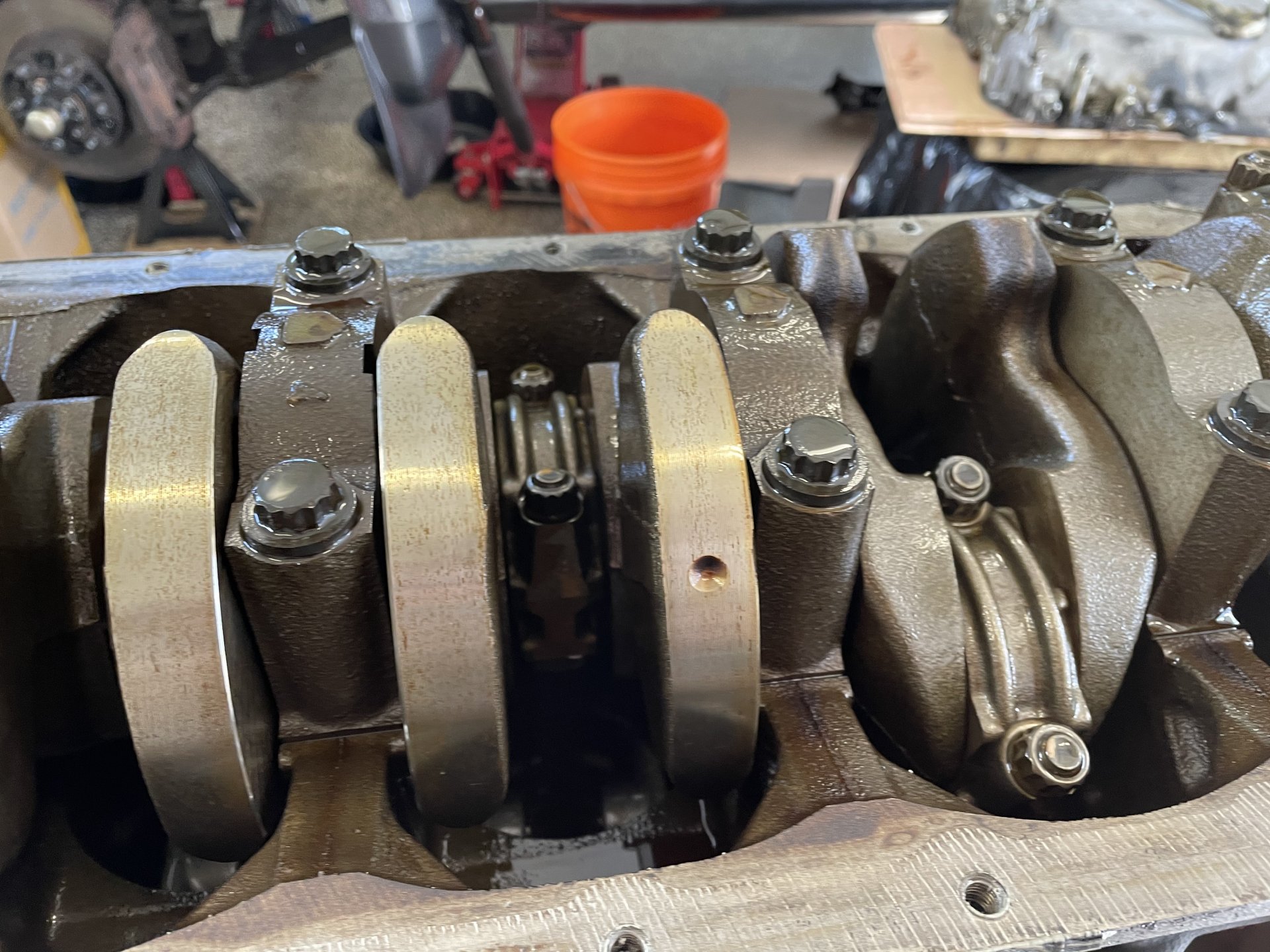

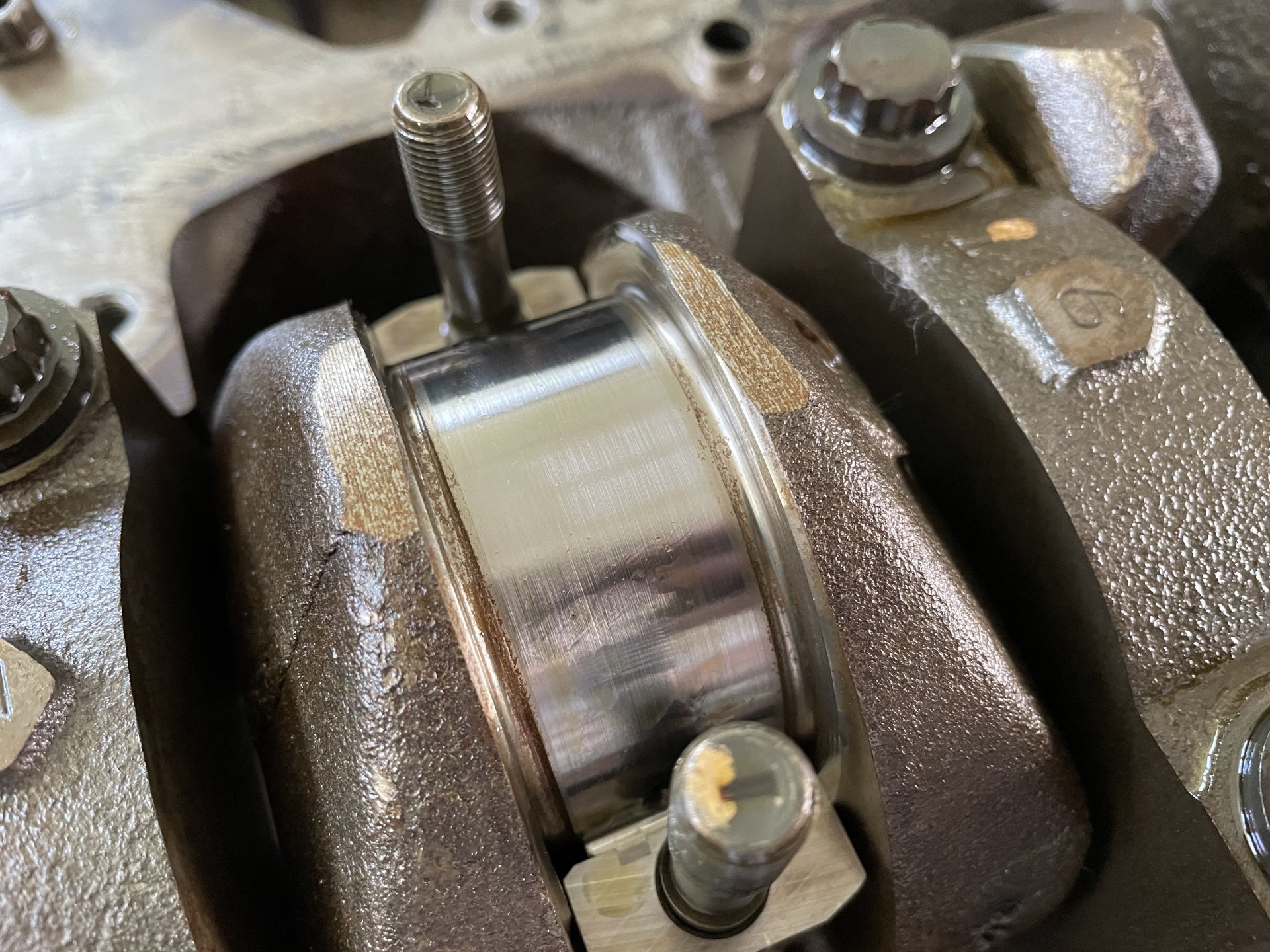

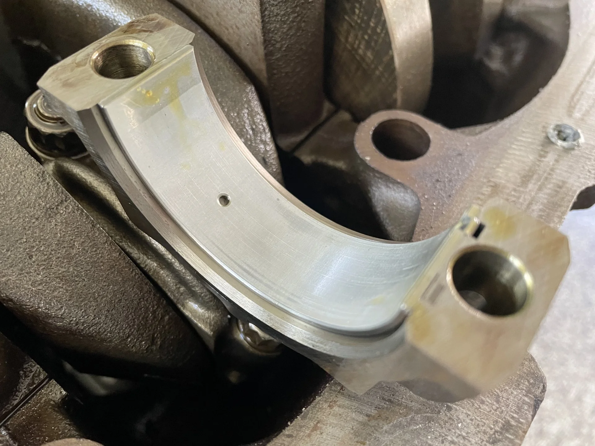

Inspection of conrod bearings and crankshaft
Conrod cap bearing.

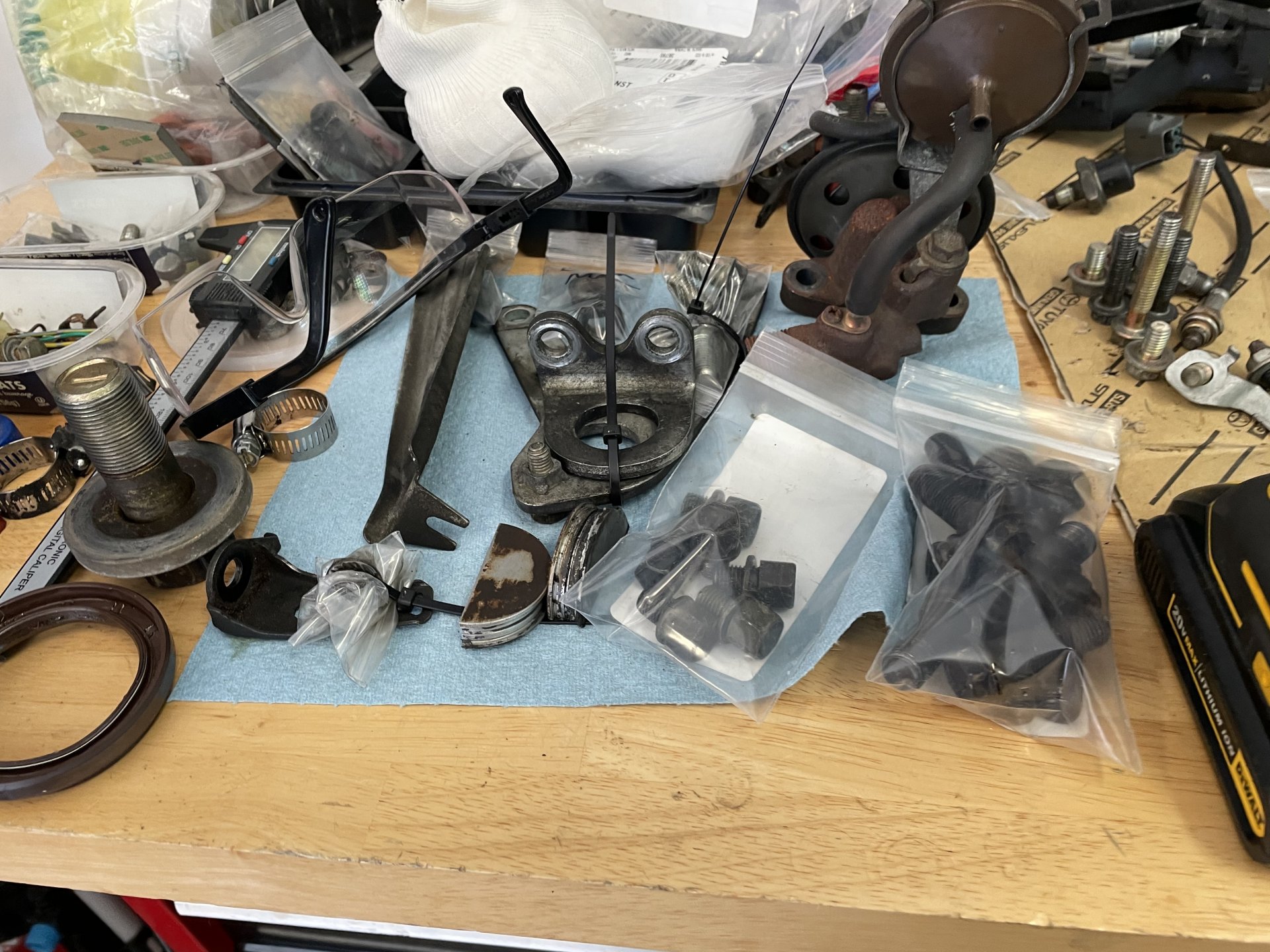

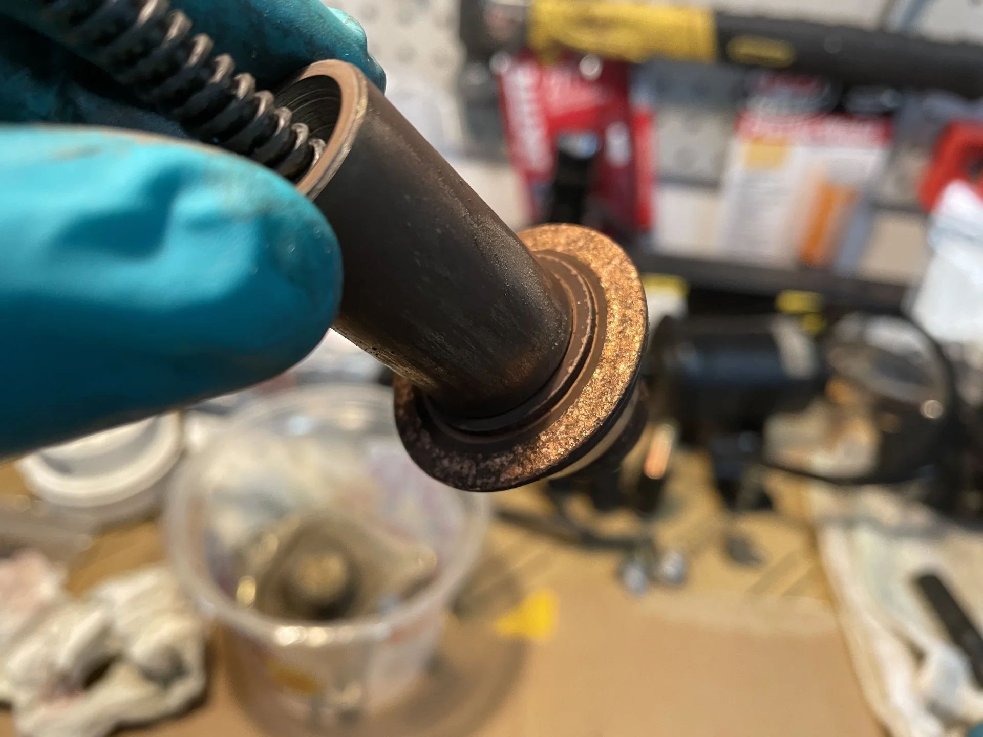

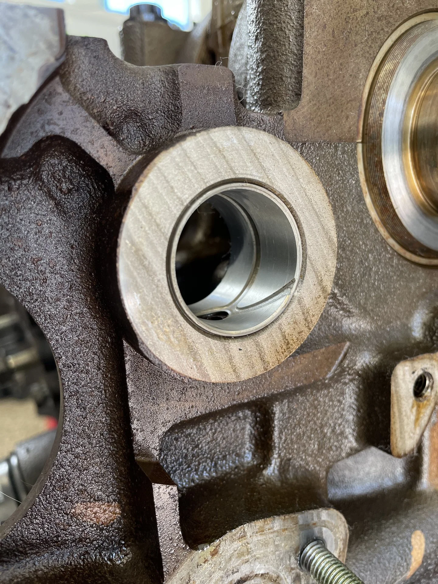

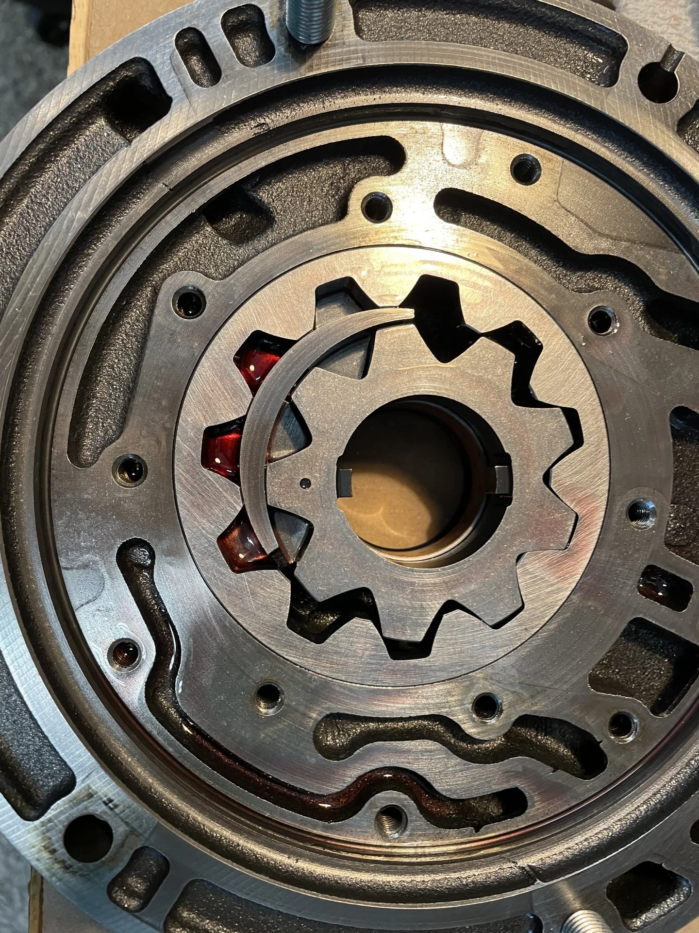

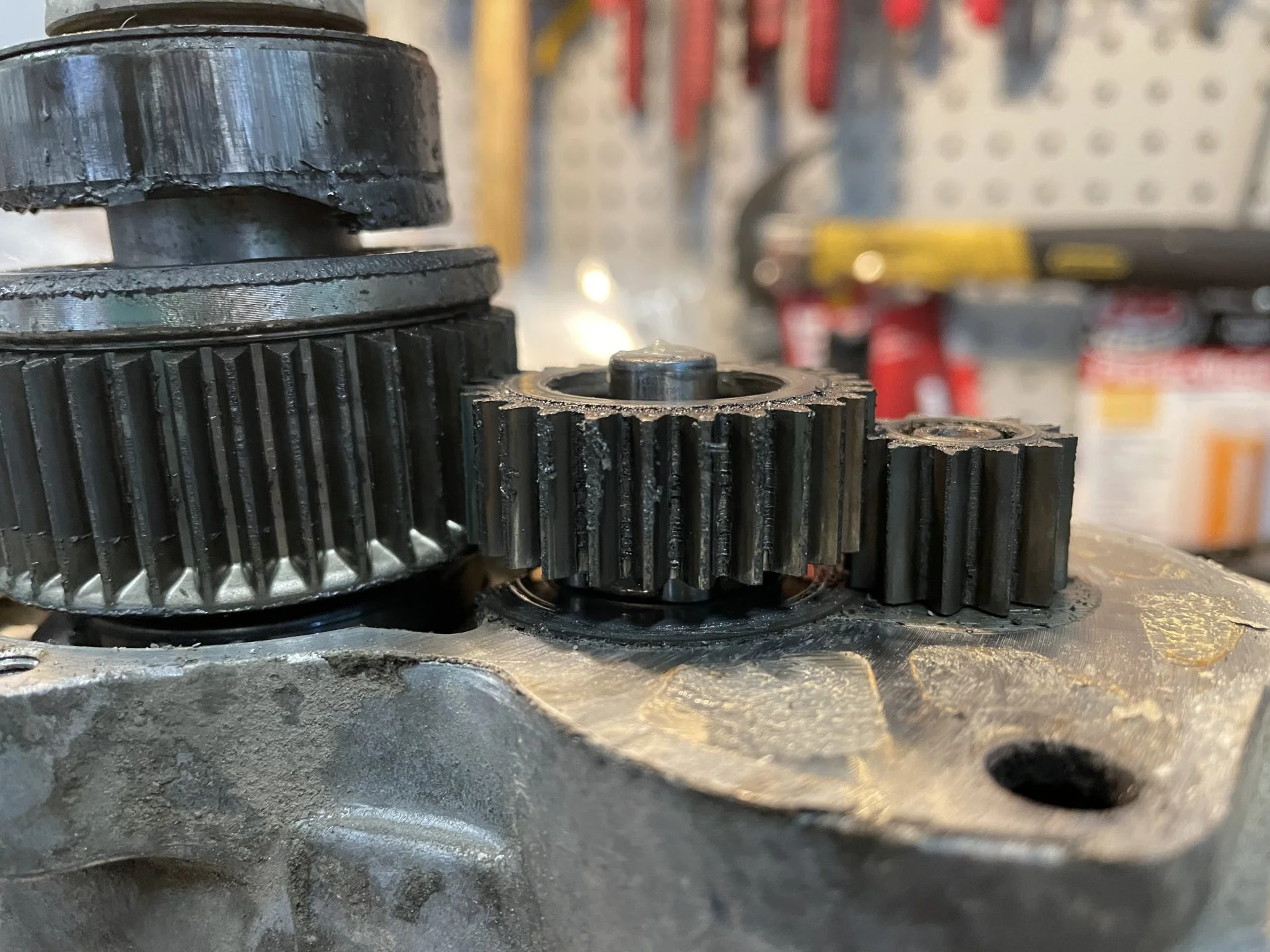

Oil pump bushing.
Chain guides are in great shape. A small hairline crack on one but no missing parts. I would bet they are very brittle. New ones going in along with a new chain.
Subbed. I’m interested in the short block. I’m in Tyler. Not sure where you’re at. I’ve got the same color combo on my LX. Looking forward to following this.
The engine shows very little wear internally! Shows the robustness of the 1FZ👍

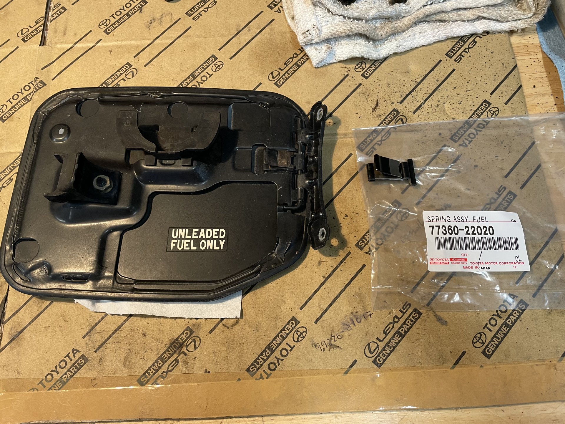

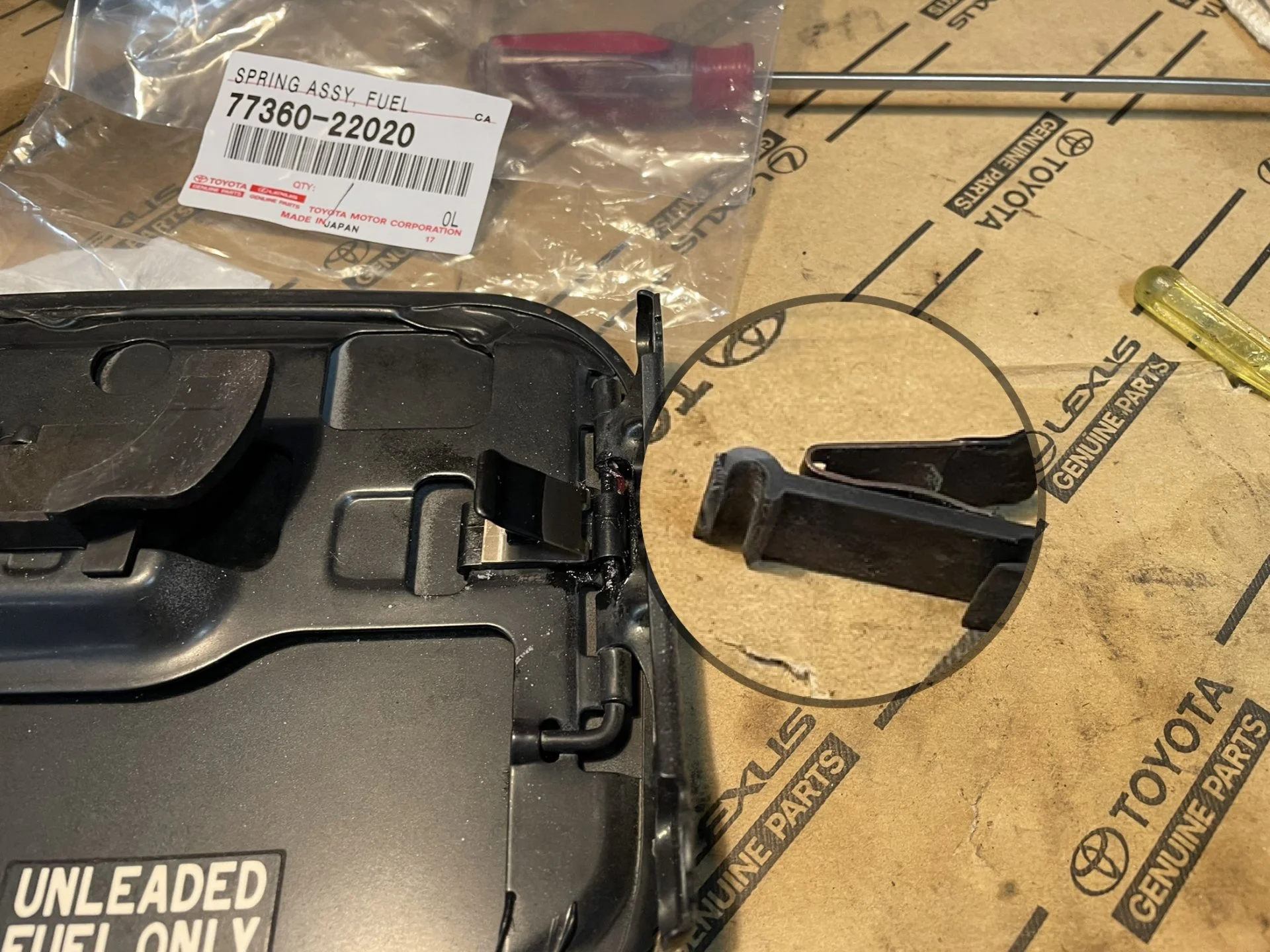

While waiting on the block and head I did some other work today. Fixed the fuel door spring. The tail end of it broke so the door would open beyond the normal amount and started to rub paint away.
Just before installation:
Installed. Broken piece under magnifying glass.

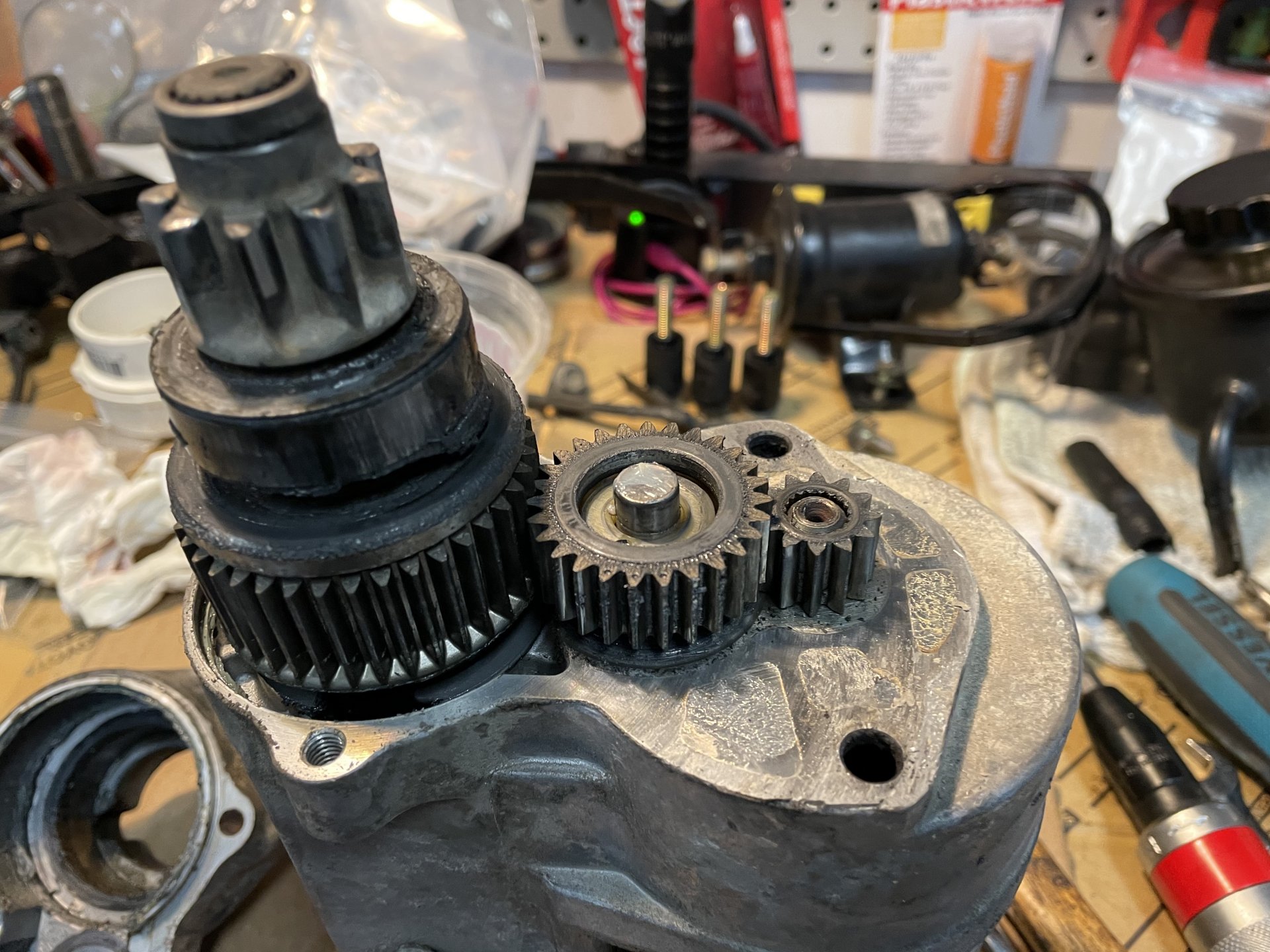

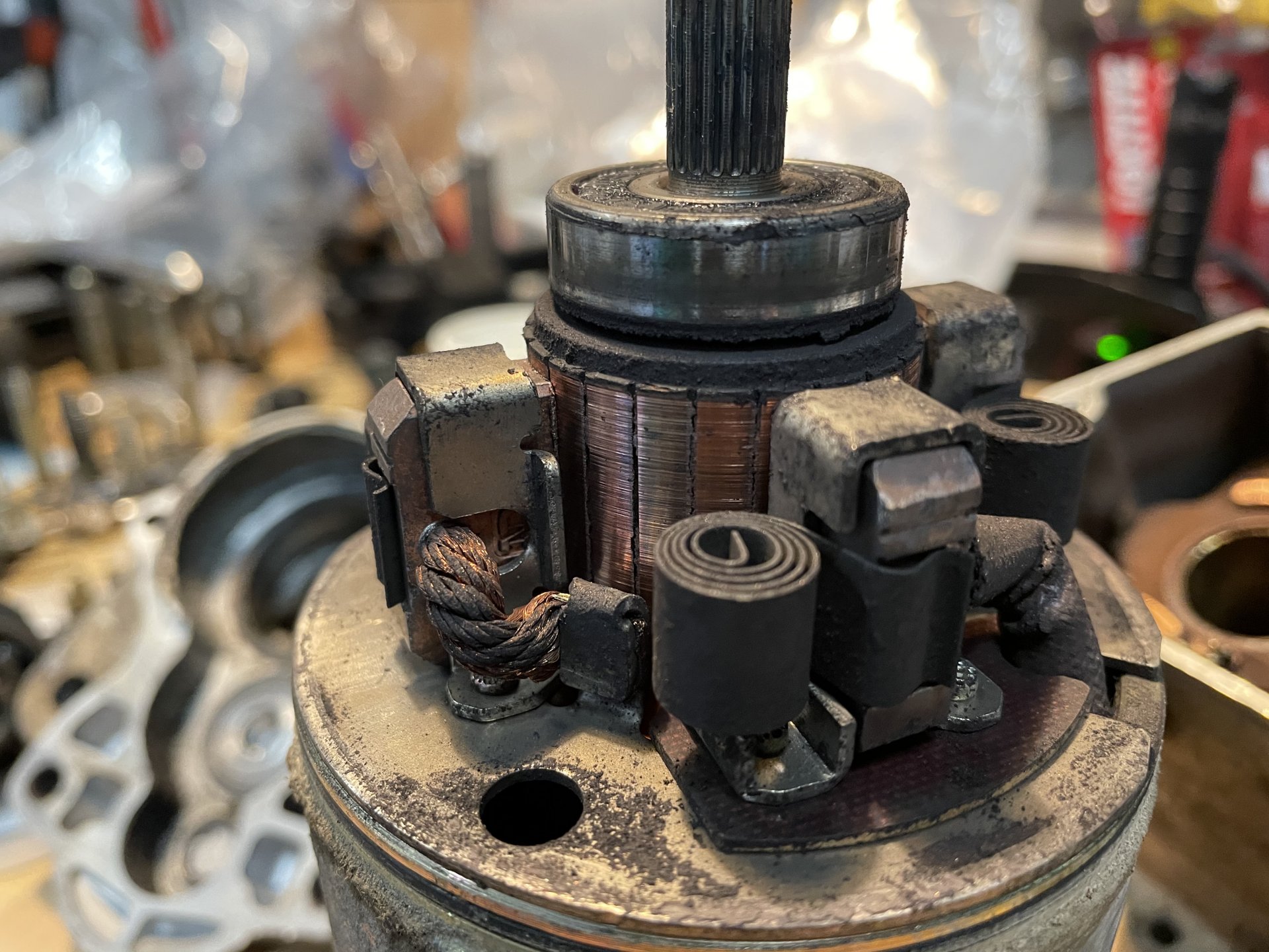

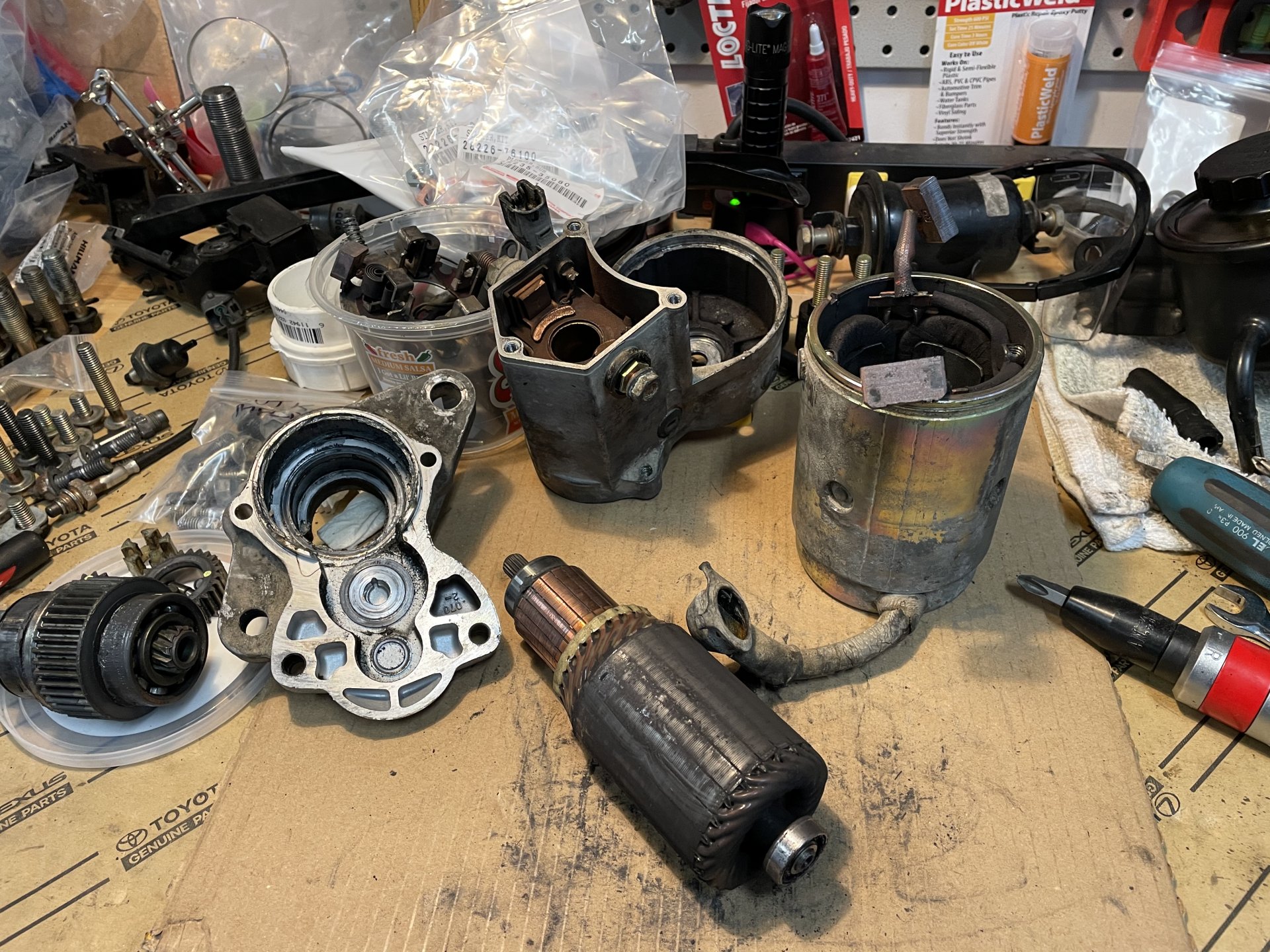

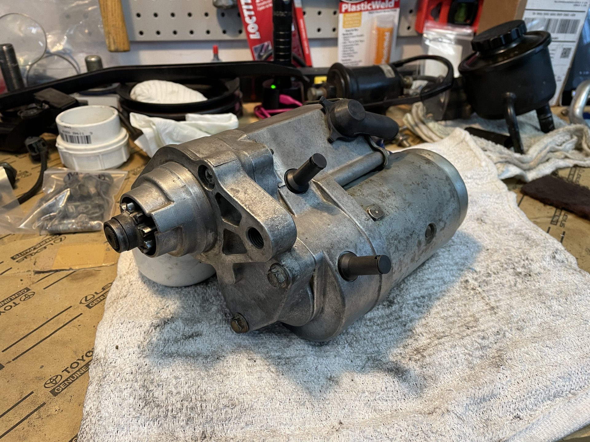

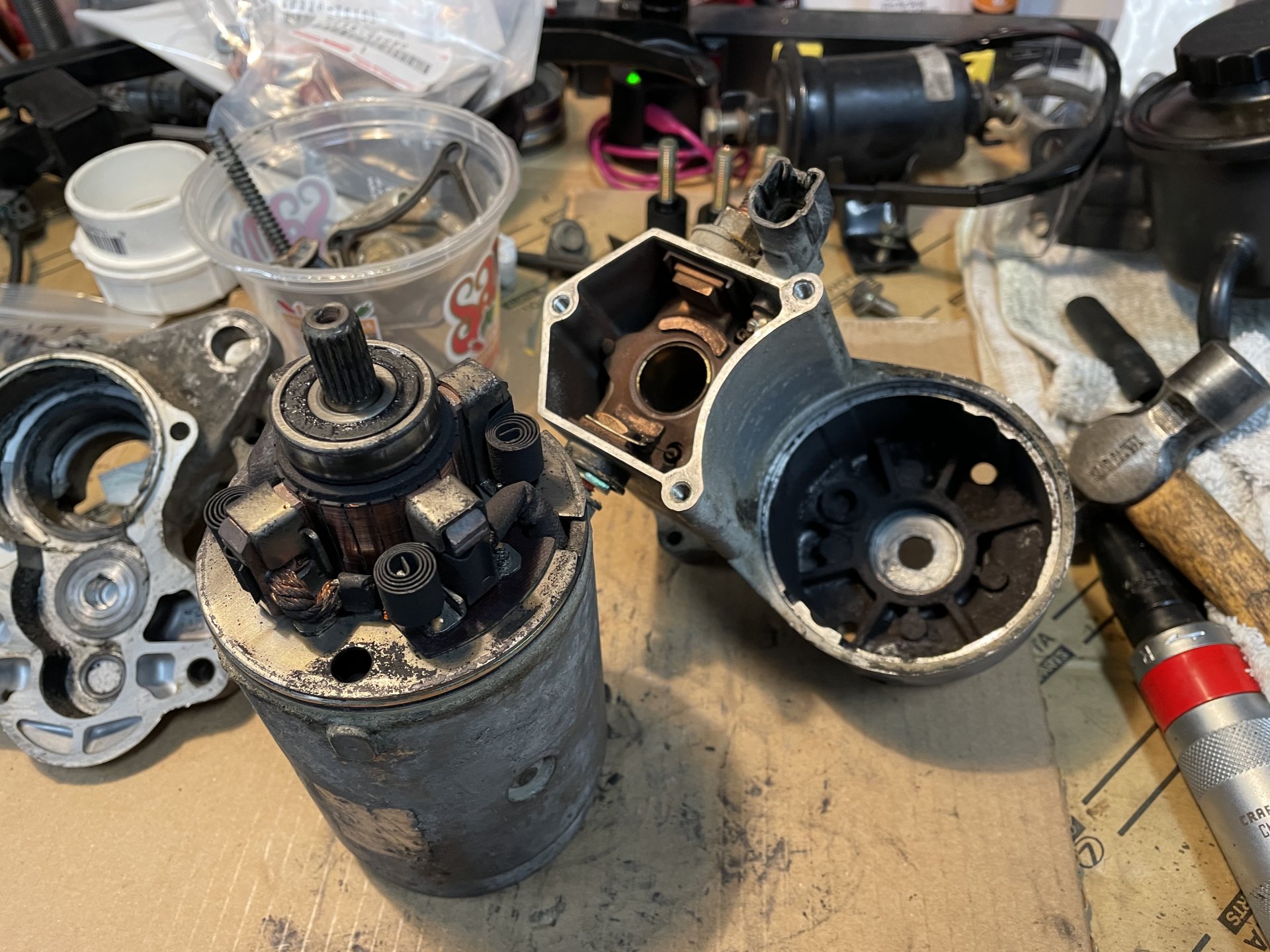

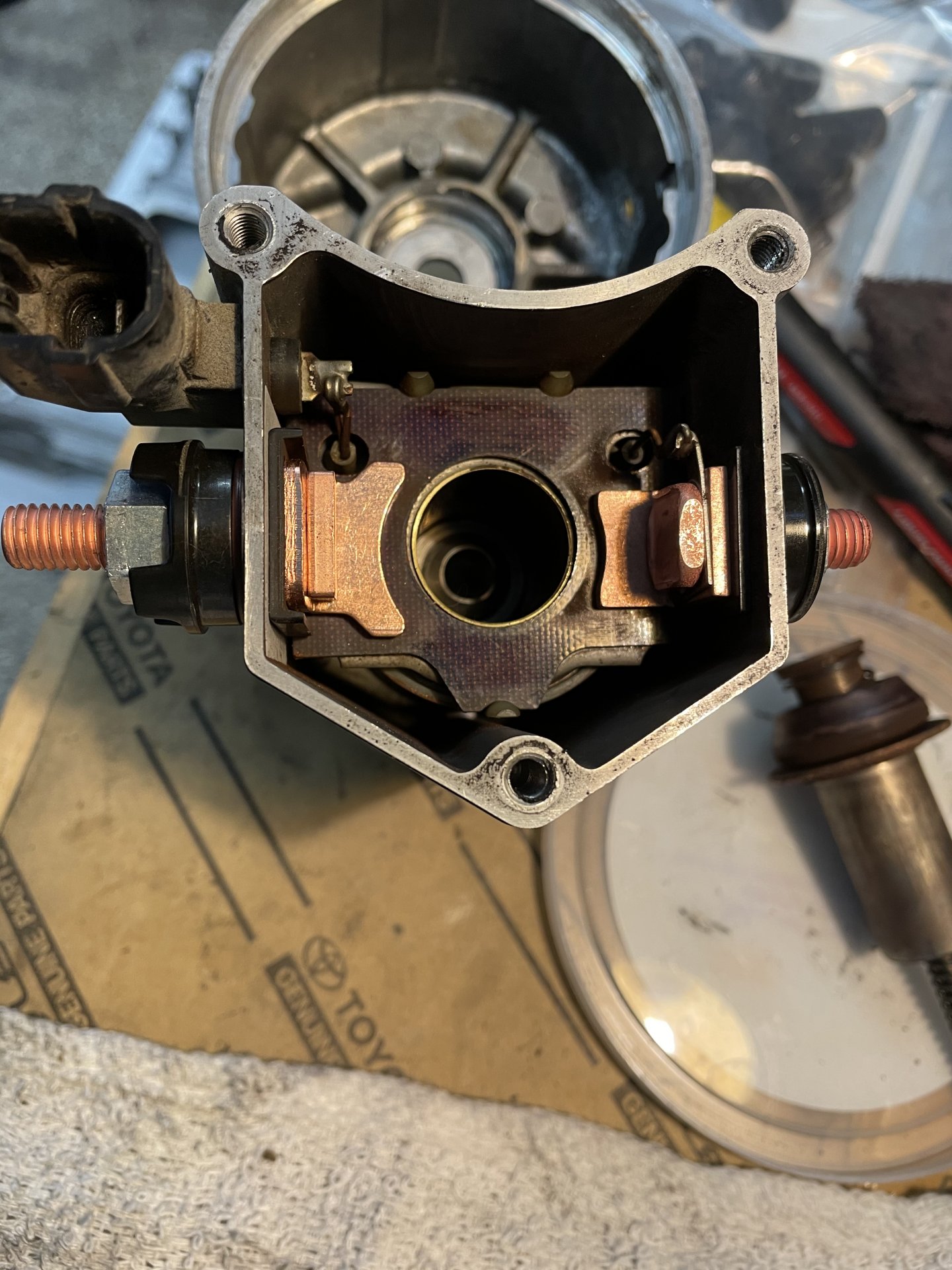

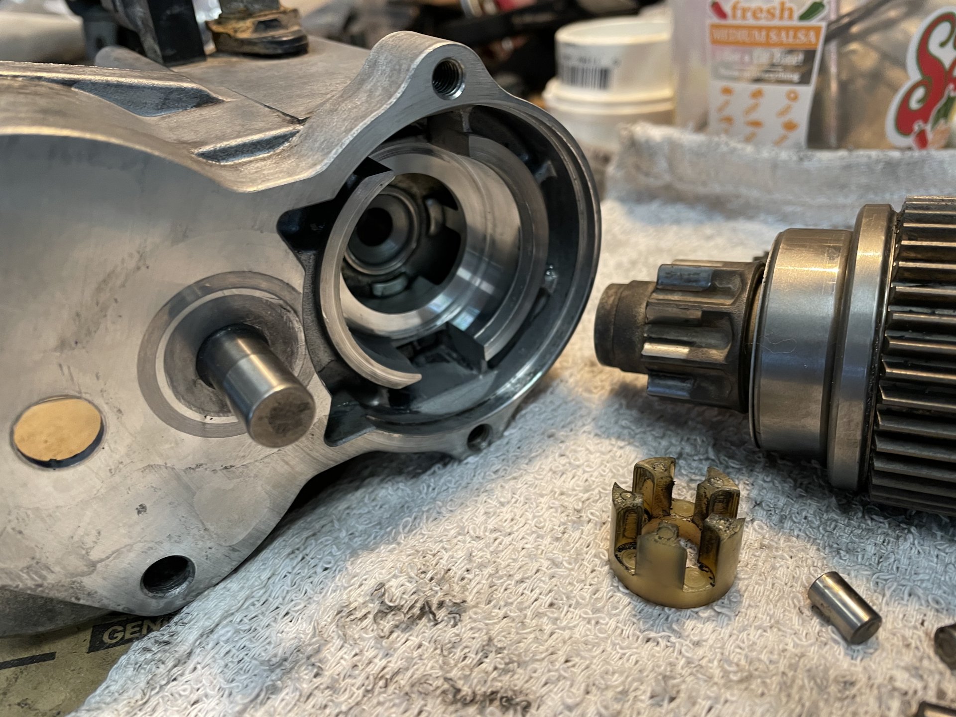

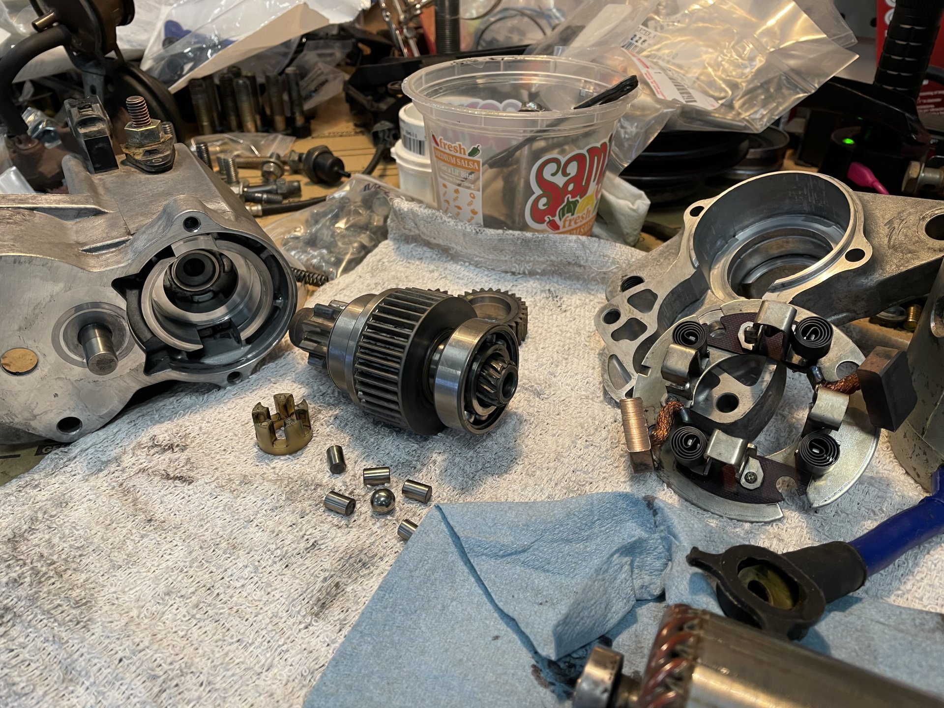

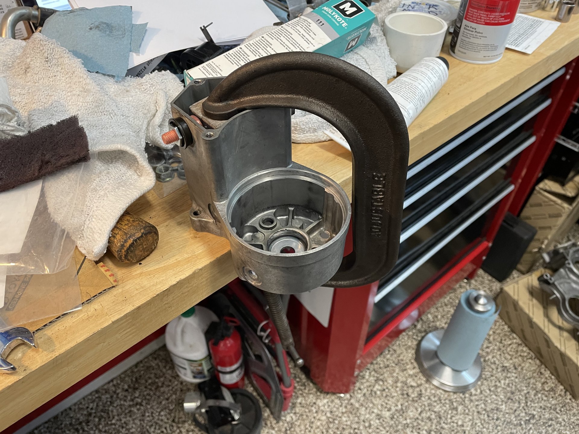

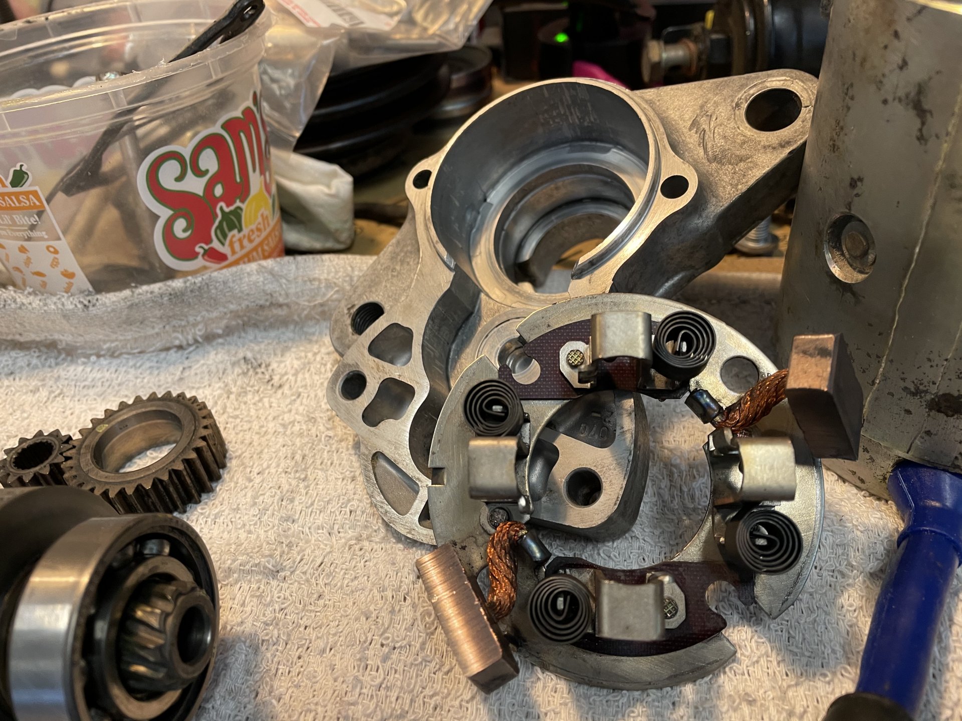

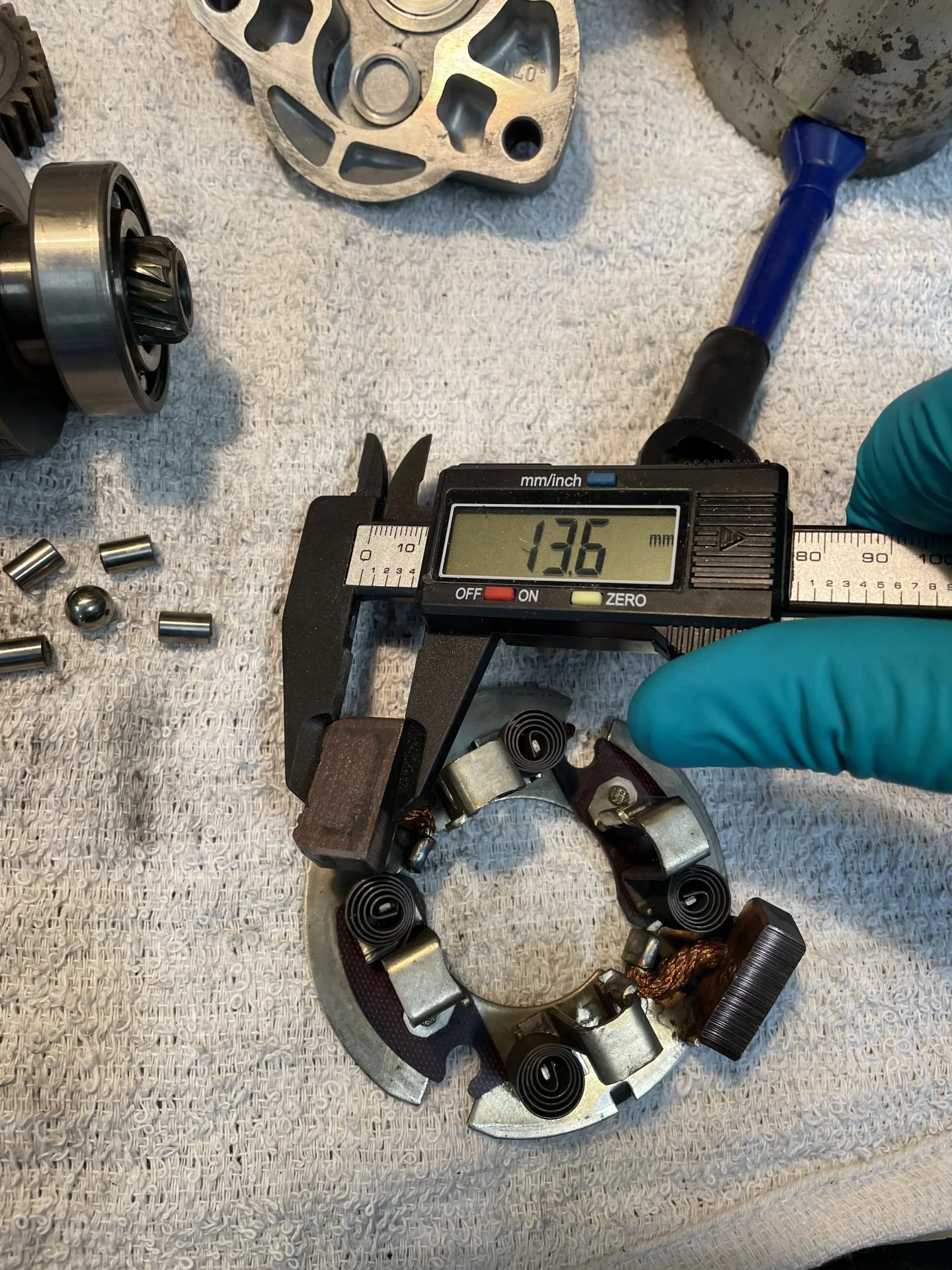

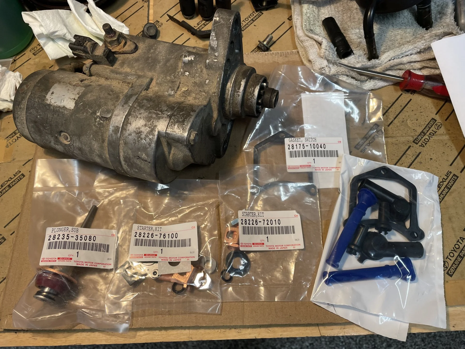

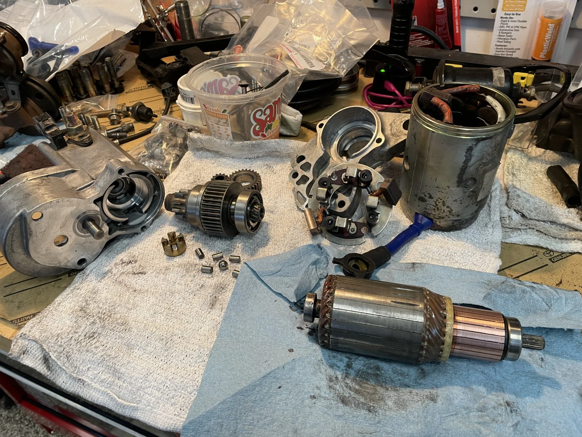

I also had a 2.2kW starter that needed to be rebuilt. So I rebuilt it.
Finishing up:

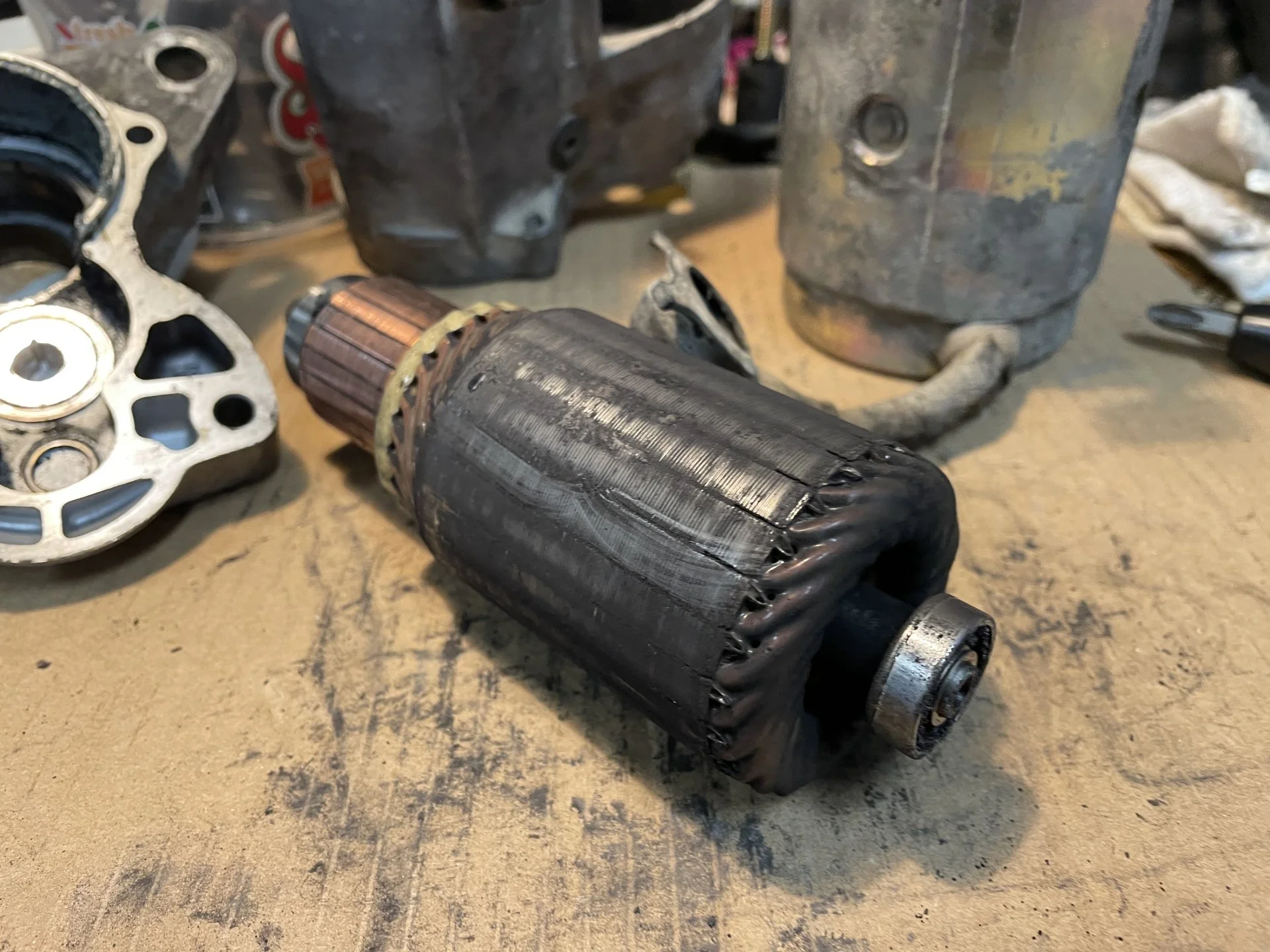

All parts cleaned and inspected. Very nice condition.

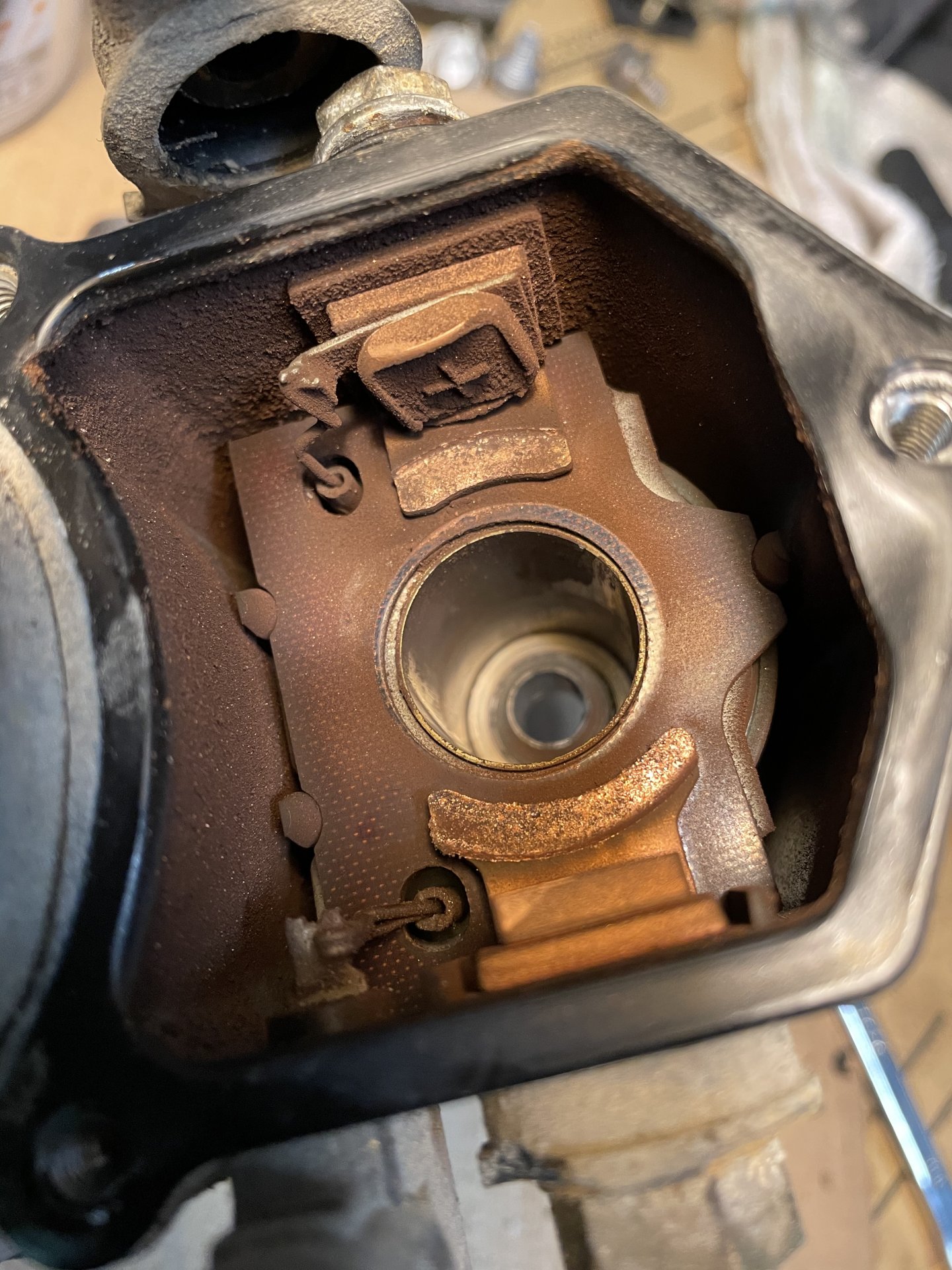

Carbon brushes are within spec. Minimum is 9.5mm.

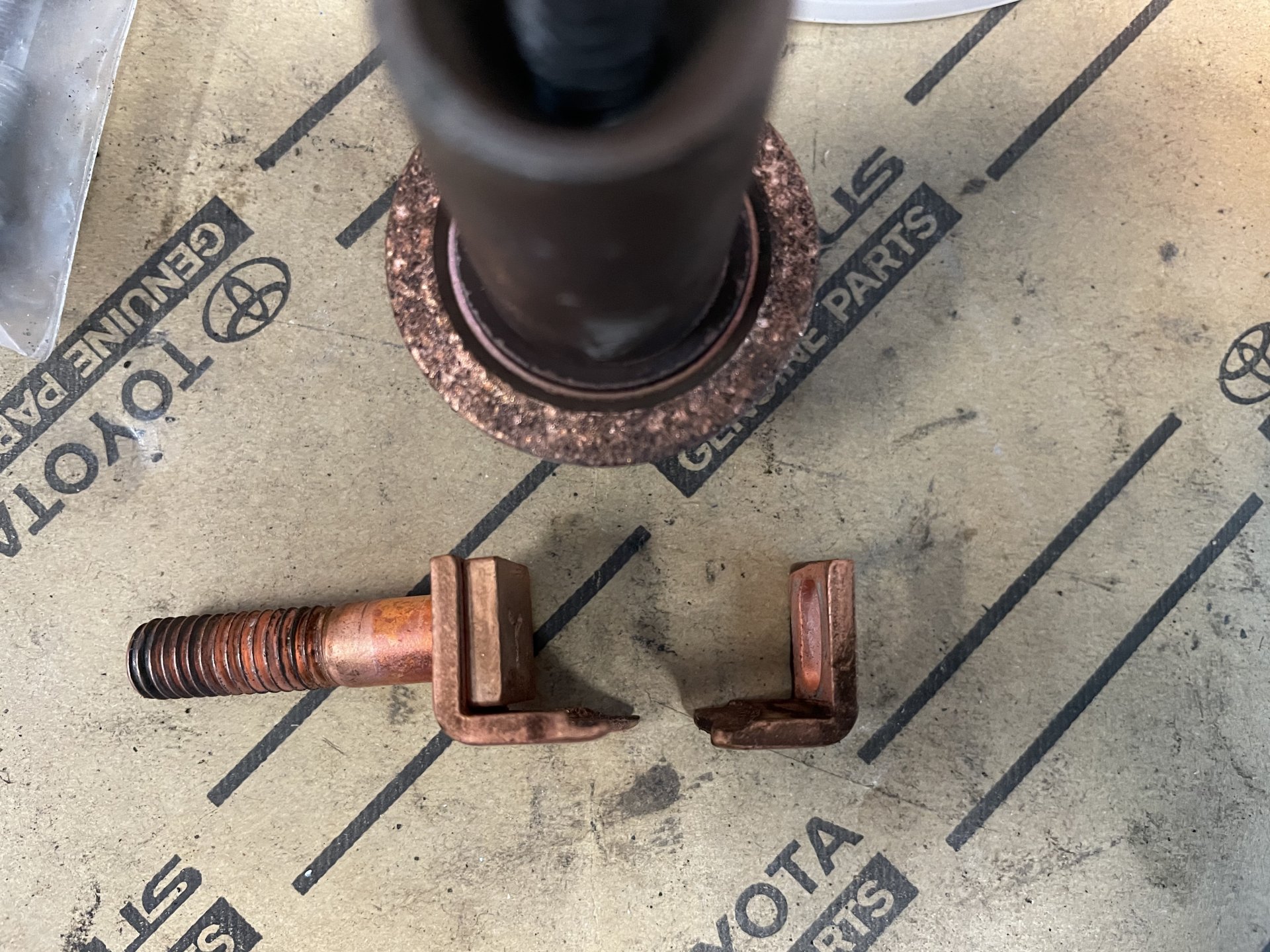

Nice and clean with new contacts.
All bearings are greased with electric motor grease from Mobile 1. I first cleaned them out before repacking.
Applying force to keep the contact flat per FSM.
Ready to go in.
Old contacts. Worn.
It really is amazing how it's barely worn. I think new rings and the engine will run another 200k.
