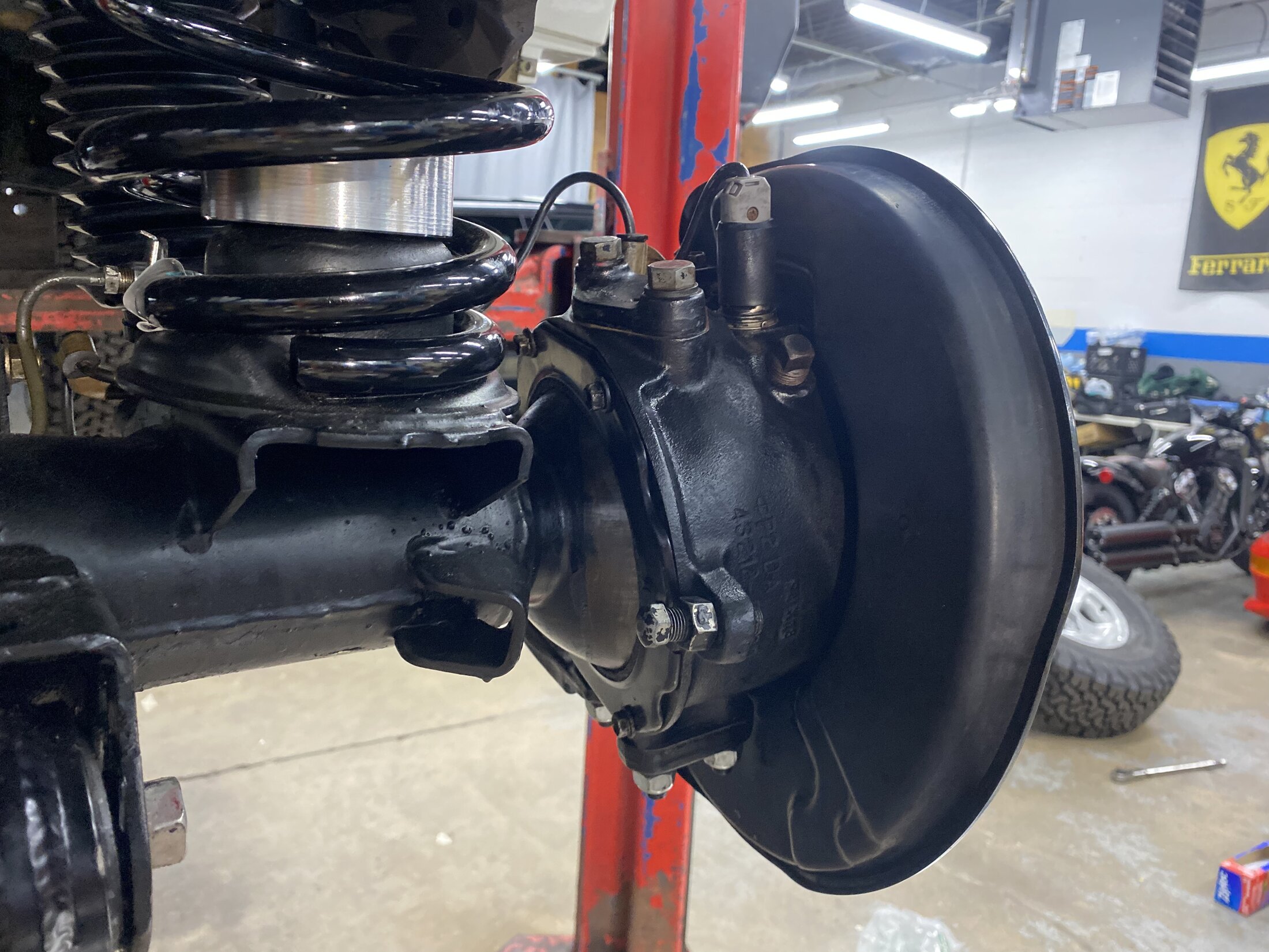

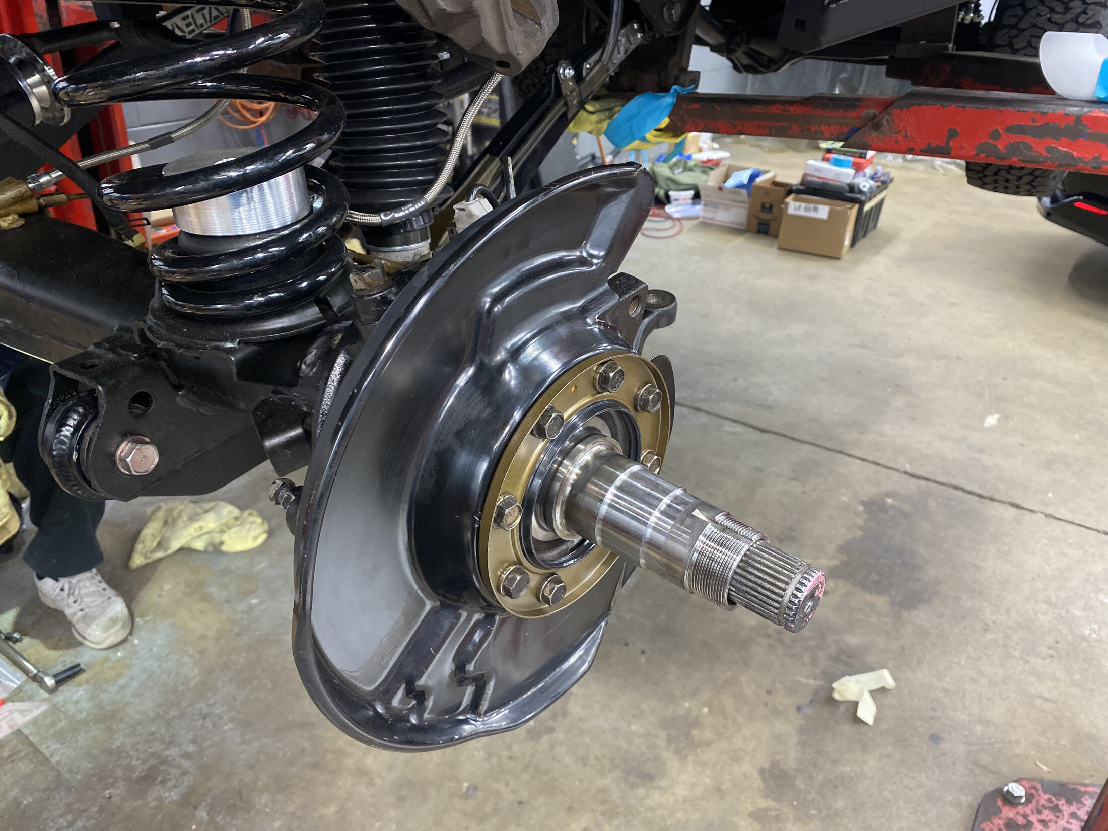

I forgot to mention I got these hockey puck-shaped aluminum bump stop spacers installed on the bottom inside the front coil. A forum member makes them in any size. He recommended 1-1/4” which is what I have on my car. Maybe worth a try? I can link his name if you want man.

I installed these too and they work well.
