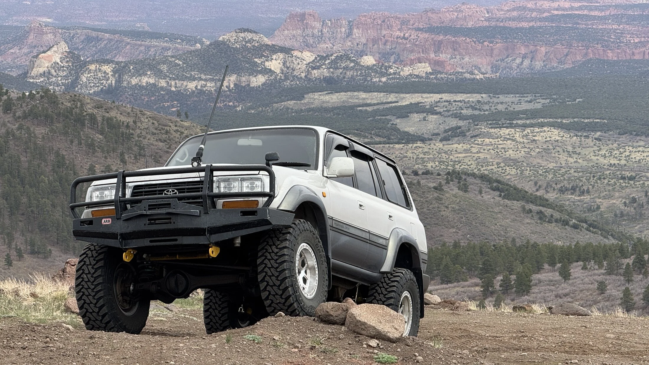

Current state:
I haven't had a Land Cruiser build in my life for a couple years and I've missed it. Just ditched my '20 Tacoma 6-speed. Fun to drive but at the end of the day, not a great platform. Test drove everything from PXLs and 200 series to LJs and 70 series. All have their strengths and weaknesses but I was hoping for something I could scratch up off road, with less electronics and sensors, definitely no DEF, coil springs, and solid axles - so 80 it is.
Flew down to AZ to pick up this HDJ81:

And finally, the build: It's basically good to go as-is - but my goals are:
- Bulletproof the engine and drivetrain
- 3" exhaust and intercooler. Maybe a G turbo
- Learn 1HD-FT diesel tuning witchcraft
- Tune the engine for high altitude. I live at about 6K.
- Air compressor and lockers
- Gears
- Sliders
- ARB bumper for that classic look
- Scheel Mann seats
- Vinyl floor
But that might be it. With the current swing arm holding a spare, and apparently a range of 300-400 miles per tank... (still untested with 35s) maybe I don't need a rear bumper and jerry can carrier.
But I'm sure it will snowball and turn into a money pit, it's inevitable.
