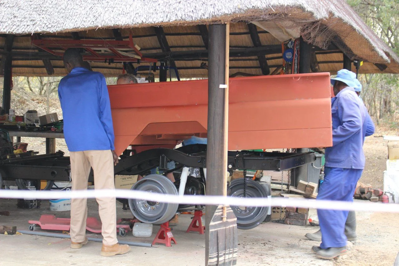

To cut a long story short, (this may take a few posts) we got straight into the move when we got back. I put the load bed back on the chassis with a few bolts, put the tub on using two bolts and 4 zip ties. Then put my one steel cabinet with tools etc onto the load bed and my work bench on top of that lot.
WITH A LITTLE HELP FROM MY FRIENDS
THE TUB IS ON. (Couldn't resist dry fitting the seats - just to see)

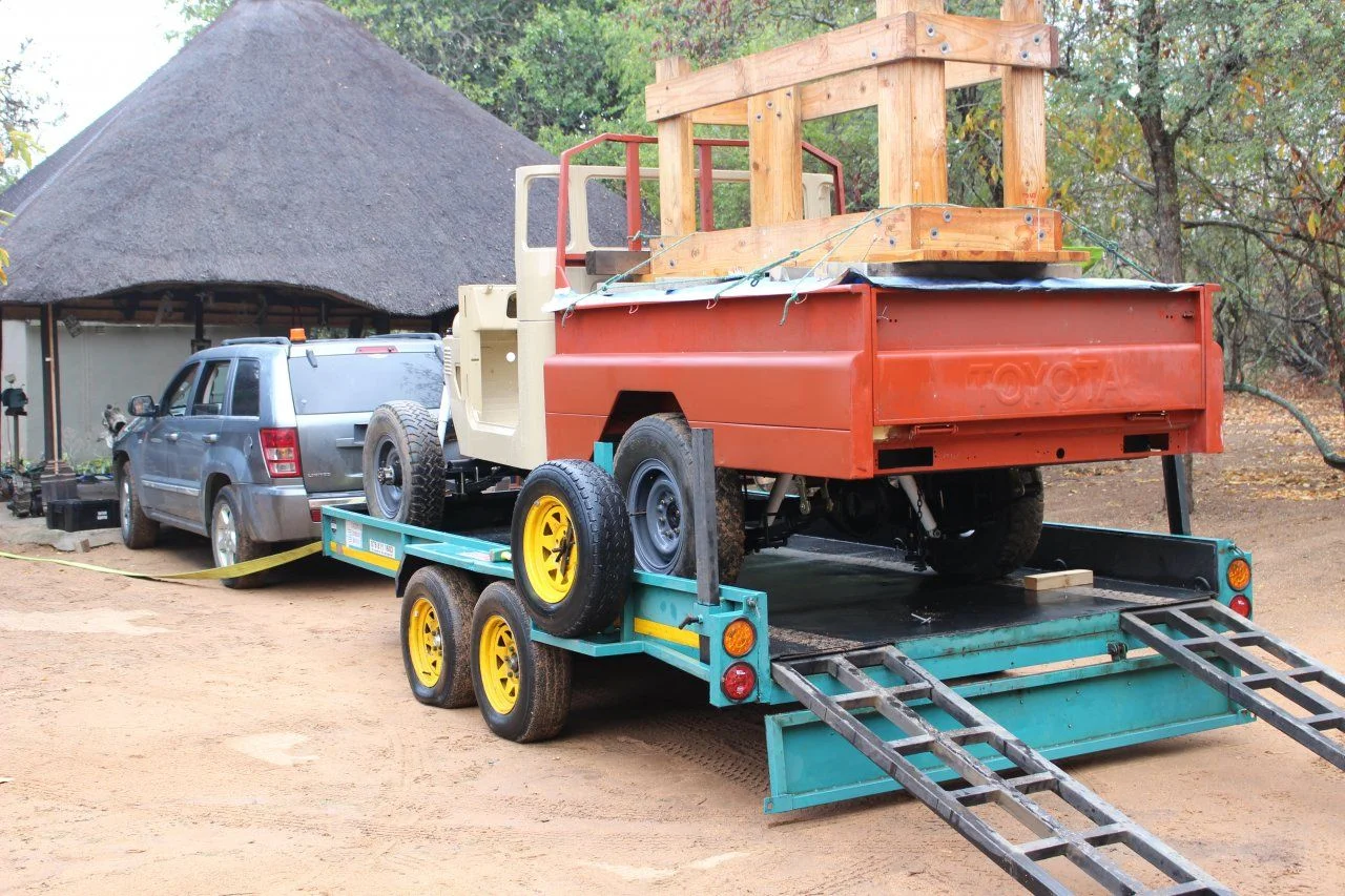

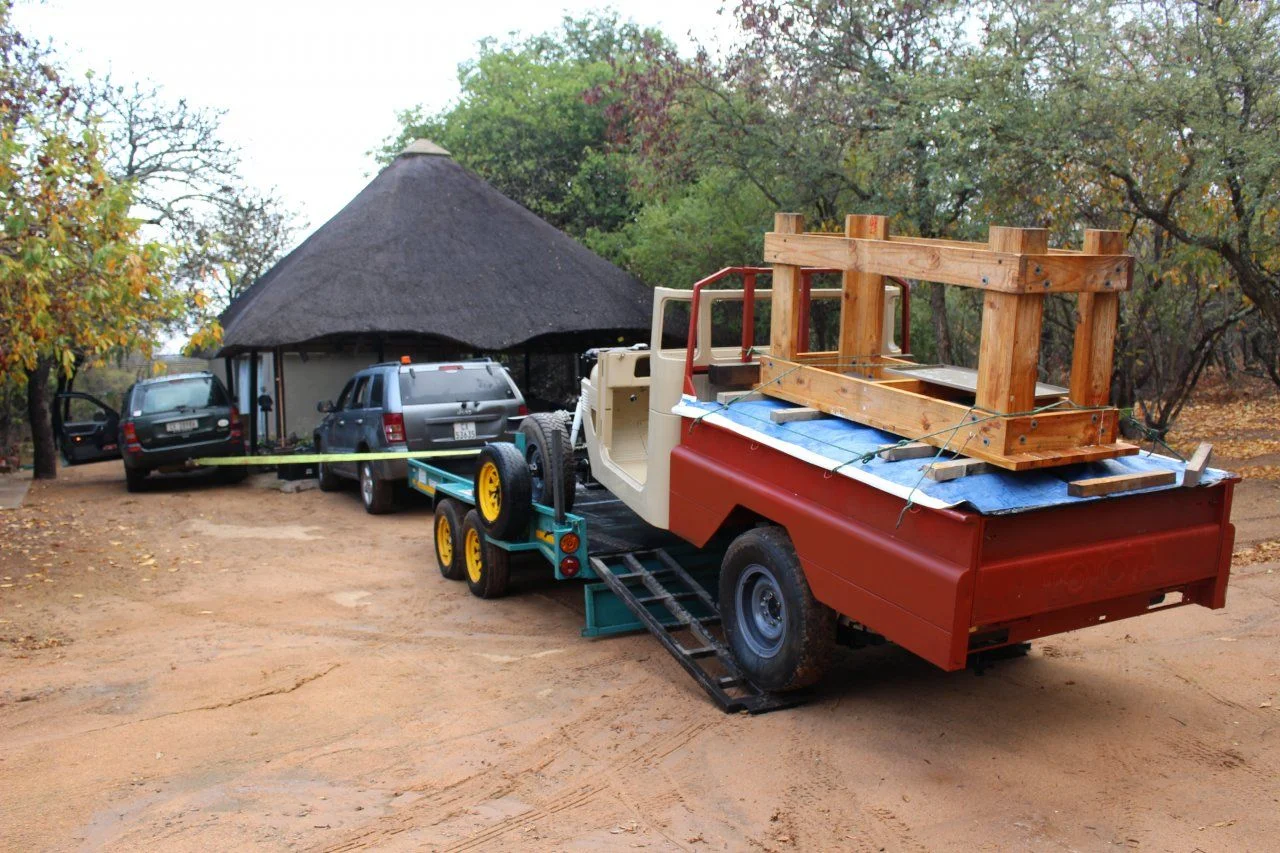

All the body panels, carefully wrapped, went into the back of the Grand Cherokee. I hauled the Dagha Boy onto the trailer using a tow strap and the other Jeep. Strapped it all down nicely. Ready to leave at 03:00 the next morning. A bloody heavy load.
ON HE GOES
LOADED AND READY TO GO

After a three week delay we hit the road at 03:00 with the MWFD driving the old Green Jeep. Eleven hours and 1100 km later we stopped for the night. Perfect run.
We left early the next morning to do the last 700km home to the coast. When we hit the coast, we drove into bucketing rain and gail force winds. The last 300km was not nice. Eight hours on the road and we were home.
To get a bit of tech in here, the 1800km (1125m) took 19hrs on the road – average speed 95kmh (59mph) with fuel consumption of 15.4L/100km(15.3mpg).

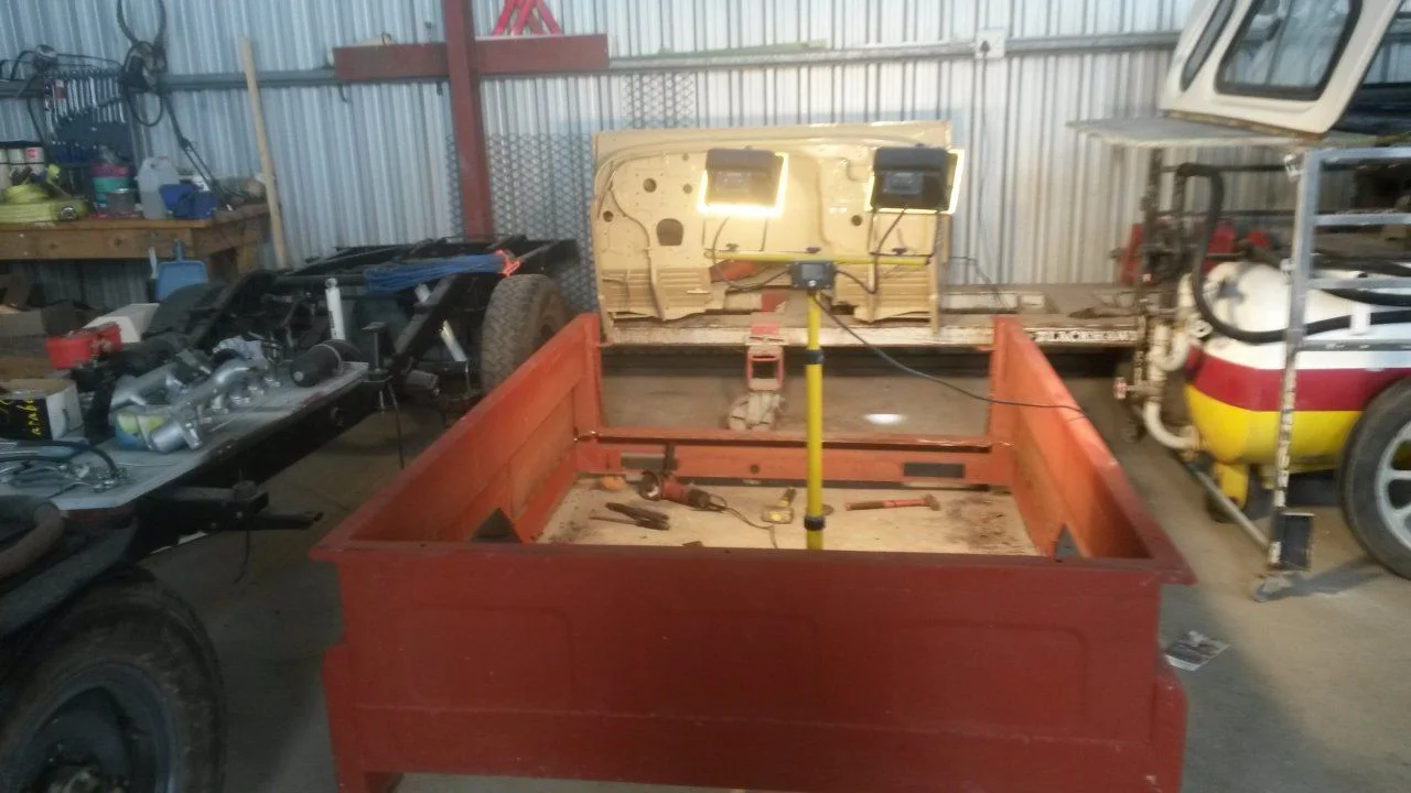

Then the shock. The workshop was not even close to being ready! There I sat with all this stuff in the pouring rain and nowhere to go. Not nice.
Sometimes things work out for the best. The next morning I got hold of a guy who owns a panel shop and owes me some favours from way back. to cut another long story short, he offered me space in his workshop and use of all facilities to finish off the Dagha Boy. Plenty air, spray booth, hoist etc.
Over the past two weeks in between other stuff I have been setting up my workspace there and will hopefully start work on the Dagha Boy tomorrow.

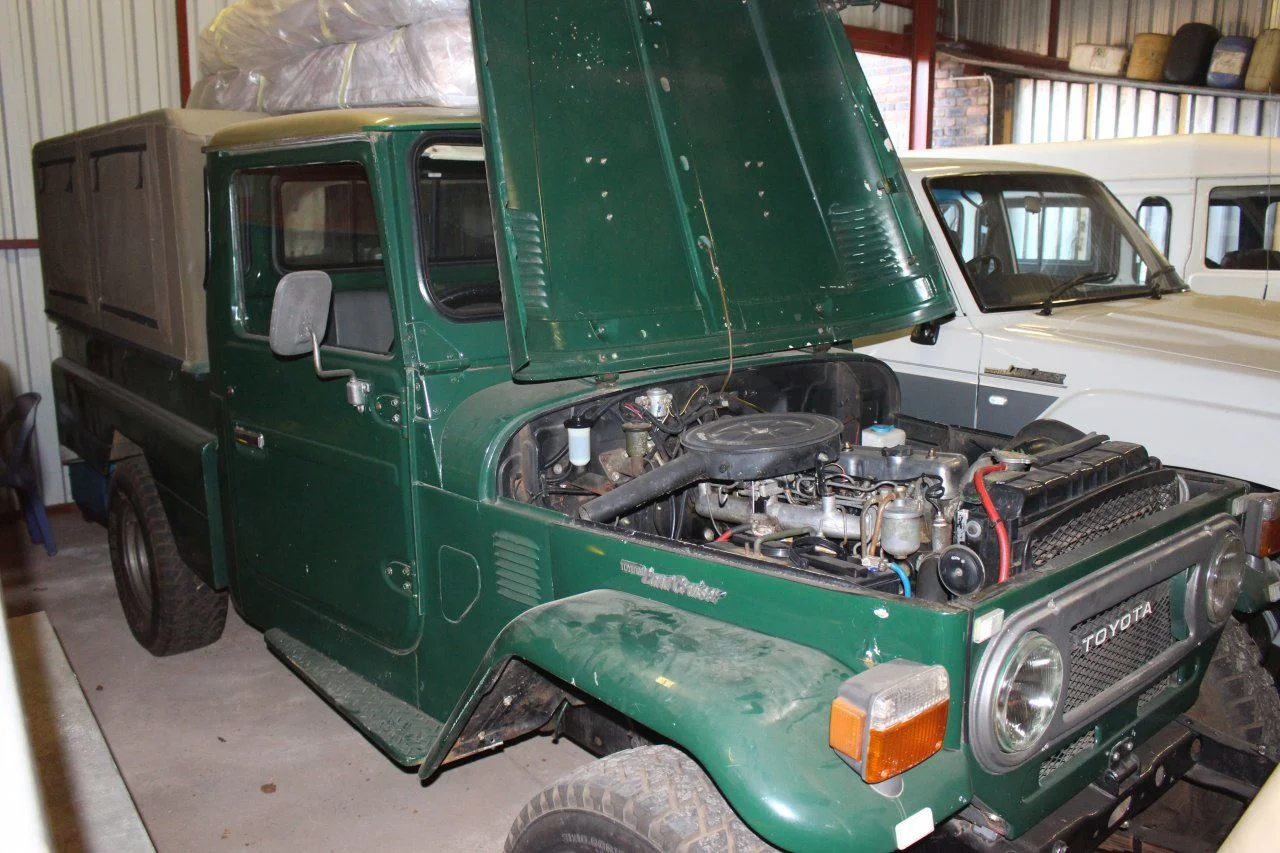

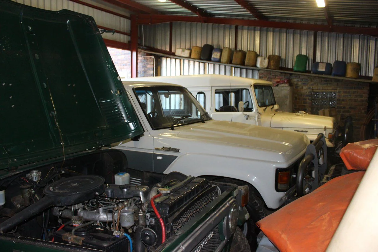

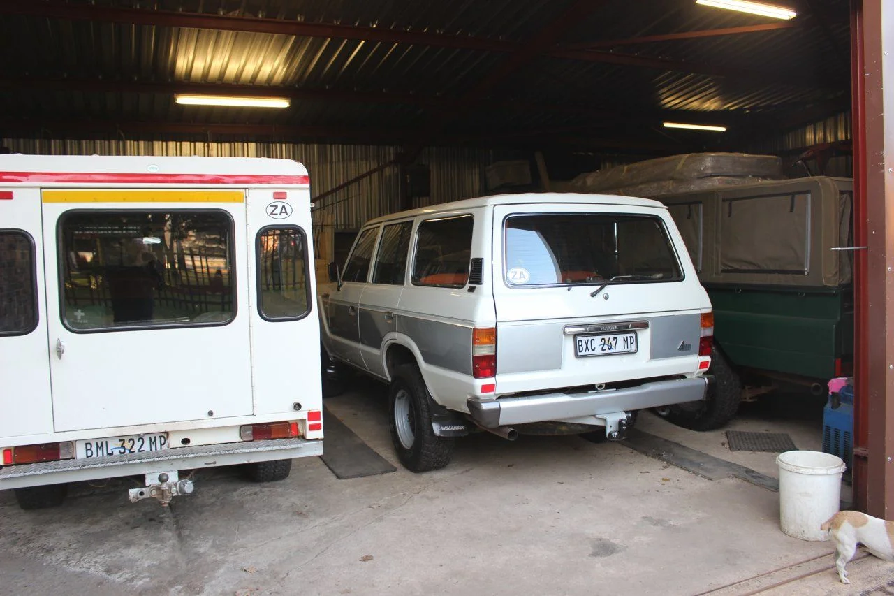

I have had to do a fair amount of travelling to consult since getting back. On one occasion I got tired and stopped at a B&B in the middle of nowhere. When I went around back to park my car I drove right into LC heaven.

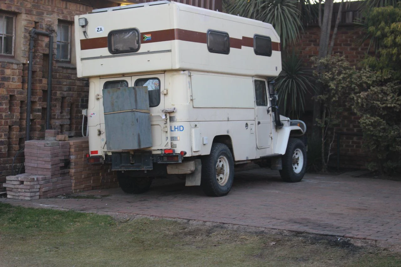

The first thing I saw was a left hand drive BJ45 converted to a camper. Just sitting there!!! Turns out it was driven from Europe many years ago and the owners still come out every year and use it for visiting the game parks. NOT FOR SALE, but my name is at the top of the list now for when they do!
THE CAMPER.
USED FOR HUNTING. NOT FOR SALE
3 BEAUTIES SLEEPING IN THE SHED. NOT FOR SALE.
The white HJ45 is a pickup and has been converted to a station wagon for camping in Mozambique and the 70(?) series he uses to tow the hunting vehicle to the hunting grounds and for general use.
He is a retired airline pilot, loves Land Cruisers and did all the work on them himself. His son has a couple as well. A new friend made.

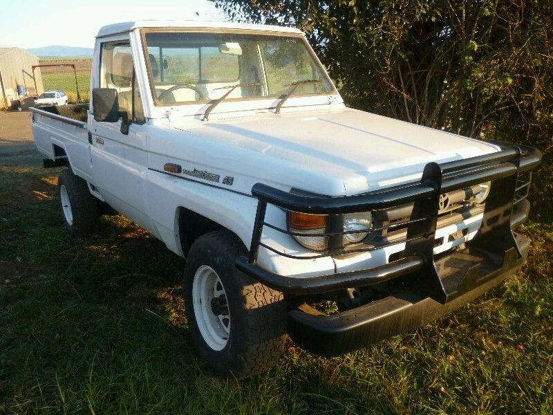

Next morning early I'm on the internet looking for another one. There she is. A beauty! No rust really nice for R22000 ($1575) and also just an hour and a half away. But it's 5 in the morning, so I decide to wait until 7 to be polite. I phone at 7 sharp and the guy says, sorry a guy phoned and bought it half an hour ago. Moral of the story, the impolite early bird gets the cruiser. Damn.
On Friday I made up brackets to fetch my repo'ed HJ45 which is about an hour from here. Got there bright and early and got the bumper off and the brackets on in no time and took off. But the damn thing refused to track behind the Jeep... So I had to give up and will now have to hire a trailer to fetch it. No luck.
There is however another one on the horizon. The best 2nd hand Cruiser (HJ47) I have ever seen. The current owner bought it a few weeks ago for just R12500 ($900) but is known for never selling anything. I spoke to him on Friday and asked to buy it, expecting him to laugh at me. To my surprise he said he would think about it over the weekend and give me a price on Monday! He'll probably want R50 000 ($3500) for it, but it would be the bargain of the decade at that price. I live in hope! My luck has to change.

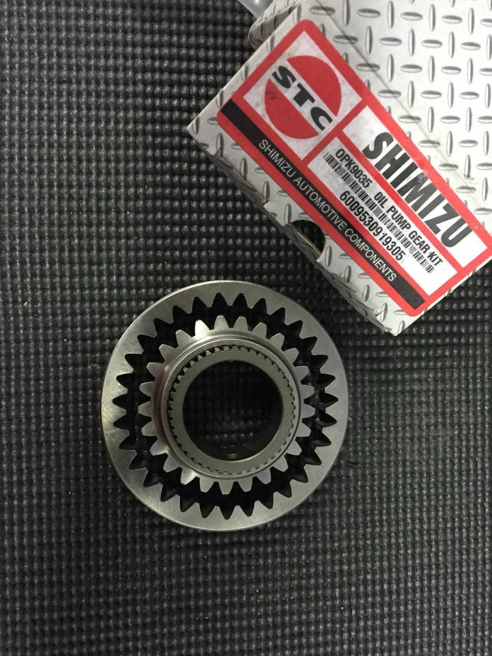

Good luck with that Dagha boy. I am doing my 40 series B-Type engine at the moment. I will post a pic and part number of mine. There is a slim chance it could be the same. Also battled a bit to get mine. Spares guy found this one in Cape Town.

Thanks Grant. A B type engine? I haven't heard of those around here. Is it from the 60's? The picture is very different to mine. Looks like I may have got lucky on one in Joburg. Should have it here tomorrow afternoon and will then be able to tell for sure. Price was R1450 so I asked for two but they only have the one. Maybe its the good Kansas mo-jo found me this one and I shouldn't be greedy.

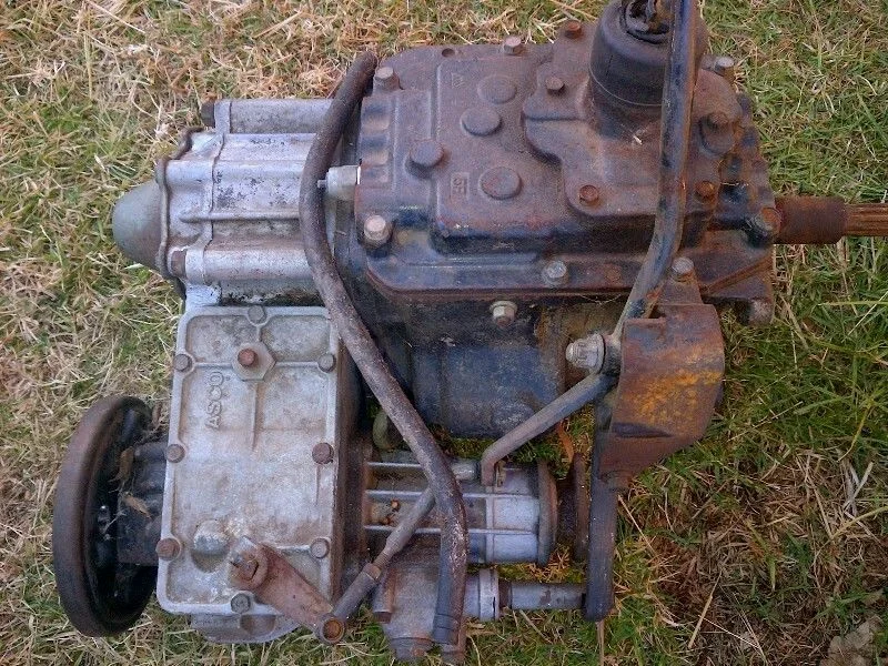

Had a guy look at my transfer box. Turned out that it had been assembled incorrectly by the PO... The gears are a bit pitted and worn so we're trying to get new ones, or at least better 2nd hand ones that won't whine, or another transfer case.

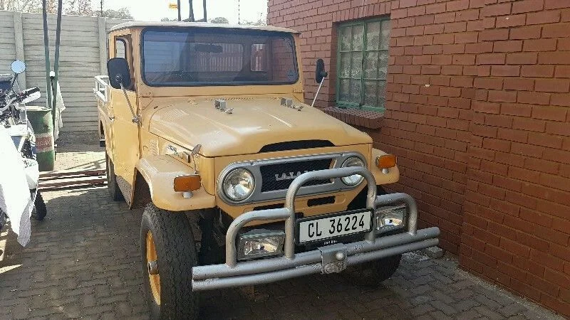

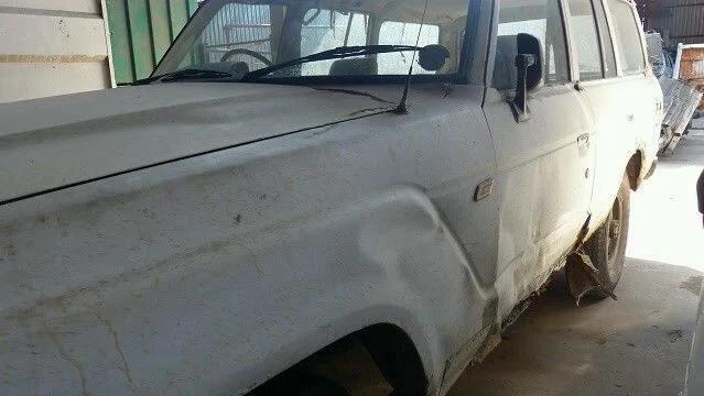

Got another lead on an FJ / transfer case yesterday. It is a job-lot of three vehicles and a bunch of spares. Apparently the guy is cleaning shed and wants to get rid of all the stuff at once, take it or leave it. Two runners and a wreck.
FJ45
RUNS BUT HAS CYLINDER GASKET PROBLEM
THE WRECK
GEARBOX AND TFER BOX
They're about 4 hrs away, hopefully I can drive down next week.

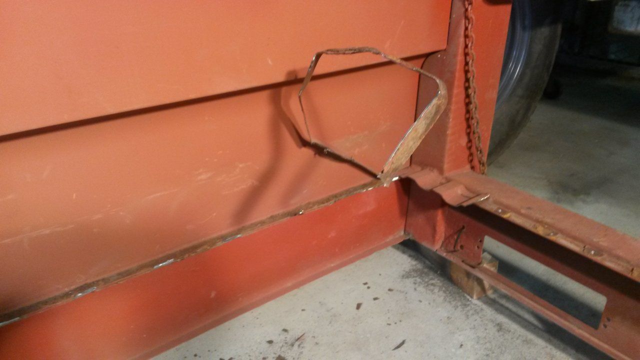

I eventually cut out the rusty parts on the bed floor. Then decided to just go the whole hog and replace the floor and wheel wells. Got new pieces made up and have drilled all the holes for welding it all down. It cost a little more, but it is going to be much easier to put together and the finished product will also look much better I think.
Once I've got the new floor in, I will hand it to Alfred who I'm hiring space from and his guys will finish and spray. Then it can go straight onto the frame.
