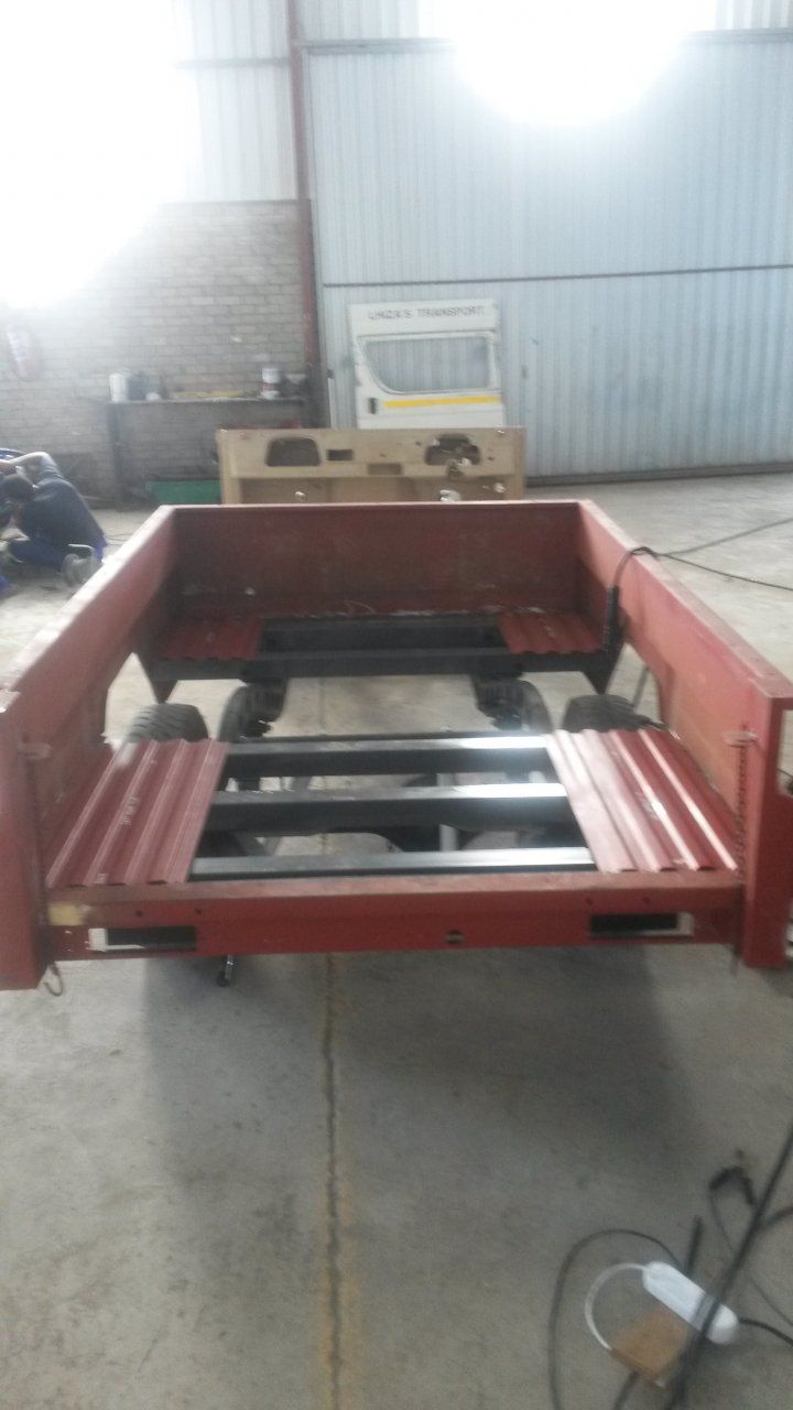

I got the new floor for the load bed - very nice, but the wheel wells were a disaster. Anyway, I made up new cross supports out of 75 x 2.5mm square tubing. I noticed when I took the old one apart that the factory had not painted the cross supports and that this caused bad rust, so I painted the replacements really well. Inevitably, where I weld the floor down, it will burn some paint away, but at least 99.9% of the steel will be well coated with paint before going down and will stay that way.
I have all the holes drilled for the button welds and now just wait for wheel wells to fit before welding it all together.
NEW SUPPORTS IN.
TEST FIT 1
TEST FIT 2
