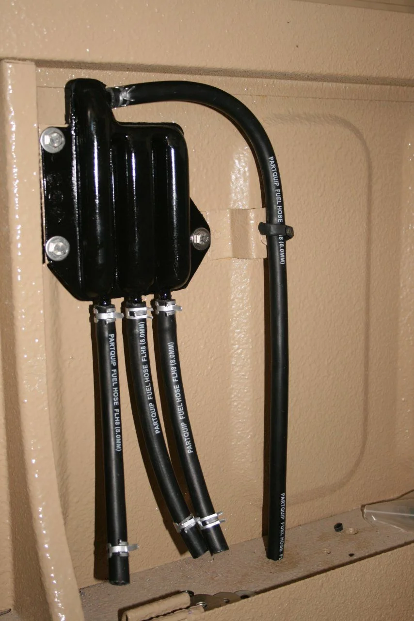

There have also been many last minute cleans and repairs, which should have been done earlier but had for whatever reason not been done. Like, the "fuel separator"(?) I had not cleaned and repainted them. All in the baggie, but still dirty and rusted. So it is clean up, paint, wait to dry and then fit. A 5min job becomes and hour.

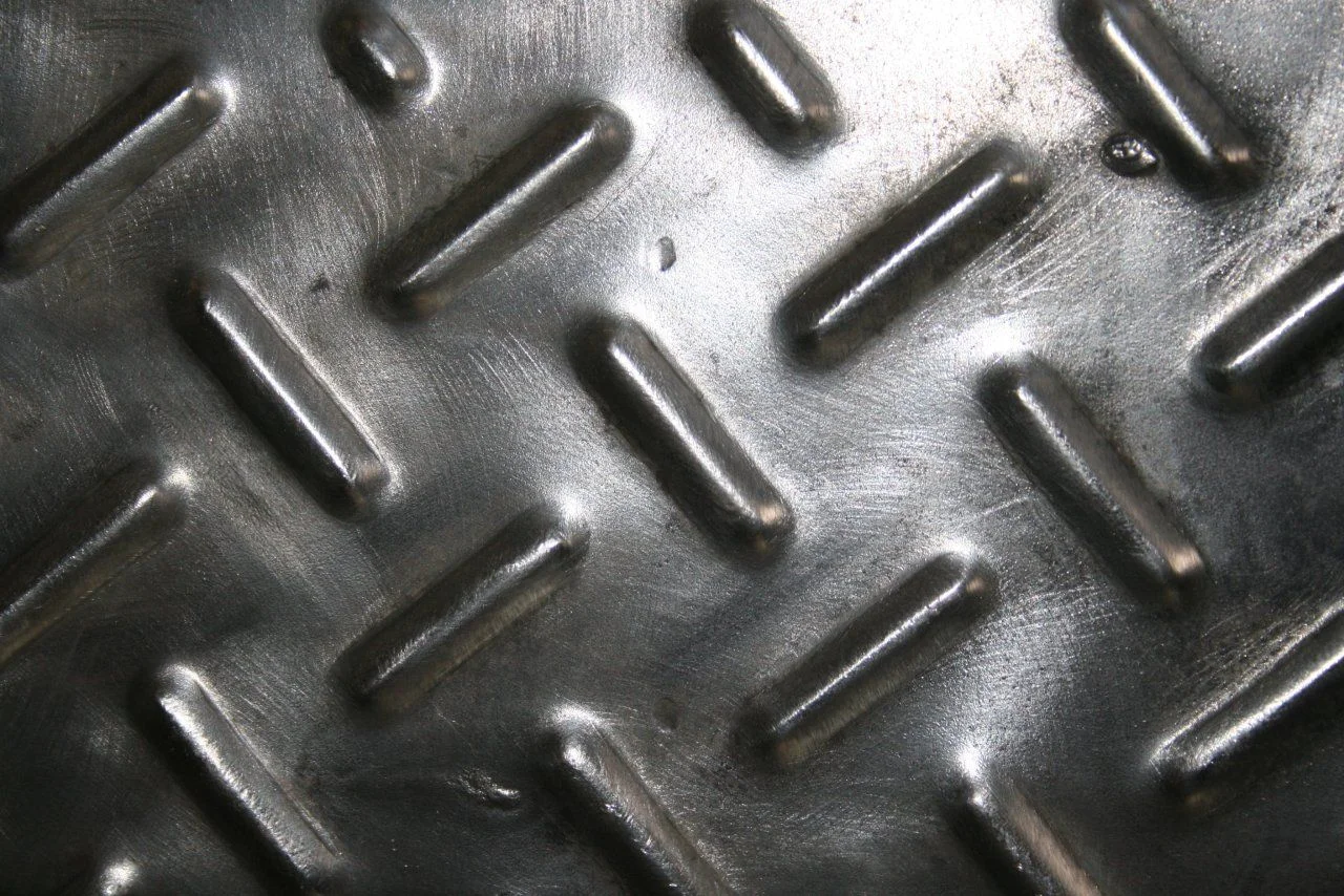

Another unforeseen hold-up was the quality of plating I had done. The same @#$^$^&(#$%$ that screwed up the paint work plated three items for me. The only things I had plated. They came back beautifully wrapped, so I resisted the temptation to unwrap them until I needed them. When I did, they were beyond s***.
PROUDLY PLATED BY CK CUSTOMS, NELSPRUIT. (Look at the rust on the filler neck)
Now I have to send them off to be re plated and wait for them to get back.

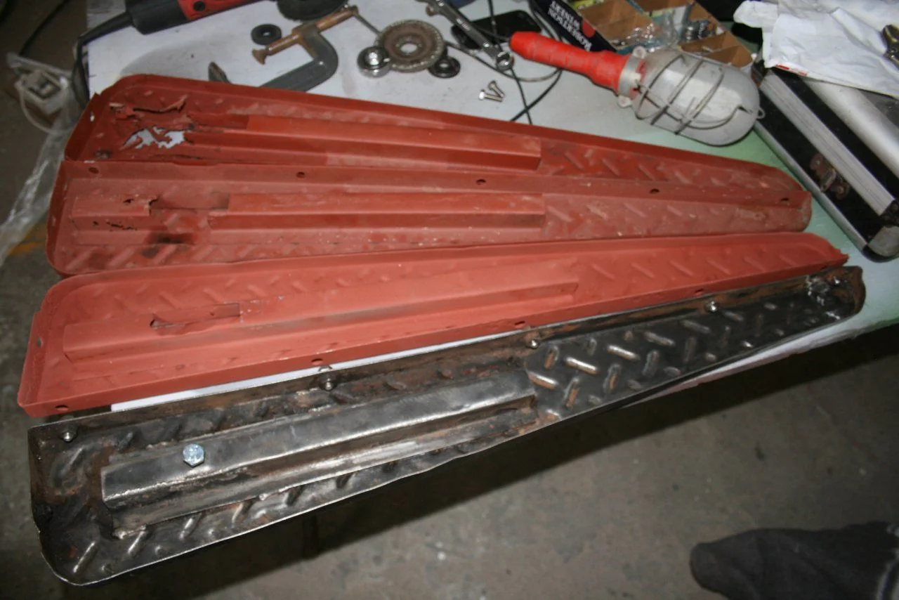

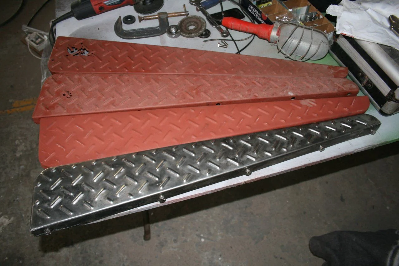

I now have two good solid running boards. Was hoping to do the repair to the one's support brace, but I am concerned about the exact position of the bolt hole. The others I have all have that part rusted away but show what may be part of a bolt hole. The problem is that those partial holes do not line up with the good one I have and I don't know whether its bolt hole is in the original stock position. Looks like I will just have to wait until the cab is finally bolted down and then locate the correct position.
I used my electrolysis set-up to take the paint and rust off the last step I acquired. I am so happy that I "discovered" this method of paint/rust removal. It literally happens all by itself overnight. Just a bit of brushing to remove the stubborn stuff and it is perfect. I was more than happy with the topside, but a bit of rust remained underneath, which I am sure another few hours would have sorted, but being in a hurry I sandblasted the underside to get rid of the residual rust.
MY COLLECTION OF RUNNING BOARDS. (ORIGINALS AT TOP)
RESIDUAL RUST AFTER OVERNIGHT ELECTROLYSIS AND WASH DOWN
CLOSE UP AFTER ELECTROLYSIS.
The bare metal one was covered in layers of thick paint and a tar substance of some sort and looked really bad. 18hrs in the tank and a quick wash down under a garden hose with and old rag and the surface turned out beautifully. You can even see the scratches left from a previous clean up. The process is really kind to the metal
I have noticed that the parts done this way do not flash rust like sand blasted parts and can be left for days without any discernible rust forming. I love it.

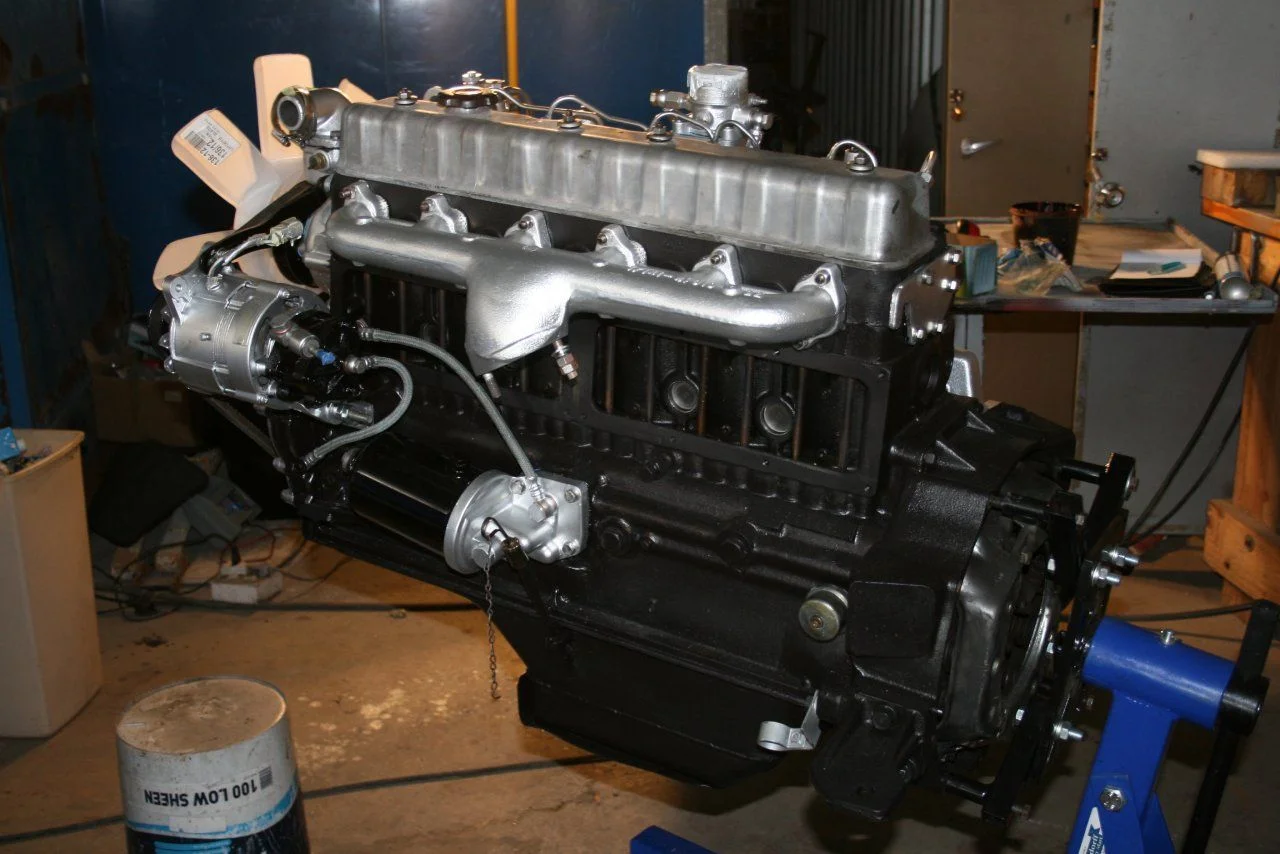

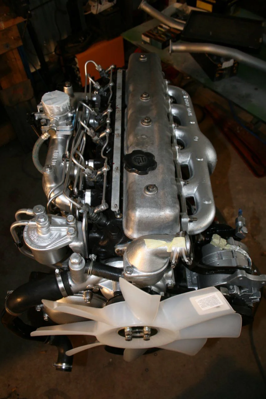

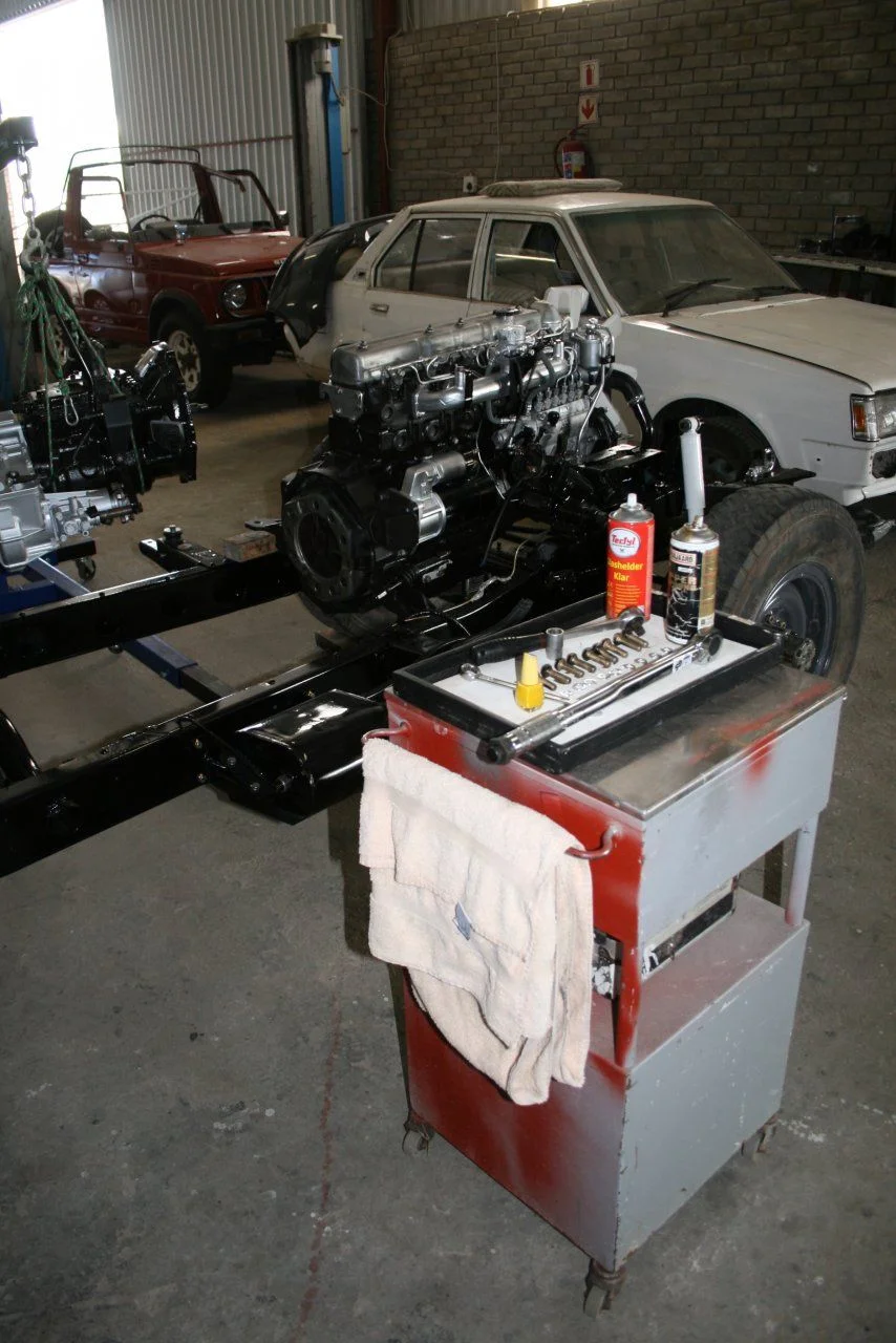

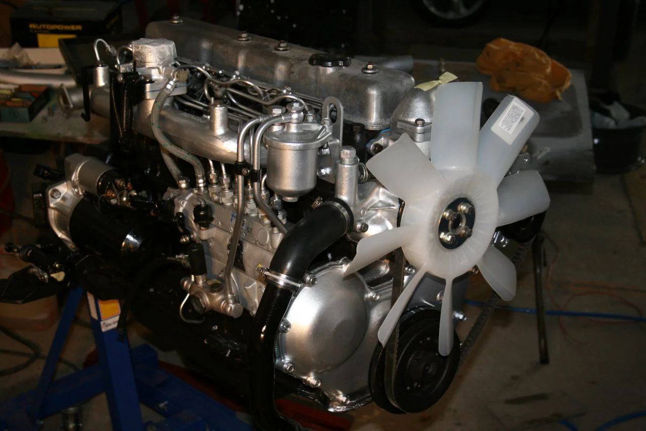

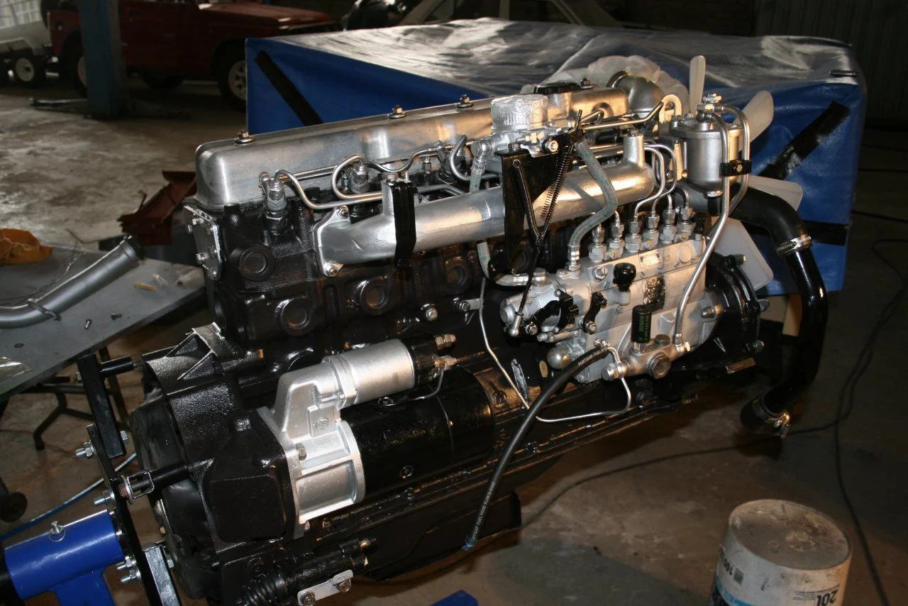

Today was the BIG DAY that the engine came together. All done but for the side covers which will go on tomorrow morning. Then it is gearbox on and into the frame. I was hoping to be driving by this time, but it should be quick as all the rest is basically assembled and it should be plug and play. Two problems did arise today. The engineering works failed to cut new threads into the head for the left hand bolt holding the lower thermostat housing/alternator adjuster arm. I'm going to have to load the whole thing on a trailer and take it to them. I'm not letting that stop me from installing it in the frame tomorrow. Also found that the threads for the three little screws that secure the alternator fan to the pulley are a bit suspect. Easy fix. Drill and tap.
Well, here it is. The next one has to be better. All the paint instead of plating just doesn't look right.
Difficult to take photos of this black engine and even more difficult to see to work on. Why did Toyota do them black?
I'm still trying to decide what to do with the valve cover. Paint, polish or just clean it a bit and leave it?
It is difficult to see, but in the first photo one can sort of see the homemade dipstick including a hand made retaining chain. It's rough and ready but somebody obviously spent a lot of time and effort making it. I'll just stick it in the glove box as it is a real piece of folk art and shouldn't be thrown away. I have a brand new one in the cupboard which goes on tomorrow.

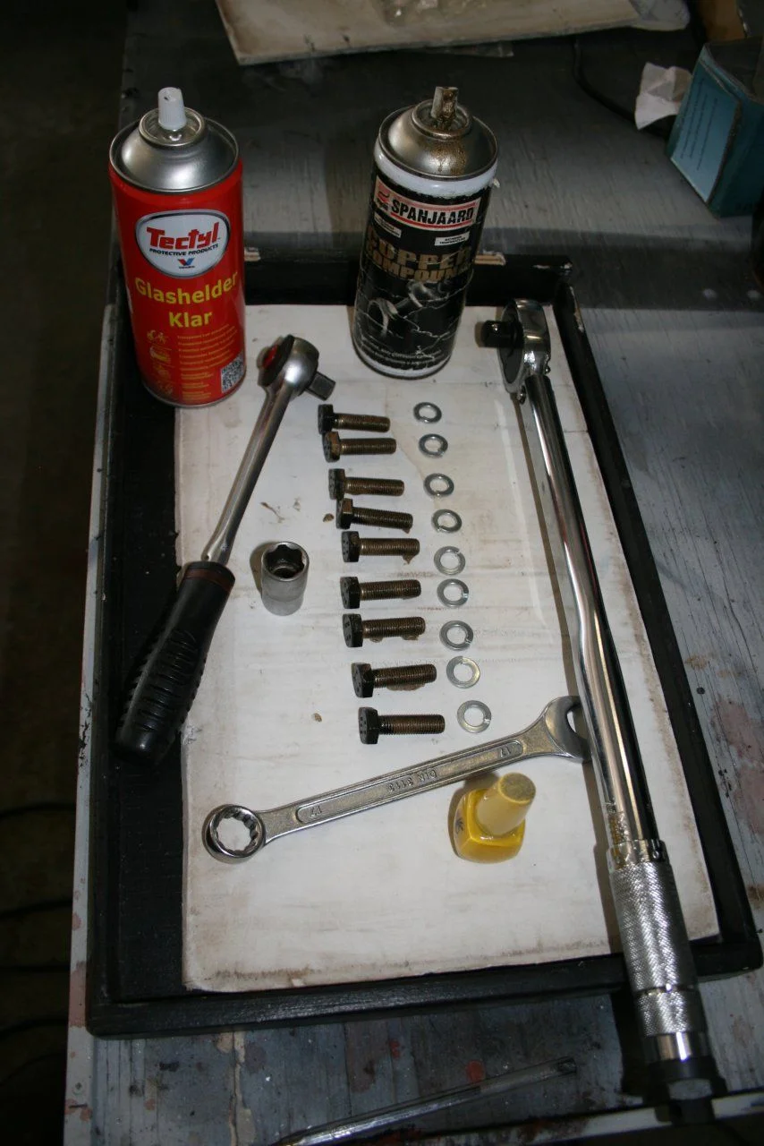

THE TORQUER'S MARK. DONE!!!
That great big transmission hanging unsupported off the rear of the engine just looks so wrong, but that's the way it is.
The little yellow marks are my way of keeping track of what I have tightened to the correct torque and what not. I find this essential at my advanced age and reduced ability to remember where I was once I have been distracted.

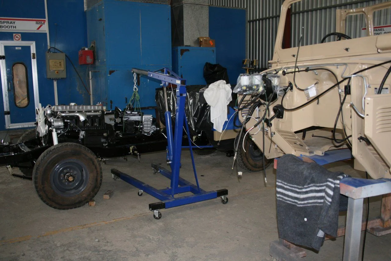

I installed the engine and gearbox separately because I had serious doubts about the el cheapo engine crane safely holding both. In the end it ended up being a piece of cake just slipping the transmission in the frame.

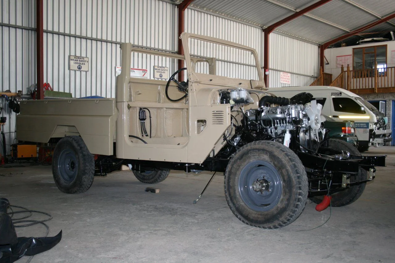

After securing the transmission and engine, It was time for the tub to go on. I commandeered 6 young guys who had come to get a quote on their vehicle and were waiting for the owner to lift it over the engine and position it on the frame while I supervised and lined everything up. I modified the front mounting on the body to make it easier to bolt down as I was unable to obtain original mounts at that time. The front mounting rubbers I'm using are about 15mm too high, so I'll have to cut those down a bit. Shouldn't be too much of a hassle.
The same guys then helped align the load bed that was already sitting on the frame. Another quick and easy job.

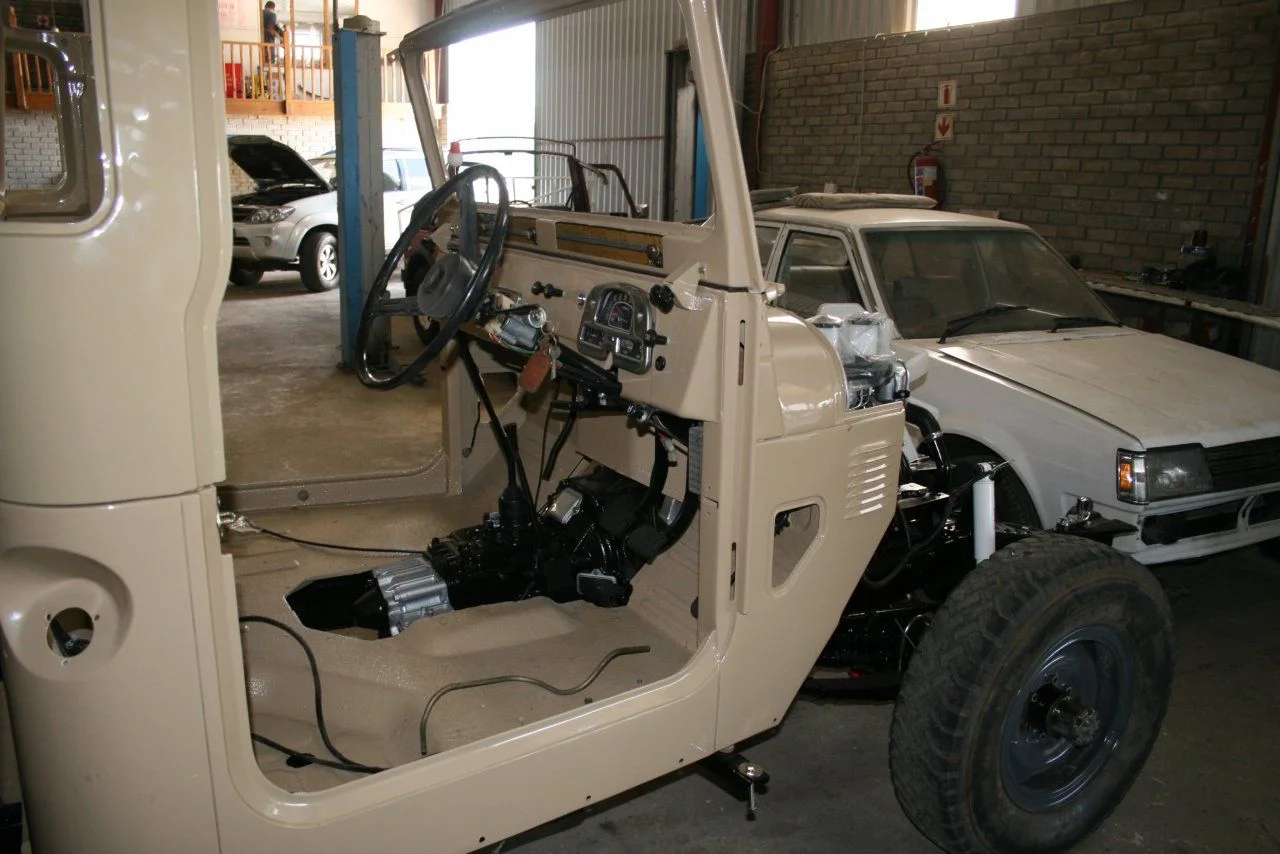

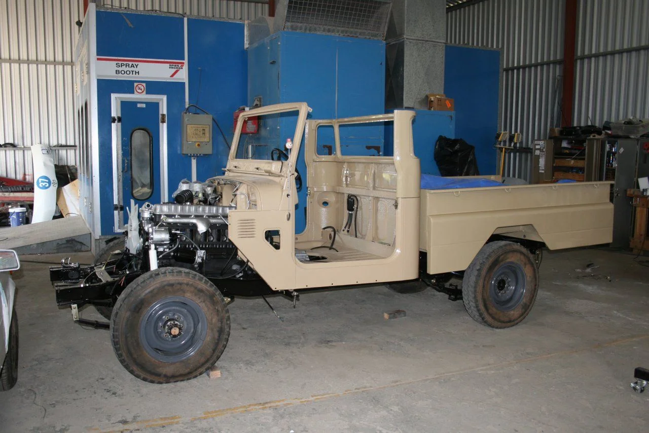

Now the Dagha Boy is actually starting to look like a truck again. No longer just a collection of parts and assemblies.

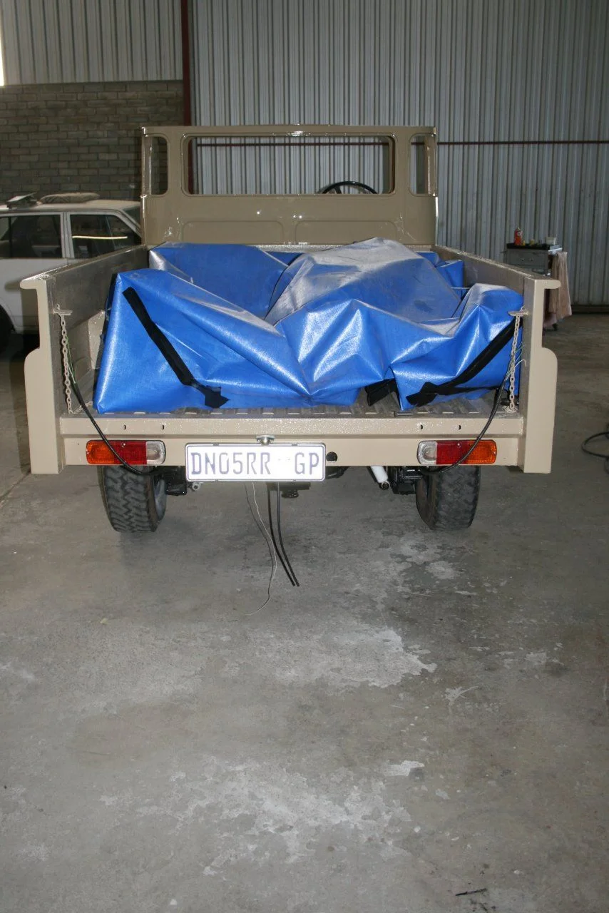

Here's wishing you all a very happy Xmas and a Cruiser filled 2017.
REAR VIEW
LOOKS LIKE A CRUISER
HANDSOME BOY
BACK HOME
I FEEL THE SAME WAY... CAN'T GET THE SMILE OFF MY FACE
