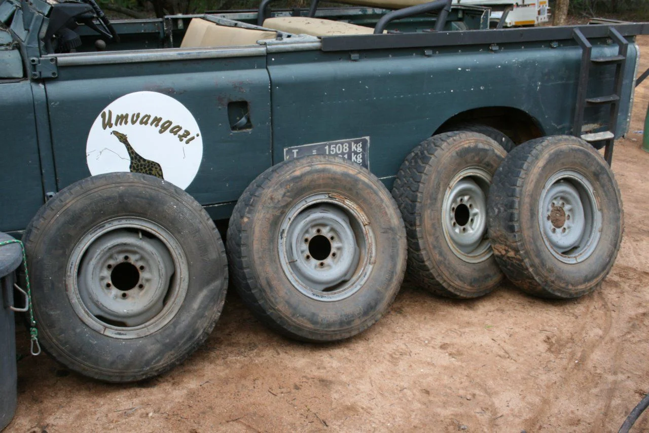

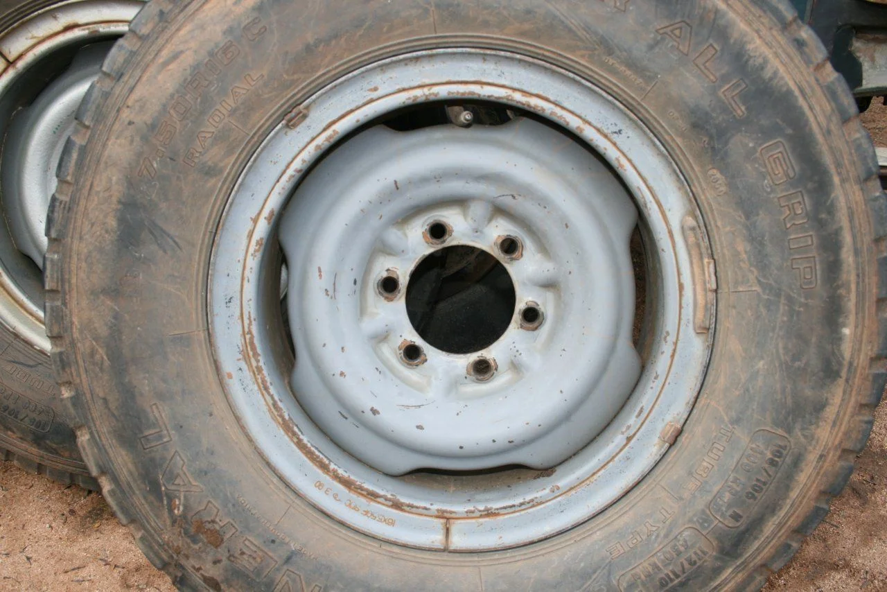

Left early so I was there by seven this morning. The main mission was to drop off the roof and rear cab panel with Kobus at CK Customs and to do the physical swop of the 15" wagon wheels for 16" split rims. When I proudly showed the wheels to Kobus he said that about 5 years ago he sent 12 brand new sets of them for recycling because nobody wanted them anymore, everybody wanted fancy rims. It is to weep!
I'll take the rubber off over the weekend and get them blasted and then paint them next week and of course 5 new Dunlop crossplies. Ouch!

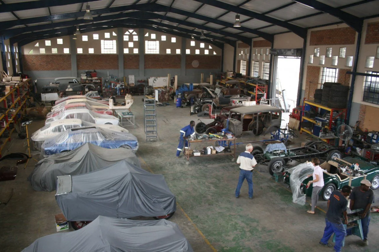

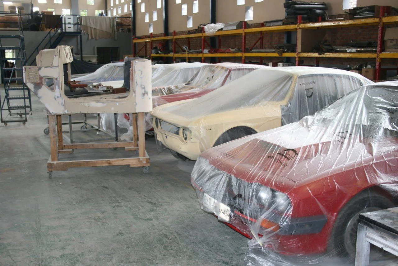

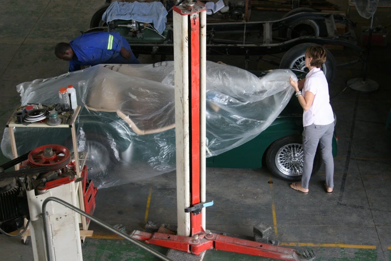

Dropped the roof etc at Kobus, new bigger workshop. Still a mess but I'm sure it will be back to what his old shop was like shortly. Inbetween the moving they have managed to do some work on the Dagha Boy's tub, doors and fenders (the fenders had to be converted from LHD to RHD. No wonder I got them at half price)
Some pics just to give you an idea of what he has in his shop at the moment.
SHOP TRUCK
DAMAGE CONTROL
On the right, Triumph, '27 Hudson next to it and a '52 Citroen hiding behind that and them a hacked up FJ45 and a couple of 40's pickups.
LET MAMMA PUT YOUR BLANKIE ON
The little green Triumph being covered is beyond gorgeous. The chrome and the leather work just boggles the mind. The two front seats are not yet in but look like two works of art.

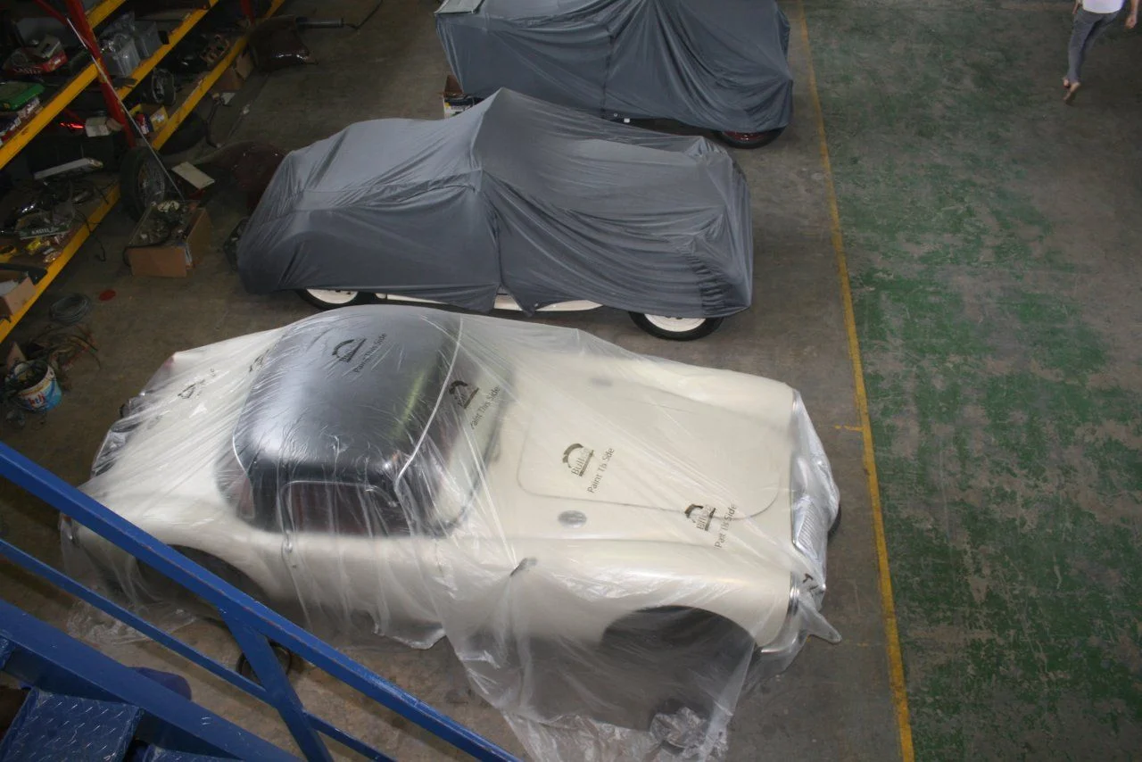

DOWN THE OTHER SIDE
I don't know what the first three are, but I think they are all British and belong to the same guy. Then Alfa Romeo, E-Type Jaguar, Alfa x4 and right at the back a '58(?) Mercedes Benz Limousine.

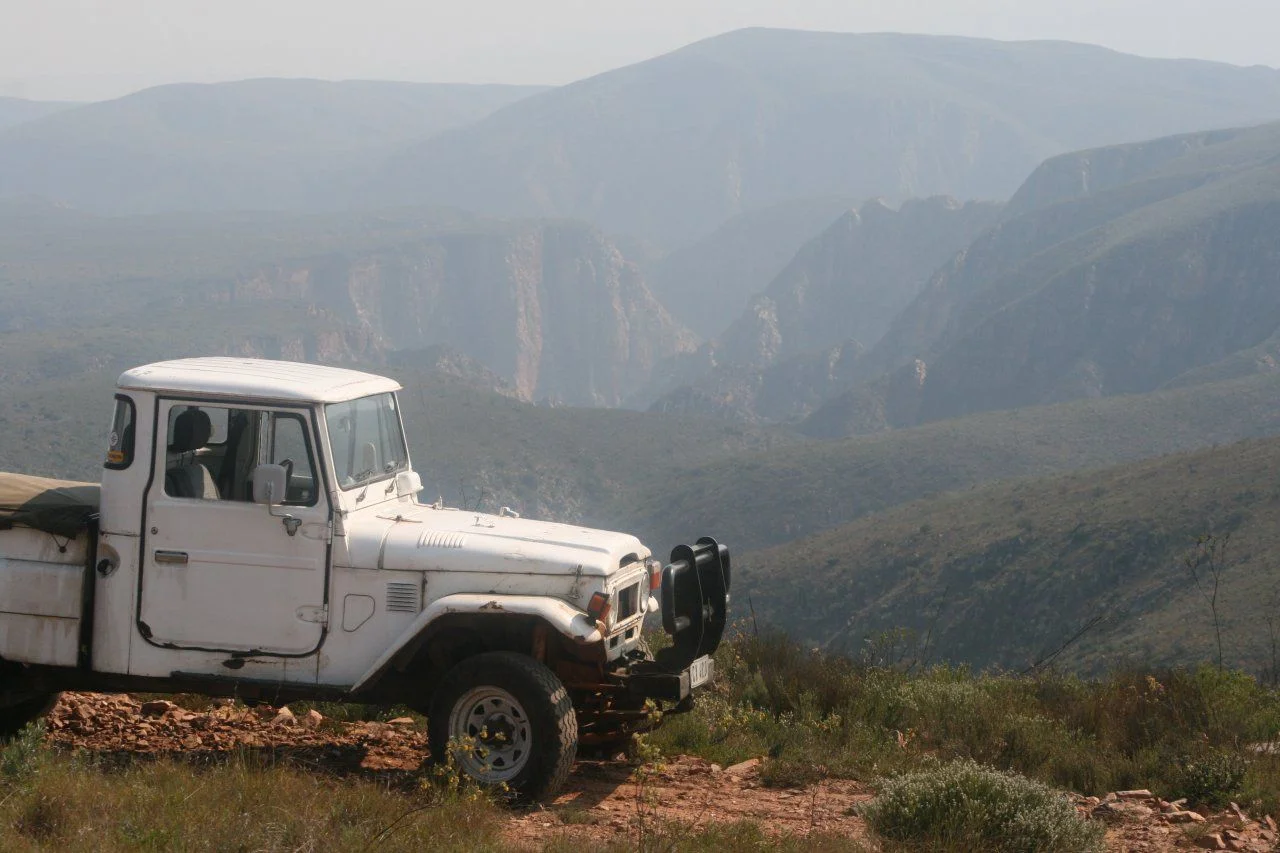

I've got to work some 40 series tech in here for the purists so, a picture of Tom's old HJ45 crossing the coastal mountains on the way to the Baviaanskloof.
TRACK TO BAVIAANSKLOOF

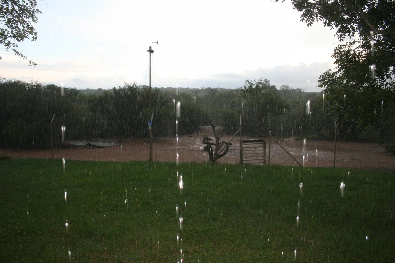

We're getting a bit of rain. Too late unfortunately as the growing season is over. But we'll get some growth.

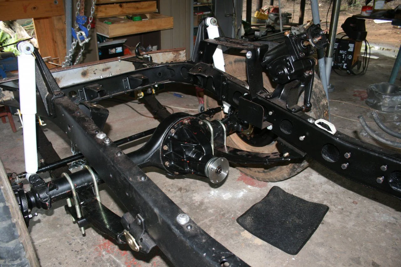

I collected my front axle yesterday, all perfectly done. I wrestled the bugger out of the Jeep this afternoon, fitted wheels and rolled it under the chassis hanging on a tripod. Got it roughly in position, lowered the frame, lifted the back of the springs up and put the spring hanger pins back in. Then hoisted the frame and springs up against the axle, shuffled it around a bit till it was in position and then hoisted it right up again and installed the u-bolts and shocks. Then lowered it and Dagha Boy is back on its front legs. I couldn't fit both assembled axles in the jeep at the same time so will fetch the rear on Monday.
RAIN AT LAST
SOME DINGS AND SCRATCHES BUT IT'S IN
VIEW FROM BELOW
But, I'm a bit concerned. It looks to me that the diff is tilted slightly - higher at the back. Looking at it, and it's getting too dark now, it looks to me that I may have the springs on the wrong way around. The shorter portion of the spring is at the rear, so where the axle is sitting it is already starting to bow upwards.
But that is tomorrow's problem. Any advice?

Hydraulic lift.... I'm greedy I want SuperBuickGuy's whole workshop!! (That includes the Buick) This is the nice part of the build. I can't wait to do the brake system. Everything for that is brand new.

Your front springs seem ok to me, shorter section to the rear. The axle centre line to the rear hanger pin is 500mm. The nose of the diff should be slightly up.
There are plenty of vegetables in the beer ;)
thanks. that sets my mind at rest on both counts, the axle and the veg.

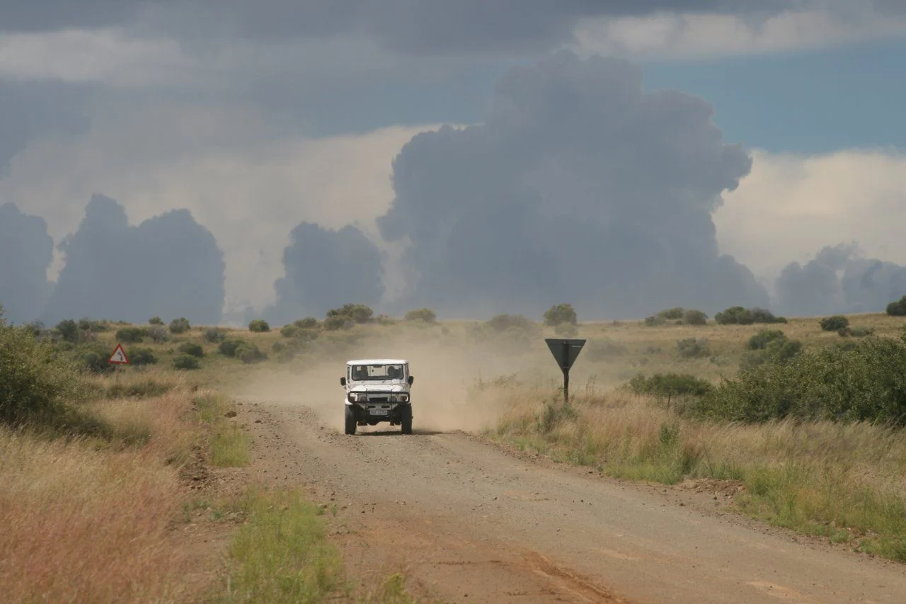

Here's one of the MWFD's son Tom, (MWFD co-pilot) getting the previous HJ45 sideways while running away from a storm while he was driving it 1000 miles across the country (back roads all the way) after we bought it. I was driving ahead of him in a Merc and had lost traction on the loose stuff so knew what was coming and waited for him to take the photo.
Next morning the MWFD took the Merc and abandoned us, so we bought a couple cases of beer and cruised the last 500 miles home.

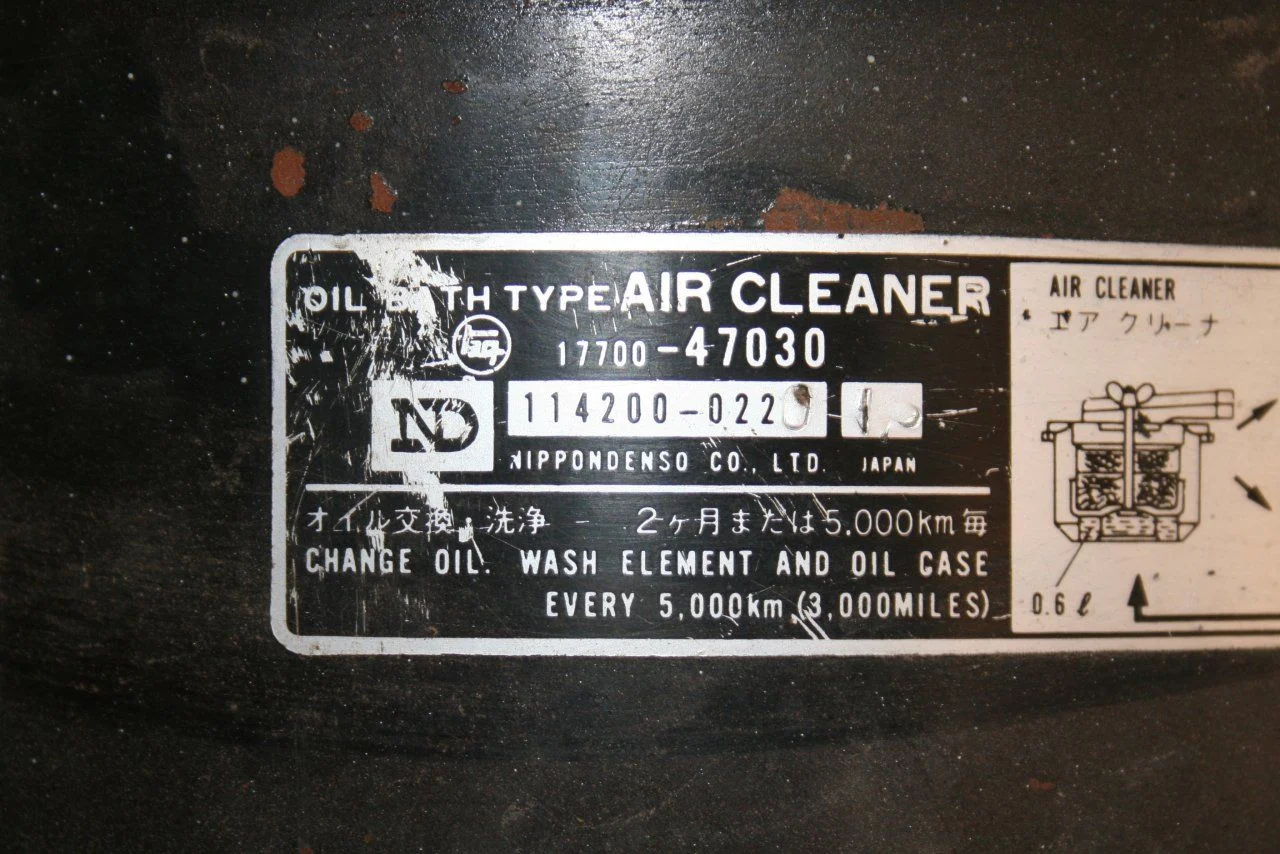

I have one piece that is still in rough condition that I have to clean up and restore, but I'm reluctant to destroy the decal on it. I have looked all over on the internet and cannot find this one. Does anybody know where I can get one? Maybe Beno?
It's pretty battered but if I can't get a new one I seriously considering taping it off to retain it. Please help.
Mask off the decal and cut the paint back with cutting compound. Then clear. It's good to have some things that aren't perfect, unlike paint.
