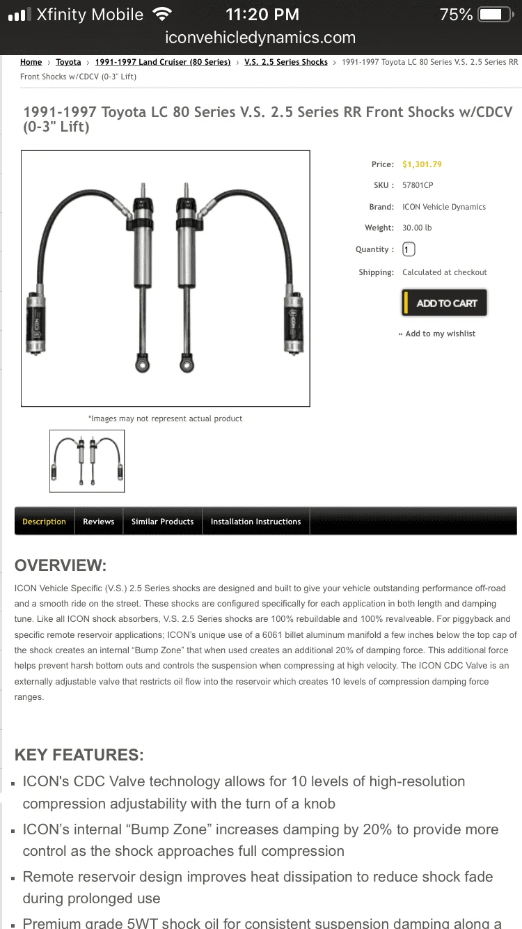

The 2.5" are part of the Stage 2 and above. I don't know where those fit in because they also add the CDC valve on top of being 2.5 remote resi.
These are the shocks that are part of the Stage 1 package. They are roughly the same price as the Fox 2.0
