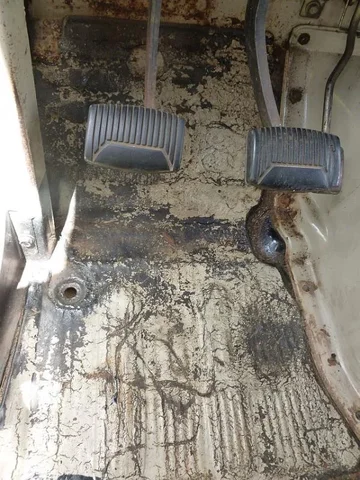

Today, I began working on the rust..overall not near as bad as some Ive seen...but Im no professional. I decided since the undercarriage looks pretty darn good, I start with the interior. Pulled out the floor mats..this is what I sawDside floor b4.webp

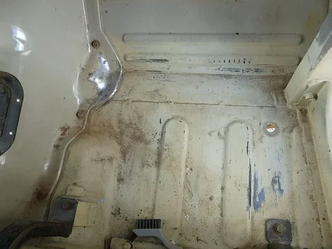

The passenger side took all of 15 minutes...so naturally I did the 'easy' side first
Maybe someone can tell me what this rubbery stuff was on the driver side - but based on what common sense I have and the difference of appearance I figured the rubber was bad and I peeled it all off.

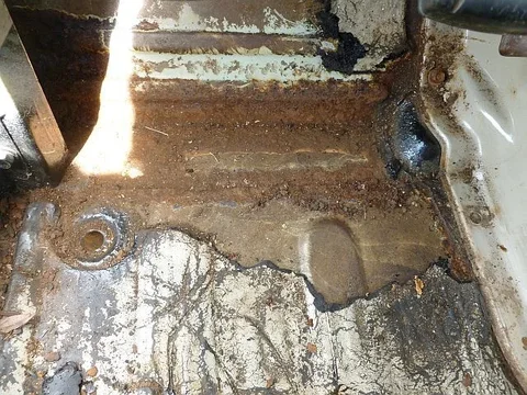

Scraping off the 1/2 inch thick rubbery stuff - I discovered I was indeed on the right path

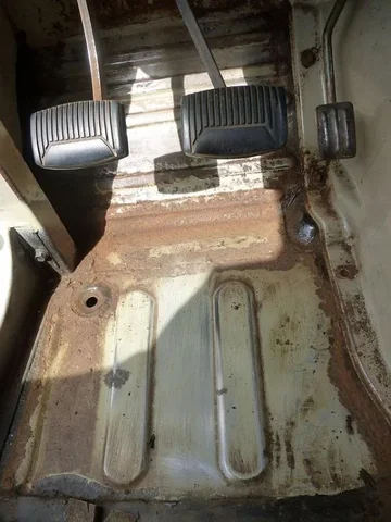

After two hours I decided that learning how to use POWER TOOLS would help this side.. Here's how I finished the day

my truck had the some of the same black stuff on the driver's side - I suspect it was meant as a heat or noise barrier

Looking good there! The rust showing so far really appears to be minor. Hopefully the rest of the body is no worse for rust.
Another area to look closely into is keeping exterior water out, as in rain. Make sure the rain gutters are still sealed, the window and door gaskets don't leak, etc.

Good Looking rig,. I had a set of bilstein shocks on one of my other 40's and liked them. It's not going to ever give you a cadillac ride but then again, it's not a cadillac! On the mat on the ds floor, my 75 had it there and I agree that it is most likely a heat barrier. One thing you may want to check is the floor under the fuel tank. You will have to pull the ps seat to get to it but that is a good place for rust to hide and start and it will eat your fuel tank up.

Pick up a 4.5 inch angle grinder and a knotted cup brush. It will save a ton of one with rust removal . You should also check out clubs in your area. ONSC is a good group.
