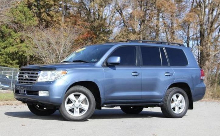

mild build is a go so she doesn’t look like all the soccer moms.Here is what we are starting with.
2008 with 111K when we picked it up.

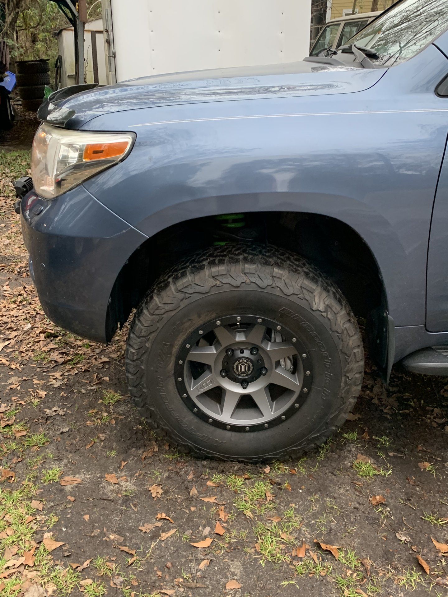

I looked at about 100 wheels before deciding on these. They look like the have black accents here but they are all Grey except for the outer ring and center cap.

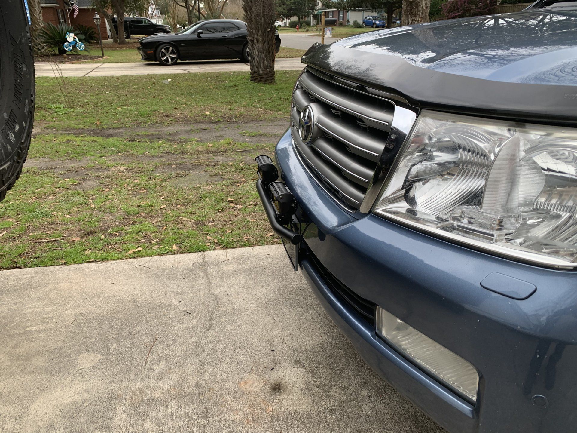

This one is aluminum. The welds actually look really good. I was impressed considering it pretty Inexpensive. I didn’t want to spend a lot because down the road I may end up swapping out the front bumper anyway.

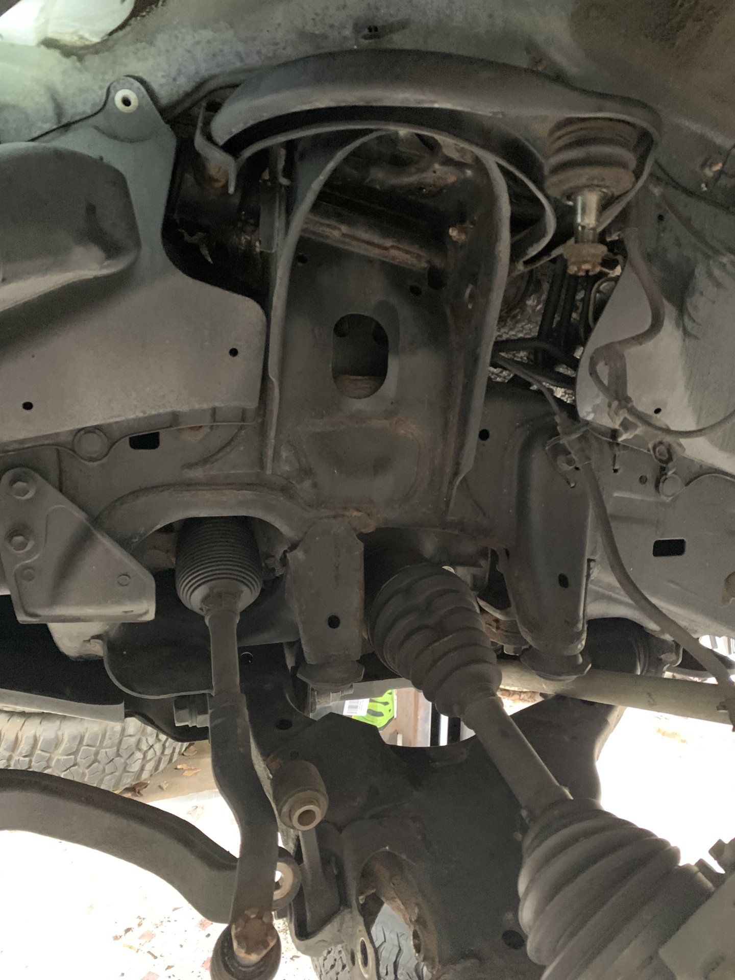

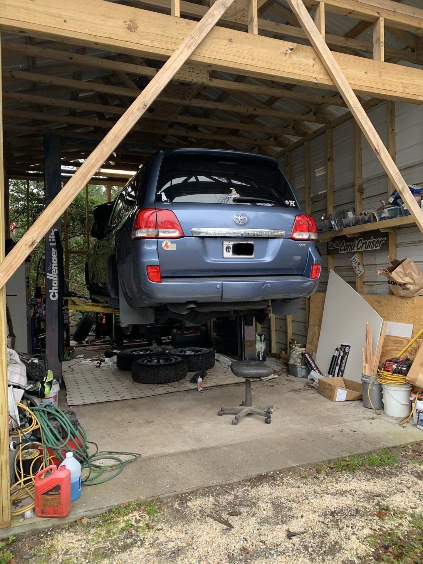

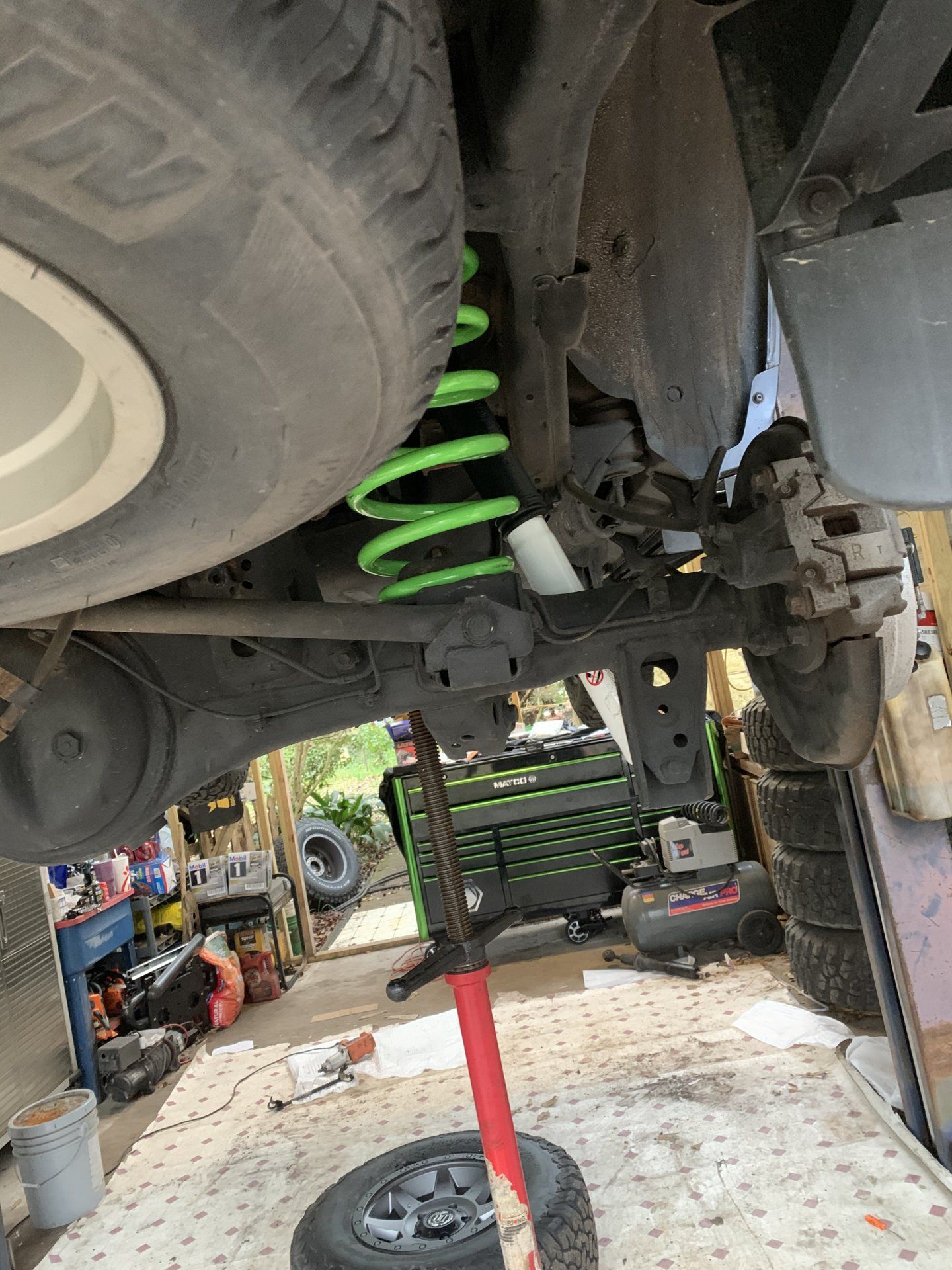

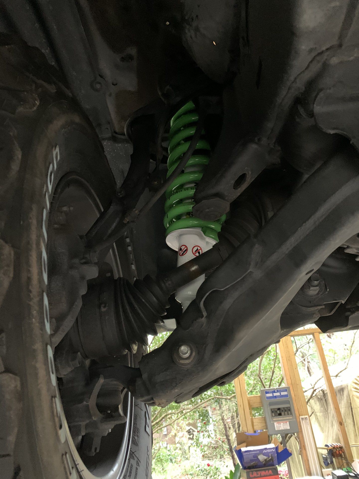

David and I got the 2” Iron Man lift installed yesterday! I am extremely happy with it so far. Thank you 6 lb 8 oz baby Jesus the KDSS valves weren’t frozen. They didn’t move without a fight and some PB blaster but in the end they relented. Also really glad David has all the tools and lift. I can’t imagine trying to do this on jack stands. I’m also glad he has a friend with an auto repair shop. We tried doing the front springs with a spring compressor I had ordered. After scratching up a spring and thinking we were going to die, we took the front springs and had them assembled on a commercial spring compressor. If you are going to tackle this lift make sure to clear your schedule for the day. Even with David’s expertises as a former professional mechanic it took all day. Of course it probably could have gone faster if he wasn’t teaching me what to do and explaining things along the way. On mud it’s pics or it didn’t happen so here you go.

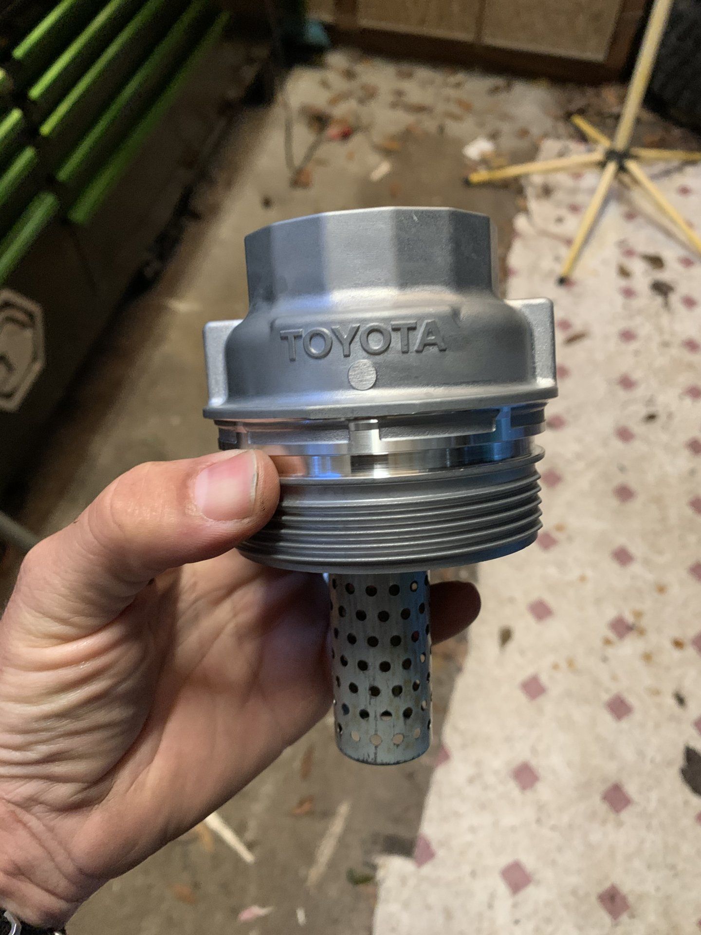

Wasn’t sure when the last oil change was on the truck so we went ahead and did one for good measure. Did a few “upgrades”while we were at it. Mobile 1 full synthetic, TRD oil filter, swapped the plastic cartridge cap for an aluminum one , and added the drain valve. And while we were at it we replaced a bunch of bolts that were missing from the skid plate that had been left off during previous servicing by the PO or dealership.

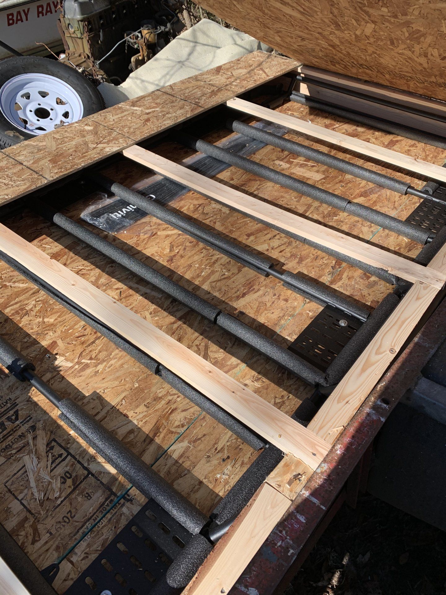

The new rack came in! Gamiviti is serious about their crates. The rack was well protected. FYI. Saved about $100 on shipping by picking the rack up at the terminal on Daniel Island instead of having it delivered to the house.
