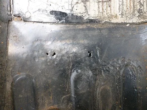

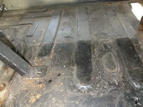

Alrite..Im putting this to you professionals..if you saw my previous post, I pulled off the rubber matting on the driver side floorboard and have been sanding and scrubbing. The question is - right below the seat is a completely sealed black coating, brushed on - (por15, i think) and it looks well done..noting two tiny holes right at the beginning of the coating.
Should I leave this alone? Or scrape it up while Im doing the floorboard?
I have no urgent mechanical necessities to be done - so I want to get a handle on rust now..so leave it/like it...or live with it?

Take a peek at the location underneath. It looks to be fairly thin from the top. It can be patched and treated with rust converter or.....Get into it and cut out the thin area and replace. Not an extremely easy task for a novice but with patience it can be done.Then of course there is the option of Treat the rust and fill in the area with bondo, fiberglass resin etc. which is not a long term fix but it all depends how far you want to take it or just drive the stuffing out of it and have fun lol. Btw I have relatives in Luffkin and Beumont. You near either of those?
Leave the holes alone for now and keep driving and enjoying your FJ40. You have very minimal surface rust in your foot wells after you removed the factory tar, that is a very good sign. Check the underside of the tub for rust and post up pictures. "Mini truck" power steering is the easiest and cheapest to install, check the FAQ about it. Power steering is one of the best upgrades you can do for everyday driving. For your rear turn signal issue, check the bulbs first then the grounds, it is usually a ground issue. If you don't have a multimeter, that is the next tool you need to purchase.
