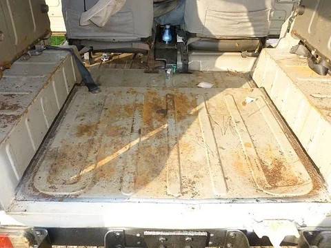

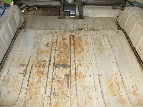

Todays work - before and after - as well as my obligatory "dash kit hula girl customization" :cheers:
The huz got me my very own sander..Id had a rather crappy day and felt cranky..it was 90 degrees here at 6pm..so I decided naturally that Id work out the days frustration on the rust.
Turns out power tools have some sort of medicinal value..When I finished up - I told the fam to jump in..On the advice of this forum - It was time to enjoy the hard work (and I figured a ride would help blow out all the dust I kicked up)
