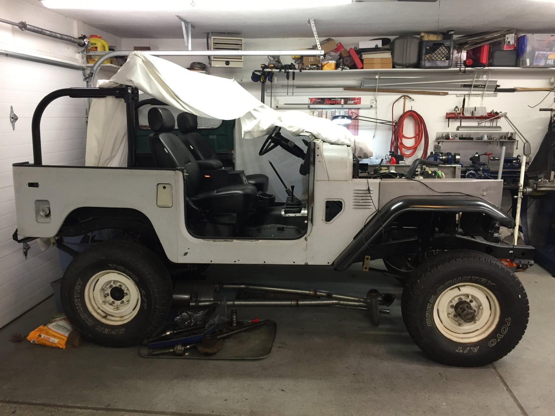

Here is a picture of my rig sitting on 33x10.5’s before I owned it and before the 3” stretch. To me the rears look fine, but the front gap between the fender and the tire looks too big.

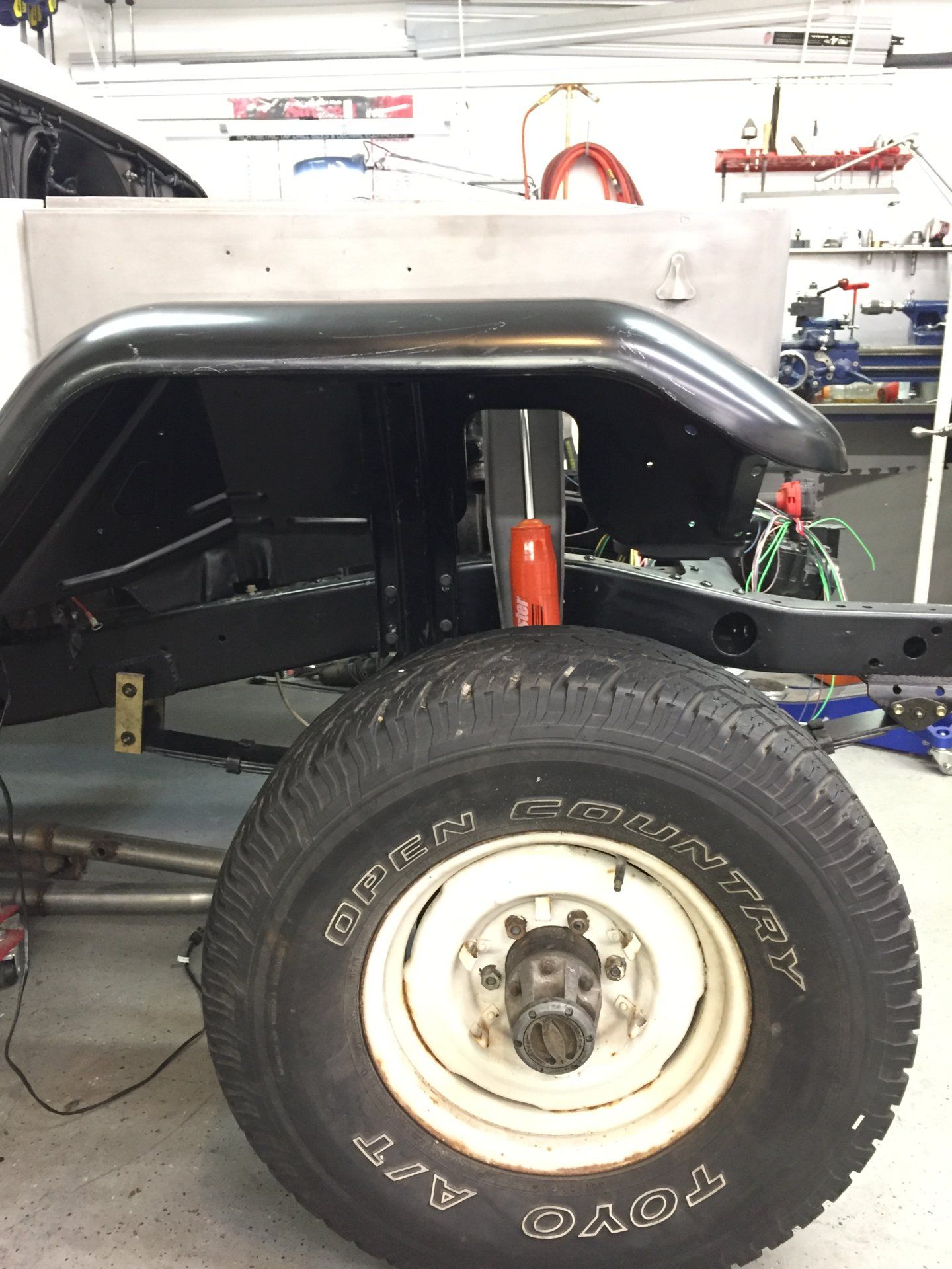

Here it is during my build after the 3” stretched front sitting on 29” shop wheels.

Based on the mods you've described I assume you intend to wheel it fairly seriously. In that case I think you will eventually wish you had 35's on it.
To my eye, 33's might look odd in front with the 3" stretch AND SOA. Are those 30-31" tires on it now?
Thanks for your reply. Yeah I think your right. I’m leaning more on the 35 side
The shop tires that are on there measure around 29”. The ones in the first picture are 33x10.5.

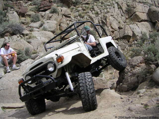

The near white 40 was on 4" lift springs with 35s, mine was behind it soa on 33's.
