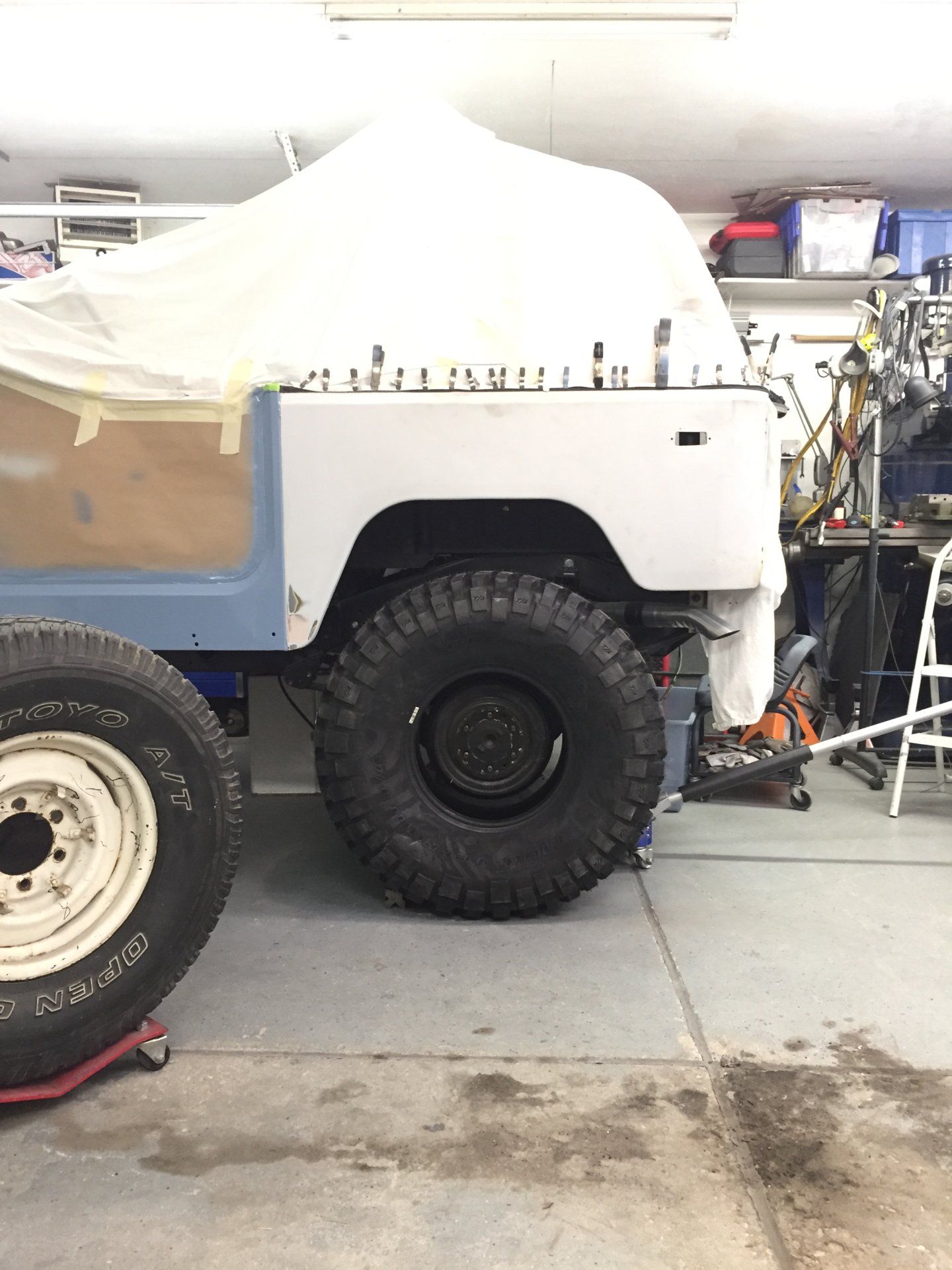

Thanks for everyone’s advice. Just received some BFG KM2 35’ x 12.5s. Very happy that I went with 35’s instead of 33’s. I purchased these from 4wd.com (I know it’s a Heep site, double thumbs down :poop:) but for $220 a piece I thought it was a great price.
Here is a picture of the tire centered on the rear drum. I think it’s gonna look great!

Oh man thats gonna look so sweet!!!!!

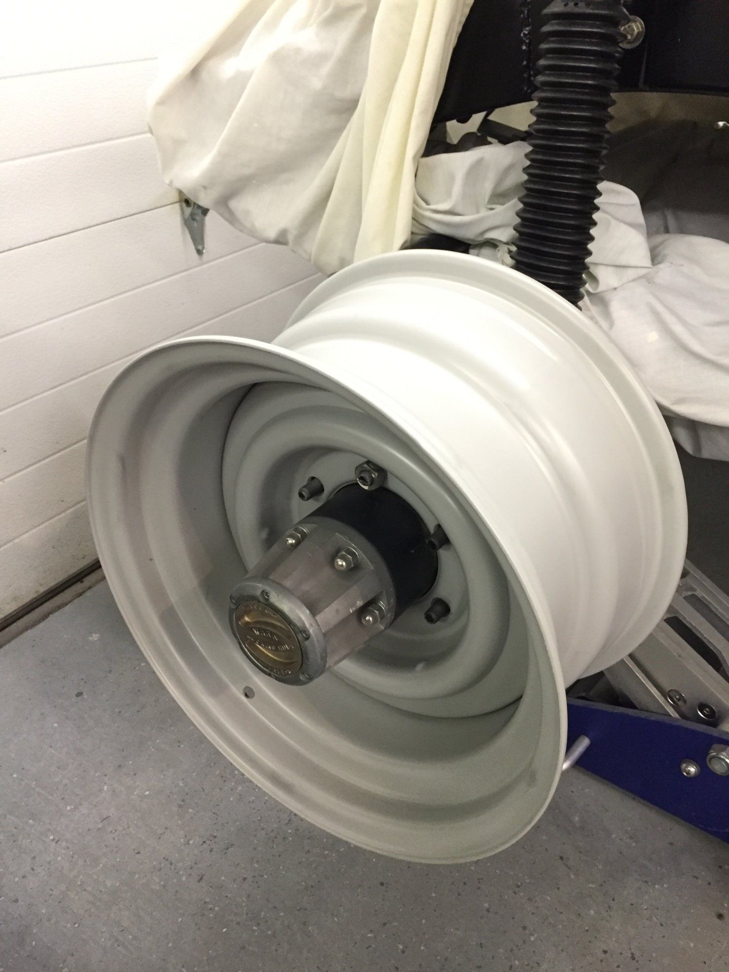

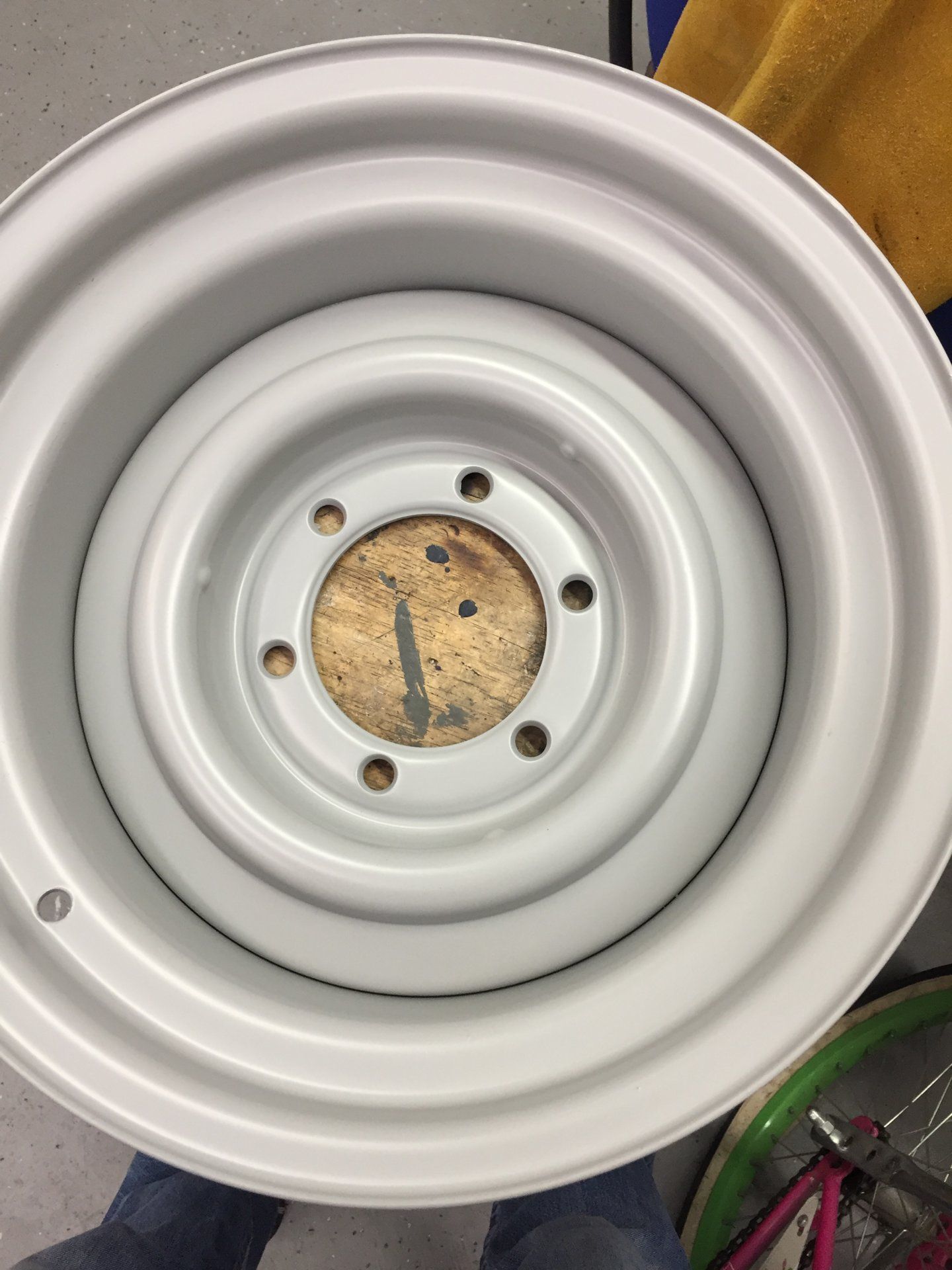

So whats your wheel dimensions?

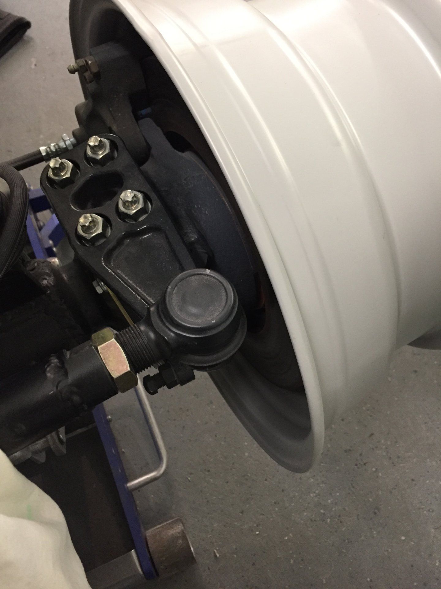

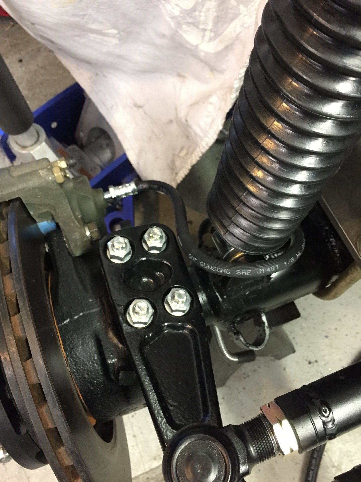

I don't think those will fit man. 4" is a lot for a cruiser axle, steering arm clearance will likely be a issue without spacers.
I slipped them on both front and rear axles and they seem to fit fine. They were close, but did spin freely.
Could I be missing something? Maybe they clear because I’m running All Pro Steering arms?
I probably will run spacers, just not sure what size.

Oh if they clear your steering arms you are probably good. I was thinking of stock arms, those arms look nice. The only other thing to check is if the tires rub the rear inner fender when flexed out a bit.

I have some 4 inch back spaced wheels they will work but they will rub the toe rod end rubber boot when using stock steering arms and forget getting the wheel balanced the tie rod will knock the weights off I had to change wheels when going to 4x4 labs highsteer the wheels did not clear Luke’s arms without a spacer.
When I ran 35's and 4" backspace the tire rubbed the inner fender of the tub when flexed. 1" spacers cured it.
I have some 4 inch back spaced wheels they will work but they will rub the toe rod end rubber boot and forget getting the wheel balanced the tie rod will knock the weights off I had to change wheels when going to 4x4 labs highsteer the wheels did not clear Luke’s arms without a spacer.
I'm thinking the allpro arms have the Ackerman angle for a Toyota pickup. 4x4 labs has the Ackerman angle for a fj40 i think and is why they rub with 4" backspace.
Looking at the rear tire centered in the wheel opening it looks good. However I noticed the shackles are in the slack or forward position and will move the axle to the rear when compressed. Is this going to be an issue for U ?
