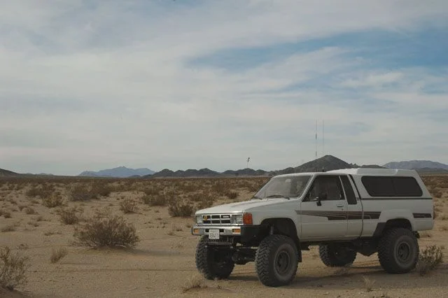

Try #2. 1986 Extra Cab 4x4
Try #1: http://forum.ih8mud.com/79-95-toyota...oorrunner.html
Try #2:

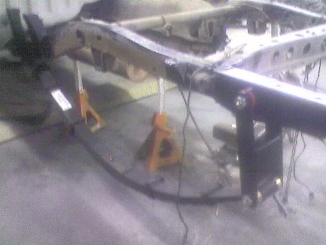

22re- stock with a new fan clutch, and 3 core radiator. LC engineering motor mounts, 5 speed trans, inchworm dual case adapter, all pro 4.7 gears, toy4crawlin tripple shifter, 4x innovations trans mount, budbuilt x-member, all pro long travel front driveshaft, rear .250 wall shaft, 5.29 elockers front and rear, front 62" wide diamond axle housing, longfield shafts, 6 shooter knuckles, Fj rotors, bigger v6 toyota calipers, ARP knuckle and hub studs, custom brake lines, rear 1.5" spacers, national front springs, deaver rear springs, f-250 shock mounts, bilstein or BBCS shocks, FROR highsteer, New 35" mickey thompson MTZ's on weld on beadlock wheels, ramsey re12000 winch, tuffy console, 12 volt guy switch panel, driven industries tube works interrior cage, ARB fridge

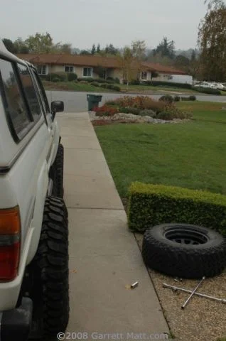

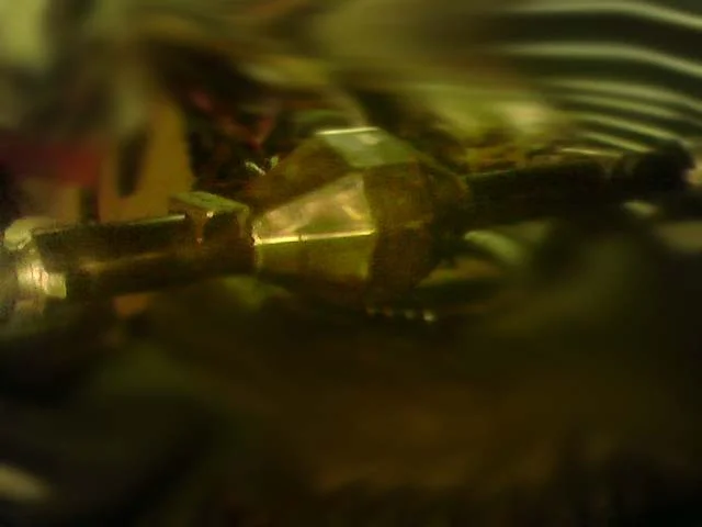

Its Begins.
GRM is offline   Reply With Quote

Parts.

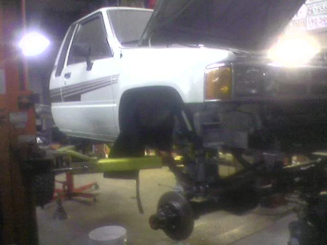

Mockup

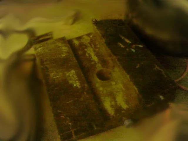

Diamond Showed up Today. Also grabbed a Downey Aux fuel tank.

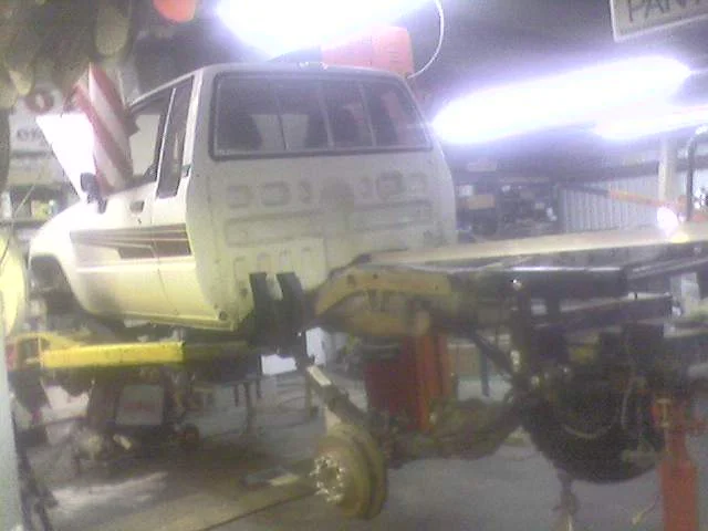

been working on it the last 5 days. Bed is off, IFS is torched out. Diamond Axle is hung. Rear springs are hung. Extended the frame 4". Added one more x-member.
Spending ALOT of time on little detail work.
Should be another 3-5 days before its driving again.

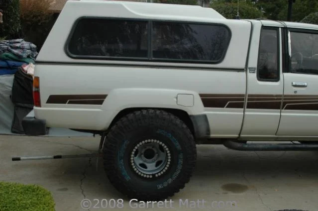

Snapped a couple more pics tonight. It looks tall because its at full droop, but according to my measurements, I'm at about 3.5-4.5" taller than stock.
Whats left before Im driving it again:
Rebuild transfer cases
Make driveshafts
Make rocksliders
mount shocks
mount aux fuel tank
Mount Purporting valve
bleed brakes
Mount last 35" on the beadlock
Its almost there

Rolled the truck out of the shop thursday night.
Friday I was on the highway, and put almost 1,000 miles on it by Monday.
Overall im pretty happy, but I have a few problems:
Pitman arm is too short, and the box needs to be moved. It won't turn lock to lock, pitman arm hits the spring, and the drag link end hits the tie rod.
Rear springs are too soft (stopped by deaver, and Jeff is going to rebuild them for me, needs 2-3 more leafs per side to make a 14 leaf pack).
