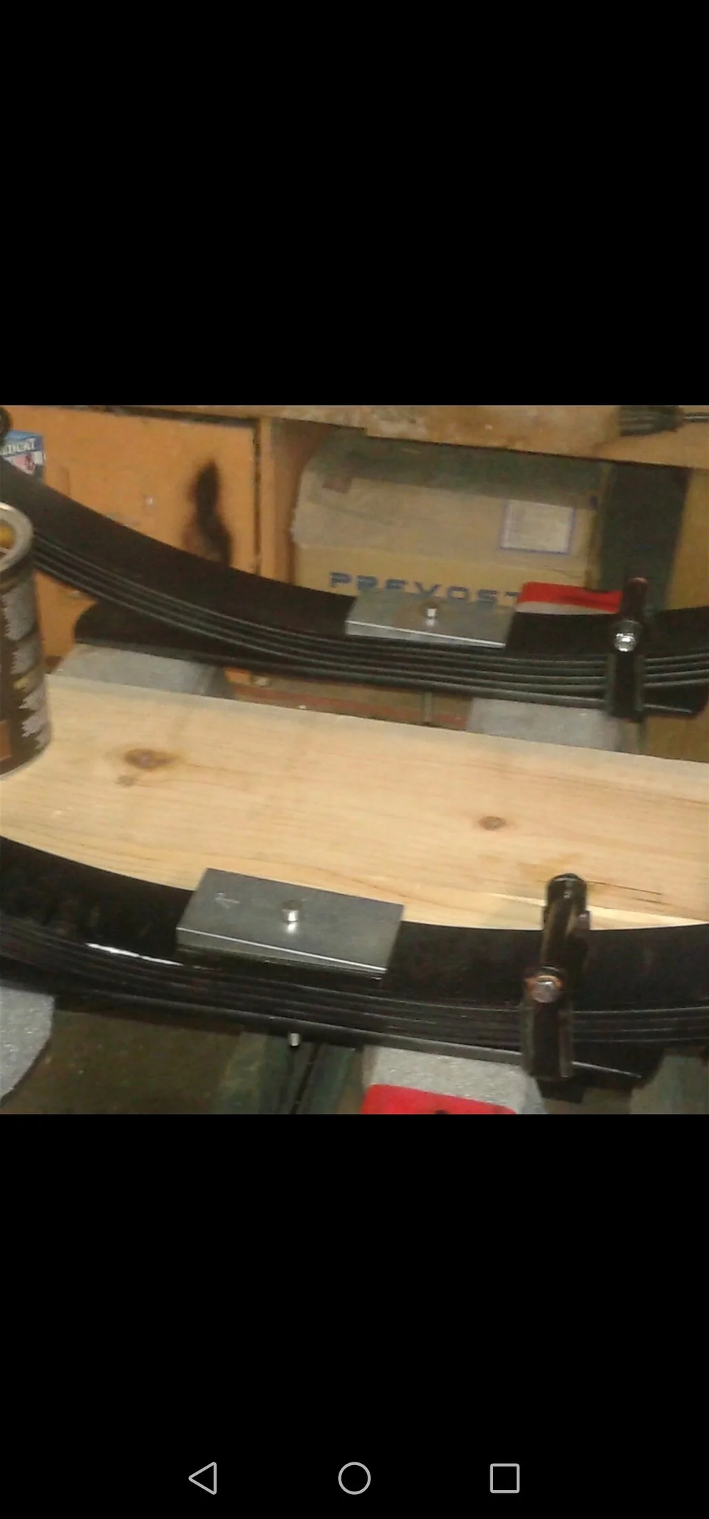

I'm struggling to find extended head leaf center bolts for 6 degree steel shims. Any ideas?
Good quality steel shims like those from valley hybrids use regular center bolt, shim is part of the leaf pack
