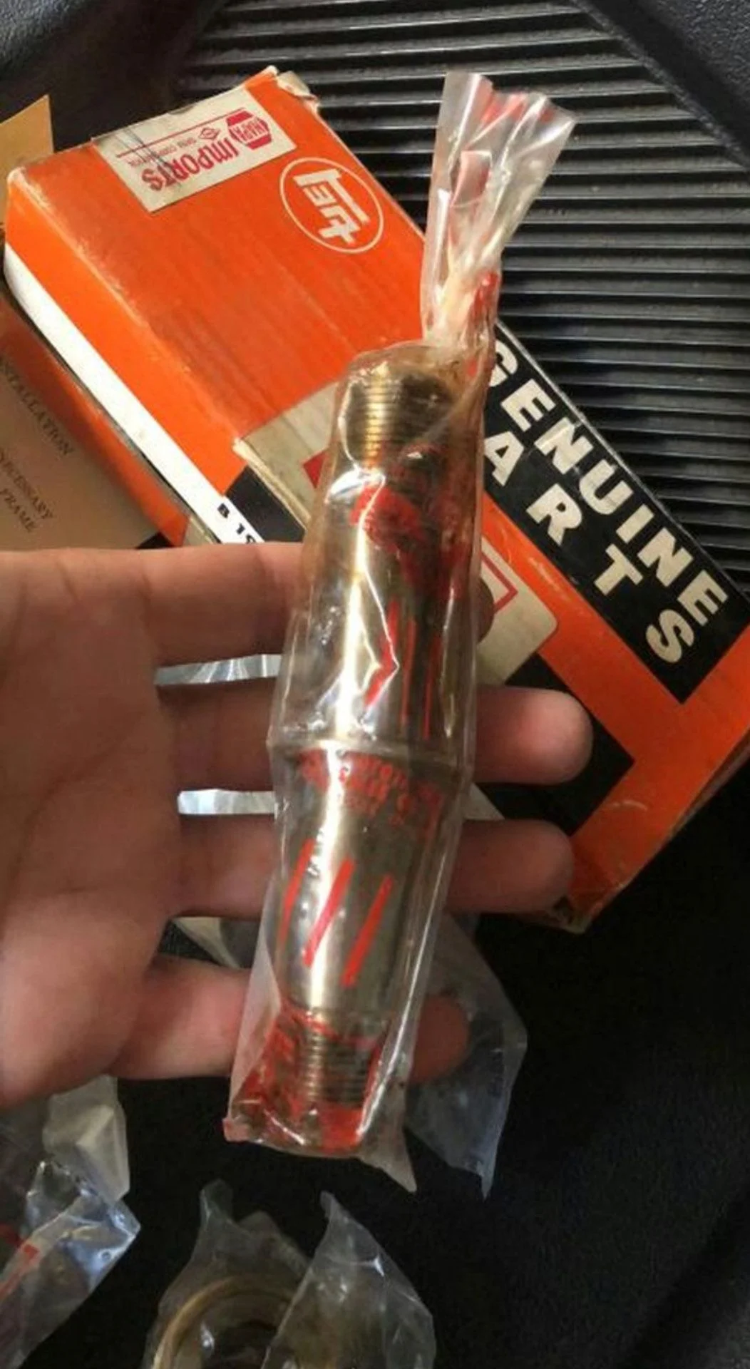

Bummer. Bryce mentioned you were hunting an OE shaft. I'll see what I can dig up at the shop.
That was my gut reaction. I’m scared I’ll mess up mine.
I will try to cut it off as suggested.
The problem last time is I could not
Get the shaft out of the frame.
I will try my slide hammer this time
My Venezuelan connection has one.
$1500 :eek:
I’ll try harder to remove mine. Of all the slide hammers and pullers I’ve git something is bound to work
That's a Toyota major service kit with a NAPA sticker. Wonder if napa still has one languishing somewhere?
Fwiw many of the NOS kits we were selling were also Napa labeled on the OE box. I had my Napa guys scour the system and they said there were none left in any modern Napa but it was quite possible an older Napa garage or machine shop affiliates might have one.

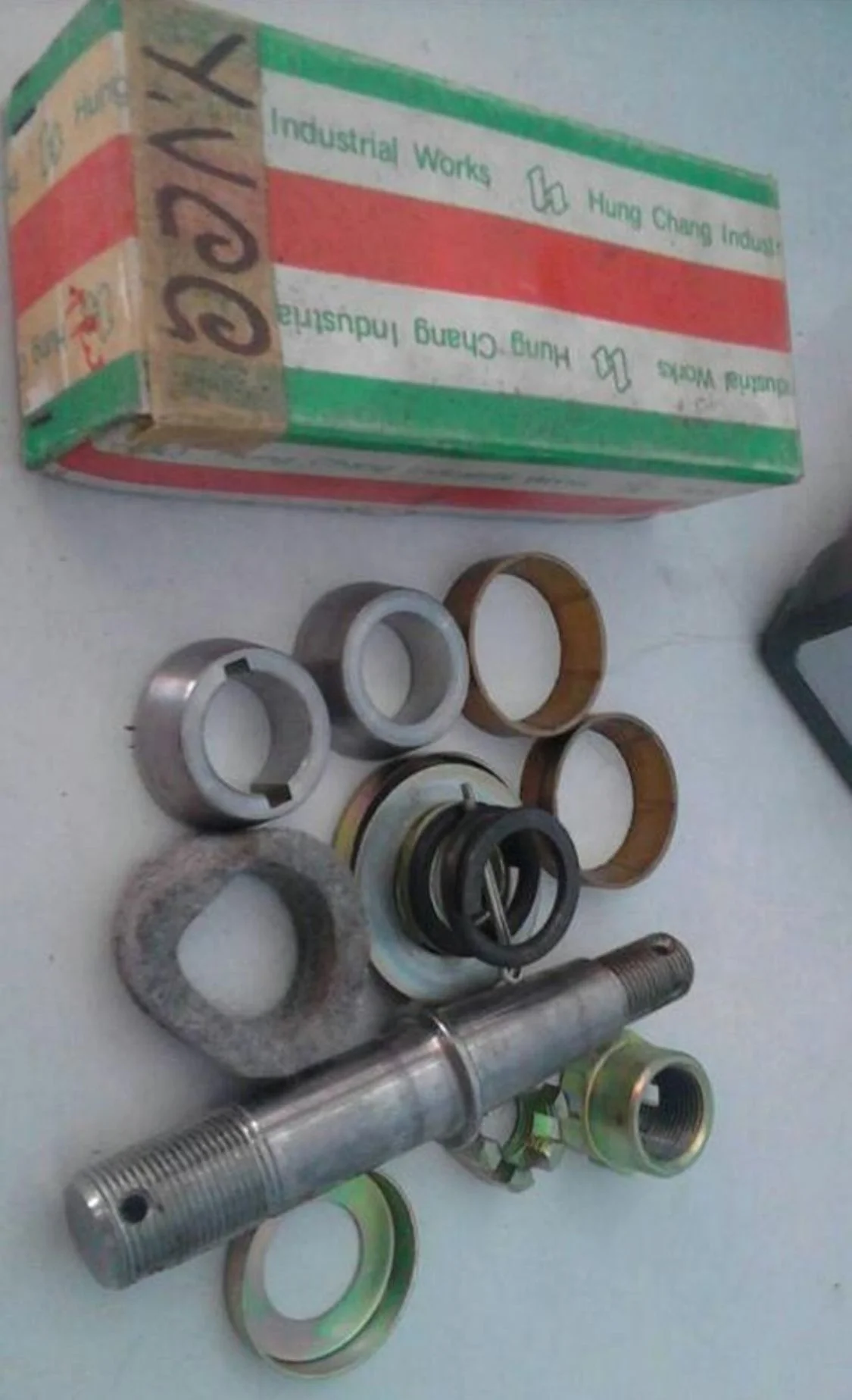

Hmmm, worth a try if the price is right. I bet we could get new shafts machines for under $100 each?

So. I decided to dive back into this setup
And figure out how to make it work
I pulled it apart and put every puller I had on the old shaft and heated it up and still it sits.
So. I cleaned up the old lower bushing and put it back on and trimmed 1/2 the felt thickness out.
I tightened it up until the steering had a bit of resistance while both wheels were off the ground.
I adjusted the steering until the steering wheel was straight and took it for a spin.
It steers and stops like a 51 year old truck with new parts now.
I’m silly happy.

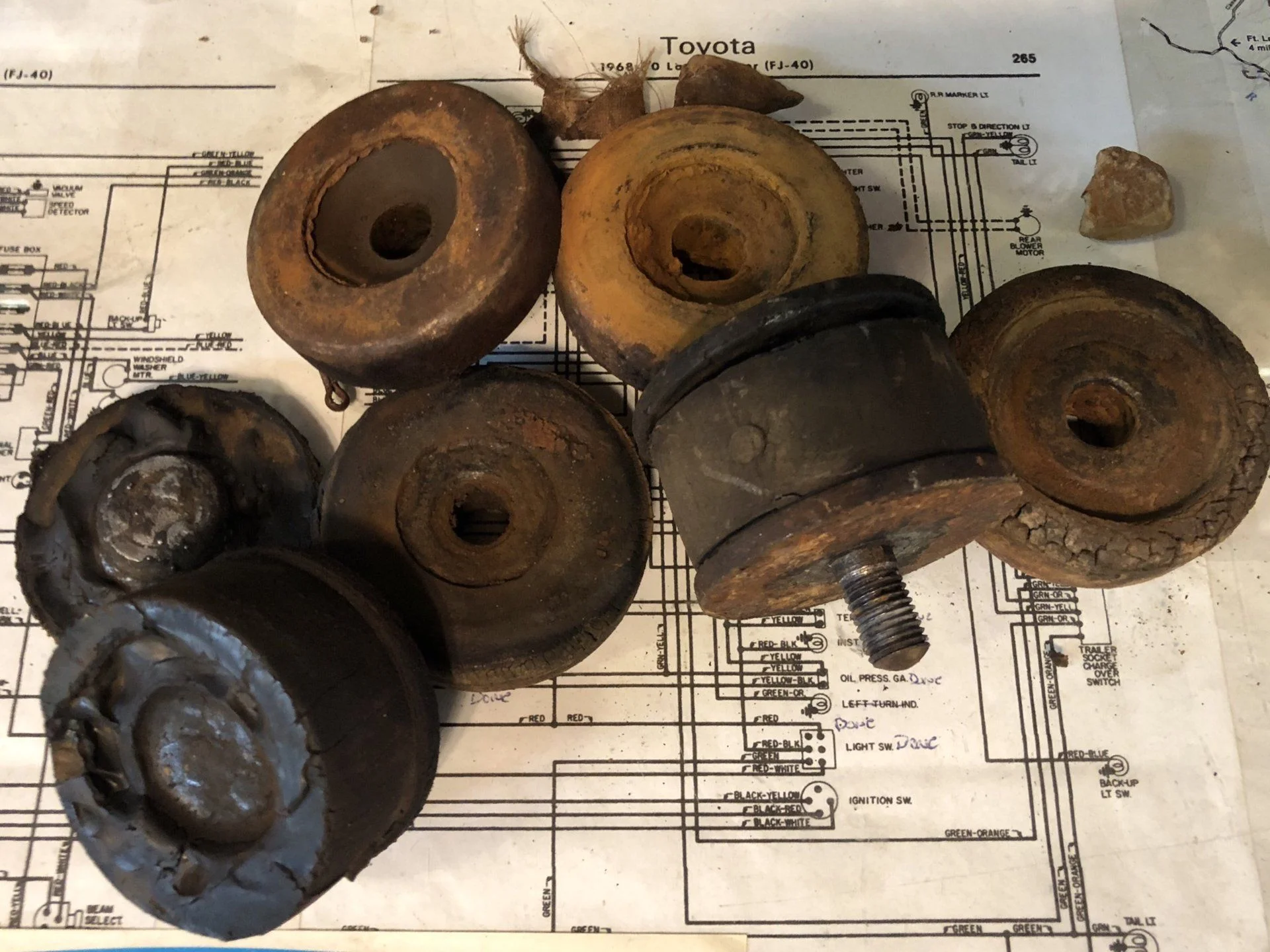

More replacing old stuff happened today.
Thanks @FJ40Jim for suggesting if my motor mount was broken to look a little deeper and see what else was worn out.
I ordered up some new motor mounts from @beno and today I was feeling good about a quick swap.
Quick.
I’m not sure who I think I’m kidding
The rears were smashed flat and both fronts were separated
Nothing like a metal fan hitting a shroud to get your attention to fix something
This thing is so much tighter now with motor mounts. Bed mounts. Sway bar mounts. Steering ends.

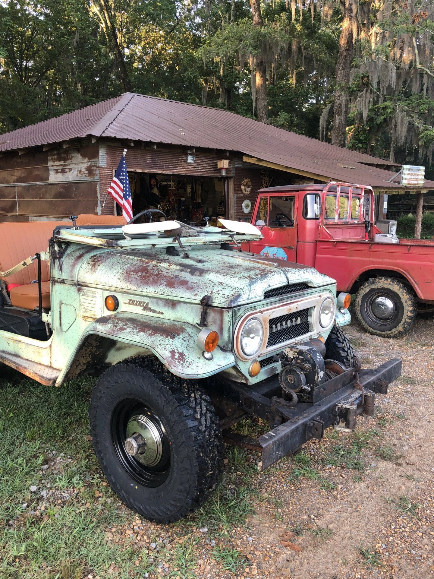

Pig approves.
Even got some mud on the tires

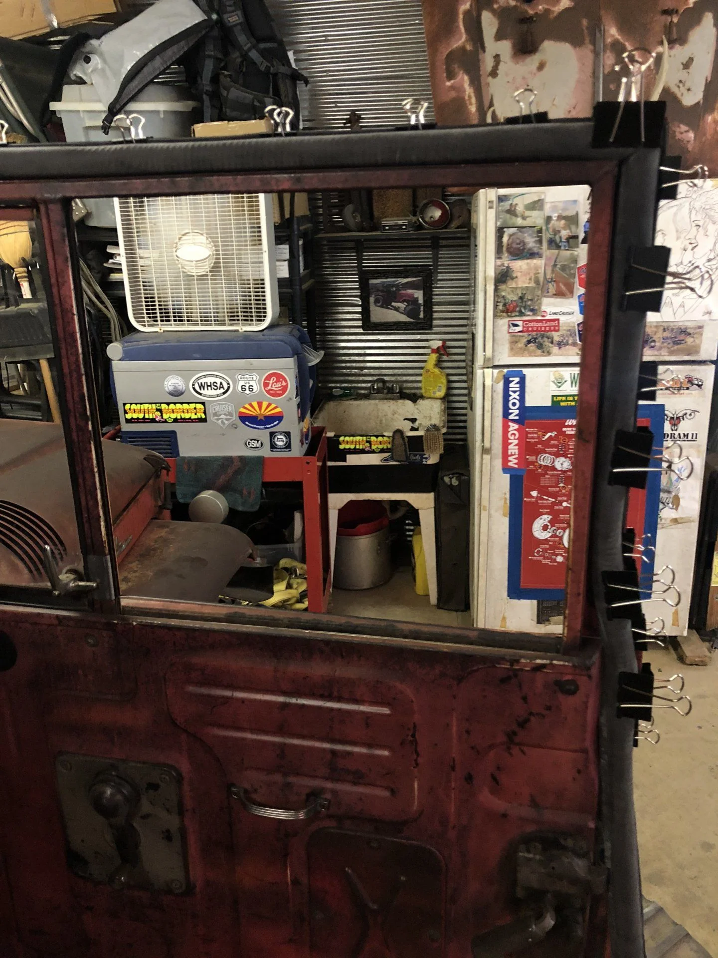

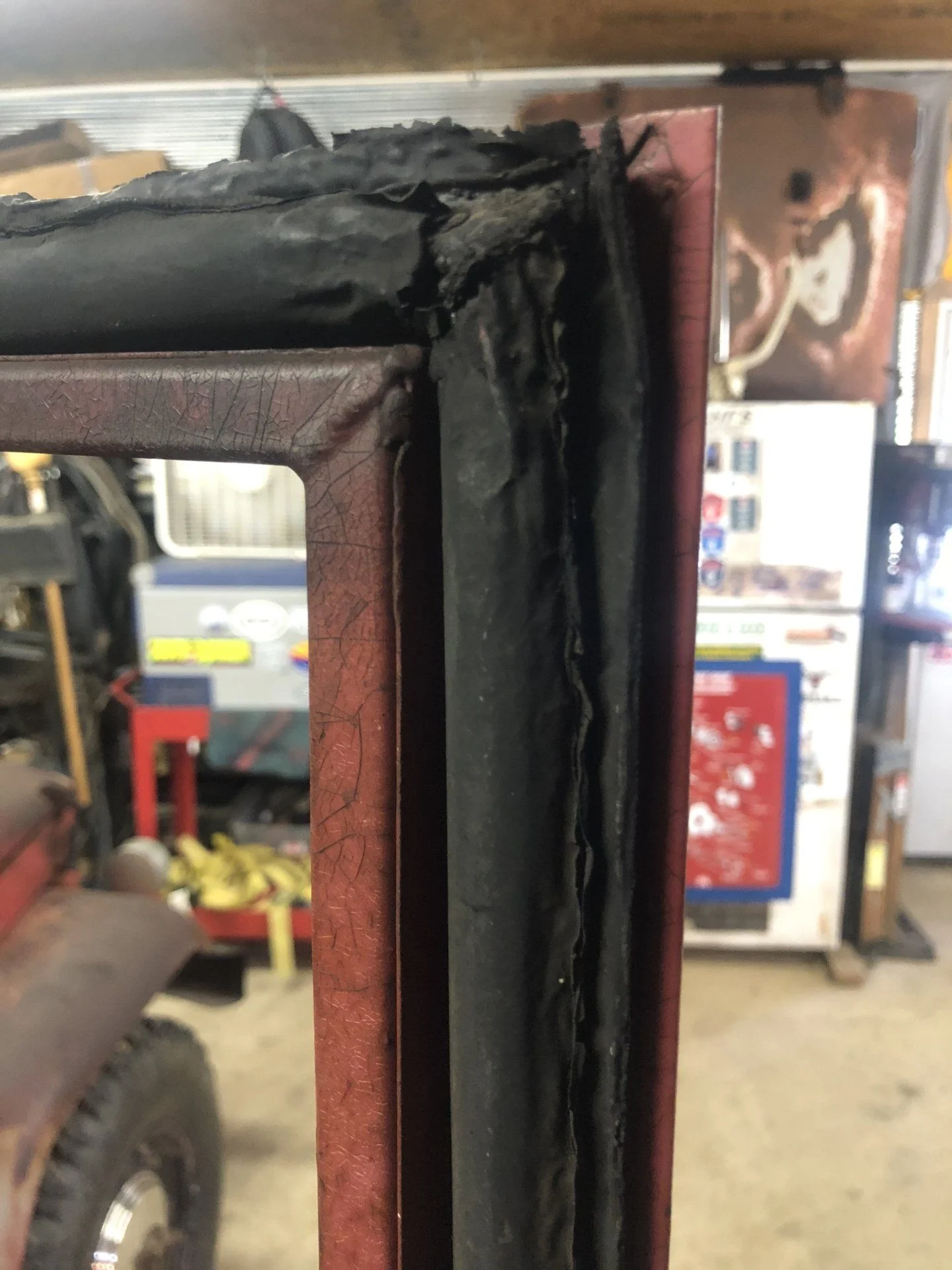

Started this fun job today after hosting a swap meet at my shop
I have to say. There is just no substitute for OEM 40 door gaskets. They are pillow soft and fill in even the largest gaps. Thanks @beno
