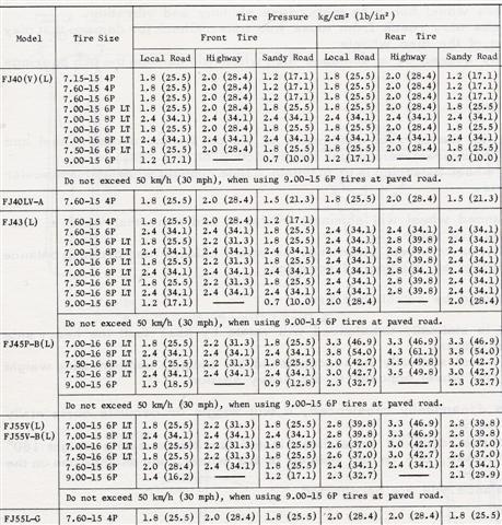

Tyre pressure
I feel ok with 2,5 atü front & rear (7.50x16)
and Bilstein shocks better handling and a more stable road holding...the old Toyota shocks are stored.
