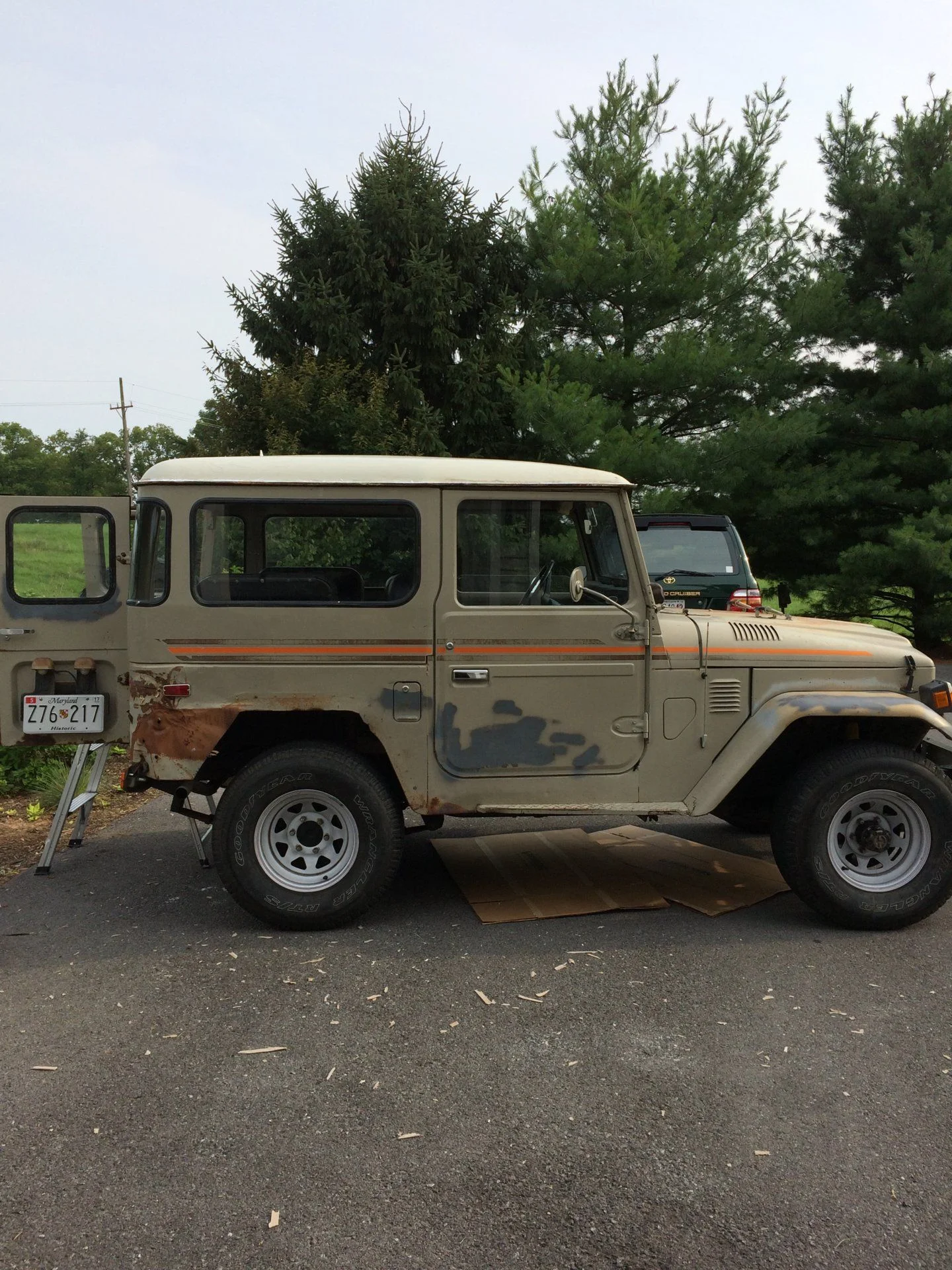

I got my Fj40 back in May of 2015 and have been working at a embarrassingly slow pace to get it as close to a daily driver as I can. After about two years of not having a clue what I was doing on it I finally think I'm starting to head in the right direction. I gave myself a deadline of until the end of Summer 2019 to get it to where I am happy with it, if it's not close by then I am going to reluctantly but seriously consider selling it.
I was hoping that starting a thread would give me the kick in the pants I need to start actually getting some serious work done to it. It is a 1975 Fj40 with the front axle, engine, transmission/transfercase from a 77 so I call it a 77 to avoid confusion, she's from Colorado and has typical rust in the rear sill, front fenders, and rocker panels, but overall she's solid. My plan up until my deadline is in order: Get her driving(she was up until a bad throwout bearing forced me to pull the Tranny and transferase) finish up any bodywork(new rear quarters, sill, and front fenders, as well as rocker panel patches) and last is paint(dune beige 416)
Any input or tips are welcomed, fair warning, I am not a very experienced mechanic so go easy if i do something stupid.

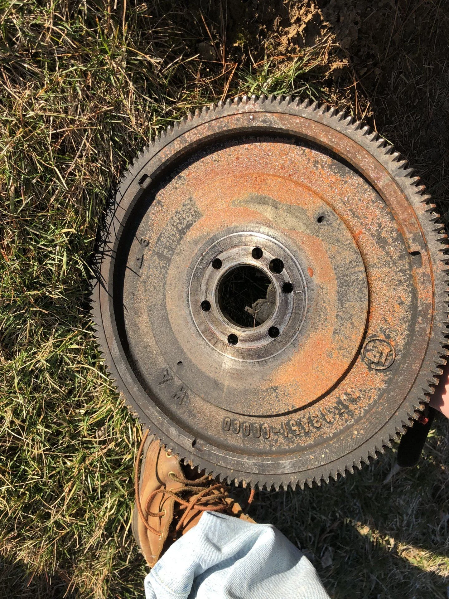

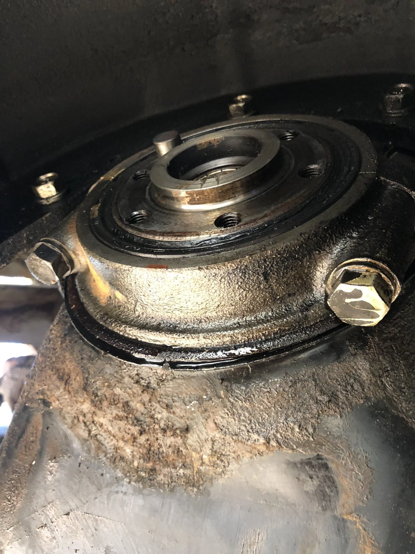

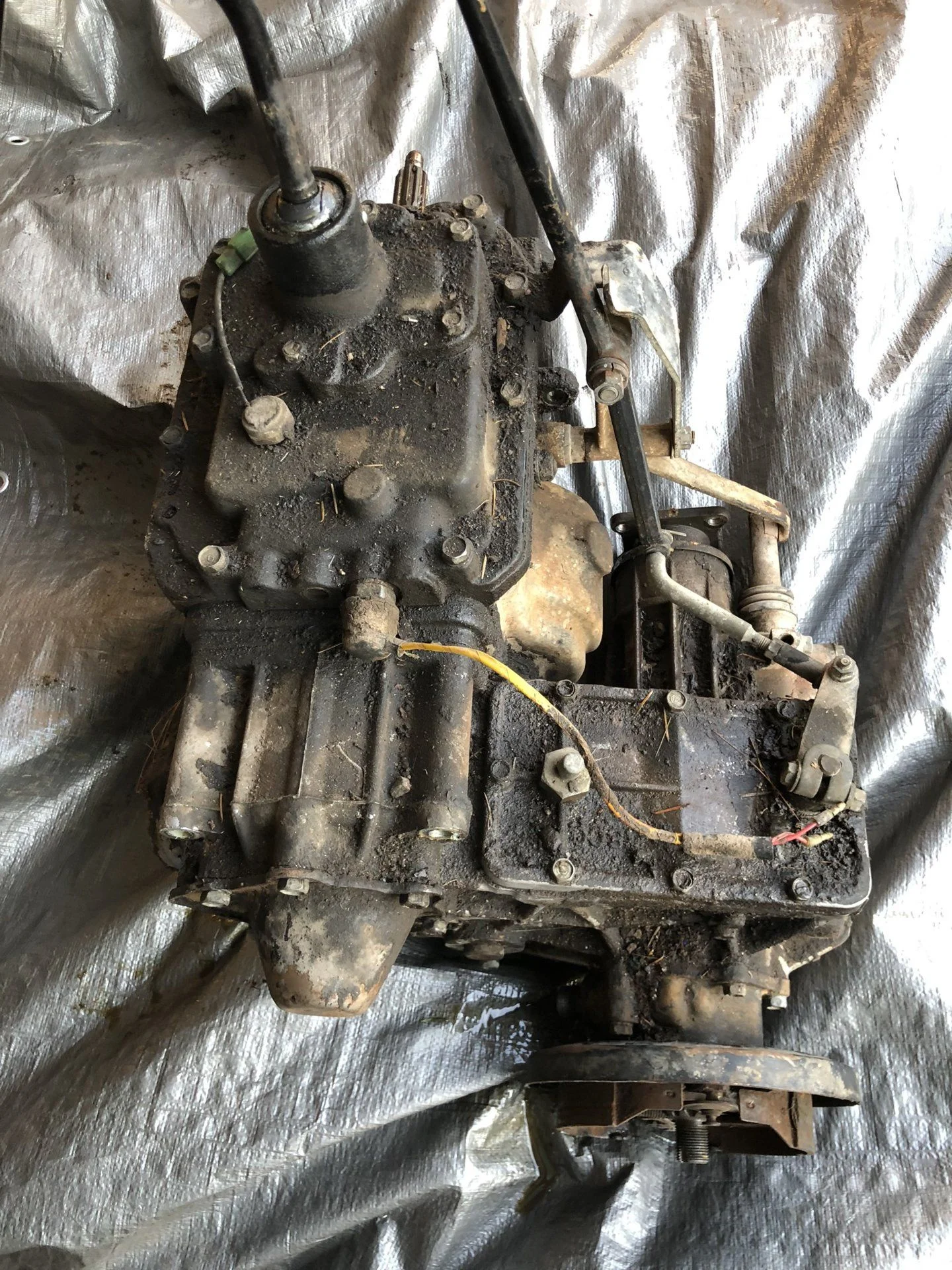

Thanks to everyone for the warm welcome! My dog's name is Scout and I am definitely gonna miss the pinstripes but i plan on recreating them as best I can after paint. This past weekend I worked on cleaning up the transfercase, and removing the pressure plate, clutch, and flywheel. As well as cleaning up the parking brake housing. The previous owner mentioned a rear main seal leak and i do have a new one but does this look like the rear seal or the back of the oil pan gasket?

Do that rear main seal while you’re there, the hard work is already done.

I’d say that’s coming from the back of the oil pan gasket.
Clean that area up real good and shoot some baby powder around it, start it up and look for the leak.
If you can safely start the engine.

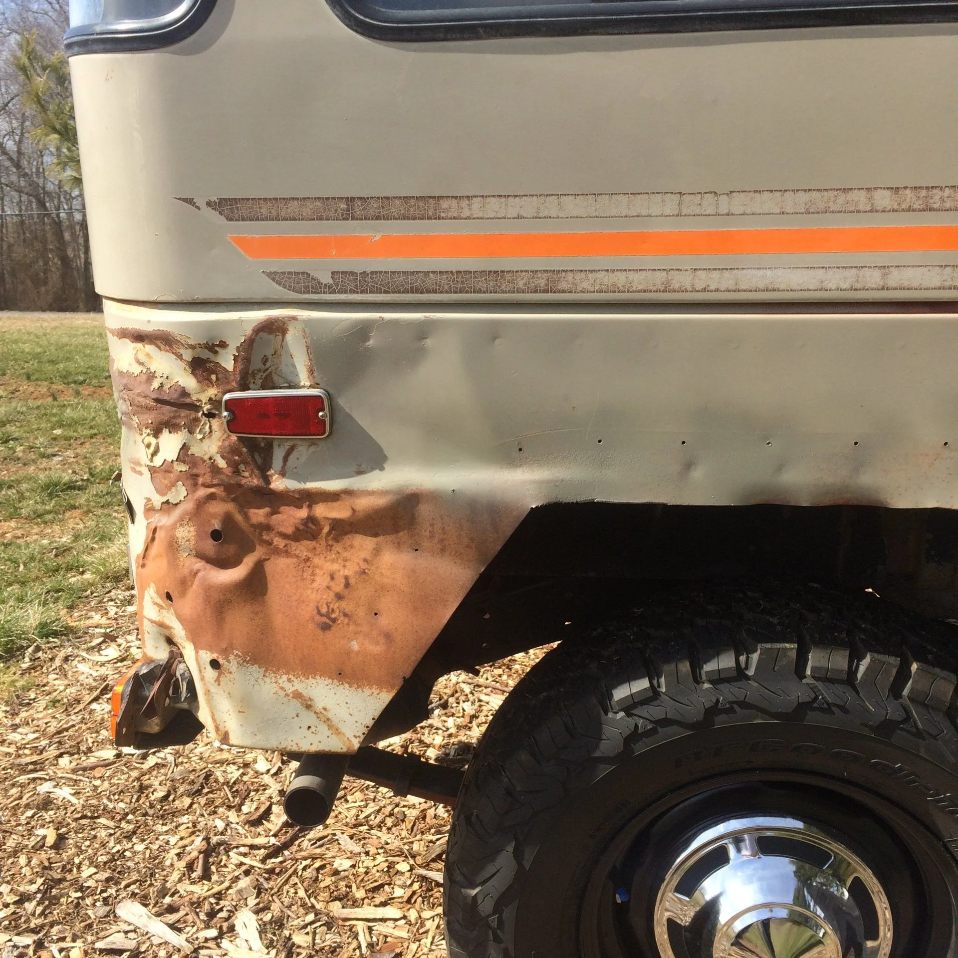

I'll leave you alone on the original paint now.
I would consider keeping the original paint but there's a lot of body damage i need to correct and quite a bit of rust that doesn't show up from a distance in pics
